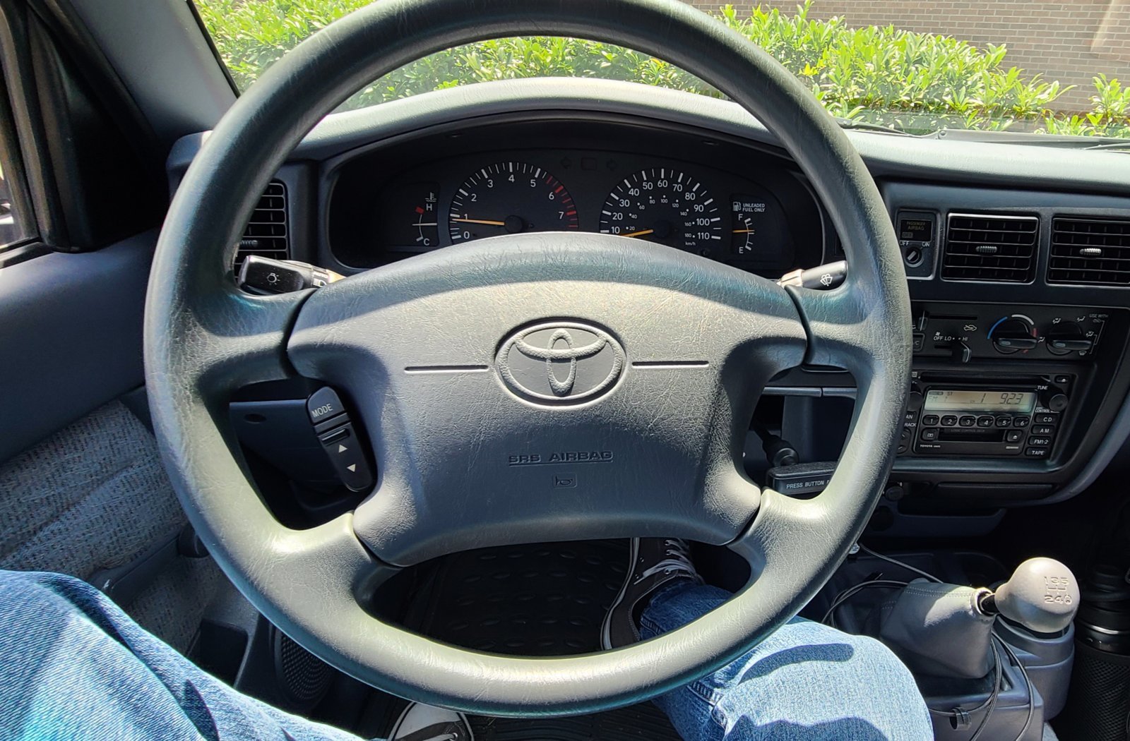

    IMG_3797.jpg I use the steering wheel from a 08 Corolla S. Looks great. Feels OEM.

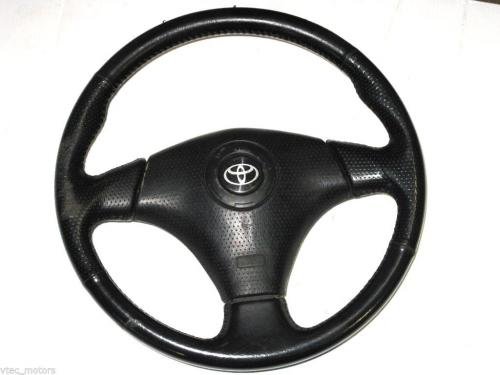

    Steering wheel controls can also be made to work with the 3 spoke wheel shown above. The controls have to come from a Lexus of the same vintage (from the GS I think) but that's unfamiliar territory for me since I went the Sienna route. My guess is you'd need the clockspring from the Lexus in order to work too.
