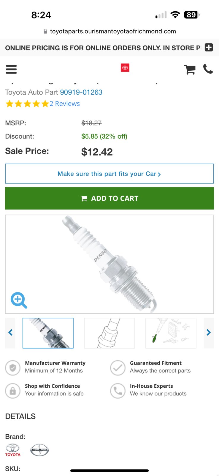

  15. May 4, 2024 at 4:53 AM
    faawrenchbndr
    faawrenchbndr Til Valhalla
    Jul 17, 2011
    #60024
    2,591
    Greg
    Denver, Indiana
    ‘23 Sport 4x4 DCSB
    heat range yes, material no, gap no, electrode style no

    #19
  20. May 4, 2024 at 5:25 AM
    #20
    faawrenchbndr
    Jul 17, 2011
    #60024
    2,591
    Greg
    Denver, Indiana
    ‘23 Sport 4x4 DCSB
    That’s weird. Take a little listing from one of many Toyota dealerships.
