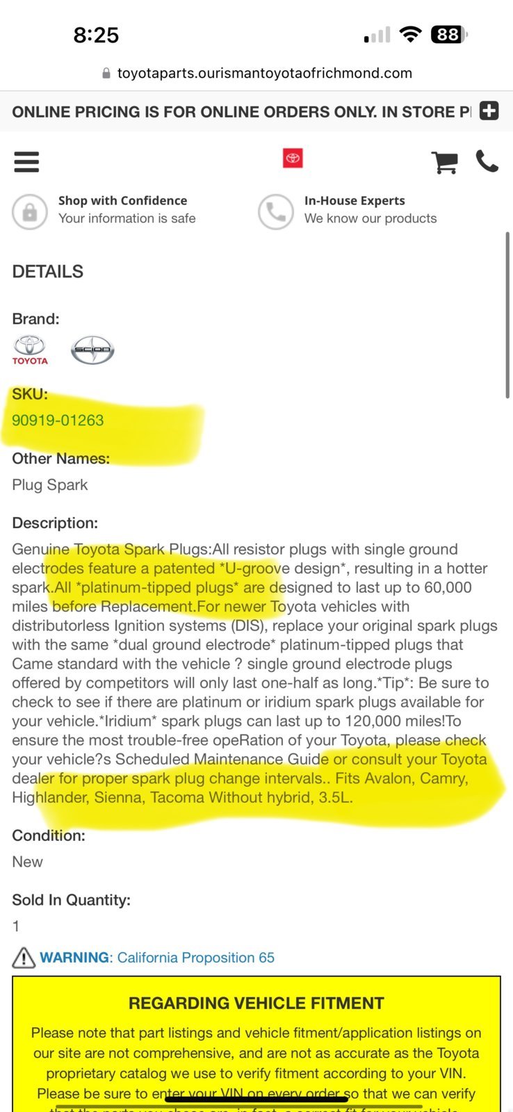

    I don’t know how much more detailed do you want this is from a dealership you’re posting garbage from Amazon for chrissake

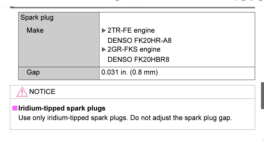

    From my online manual

    I guess all the dealer listings are wrong
    Whatever…..you win

    i’m just putting out the correct information that comes up when you search for parts at the dealership, not Amazon or eBay or Rock Auto

    But that's NOT correct. You said they are platinum, which they are not. What is the platinum Denso part# for platinum the plug you are referring to? You only mention the last half of the OEM part#

    post number 20 & 21 take a look clearly states platinum, sir. straight up that’s the number that comes up when you do a Toyota parts search.

    I'll ask again because you seem to be struggling with this. What is the manufacturer part # on said plug that comes with that part # you specified? Furthermore, why does my owners manual specify iridium ONLY?

    Same plugs. Look in your manual. This is from a 2023 manual
