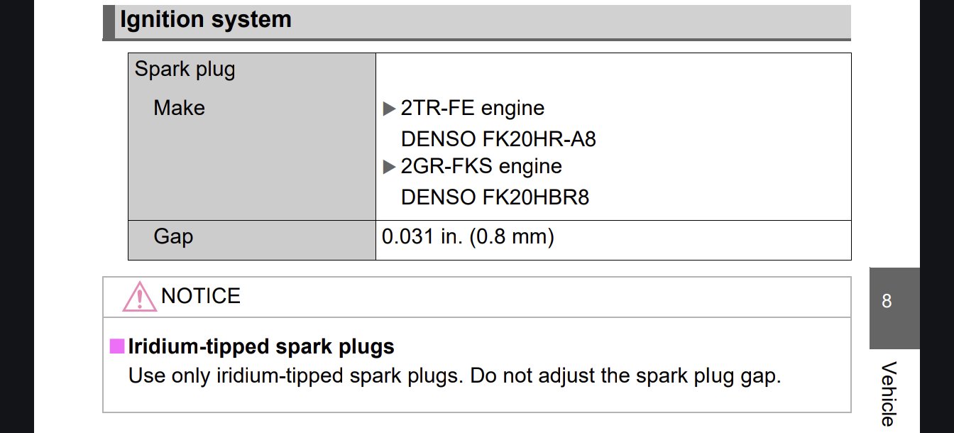

    2023 owner's manual says the same thing. I don't think they'd ever update the older manuals, but they absolutely would update the latest if they found a reason to change it in later years.Screenshot_20240504-160525.png
    I'll stick with what's in the manual. The dealer parts websites are full of inaccurate and contradictory information. Hopefully the people at the parts counter have better info.
    When I bought my truck the used car dealer put in cheap Champion plugs gapped to 0.040. Rockauto lists them as an option. They did work, but I'll stick with the manual's recommendation for maximum reliability. It would be nice if they gave a tolerance on the gap, because otherwise I have no idea if 0.040 is acceptable (besides the fact that it seems to work).
