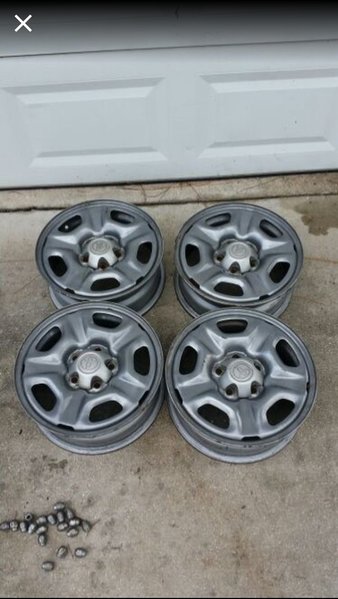

    I have a 1995 2wd with stock 14" wheels. I found a good deal on a newer set of Tacoma steel wheels and tires (225/75/15), just wanted to confirm they will fit. Thanksimage.jpg

    Don't know if it's the same with first gens but second gen V6's are 6 lugs and 4 cylinders are 5 lugs. What truck do you have?

    I have a 6cyl 5 lug

    Lol things have changed. Sorry I can't be of more help.

    2nd gen 5 lug wheels won't fit 1st gen 5 lug trucks. The center bore is different and the offset is way positive. You would have to cut the centers out of those wheels to get them to fit

    what year truck are these "newer" rims off of? it makes a big difference if its first gen or second gen.
    newer first gen rims will fit without any problem, if they are the second gens, I think they will have fitment issues

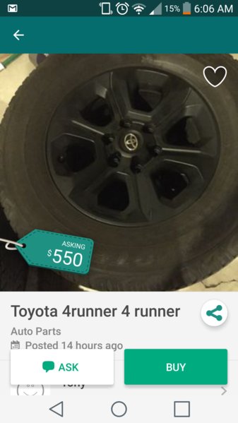

    I have a similar question....I was looking at these for my 1st gen 2002 Taco. They ar off a 4Runner.

    But i can clearly see y lugz.

    The holes in the gen 2 spokes are D shaped and will NOT fit a Gen 1. The later Gen 1 wheels are a triangle shaped hole in the spokes and have the correct center bore and offset.
