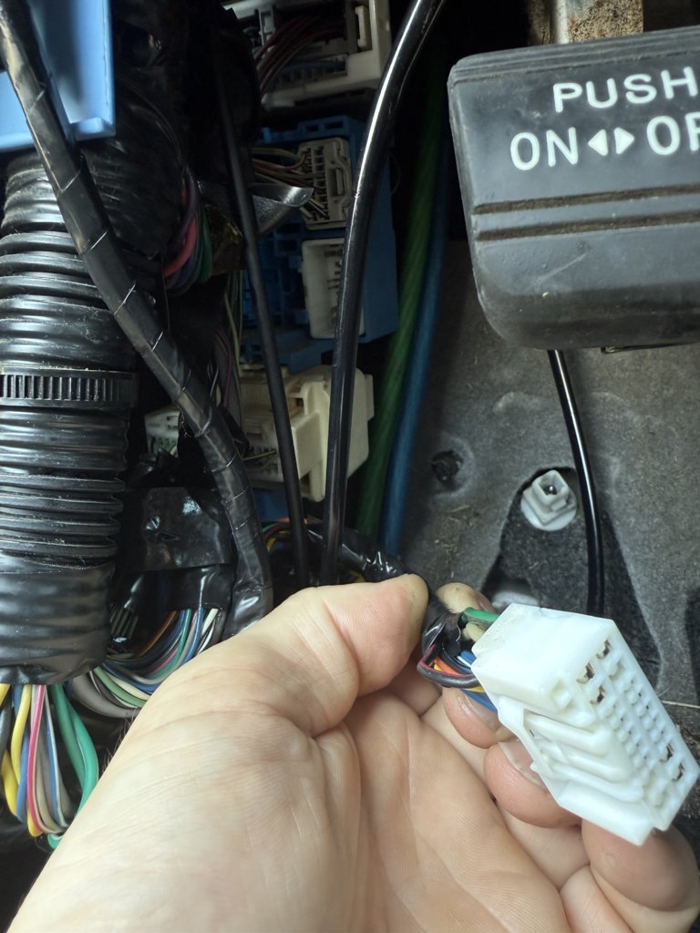

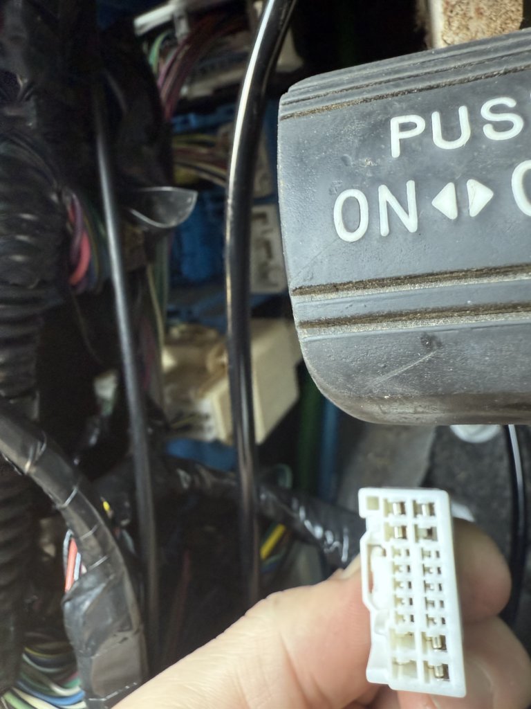

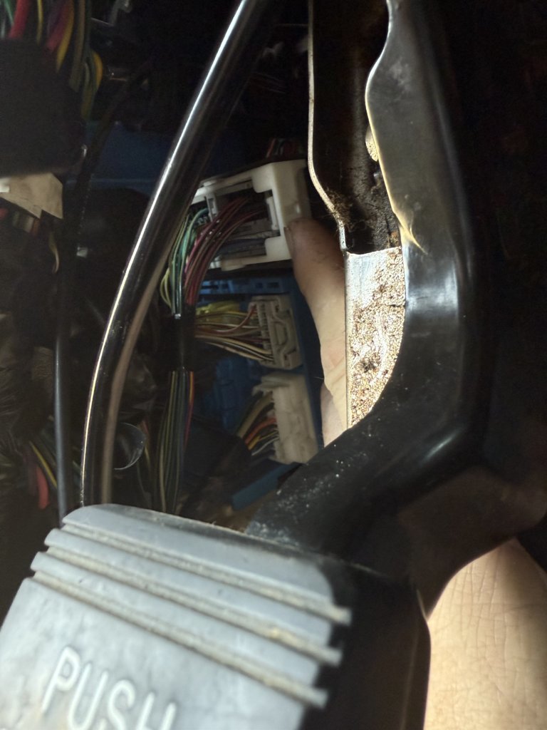

    Have you checked Connector IB1 Pin 8 (Black/Red) behind the left kick panel? That's a relatively common issue for it to get burnt.

    Is it the one my figure is on

    No it's the white one that's vertical below it.

    If this is correct looks good to me

    5. I'd like to know what the voltage is to the IB1 pin #8 (Black/Red wire) when this happens. (See DM93 post above for Where it is)
