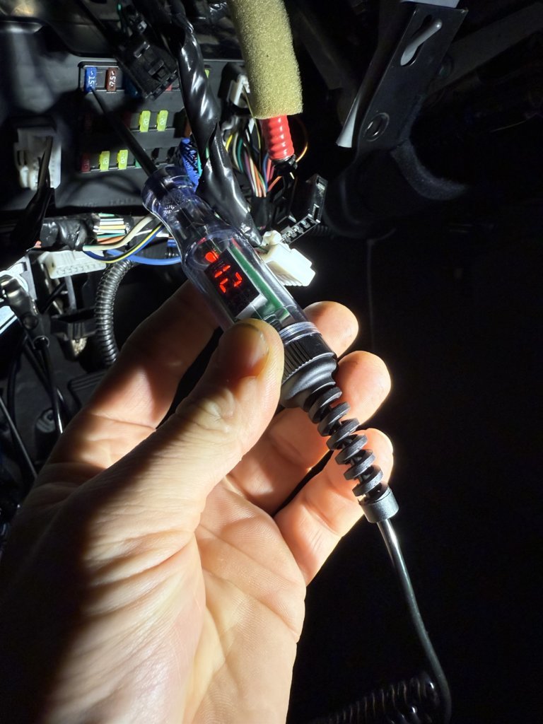

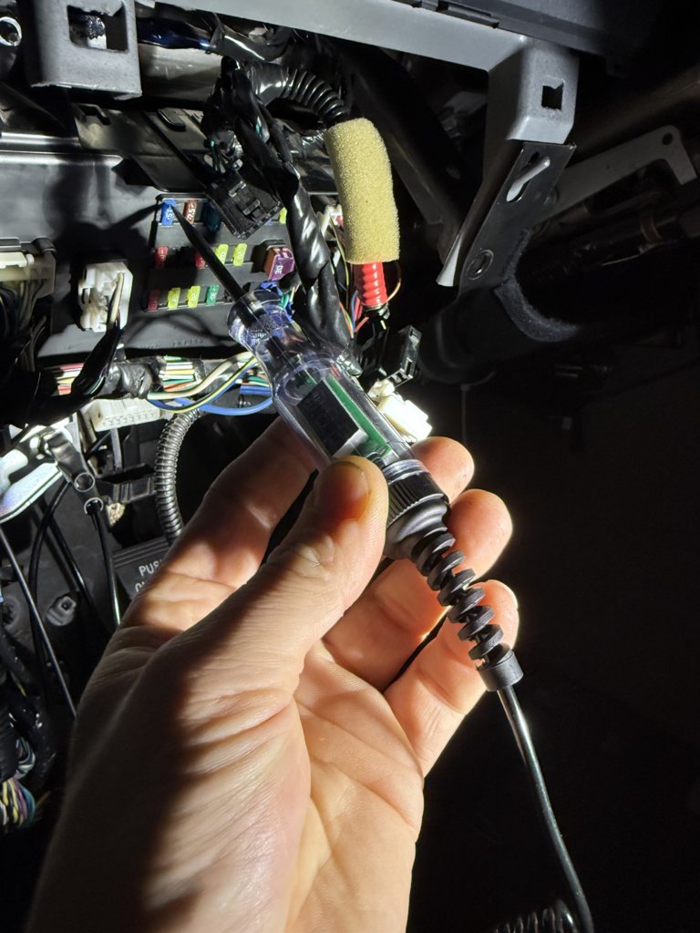

    Wasnt 100% sure so i checked all the green an white wired in that row with key on

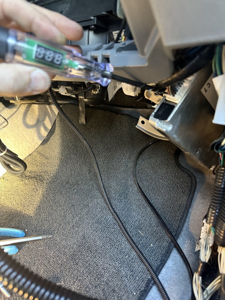

    Need to check Pin 3 (Blue) and Pin 9 (Orange) on E8 for Power in.
    Pin 3 should have power at all times and Pin 9 should have power with the key on.

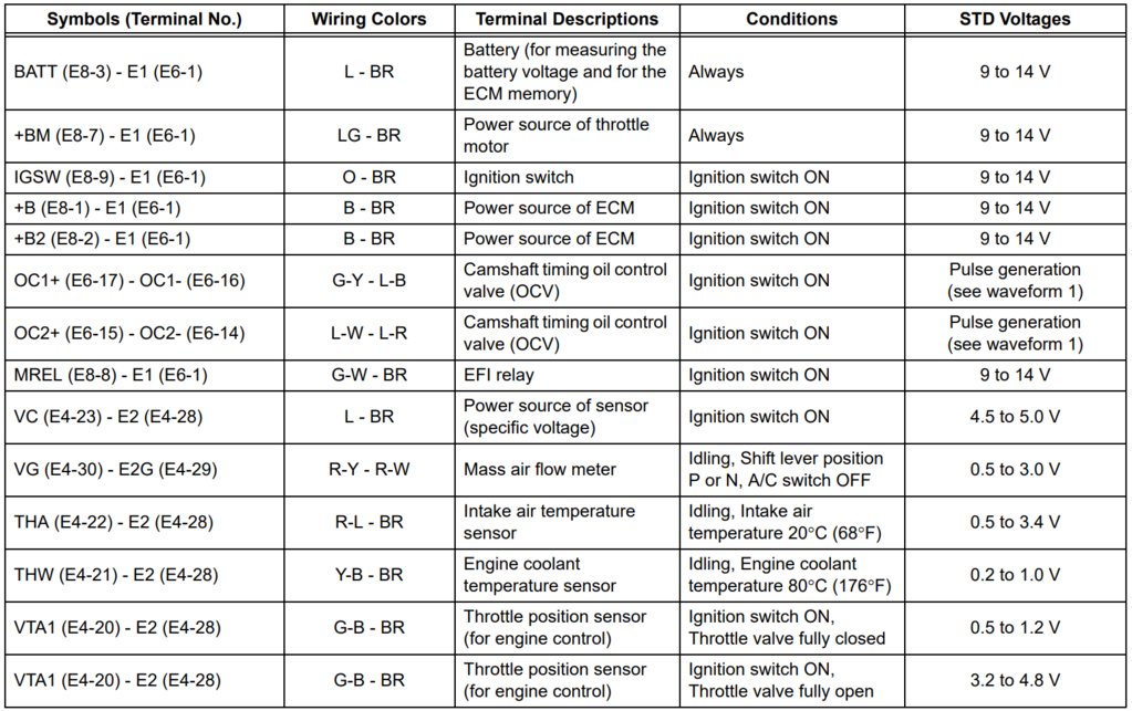

    As long as you were making good contact, then it looks as if the ECM is NOT putting out 12v to turn the EFI relay on.
    The key was ON, correct?
    here is the info from the FSM.
    Key on, Pin 8 should be 9-12v (Listed as MREL below)

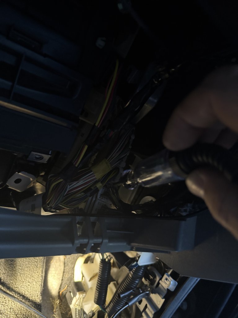

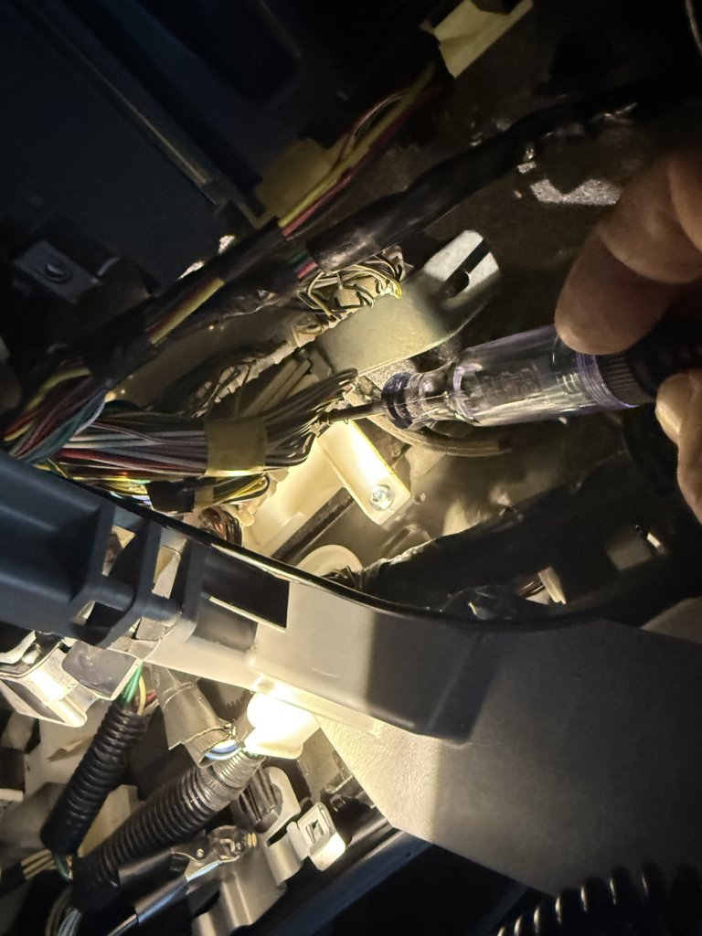

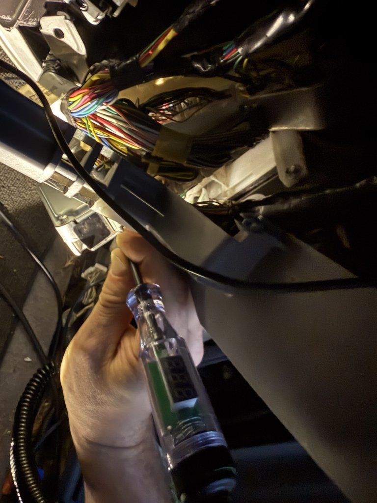

    Blue 12v orange nothing

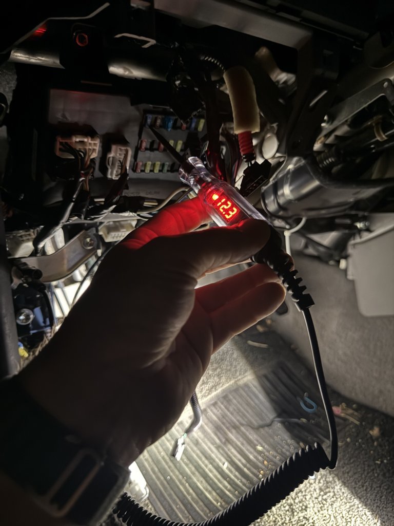

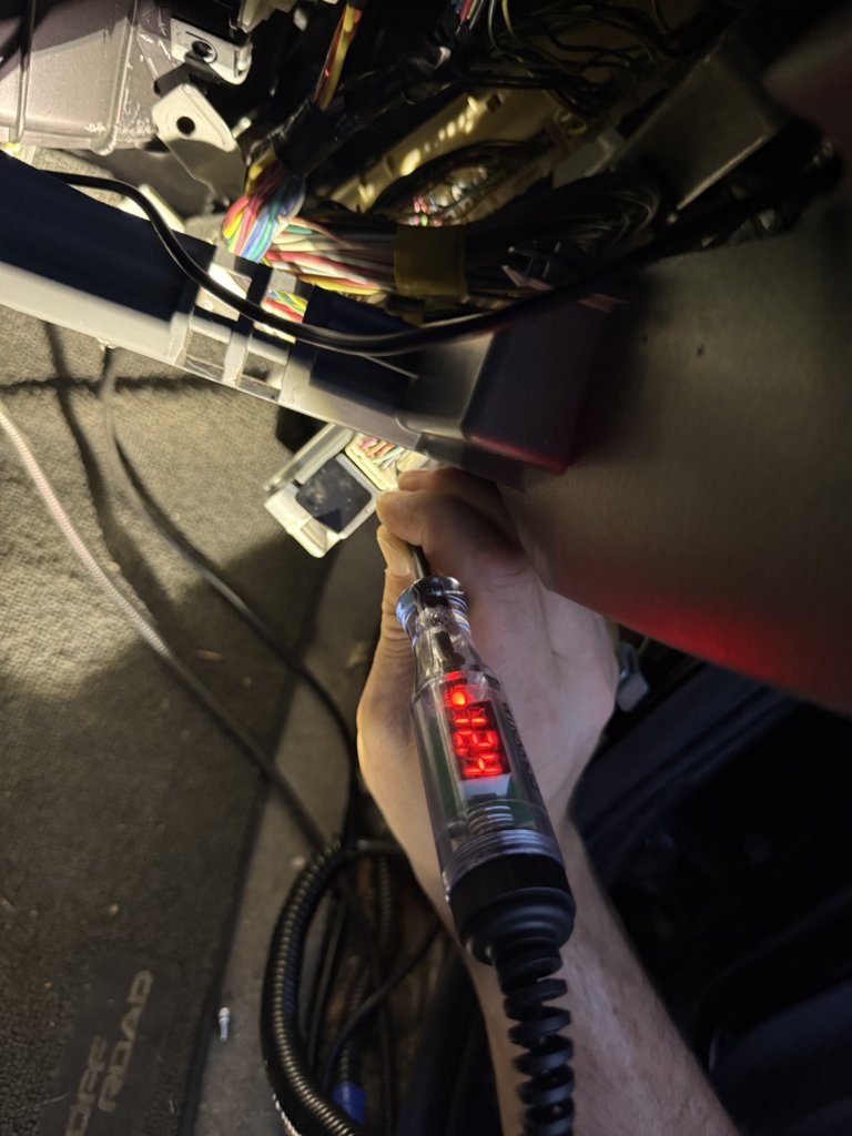

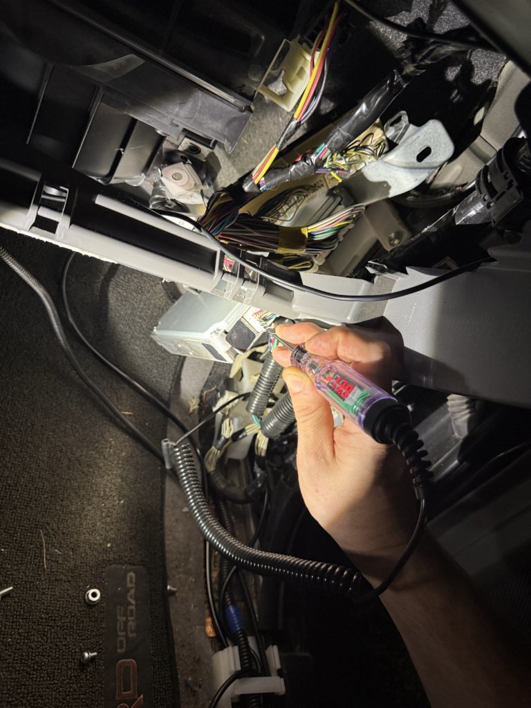

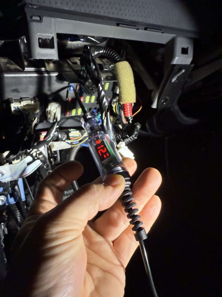

    Go to the IGN Fuse (15A) in the interior fuse box left of the steering column and check it for power on both sides with the key on.

    It seemed to have a crappy connection

    Did you pull it and look at it to see if it was cracked or something?
    Is it working now?

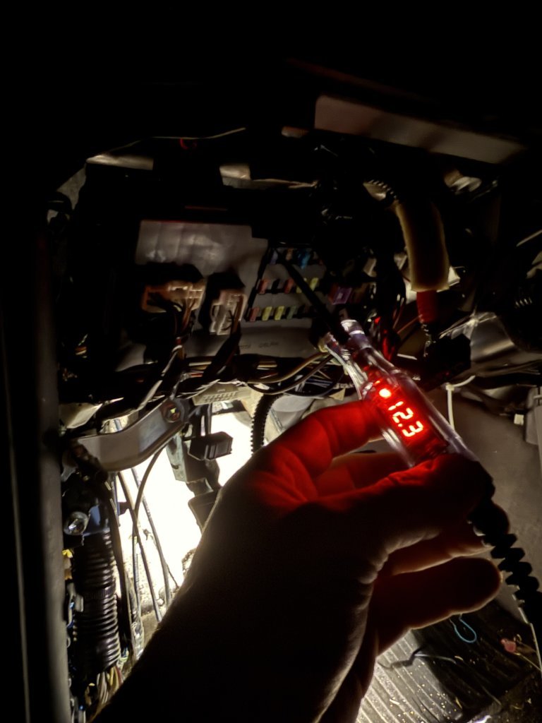

    I pulled and and replaced it

    So do we have power at the Orange wire at the ECM now?

    Well see if she runs.
    I've seen fuses crack before but it's pretty uncommon.

    She started shes runing with what seems like a small miss miss tho, now well have to see if she runs for longer then 30 min ill report back in a bit fingers crossed

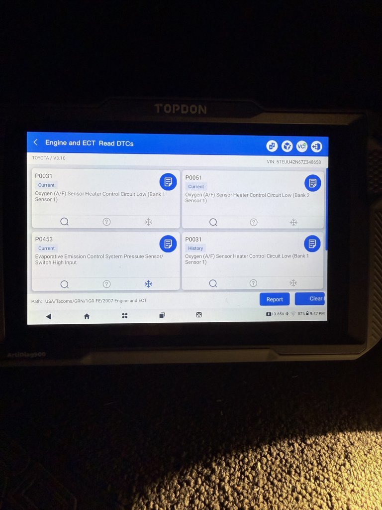

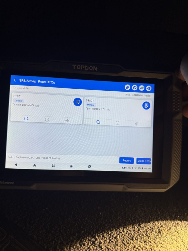

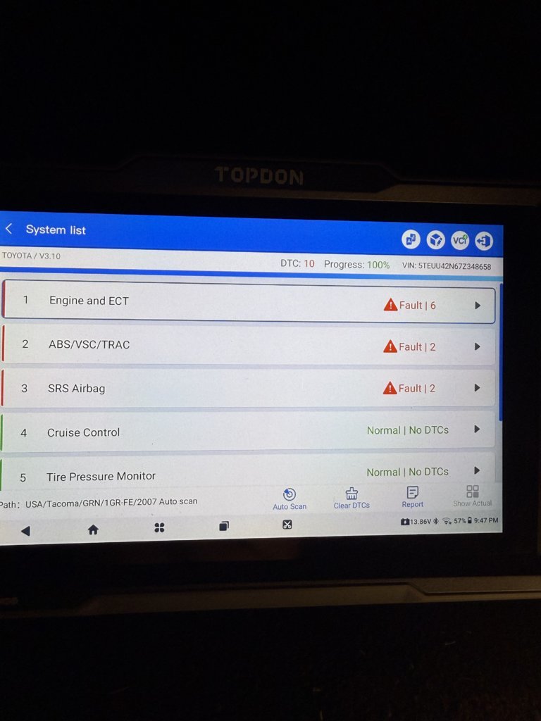

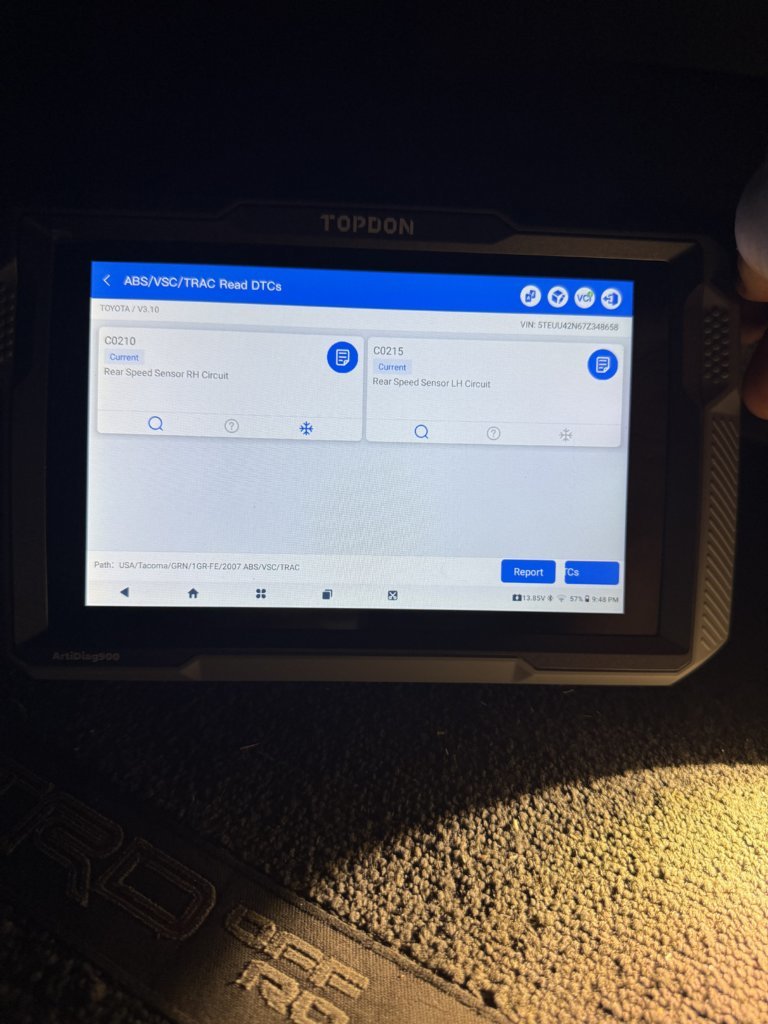

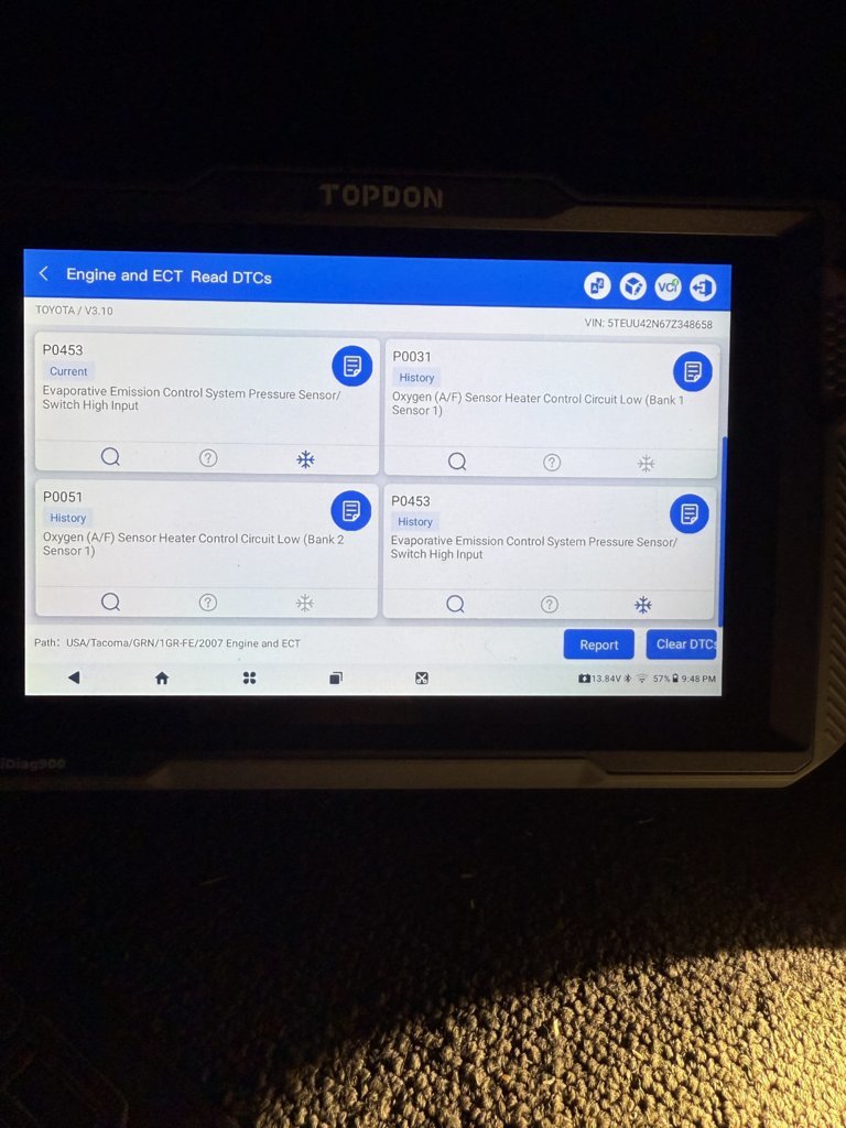

    Shes still going no check engine but i went ahead an scanned it an i got some codes

    Check the 15A A/F Heater fuse.
    And the EFI no.2 fuse.
    It's an easy first check.

    So for the P0031 & P0051 we need to check the A/F HEATER Fuse (15A) and A/F HEATER Relay first.
    The P0453 suggests a wiring issue to the Canister Pressure Sensor (or failed sensor) which is in the Leak Detection Pump on the Charcoal Canister at the rear of the truck.
    The B1801 is likely a failed clockspring (Spiral Cable).
    The C0210 & C0215 is likely a wiring issue, Connector S22 above the rear axle is pretty common to get corroded.
