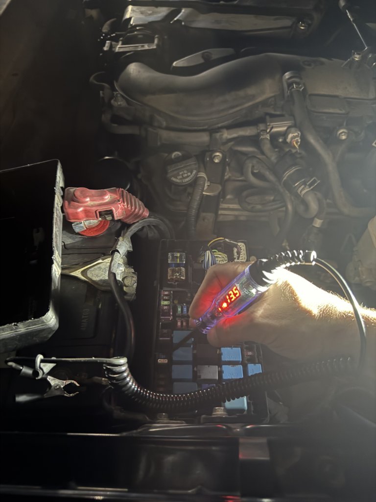

    07 Tacoma access cab
    A/f heater good and efi#2 good

    Did you check both sides of the fuse?

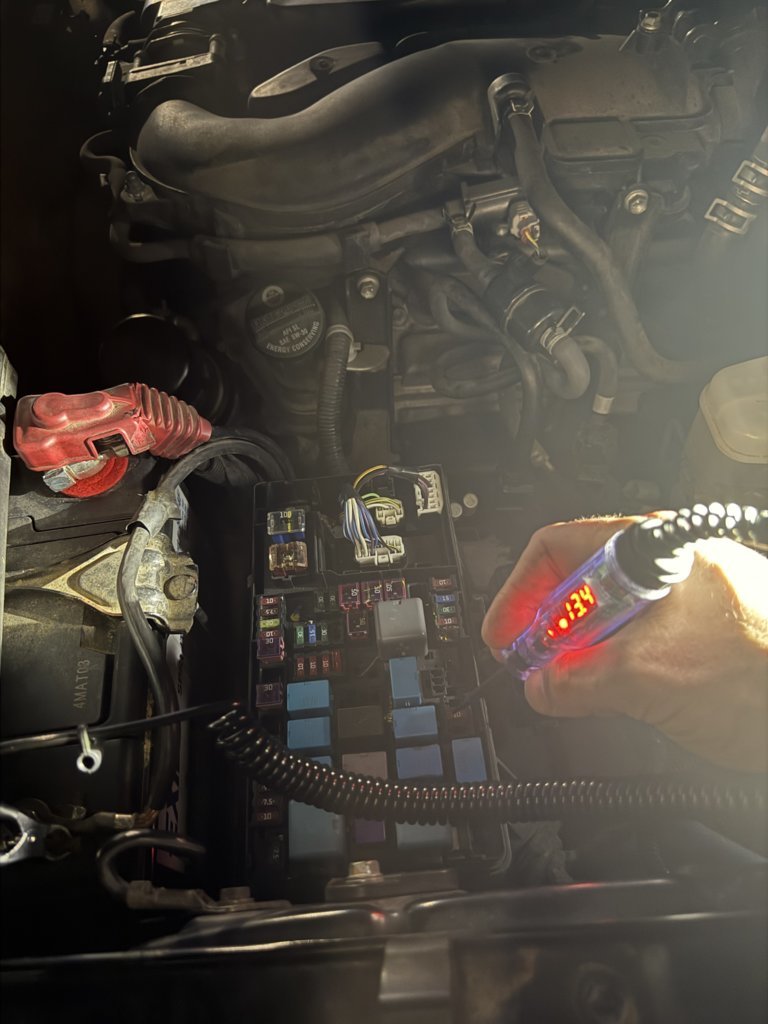

    Yes check both sides both those fuses are good also truck is still running witch is the longest its ran in 2 weeks I'm plus

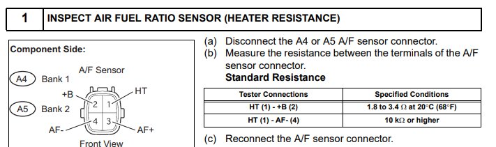

    Ok I’m going to be home soon so what am I checking / testing we left off on the afr sensor and the canister so I’m assuming you want me to prong the afr sensor and the canister or is it a different test

    For the Test in post #70 above.
    You will unplug the AF Sensor, and test the connector going to the Sensor. NOT the ECM side.
    In this test, you are testing the A/F Sensor.

    Ok so if I’m reading dm93 diagram correctly I’m testing for power in pen 2,3 and ground in 1,4

    No we're checking the resistance of the heater circuit in the sensor, set your meter to ohms.

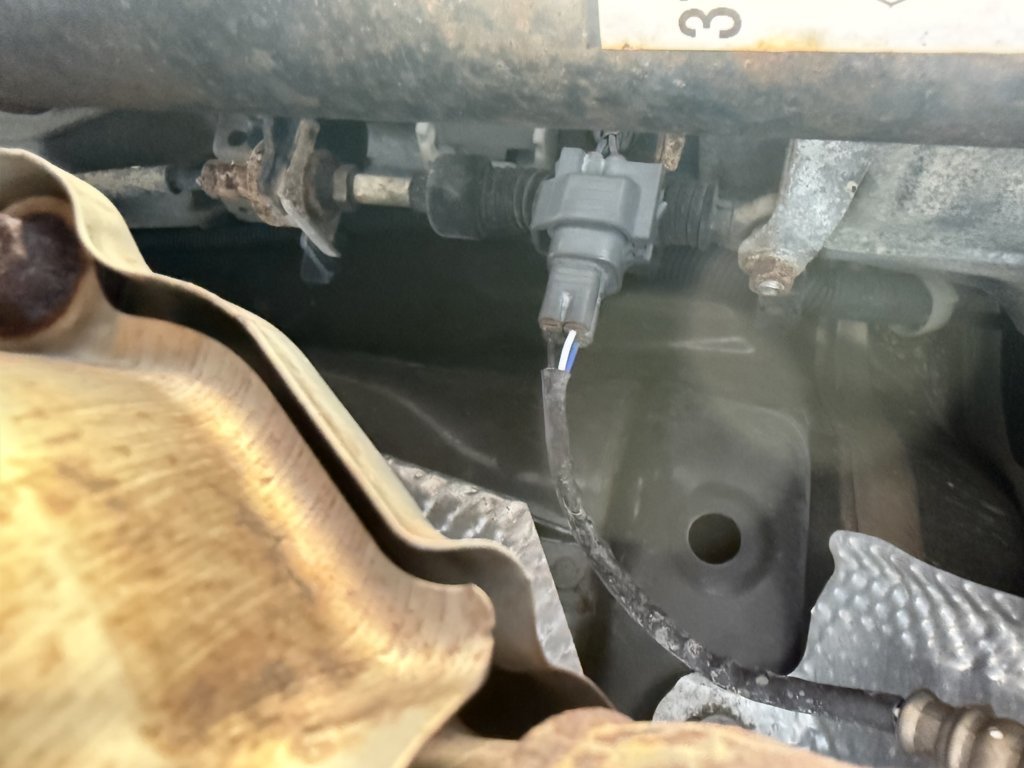

    She did start agin, i found my meter so im checking this plug in drivers

    Hope i did that right

    You need to test this end.

    Hopefully thats right
