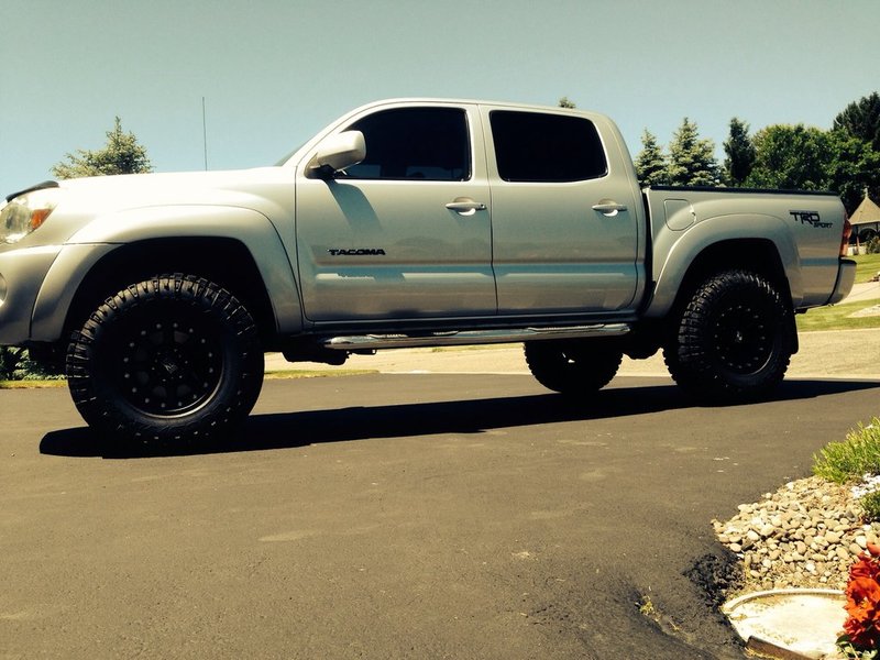

    OME 887s with 5100s all around and an AAL for just under three inch lift. Front sits a half in lower than rear. 285/75/16 duratracs. Stock UCAs, light trimming on bumper. Ride is great. image.jpg
