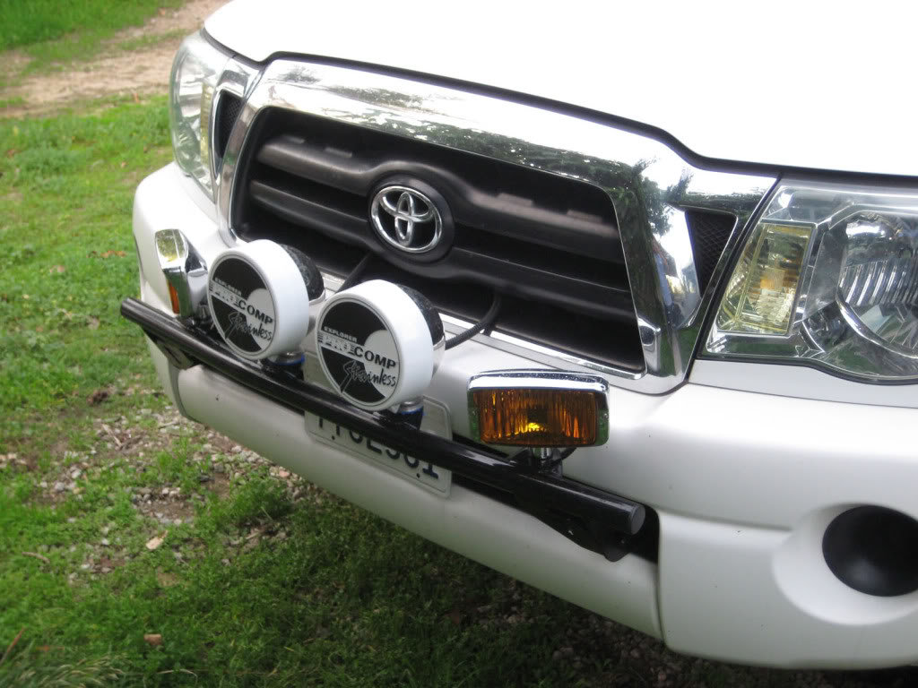

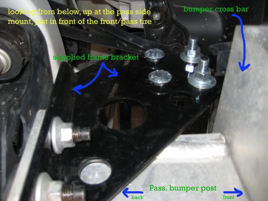

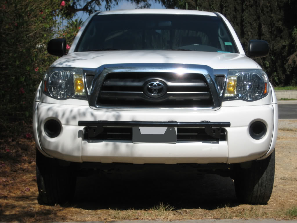

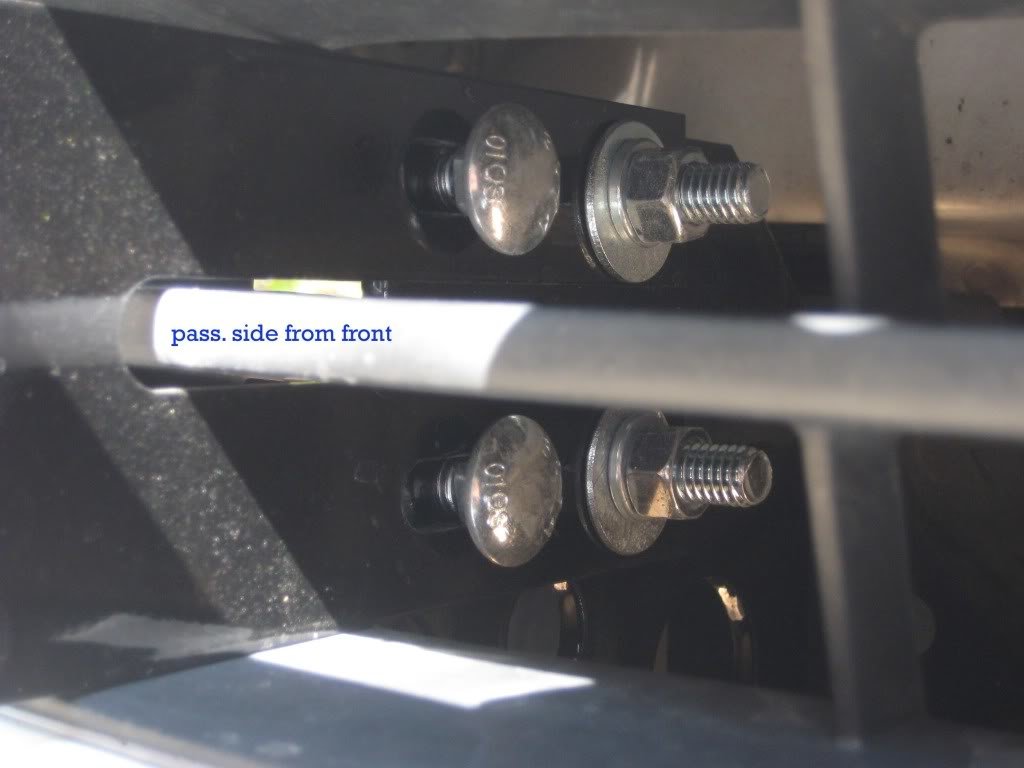

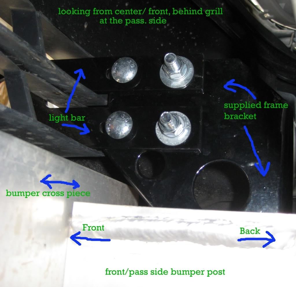

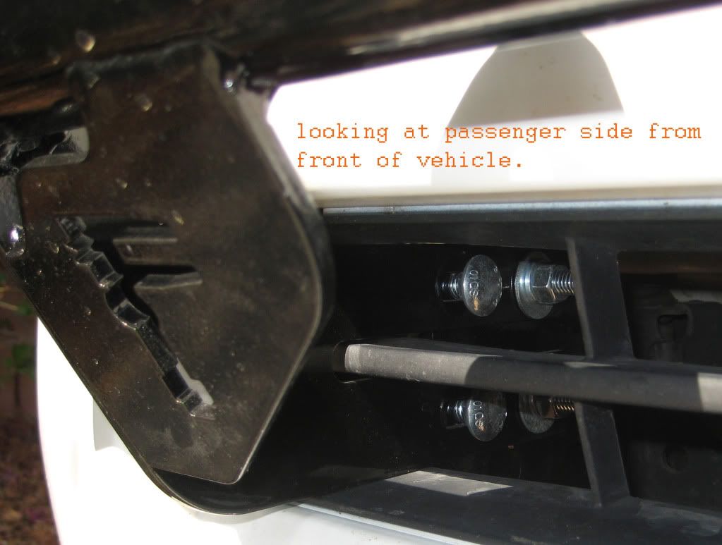

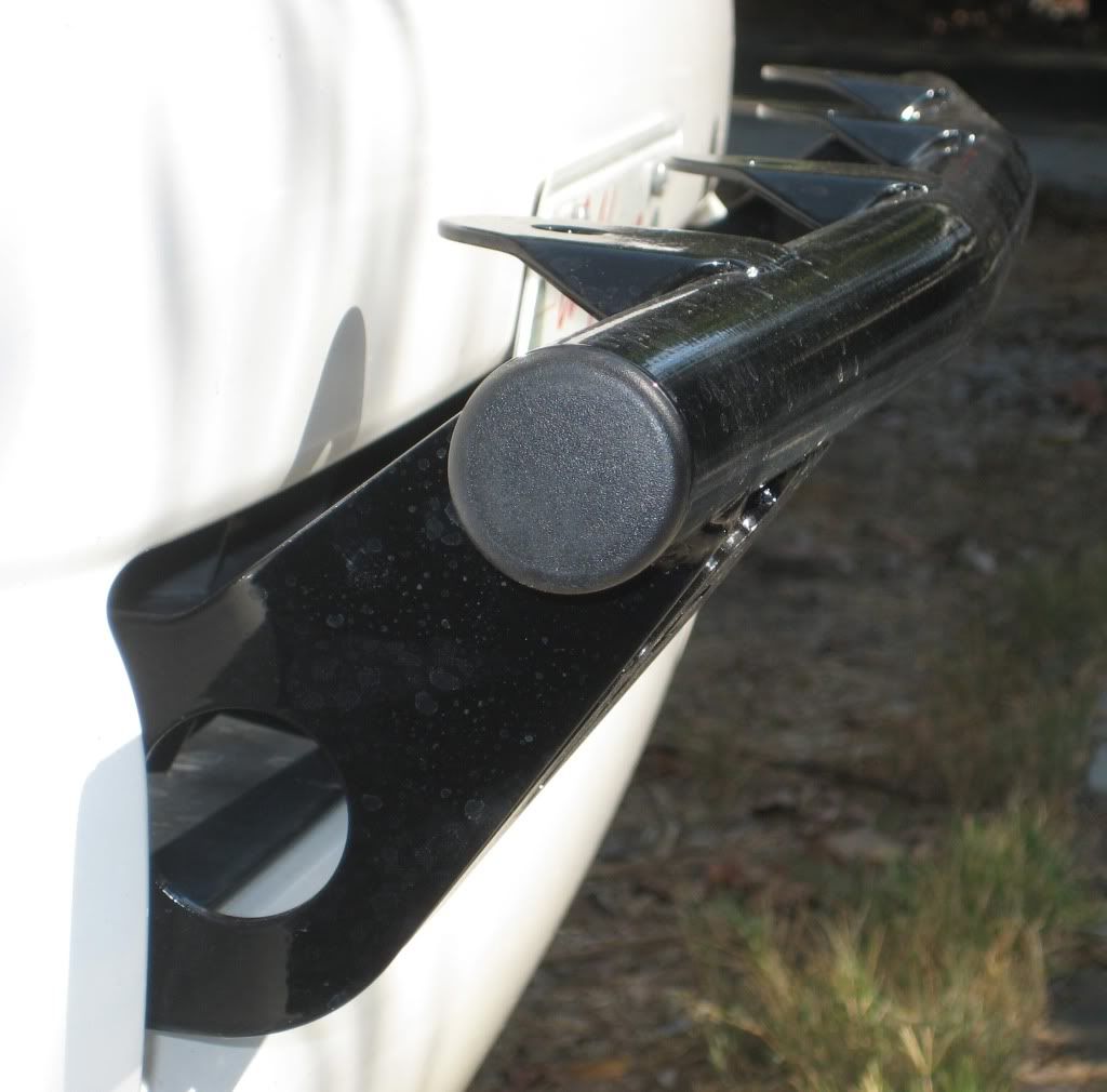

    I just installed the Fab Tech light bar for 2005 up Toyota Tacomas. Install was easy and took maybe 1 hour. A pair of ramps to drive your front wheels up onto make it easy. The supplied carraige bolts did NOT fit into the slotted holes on the brackets/ light bar. I will replace them with grade 8 hex bolts and add lock washers.
    The pics below should help new installers.
    Jesse

    Thats too bad about the carraige bolts. Luckly everything went very smooth with mine. Truck looks awesome Crooks420!

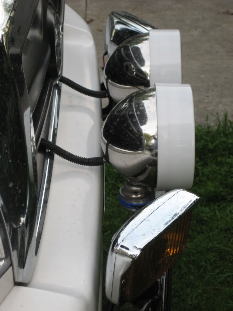

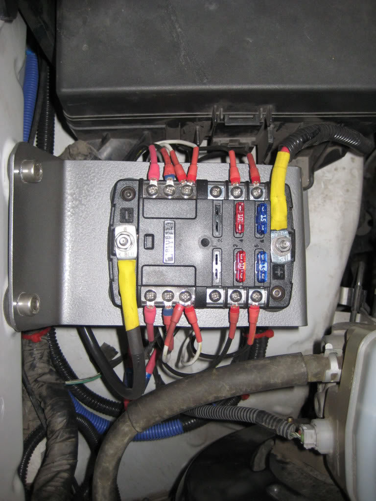

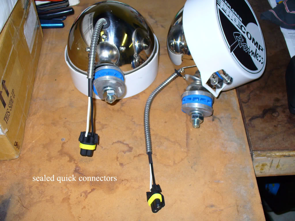

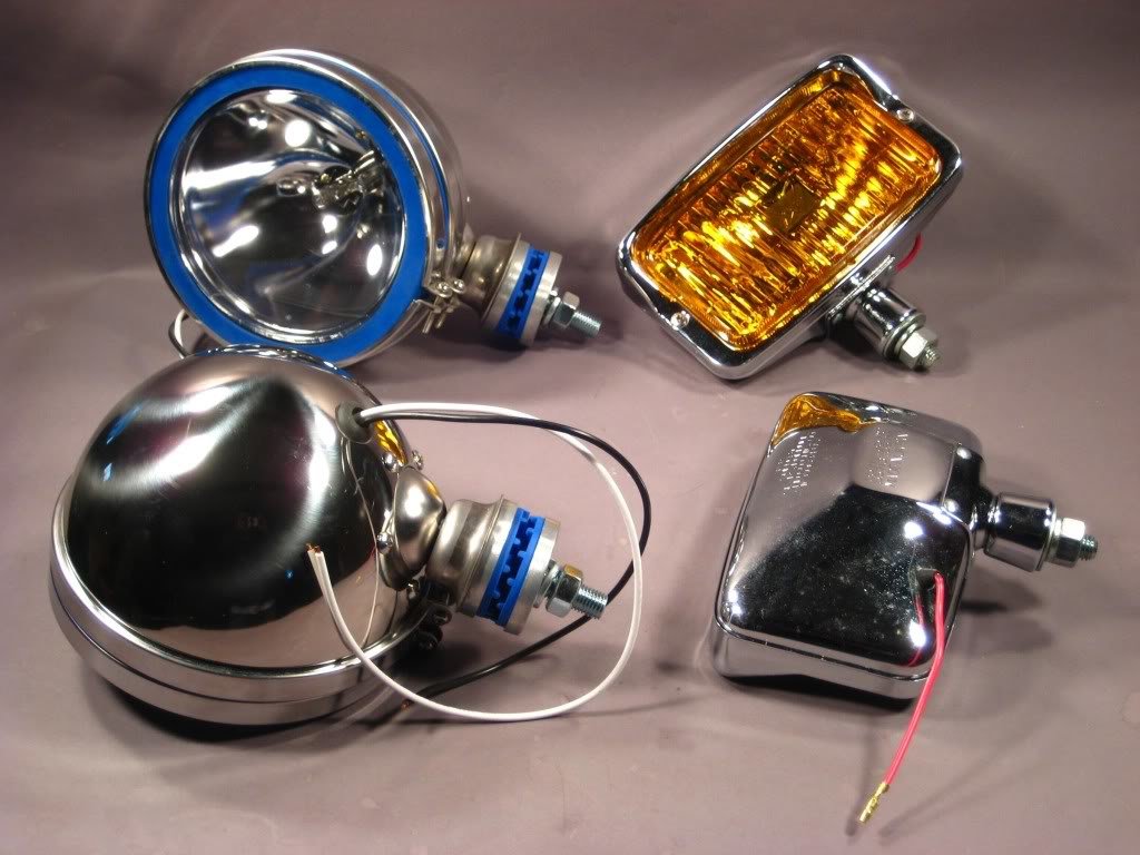

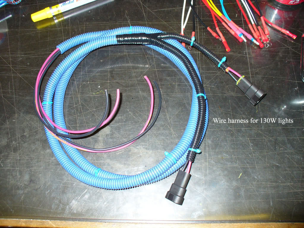

    I just need to put the lights on : Two old school SEARS chrome/amber fog lights, and two 130W 6" clear lens lights. I will post pics of eveything when I get it done...... aux. fuse block, relays, and factory fog light switches.

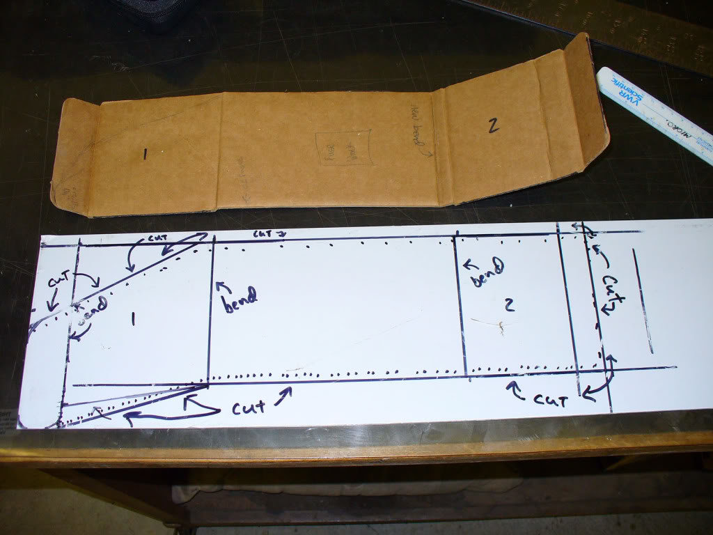

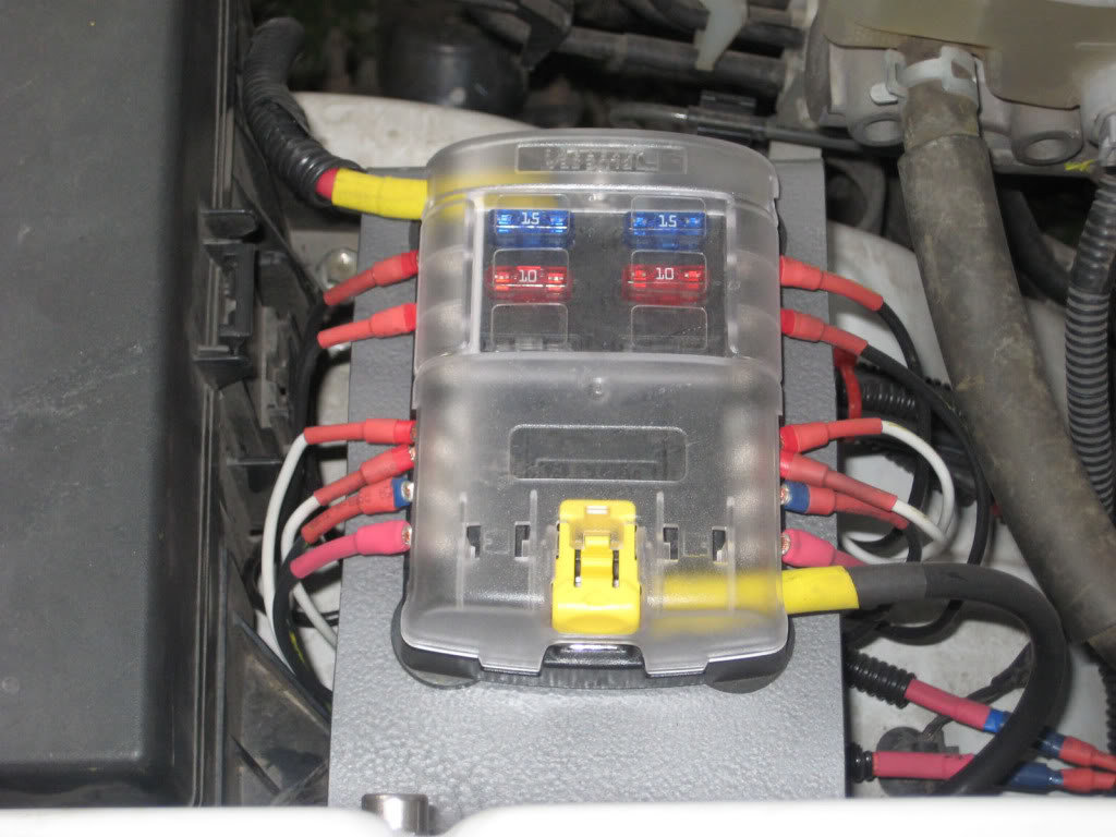

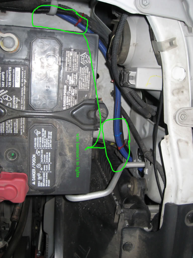

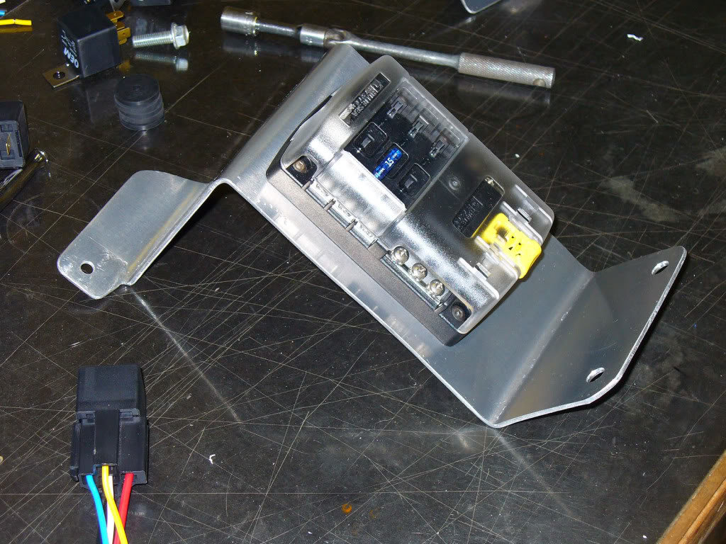

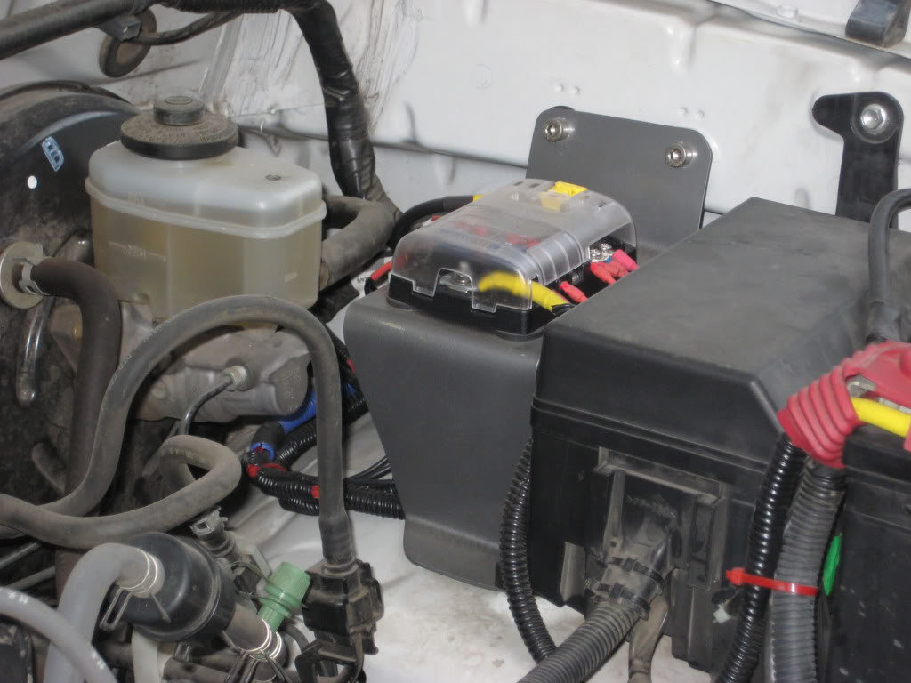

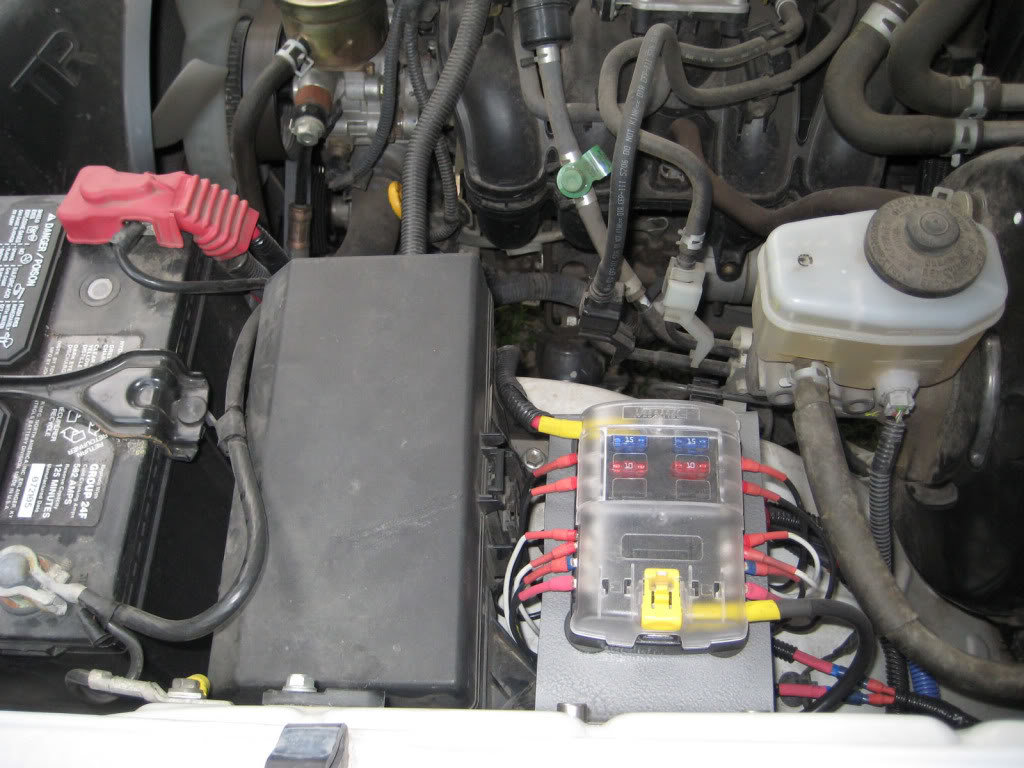

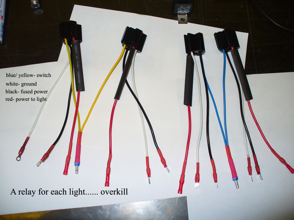

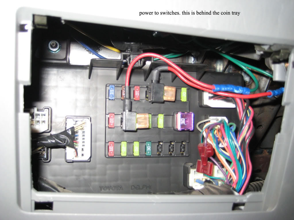

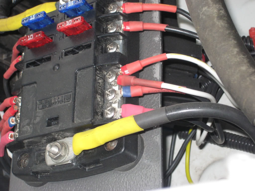

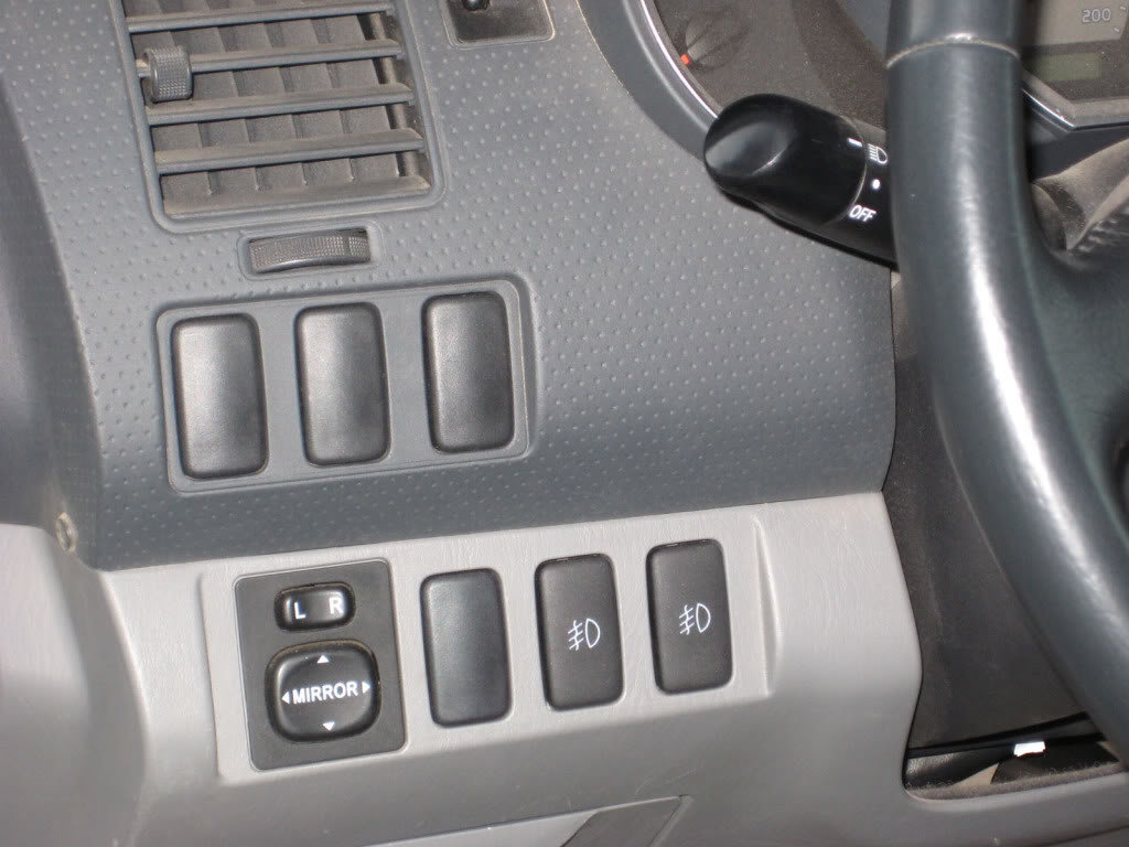

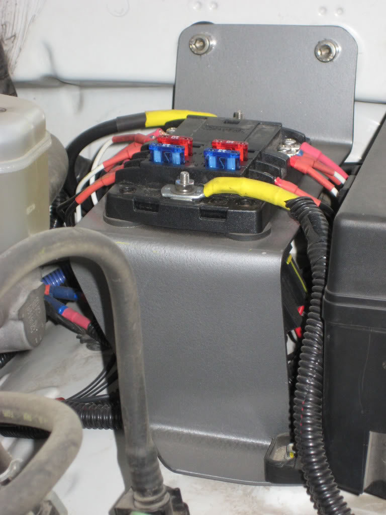

    I have had the lights installed and working for about a month now. Everything went as planned, and the factory switches work great and dim with the rest of the instrument panel. The hardest part was making my fuse block mounting bracket, and deciding where to put the relays so as to keep the wiring as clean as possible (underneath the fuse block bracket). I know, a relay for each light is a bit overkill, but why not....?

    My tabs point towards the grille. Great pictures at the top of the page.

    I know this thread is over a year old but my tabs are facing out. Just found this thread. I looks okay to me but why false advertise? The truck on there sight has them facing in.

    Just received my N-Fab light bar today very nice piece welds are clean and very well painted. Also the tabs are facing grill side (In) $118 Amazon
