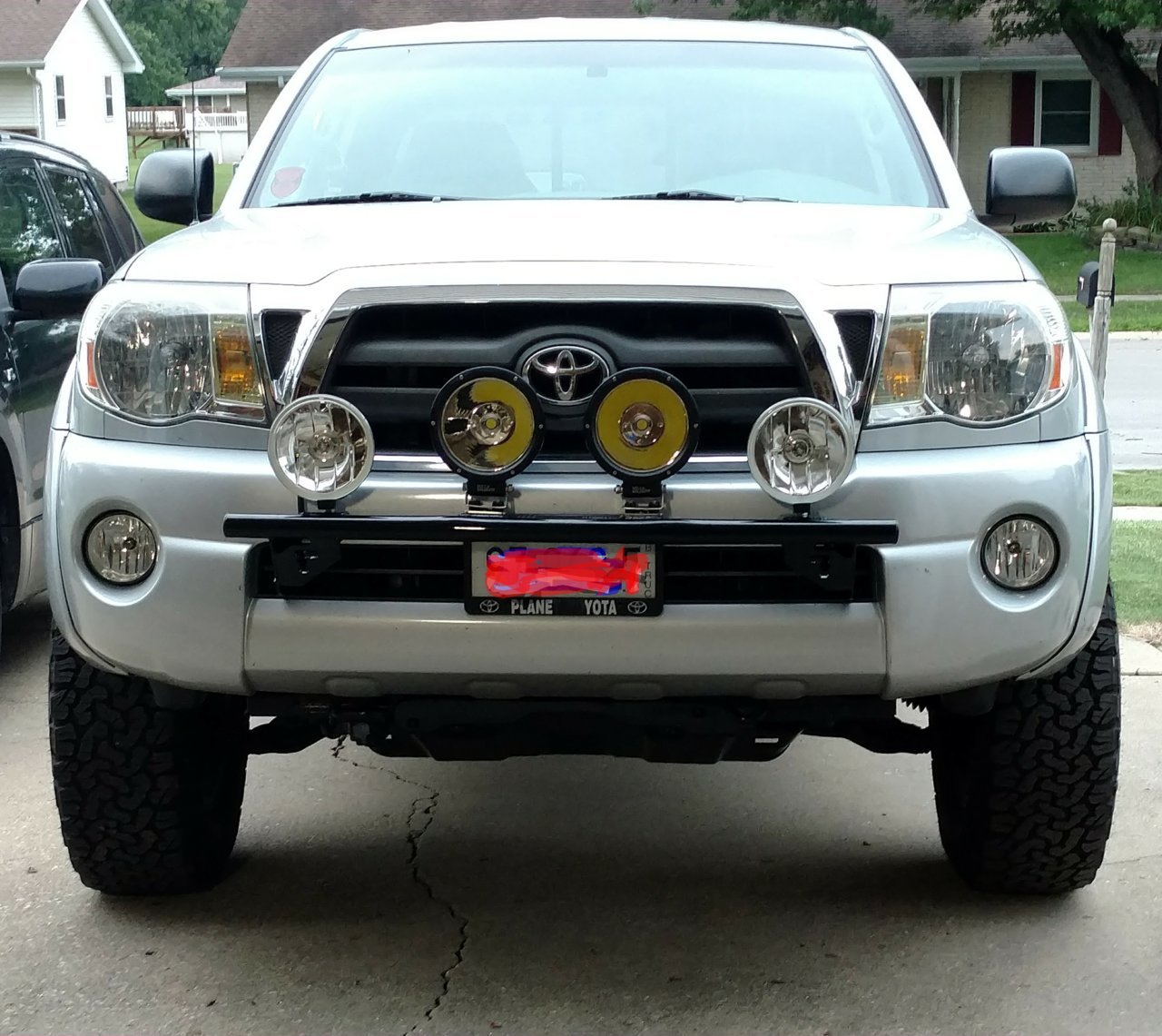

    Here's my 07 with it on.

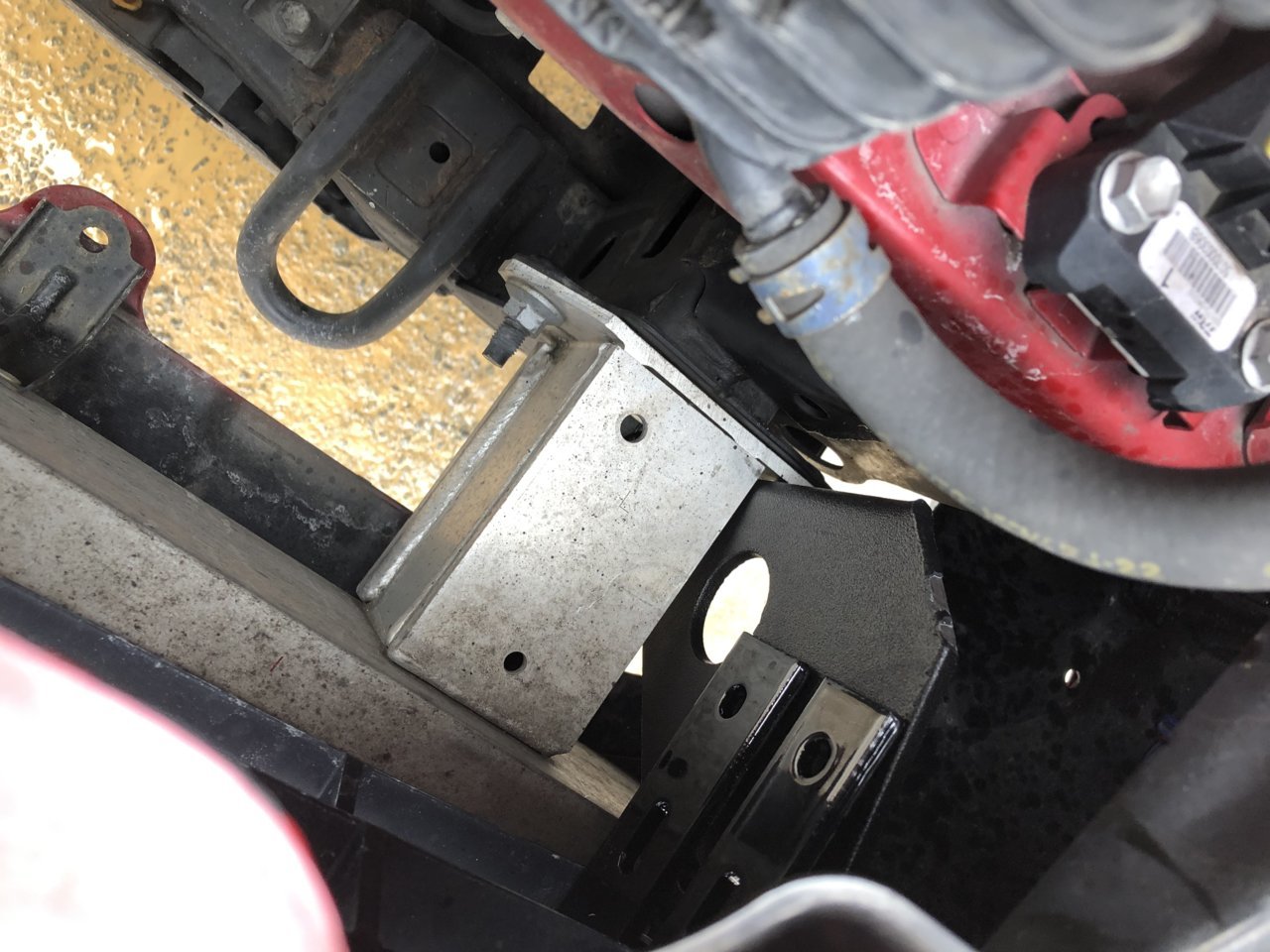

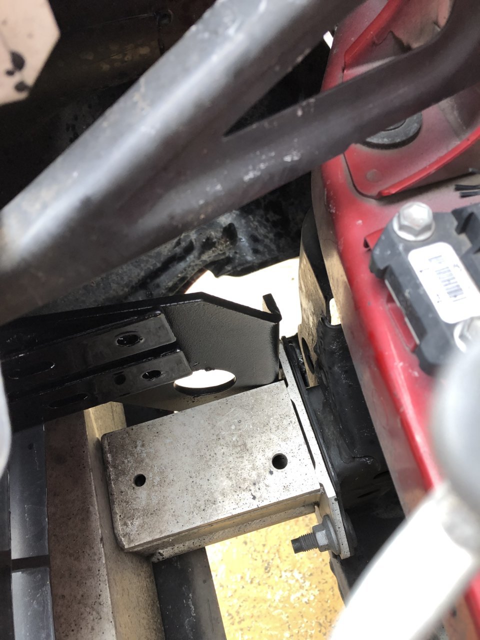

    I got mine installed. I ended up taking the grill off to make it easier. What I did notice is that the angle of the bracket fits opposite of what the directions say-unless the latter is just written horribly. The other big thing was that the 3/8 bolts supplied didn’t fit. I was able to hammer 4 out of 8 into position with minimal damage for the threads. However, I had to go to the store and get 5/16 bolts to finish the job.
    I do like this product a lot so far and the two Apollo pro lights look great.
    Here are pics of the brackets as I bolted them.
