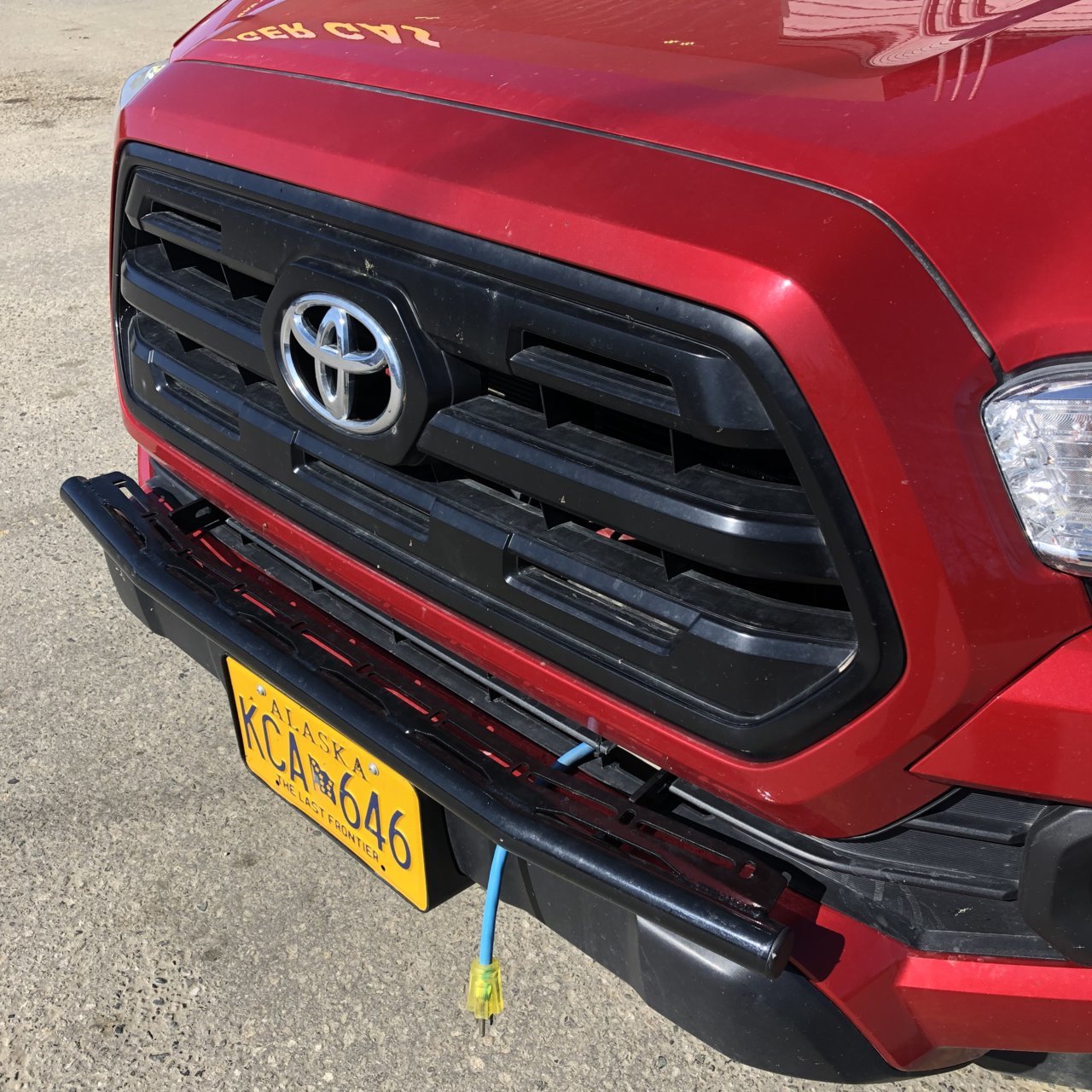

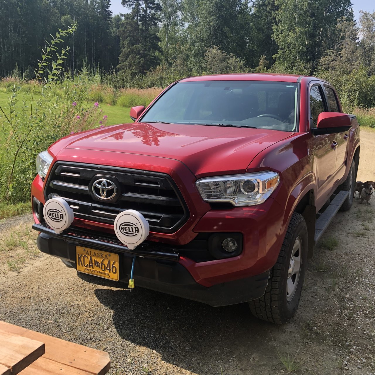

    No lights installed yet, but the bar is on and solid. I have the 163OLD version meant for small LED lights but I’ll be using Hella 700’s.
    I thought the install was pretty simple. Pull the grill, bolt on the brackets, cut the tab on the lower grill, and bolt it together. Took my about 2 hours. You’ll need a decently powerful drill for the self tapping screws that go in to the aluminum cross member. I used a 1/2” drive ratchet to tighten the bumper brackets back on.
    New the bars are $165 or so, I got mine from Amazon warehouse for $65 shipped prime. :)

    I’ll second following the @smugly instructions too. They’re very clearly written and definitely is nice to do less cutting. I used tin snips to trim my rad panels and cut the grill slats FYI.
    The directions are kinda wordy but it harder to describe it well compared to actually doing the install.

    That’s a very nice looking red!

    Light bars are better with lights. :)
