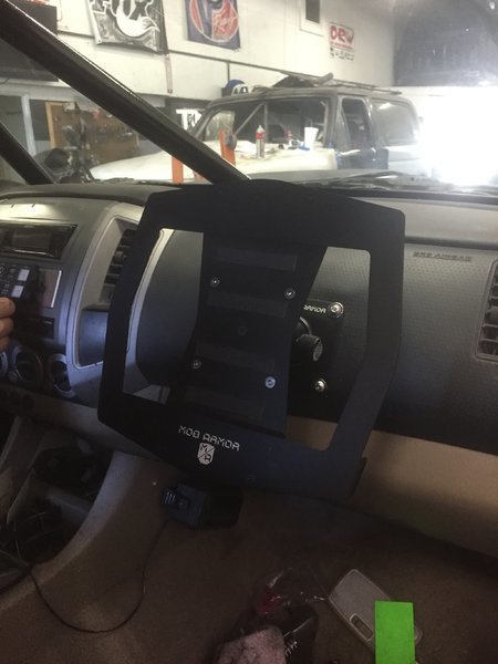

    Jun 22, 2011
    #58691
    7,530
    DFW

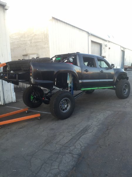

    She gone

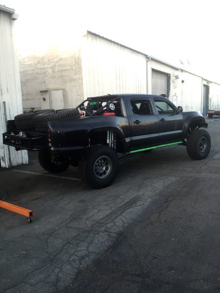

    Full Droop
    Ride height give or take a few since the fuel cell only has ~10 gallons out of 44 :rofl:

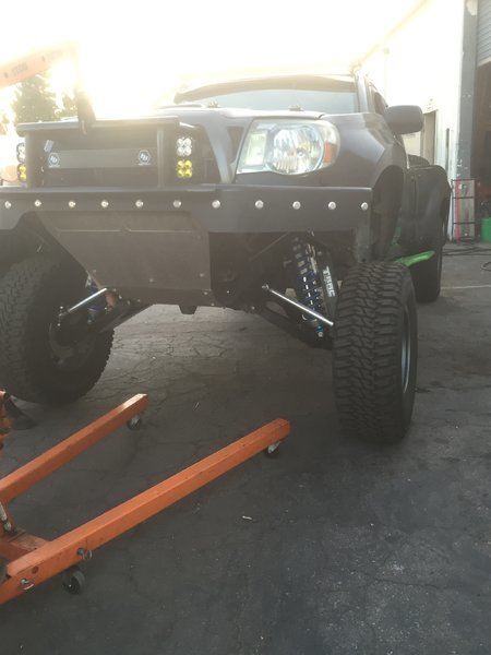

    Front full droop

    Yes
    What size springs did you end up using in the rear ?
    ChadsPride likes this.
  5. Jun 2, 2016 at 7:56 PM
    #845
    nfs257
    nfs257 [OP] Well-Known Member
    Jun 22, 2011
    #58691
    7,530
    DFW
    She gone
    Size or rate?
  6. Jun 2, 2016 at 7:57 PM
    #846
    nfs257
    Jun 22, 2011
    #58691
    7,530
    DFW
    She gone
    18" 500LBS SPRING
    14" 350LBS SPRING
  7. Jun 2, 2016 at 8:02 PM
    #847
    Jerez
    Jerez SoCal LED Dash Swap
    Feb 1, 2010
    #30488
    17,999
    Rod
    Ontario Ranch
    08 TRD 2wd converted to 4wd
    Estock
    Madre de dios...:eek:
    Jealous lol
    nfs257[OP] and ChadsPride like this.
  8. Jun 2, 2016 at 8:30 PM
    #848
    Evenflow
    Evenflow Well-Known Member
    Jul 15, 2013
    #108344
    5,766
    Jason
    San Diego, CA
    06' DCSB 4x4
    Yes
    Hmm interesting, it's hard to compare because the leverage ratio difference between my links and yours IE: short bed vs long bed etc but just looking at how much lighter the back of your truck is vs mine I think I need heavier springs. I'm at 400 over 450 and they are just barely preloaded a couple of turns to hold the rear end up level which is good but if I just sit on the tailgate it sags like 3 or 4 inches...rides like a 72' Caddy but no cargo capacity. I think I'm going to try 450 over 500, I have a full expo set up with camper shell, roof rack, plate bumper etc. I might swing by Trac and ask their opinion ...trying to balance cargo capacity, ride quality and performance is a bitch :/

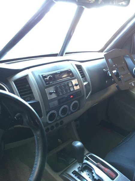

  15. Jun 3, 2016 at 1:06 PM
    #855
    XPOTRPR
    XPOTRPR CNC Programmer/Machinist
    May 29, 2011
    #57449
    31,171
    Josh
    Chandler, AZ
    > BUILD LINKS >
    is that a switchpro I see over there too? :)
  16. Jun 3, 2016 at 3:20 PM
    #856
    nfs257
    Jun 22, 2011
    #58691
    7,530
    DFW
    She gone
    Sure is lol
  17. Jun 3, 2016 at 6:00 PM
    #857
    XPOTRPR
    May 29, 2011
    #57449
    31,171
    Josh
    Chandler, AZ
    > BUILD LINKS >
    :spy: where you mounting it? i happen to know a guy with flush mounts...
    Crom, ChadsPride and 4Running Daily like this.
  18. Jun 3, 2016 at 7:55 PM
    #858
    nfs257
    Jun 22, 2011
    #58691
    7,530
    DFW
    She gone
    Didn't know how water proof it was....
  19. Jun 3, 2016 at 8:09 PM
    #859
    XPOTRPR
    May 29, 2011
    #57449
    31,171
    Josh
    Chandler, AZ
    > BUILD LINKS >
    Totally fine. But.. Even in that spot you could probably make it flush.
  20. Jun 3, 2016 at 8:14 PM
    #860
    nfs257
    Jun 22, 2011
    #58691
    7,530
    DFW
    She gone
    It's was just a smidge too big to fit inside hat spot. Had to fit on the outside. But what's around yours?
