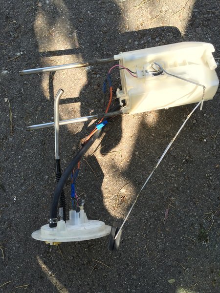

    Fuel pump self destructed and bladder got pulled in. Hope the bladder isn't torn or punctured.

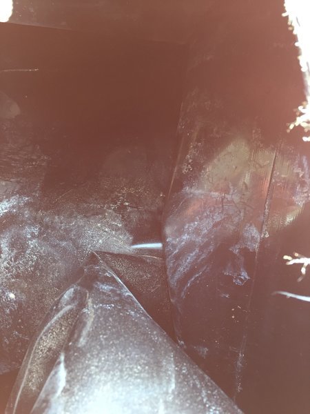

    So the fuel system is closed loop with the only bent being in the charcoal canister. It vents back to the engine. The fuel pump sucked the semi solid bladder in on itself until gas gauge wouldn't work. Then it also snapped the fuel pump assembly in half.
    So come to find out the bladder is almost inside out and there is no fuel even though I thought there was at least 1/2 a tank. :oops:
