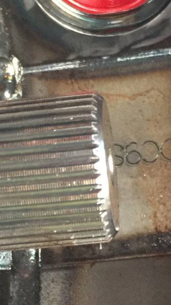

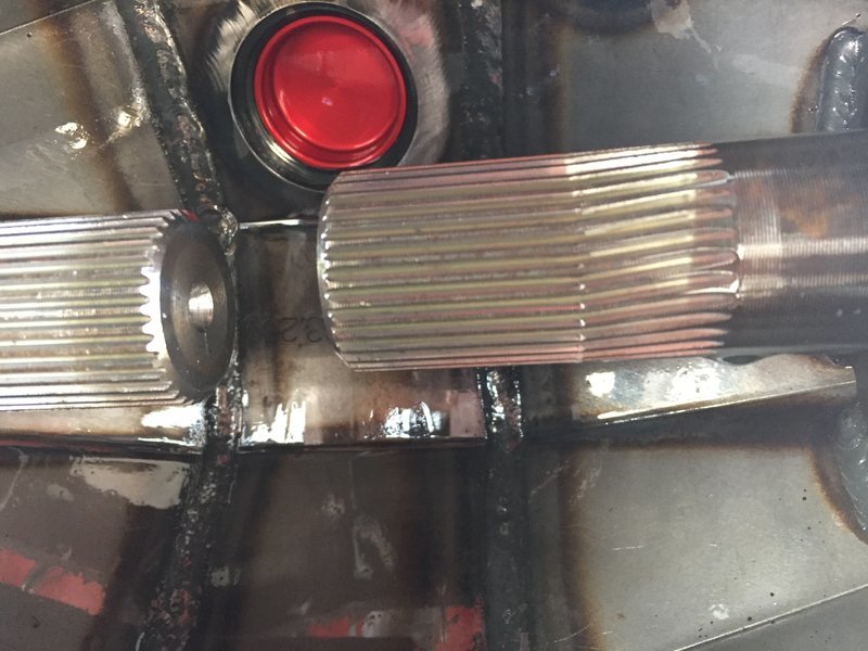

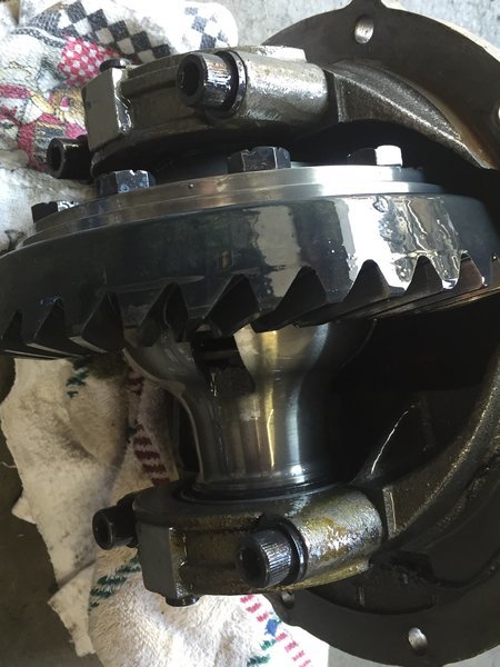

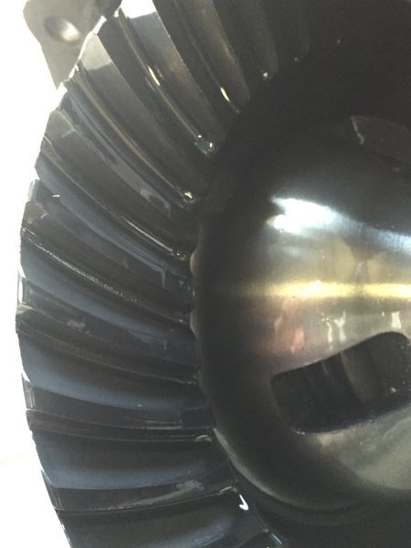

    Detroit locker gave out and put power to only one wheel.
    Gears still look ok.
    But axle is a little twisted lol
    All Currie 9" 35 spline stuff.

  5. Jun 30, 2016 at 10:27 PM

    4Running Daily
    4Running Daily Long Live ZS
    Mar 25, 2012
    #75625
    8,702
    Connor
    Tempe/San Diego
    1996 Toyota 4Runner
    Well that was fast

    Solo motorsports XLT LT, foxshox
    Wtf no luck huh? Never thought a 35 spline would twist from a v6.

    Was everything broken in or does that even matter?

    @06HAOLE not sure what's broke in the locker yet. I didn't know what I was looking at so I didn't take it apart lol

    A real man wouldn't let that stop him from tearing into something...:boink:

    Hahaha it says right on it contents are spring loaded lol

    Ok so Currie says that the longer of the 2 axles should have been on the passenger side not the drivers side like most 9" axles. I snapped the splines inside the Detroit.
    The passenger axle was only engaged
    The drivers side was
    Currie said it was a simple mistake and even though it was my fault and not theirs they covered 2 new axles and the bearing for both sides. As well as a new Detroit locker and they rebuilt everything. And are gonna cover shipping back to the shop and rushed it so I can go to the night race in Barstow the 16th.

    Wow! That's outstanding support! :cheers:

    They have been nothing but the best in customer support... Very down to earth and humble also. The 2 gentleman that were helping introduced themselves as Ray and Jon, took me through how everything works together and pulled it apart in front of me. Once I was leaving they grabbed a handful of business cards and I found out that they were Ray and Jon CURRIE.... lol
