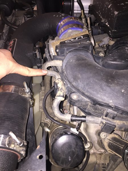

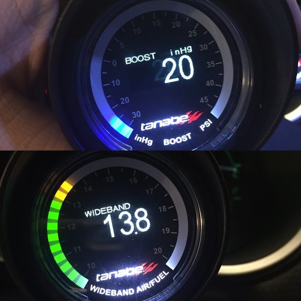

    So where does the URD setup and my boost gauge get together?
    Here?
    Other end of this T goes here:
    and the 2 bigger hoses go to the air box and the discharge side of the SC...

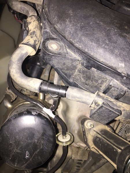

    Thanks @Torspd for the help
    He says put boost gauge "T" here:

    Pre-TB boost, is why I had to get a vacuum distribution block. It gets worse with a turbo and map sensor reading ecu. :annoyed:

    The T fitting that came with the boost gauge and the clear tubing were def hard to get to work together but I got it done.

    I could here just the slightest change in emgine noise, as the AFR's oscillated. Keep the updates coming when you get a response.

    hows the filter look? probably a dumb question since it was just installed.
    reason is when mine gets dirty/clogged.. it seems to idle a little weird and fluctuate like that. not that much, but similar.

    Does the afr swing tighten up driving slow?

    Brand new lol
    With cruise set at 60mph the AFR is right around 14.5-.7

    So weird thing today while playing in the desert the truck was running around 10 in/HG and the AFR kept hitting 10.0 and staying there but when in boost it was 10.8-11.3 the whole time... Kinda confusing to both Vance and I. We checked air filter. Next thing is the MAF sensor and also swapping the stock Throttle body back in due to the RPM fluctuations.

    What did Gadget say?
