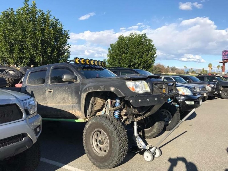

    Cool, get a couple 2x4s and it would prolly work for a tire change

    The jack wasn't all the way up lol it would easily lift the whole front end of the ground.

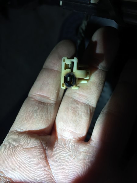

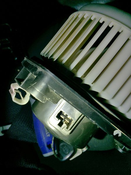

    @Evenflow and @Crom or anybody else....
    Any input on whats going on with my A/C Blower? I took it out and used the air hose and blew it out. Then plugged it back in while in my hand and it runs on all 4 speeds. Re-installed it and it won't work on any speed now. Pulled it back out and still won't work.
    Looks like there may have been a short at one point...
    But the fan plug looks good.
    Should I just order a new fan? Im stumped...

    Its been going in and out for a while now and the popular consensus was dirt build up lol It wasn't working so I pulled it to clean it and now not working again lol

    That plug burning is very common issue from what I remember. Id replace with new harness. Part number 82141-04M40
    The fan not working is probably because of loose wire causing open condition is my guess.

    Thats the resistor wiring
    i will wiggle the plug and try it again

    I've read about that a bunch too, I would definitely start with just replacing the harness and see if the motor is still ok
