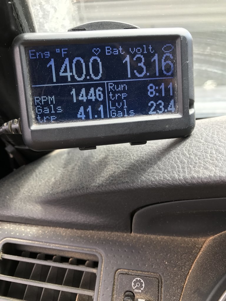

    Either you have a current draw from somewhere, or a bad battery.

    I disconnected all the aftermarket lights at the breaker. Only thing left is the URD computer.... Thoughts?
    Im betting bad battery

    Brand new battery. Is there a way to test the alternator at home?

    Yes
    you just did ... should be at least high 13's while running amigo

    Wonder if it's the wiring or actual alternator.

    If you have a multimeter you could check the output voltage right at the alternator to confirm

    You can rev your engine 2000-3000 rpms and see if the battery voltage goes up if it does the alternator is good if it doesn't then you have a bad alternator

    It goes up to almost 14v

    Mine performs similarly. It is barely 3 years old.

    It should be 14.0+ you could take it to any auto zone or o Riley's store and they can test your battery and alternator for free.
