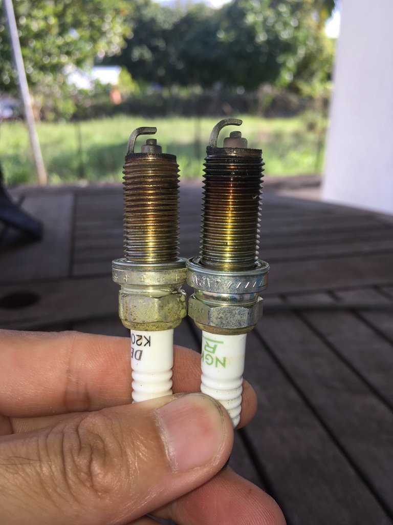

    Hello,
    I just changed all my spark plugs on my TRD Sport V6 and knew there will be Denso and NGK on each side.
    However did you noticed that the NGK ones were in less better shape than the Denso? I looked at them and the NGK were darker, had a bigger gap than the Denso...
    Glad I went with 6 Denso K20HR-U11 for the new ones

    How many miles on your truck? I noticed the same thing on mine, '05 TRD Sport MT, changed the plugs at 92.5k (right after I bought it). I put in 6 new Denso also... The old plugs were at .065-.090, new gapped at .043. Didn't feel any difference in drivability. :confused:

    I changed mine out at a little over 30k. I replaced them with Denso since that seemed to be the consensus here. IF I remember correctly, I think my NGK's were in a little better shape.
    I didn't notice any difference after the change either.

    I noticed the same on mine. Changed at 33,000, and ngk's were all out of spec. Denso's were still within spec.

    Yep NGK were worse, but I didn't notice anything better on drivability with the 6 new Denso

    yup this is pretty typical of the standard plugs in the 1GR as far as NGK vs denso.... its funny cus its just the opposite with the 1st gen taco v6, NGK's were always preferred as they wore much better than the densos.
