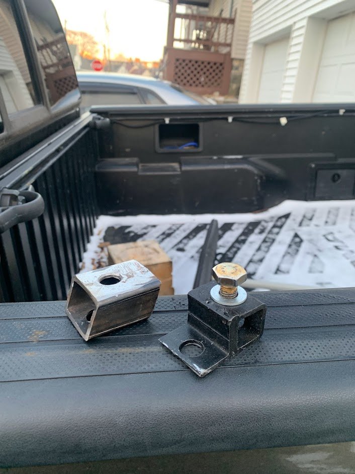

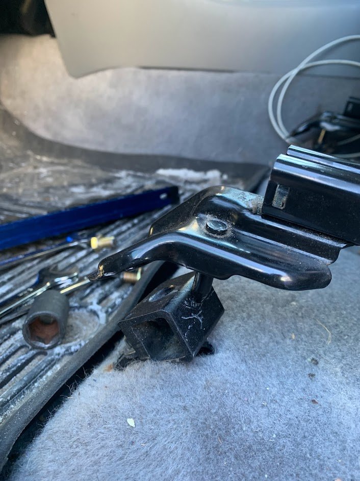

    3D printed cupholder and trailer plug relocate
    When looking at the truck at the dealer I saw how low the trailer plug stuck down just asking to be torn off. I designed up this bracket and printed it out of PETG.
    rodcEc29d9UB_VZlzuLAp2i1vDrc9twQGVfORsjE_1e0acd77af8d947dba525b086ac3bb56a8fc356c.jpgEMe39TDWrjlRB2NoJzXxtnUhjpP_aQrV-u4PH_mL_ef1ffa23890b9747ddc3011c9feaf881d8ef83a3.jpg
    After I removed the ladder racks that came with the truck I immediately noticed the annoying cupholders. I designed one up and printed it out of PETG. It doesn't fit quite perfectly but it is good enough so it has been in my truck ever sense. I tried the tree supports in Cura for whatever reason.
    jPBNjFa4o9FQNv1NMs9Ug6DpNgm9GS5yjuVDXPuH_6c0e29b971910c261097e4db894140eef2393543.jpg

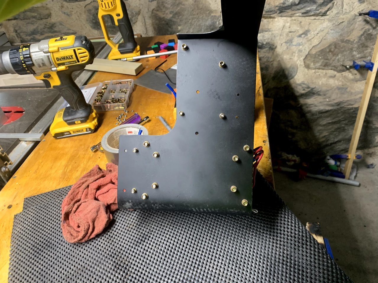

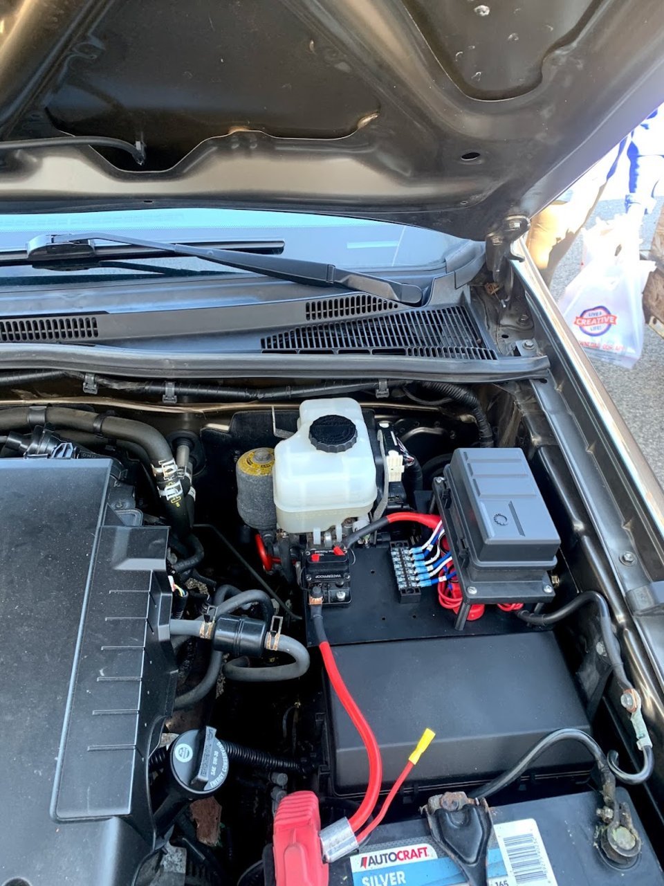

    DIY Electrical System
    qDfRU5KsjYZg51Kve8a8DI38j51zKv369DqpHNvJ_5037d0b93a2ca95976f48a931618ccfbb8e14f05.jpg

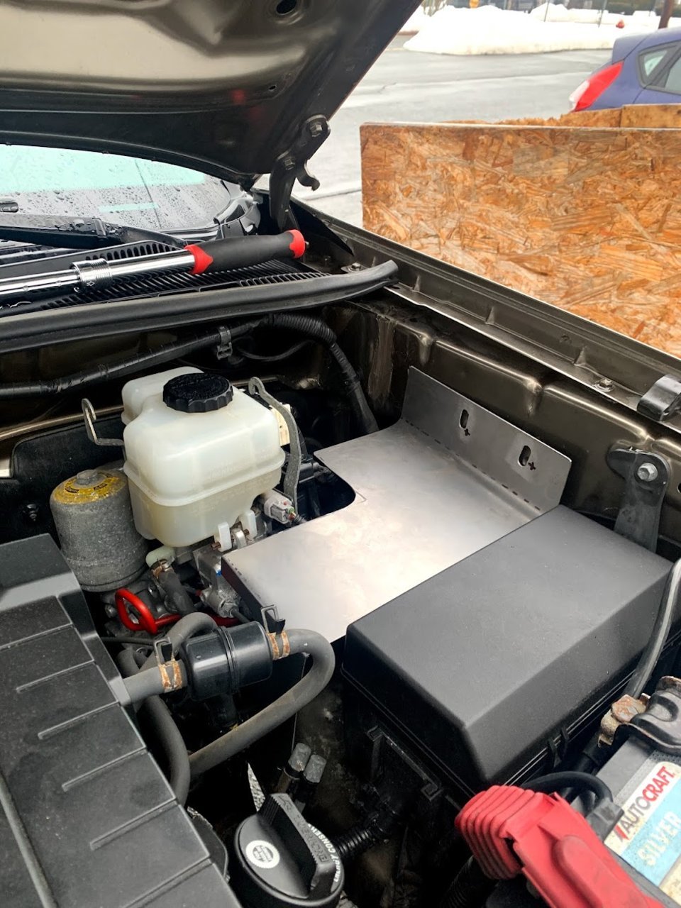

    I wanted to be able to add in accessories pretty easily without having to do lots of wiring and taking apart the interior. I started off by selecting a fuse/relay box off of Amazon. The one I selected was waterproof and when it came in it all seemed to be decently constructed for the price. I also put a quality 100A circuit breaker between al the electrical work I did and the battery. There are 5 switches prewired that I put into the sunglass holder and ran the wires down the drivers A pillar and through convenient hole in the firewall.
    Next I made a cardboard template and make it fit well then made the part out of 16 guage steel sheet. I do not have a sheet metal brake so the bends where made in a simple woodworking vise and some leverage.
    9BBsn3lORi3SZWZ5Q3bkpHkYDTzrJYL9OlcaykuZ_4b22c7fb358b20338a41e0c6a199044688820a66.jpg
    I mounted everything using rivnuts so there would be no hardware that could fall off the back, great application for these fasteners.
    -jzUUryL1m10XLHguWmE3j7H_iD9-Js2wFTJlG3P_bcfd9bf8f244678f5733e1f3ecdac21f0e29299c.jpg

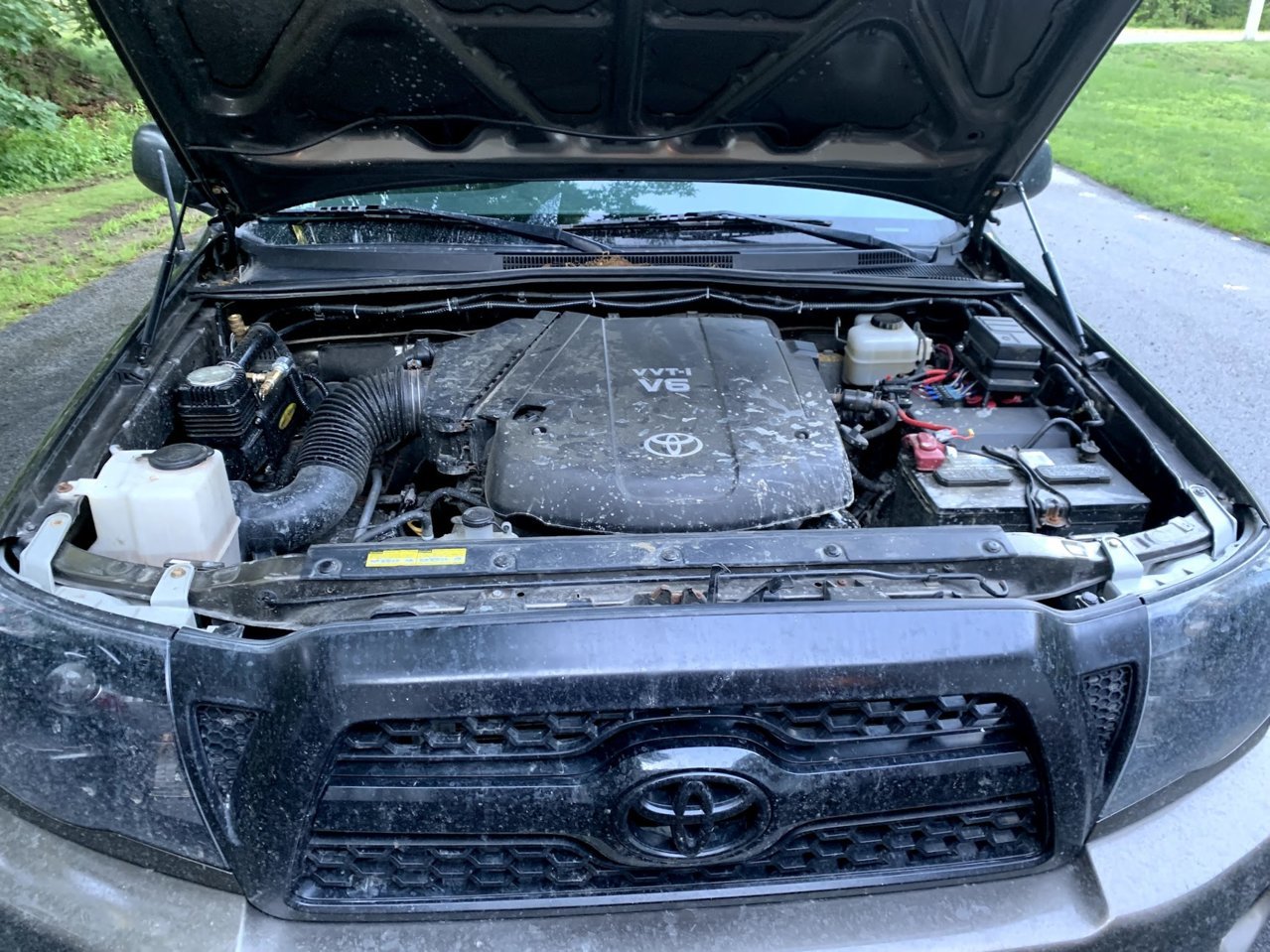

    I later added a smittybuilt 2781 under the hood (writeup to come) and I connected that to the circuit breaker also.
    Ni8r39v22muawlBPc_NyNuWZwjNrVG9jV9rf7sYz_490930f2f7f39daee04eb96a70a27fb57845c8f7.jpg

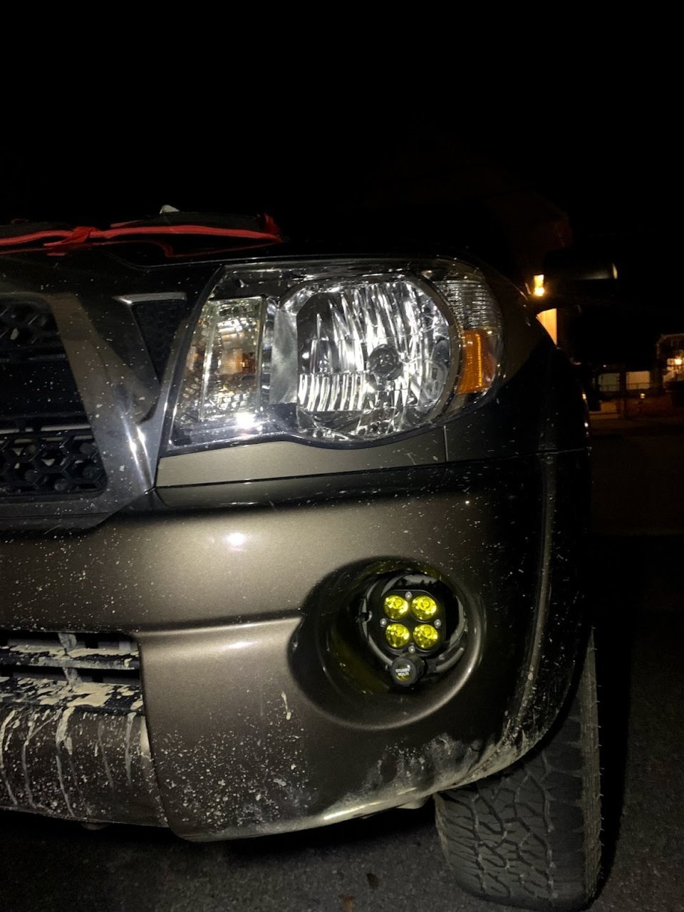

    Carplay headunit and fog light install
    For the headunit it was pretty straightforward, just order the headunit, dash kit, and wiring adapter off of Amazon then just put it all together. There are plenty of writeups on this.
    C_4NJBtYCUmVec6CAkHDbf0sRLeuIKLKemTgqWGl_ed336af8b28d60cf9e1cfd433887eef18cf5aada.jpg

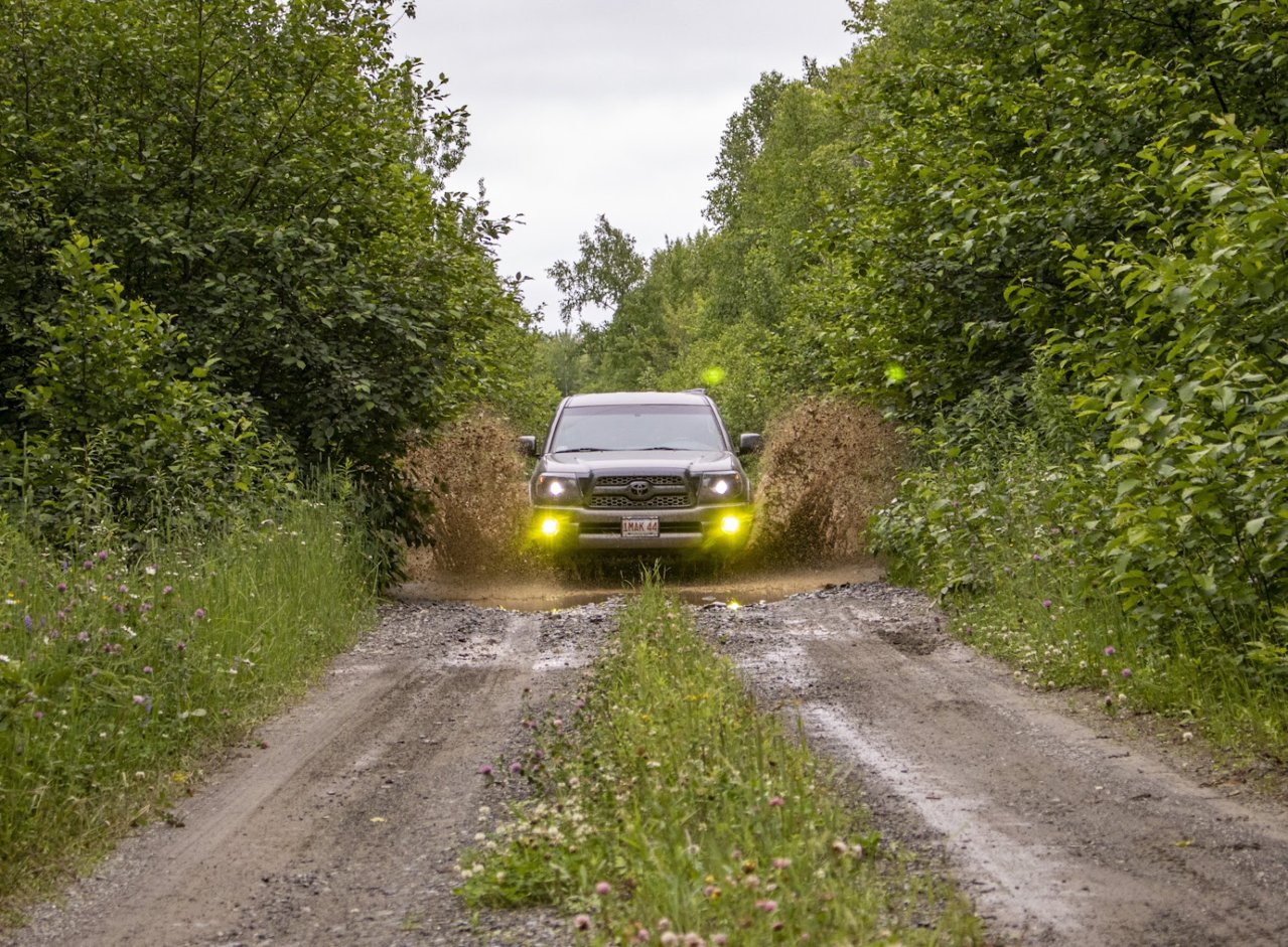

    I greatly prefer amber fogs so I put some amazon cheapies down there. I 3D printed some bezzles that are still holding up great. I used black PETG and left it without any additional finish.
    CP9fQtsql5NPb_iM7FERqjFiaRk9wVd-HOiqVXyu_69da2f5d1883082bdbdfa627c3b88a5a37c8184f.jpg
    HDAaRaiftHxCesvWmxSbTDW3Dv1JXkNzEMr62Iek_ffba0ac33b16222113457f2b70aa050a0420308c.jpg

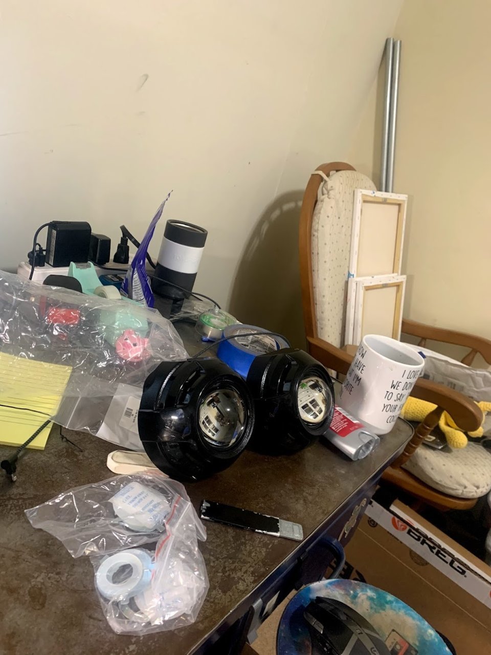

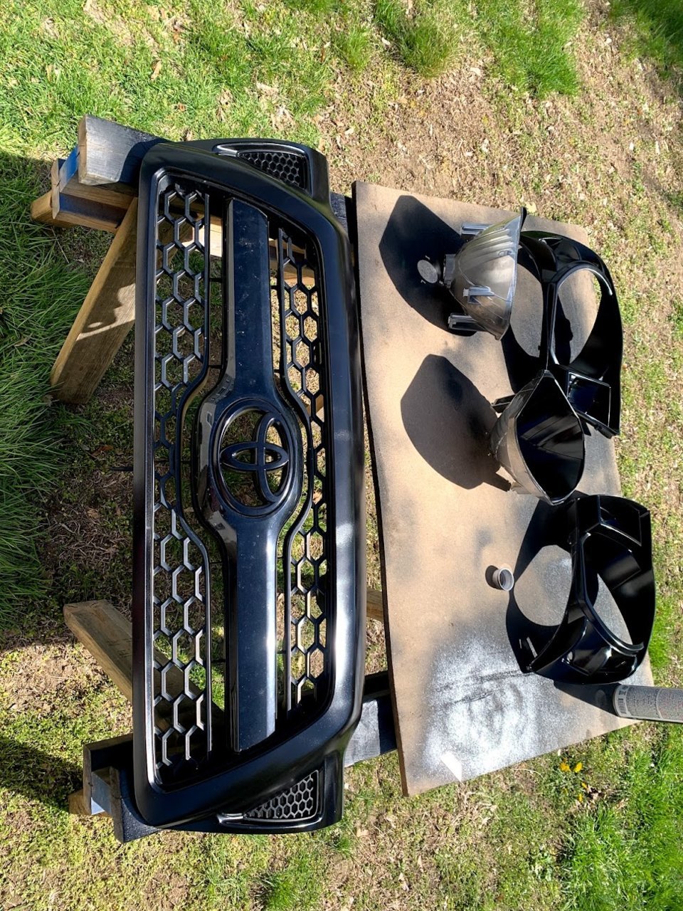

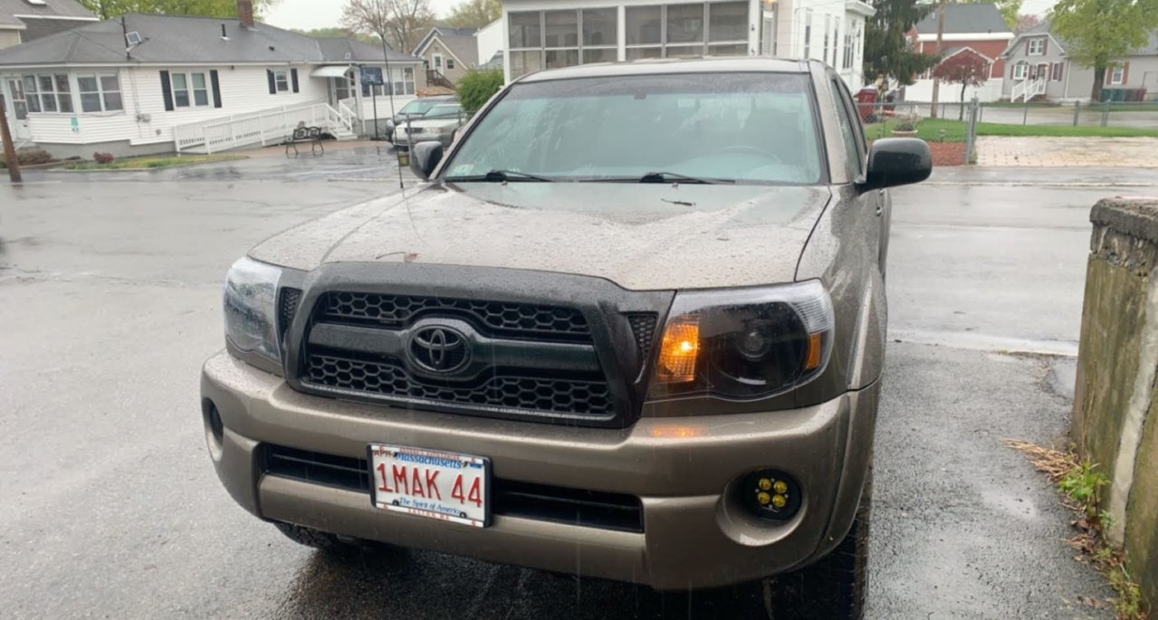

    Retrofit Headlights
    Most of our trips we get off the pavement after dark on Friday nights and we immediately noticed more light was needed. I purchased parts from theretrofitsource.com and got a second set of faded headlights to use while I retrofitted my stock ones. As long as you have some mechanical skill this is not an extremely difficult process, there are much better writeups and videos that you can reference.
    _kW_4rJrBjWSYwjLGnBuhV3Gh2sq9FOJSaPdcshj_23ae46c2a0c9bd109d7253a8a7c1d4ba733c7c1c.jpg
    gjfUcioGsTkJdOeIUVDROv60YoEPgX5BkVpm8Zs8_e36a3e63b6475c81f497154739c3948fbb44aceb.jpg
    DvXfStCFcuyh5d1LxMQ0YbtSccVO8edFqb8obVK3_e4c545d6ff195d114970487385bbe3c63e146913.jpg

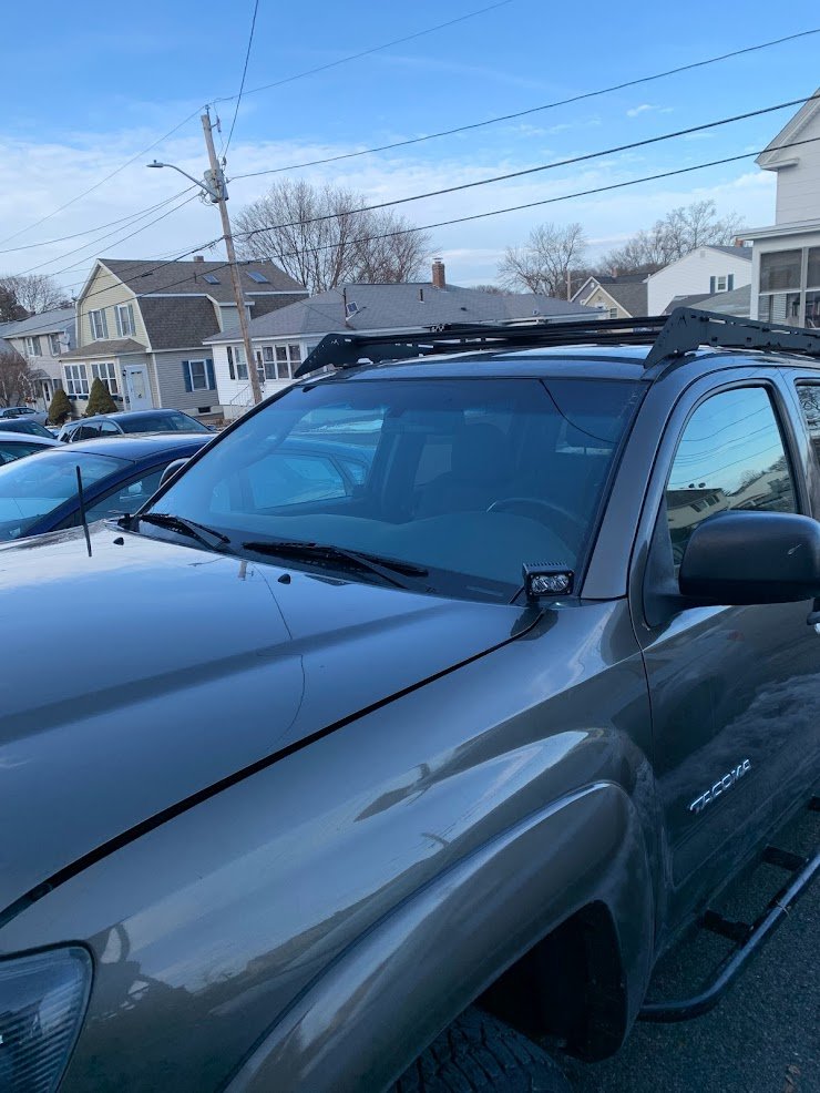

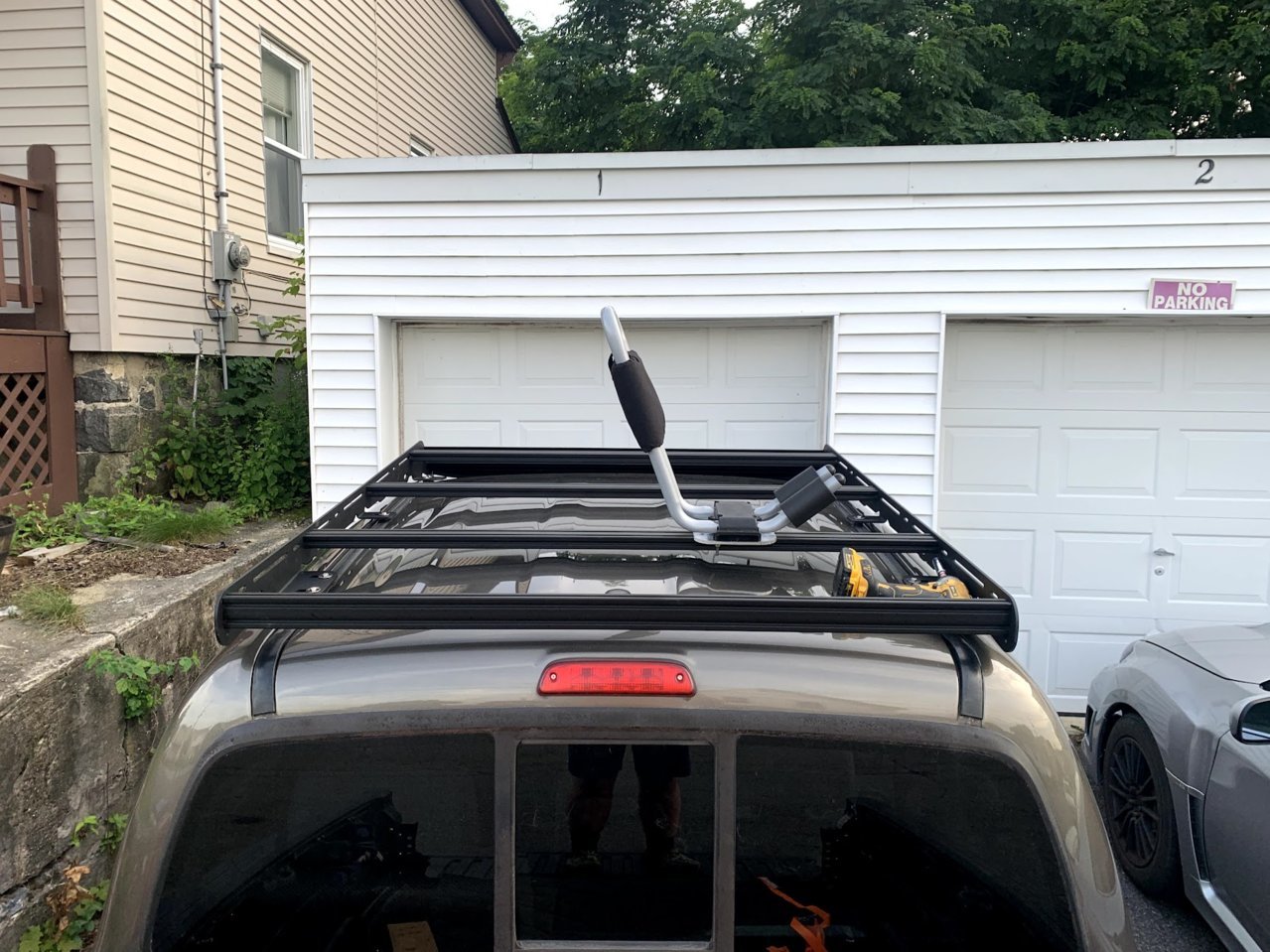

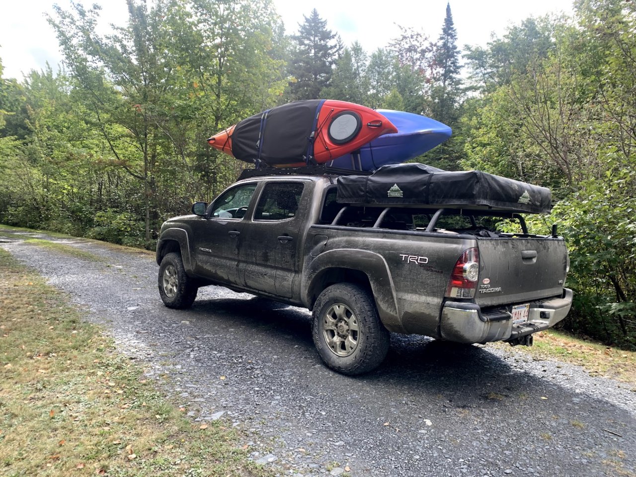

    Roofrack and kayaks
    Most of our trips now involve bringing the kayaks. The foundation of this is the Marin Offroad rack which has been great. Great rack, powder coating, and customer service. The used kayaks she bought came with some j bar racks. I attached these to some 1/4 aluminum plates and used some drop in t bolt studs and nylock nuts to go from the aluminum extrusion to the kayak rack. Using nylocks and drop in studs I believe is the best way to attach things to aluminum extrusion racks because the hardware always stays with your accessory your trying to attach. I also am attempting to design a better way to deal with the kayaks while on the road.
    ayJnRojMjjfQzUwGxK4goKJHVk_7UDa_T1__wCSl_93dbbd546b4de3e62f5b9fb436f3fff00c8b9c1d.jpg
    SC3wyVzo6_HDLGjpTmKrLst3BktPU0cgVq13ZjE4_e320281f806364d321ab9ed2fd8c7fb3bccb0357.jpg
    _N-oretV33UQty6oetxf7okkuqSXM3Zllv9jNz-Z_d8ea6e2c63f923af40d36cb7e2f250115ed7e6b3.jpg

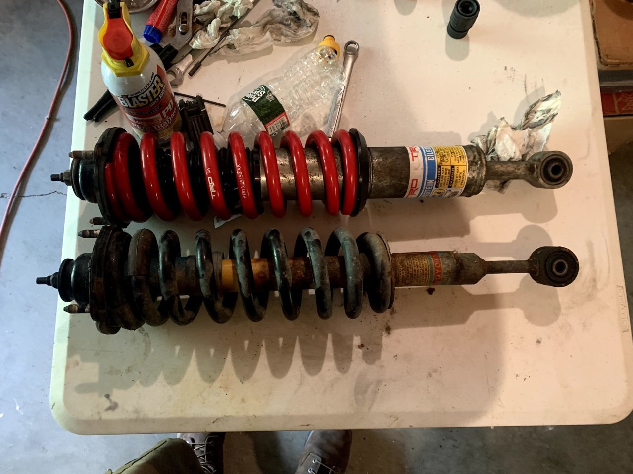

    Suspension
    When I got the truck it was on the original suspension so I went looking for 3rd gen trd offroad takeoff suspension. In a local group someone offered 2015 trd pro suspension to me that had 20k miles on it for a price that was too good. A few weeks later, before the install I broke a leafspring in the back so it was time to replace all the suspension. The install was pretty straightforward using the complete trd pro suspension, U bolt flip, add a leaf, and wheelers superbumps.
    GBA3NzpRPCAIwuZYap1p-Ni7jJ9sLeyG0iVpqBjP_a9b57439e661a600f8539f76acb87ecb0c2bf056.jpg
    Before
    uFaZWHZBA5akIXTdjaFoU3ANrKAhYDNaPT260nv9_02ea82d80ef8c3d3391bb4fce5ddf96a377a3649.jpg
    After with more weight
    KR0TRp4FkZRT3_KJk6qXmRG57TB-ULKhDQRygC7T_e8e9cbe65e998c1a9524d97984725451ebc30a6e.jpg

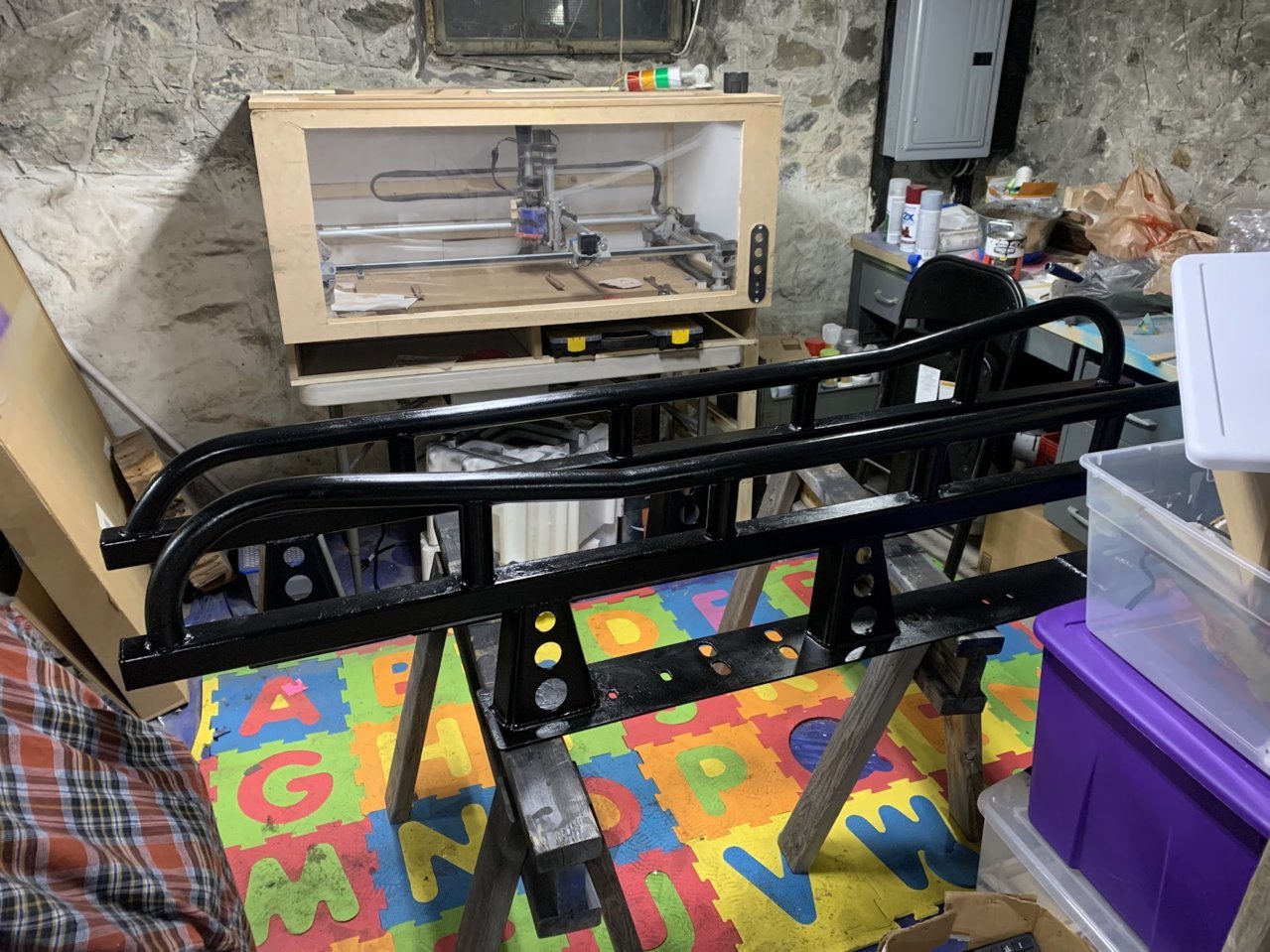

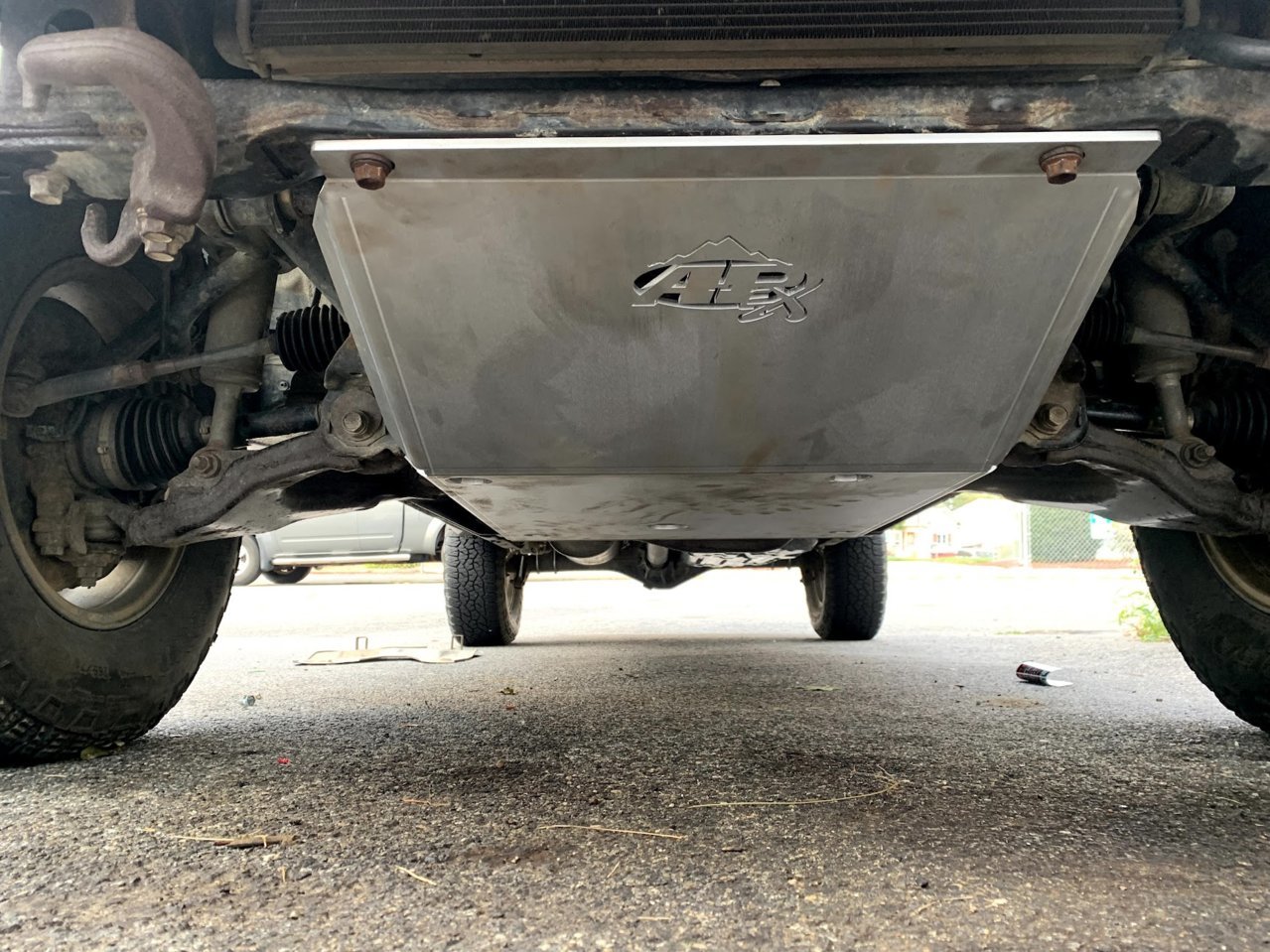

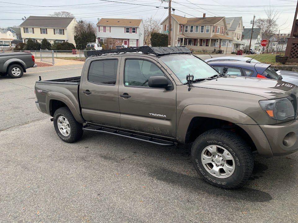

    Skids and Sliders
    For Black Friday wheelers had a good sale on skidplates. I ordered an Aluminum IFS skid and a steel transmission skid from them. For Sliders a local guy on here was selling a set of used BAMF sliders for a pretty good price.
    mp9hBQQKUq2Ustz4I8KDrHT7MY95DZmoKUOI6Ul2_6e3225456154a0b9be73b8a0cc9c01c88f9bf1f4.jpg
    I sanded these down with a flapdisk and then put a coat of rust reformer then roll on truck bed liner. (All rustoleoum products)
    qdhpAat4UL0pjlEBnn3cCUXRaPYa7C4CYYO2koOr_2b5faa791de9f7bd9ad98185ec9ac8656d92cef1.jpg
    FDyLlHRCPHjWITzG2bizZt6st6HtczcnMOgDnYlh_0da81f6bd9d09f5901048c9ab1591614eb12af6e.jpg
    9avDZ96eg2-iPf9gkfyXWHAAPg5j1F0kKXQwZj2Q_d3fbf50061a189a96194094552b9509746eeb45c.jpg

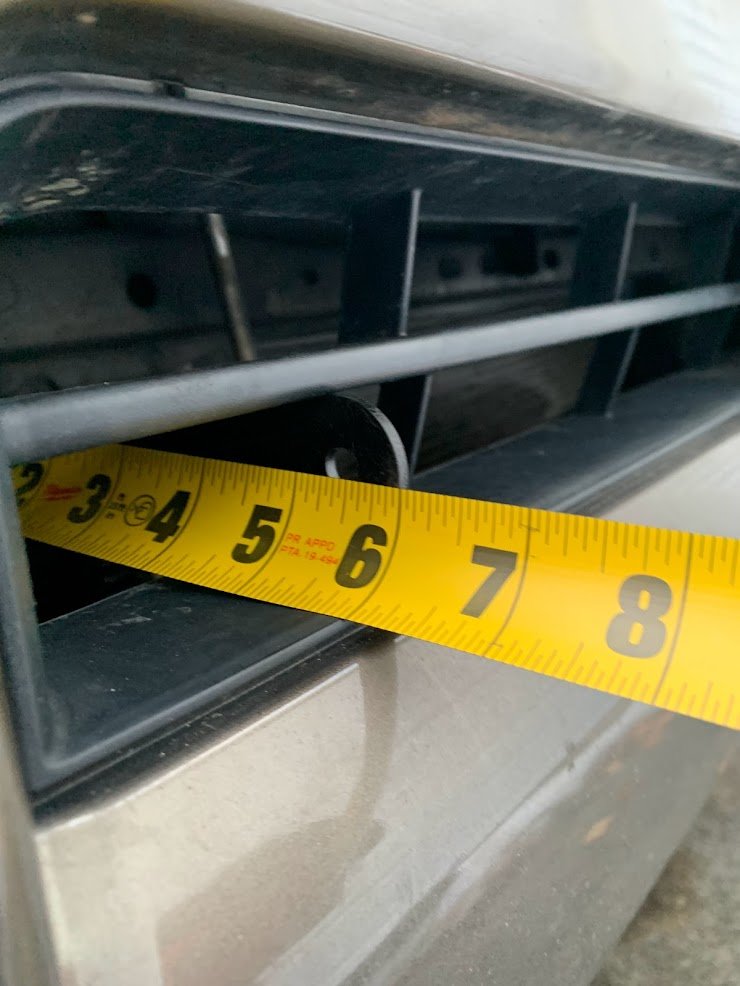

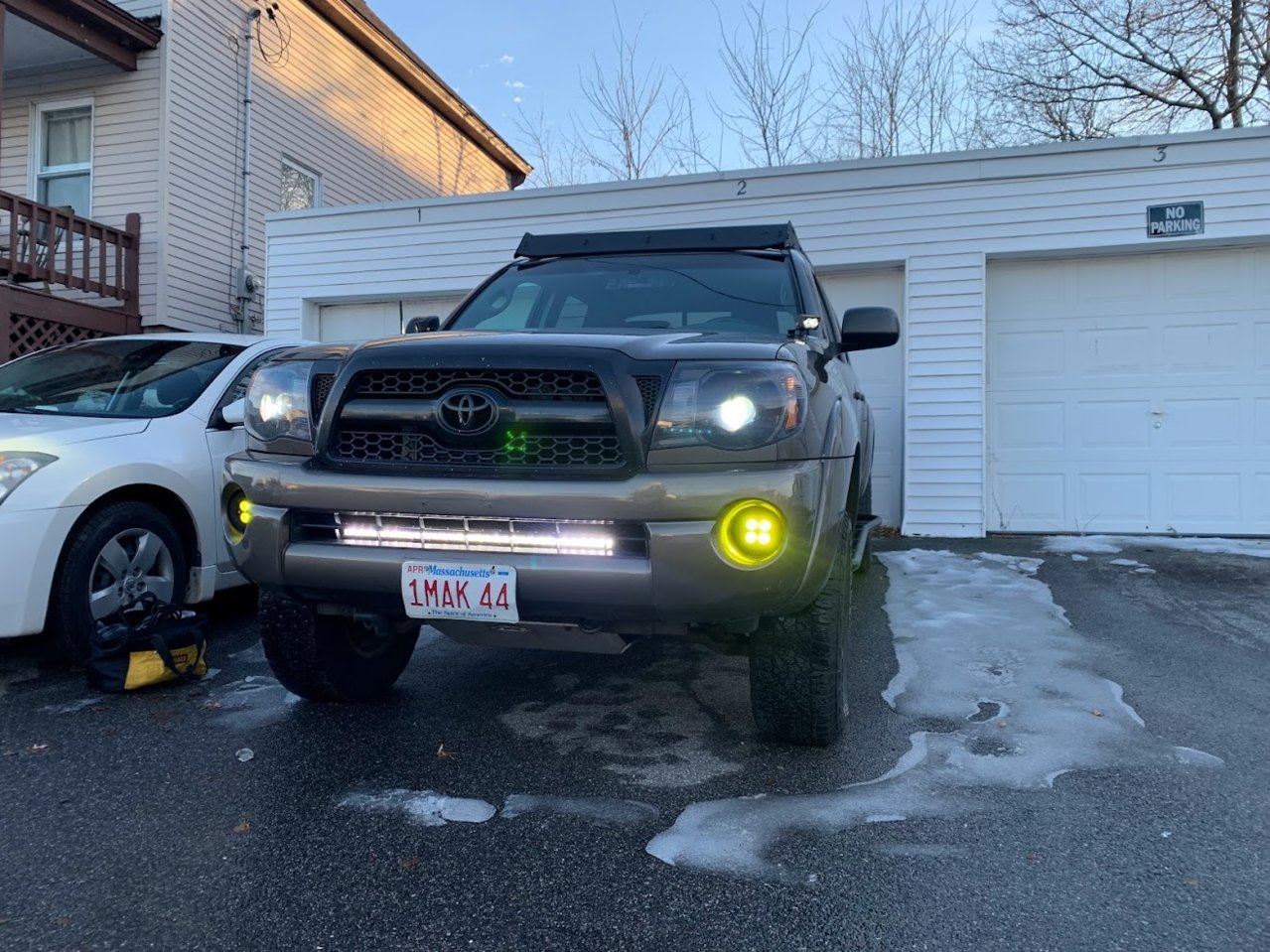

    Ditch lights and hidden lightbar
    When I first got ditch lights I ordered the Nilight 4 Inch pods and when they came in they were much bigger than expected so I ran them for a while but also searched for replacements. I settled on these, also cheap Nilights but much smaller. I wired these into my electrical system and I will see the output tonight.
    Before
    xxlRUIS2NZsPuyUbMK7cfrwoY5-168GV45mEK0tP_e2a9fc8ad30e2eb26b28524938110af285b1ed7d.jpg
    After
    9K0cARzUWtLh8vphe6LT-Of1OJZqejxq4-cUKutx_4e756f2287481cac111170d368537a28f58fa833.jpg
    I also put in a hidden lightbar in the lower grill up front using the parts below. The brackets were surprisingly good quality but they were meant for a lightbar with a 32" width and to put the lightbar flush with the bumper. The lightbar I got has a 31" mounting width and I wanted it behind the bumper completely (stealthy). I cut the brackets I think 3" back and I also had to bend them in 1/2" each. For the license plate I just lowered it drilling holes in the bumper.
    UhSE126IbaqvLs3Ou-e7CDB-ebMXDlp8yXoVVDTK_62ab2f451719098d80ecc376924a074f9772a345.jpg
    Lightbar
    Brackets
    Finished product
    Myi20v09x1ajAzBFsisxZloyAO3oaJnmONMPk3gO_b8ff21cc30dd6bc849de43e345b7fd4eb148752f.jpg

    Fridge and Battery setup
    With 12v refrigerators being about the same price as a good cooler there was really no reason to keep buying ice on camping trips. This setup isn't done, I still need to put sound deadening and probably a carpeted MDF panel on the back wall.
    kGsZQtqg45Qe39HDWQvaldgO13YaETXZIoMu04qy_a5ba0dfb53d9bb5621f5d5fd2dfe055b60dc8ef3.jpg
    With the drivers side, back seat and plastic removed the refrigerator and battery fit absolutely perfectly. Now I just need to get power in the back to charge the battery.
    xC2_4AqS8sk60Q5zZUNdrHun5hRxnbMf23iAj8vA_7bd6e8db578df5848080a1799dc4d0f49b6a4cd9.jpg
    I printed an enclosure for two cigarette lighter plugs one for the battery charger, one for the 6 usb ports for drone and camera battery charging. It is simply velcro'd to the carpet.
    NavCFCulcCoa2WzTEQ2fRuHeOFiZwNRJd1on-rU4_acddd62fe86d28bded21377b73b2fbf43aeb2245.jpg
    The power comes from my homemade panel under the hood which one relay is powered on with ignition power. The hot wire goes to this terminal block, with printed mount, that is in the center console that splits the power to the two outlets and my Midland mxt275 which is mounted in the console.

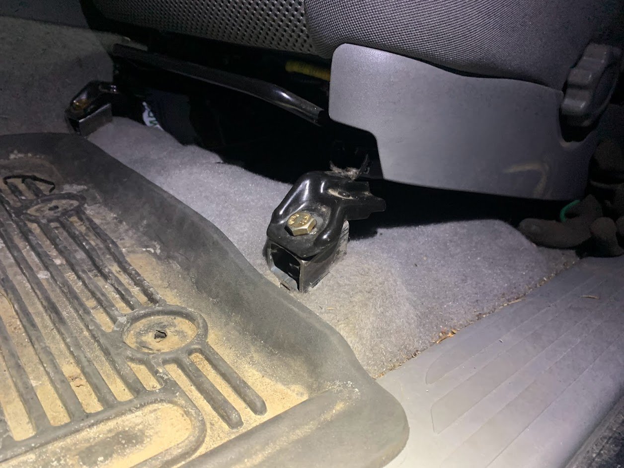

    Seat spacers
    I took one look at the desert does it spacers and to me $100 is way too much for a chunk of aluminum. I am also not confident in aluminum threads holding in the case of a crash but wanted to make the seats more comfortable.
    Here was my first attempt made out of a piece of 1x2 box tube with about a .10 wall I would guess.
    THj1egdFVQRw097B3U35nxbpo91r5T918PKZhG9D_2cc9f15348504491a1a24cfea61281f2efd972d6.jpg
    The issue with these were that the bottom bolt could not be tightened due to the box tube being too narrow. I changed the design to this.
    bBuKIta2e6e7xPZuyzXZHuJHo_I0bwYwmvPdA4D8_707d95d33e0305908f2bb839bd9e88ed85164d3e.jpg
    Qg4w97vbMJFQ01_IuEMJBEm6o0QwM7sEceRfaLcq_b671aaa7cf3c468214e9afba8c5c17b3046c86c0.jpg
    No issues yet and I would trust welded steel and grade 8 nuts well before aluminum threads.
