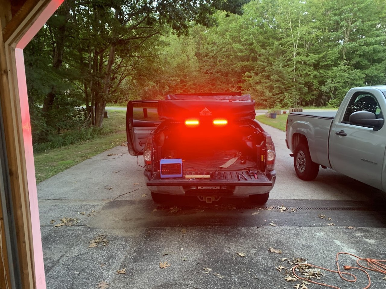

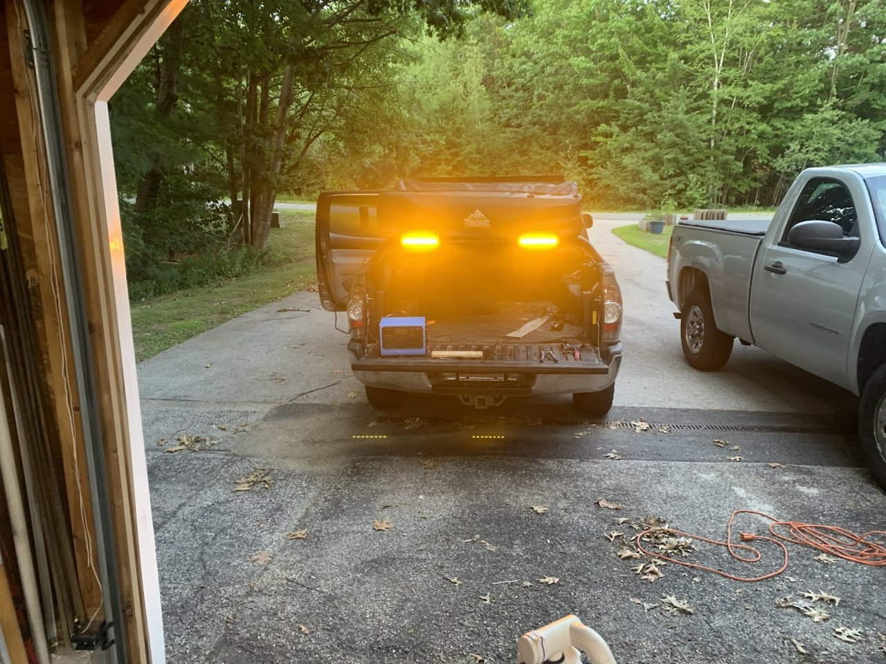

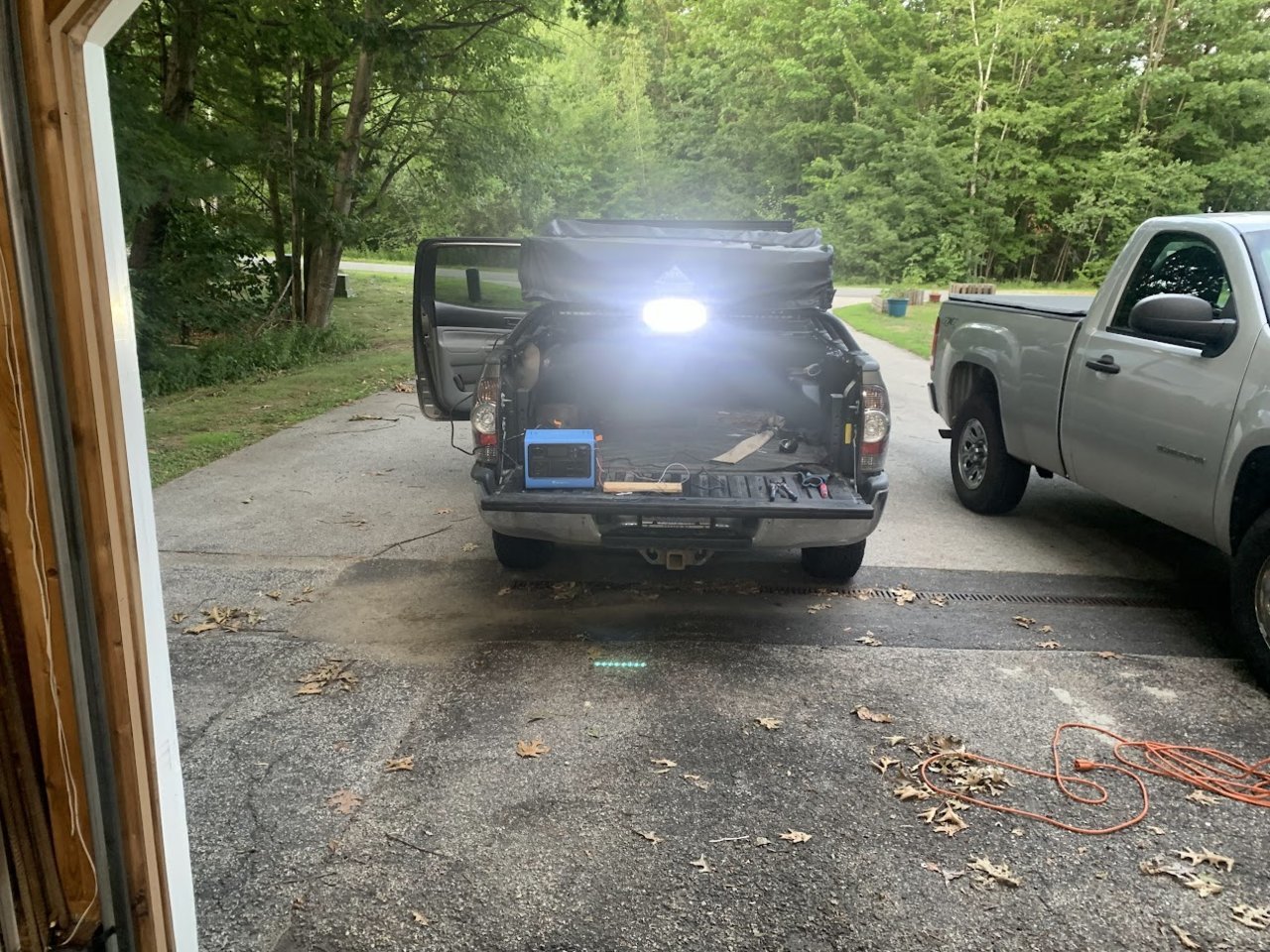

    Rear chase and backup lights
    First truck project done with the welder. Got the chase lightbar mounted up yesterday. Still needs paint and to be wired in. Here's a little preview.

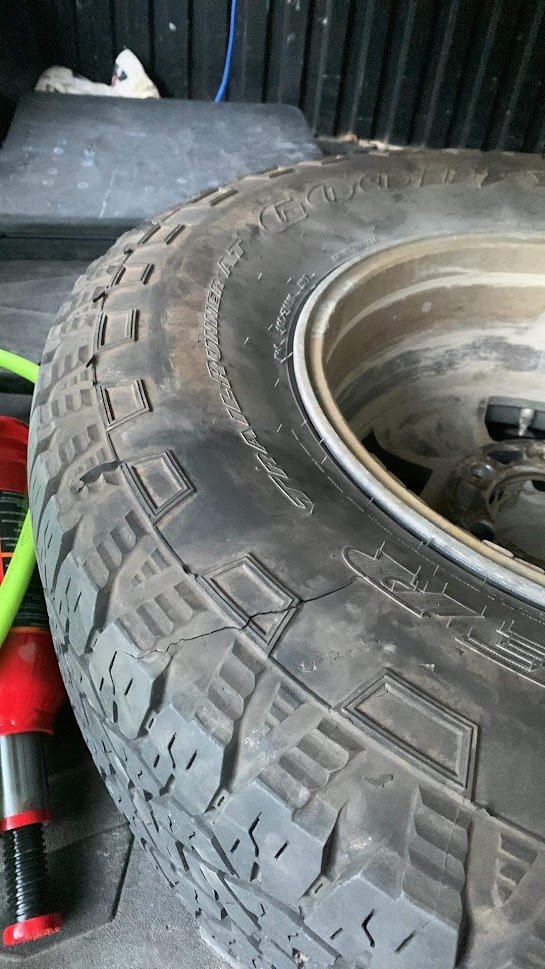

    Welp, I guess its time for new tires. Did lots of work this weekend and will mount and align on Tuesday.

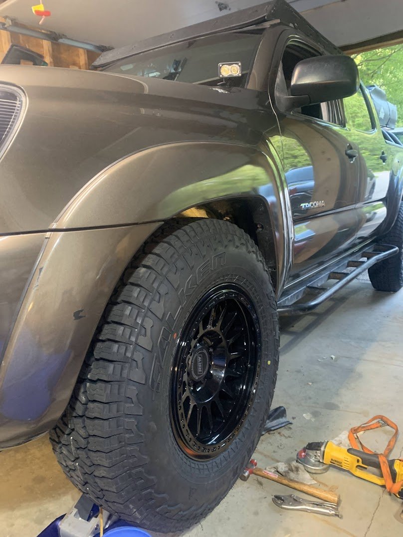

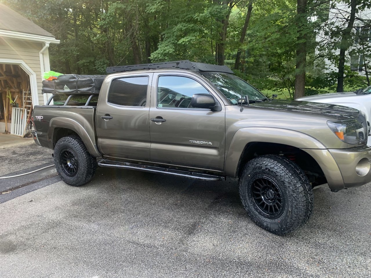

    Wheels and Tires
    I was planning on doing this upgrade at the end of the summer but my truck had a different plan. I went with 255 80 17 wildpeaks on RRW rr6-h's with 0 offset. I also replaced the upper control arms with SPC and the lower control arms with autoparts store lowers. There is some minor rubbing due to the offset of the wheels but I'll do tire clearance measures this weekend.

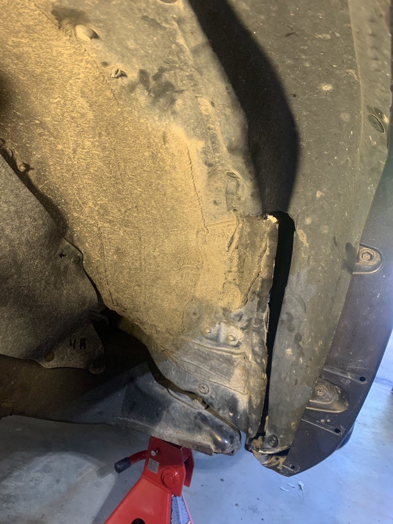

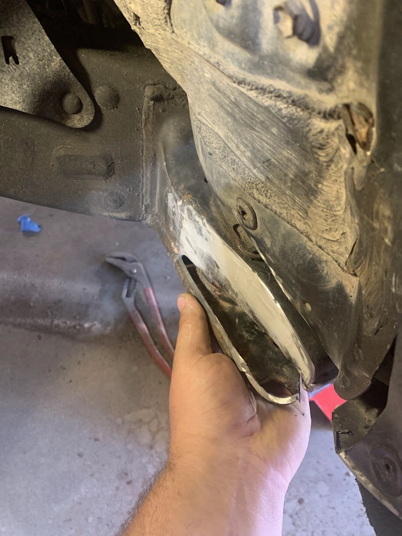

    Tire clearance
    The 255's were supposed to fit but they ended up rubbing the pinch weld and the cab mount slightly. Both the chop and the pinch weld were surprisingly easy to do. I took out the front struts so I could fully cycle the suspension and make sure it clears 100% through the entire travel.
    qz4Pjg7b90LoZhhrisHiiMQff1eB73_0GLQ4zYC3_46aee4c37355062fdd1def016628261f84558dcd.jpg
    Folded pinch weld
    S2nBSZ_uJrhpX7jwZKpEA_OdAn6-JDyBJMYDJNeO_149ef5d11b884477a0b26d4cade03ab5b298e45a.jpg
    Clearance gains, I didn't buy cab mount chop plates. I took the cutoff and beat it flat and cut it apart some more and welded it back in.
    itmGQ5LPrLmbyv8sWV6eStXs5i1k_IDFGSjwcI1M_7b9d700b320cb653aa3b46b0f133ffd86df0344a.jpg
    A 33.1" Tire at full stuff fits in the wheel wells perfectly. Clears lock to lock when its on the bump.
