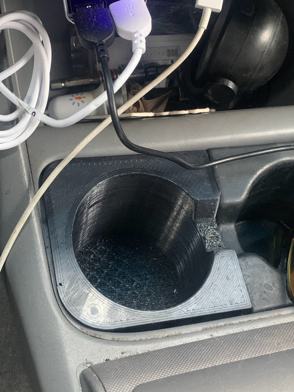

    Are the designs for your cupholder print available?

    I don't think I put them up anywhere, it didnt fit that well but it works good enough so I havent printed another. Next time I open my personal computer I'll take a look.

    That would be great. I've been missing one of mine since getting my truck. I can always tweak it if needed. Cheers

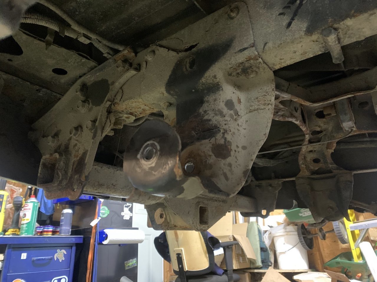

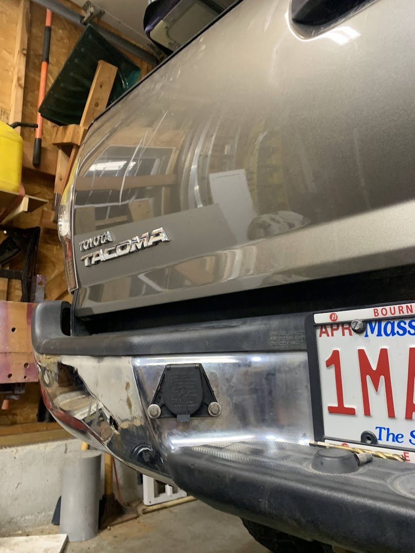

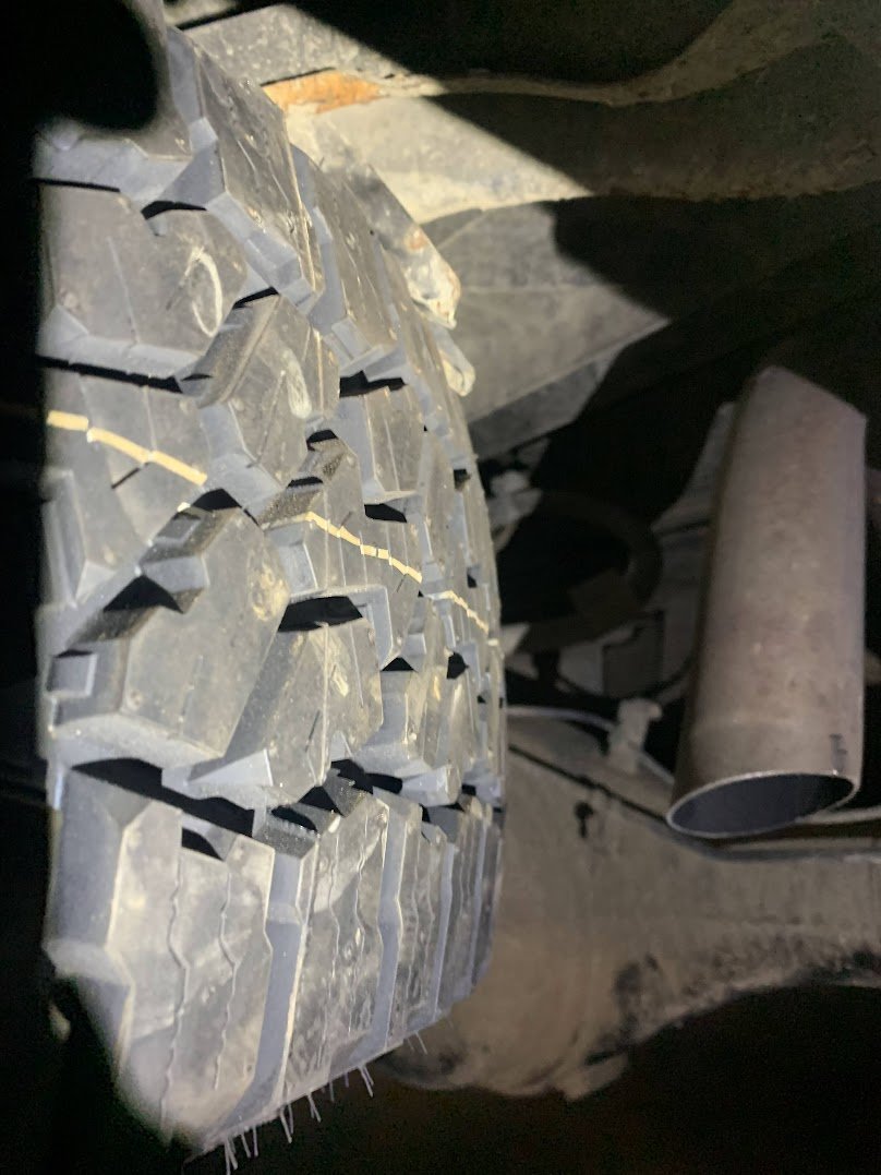

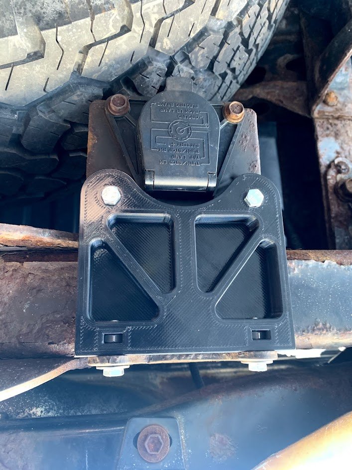

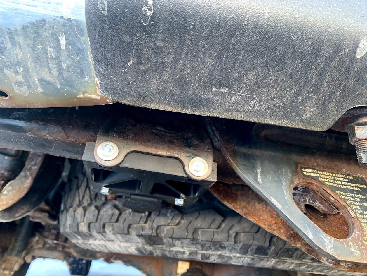

    Finishing up fitting the larger tires
    The 33" spare would not fit under the bed with the previous setup because of the trailer wiring harness relocation I did, the aligning arms, and the exhaust. Nothing a sawzall and BFH cant solve.
    j9UPaPcY45yXFNhYgP8GDFEiggu4asw2NtoqZyUu_38cde4bcb5fe326aaa3af342bbfa2f016dffd8e1.jpg
    Relocated to the drivers license plate light. The PETG print held up great, no issues over the course of a year of snow salt and dirt.
    -aKZ5N9m_SCRzF0BgRvXGlfm-_9gefi27SKhEaRl_eb4d8f8ac490aaf5cc45cdef7666af22c9e19fd7.jpg
    Sawzall work
    XOnYPKurO8mJIZpGTCq780SOckGD5Adys3vw0z7r_2a356526bdcf0caba50ef39d2c4905a3346f0da0.jpg

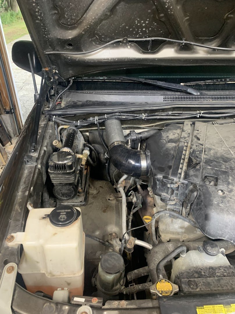

    Cowl intake
    Did a cowl intake with some Amazon parts and a piece of 3" exhaust from the auto parts store. Maybe some day Ill get around to painting the tube.
    2l0AqftwlFpKS4u8iw0g8a9HOd2gSvgChH8lytJa_c6ace7b47a84990d718ca7dd131bd42f62226167.jpg
    Also took off the swaybar for my VT trip this weekend

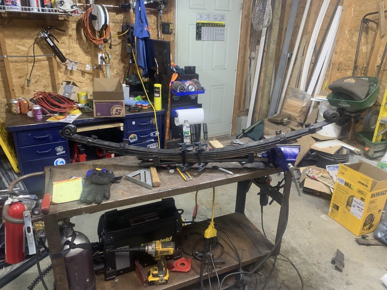

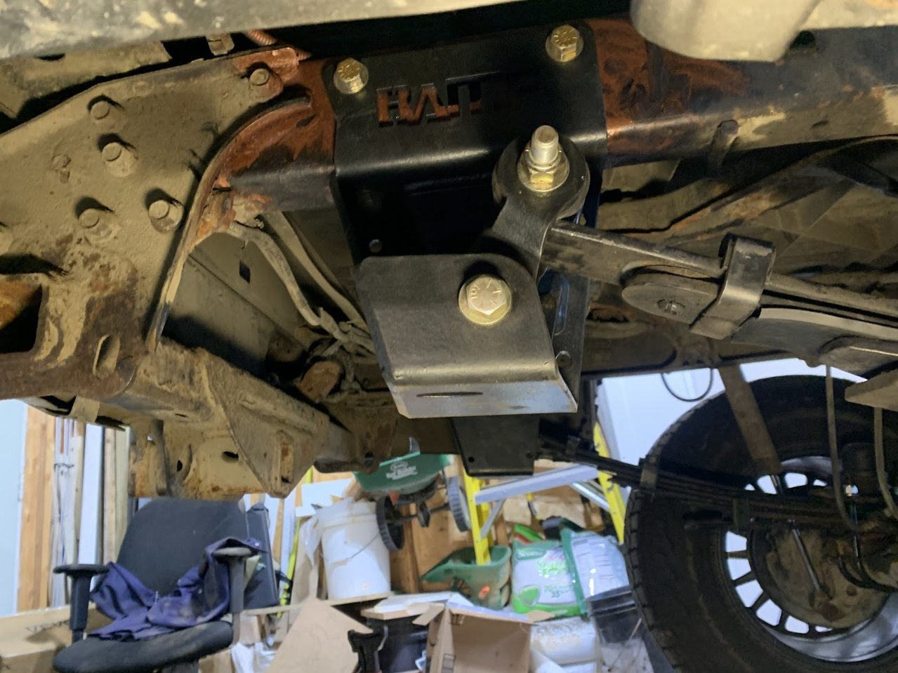

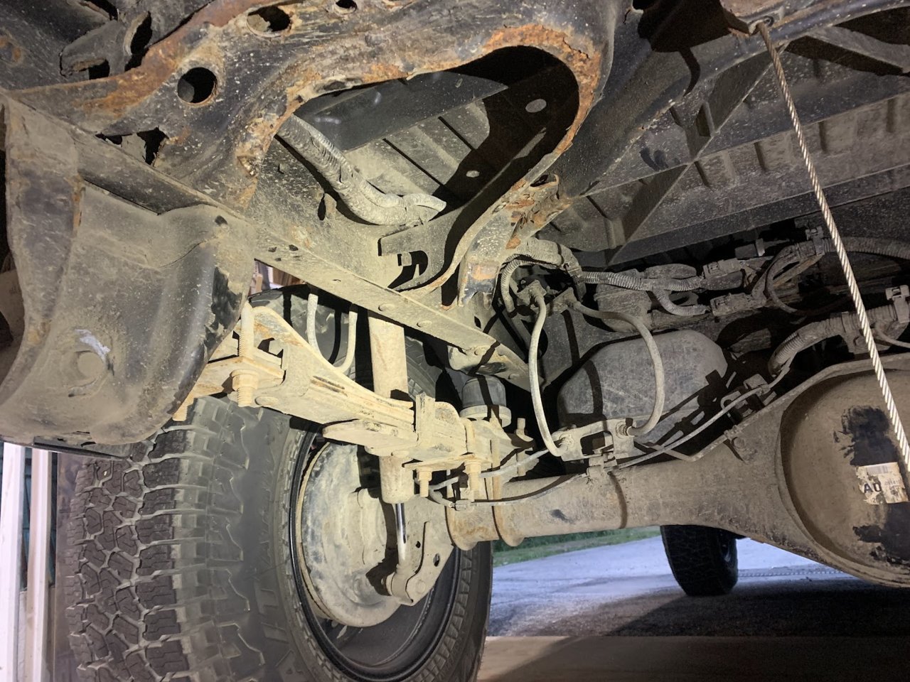

    BAMF Shackle hangers and bastard leafpacks
    Typical shackle hander/ shackle install. I also bought the shock relocation kit so theres a hint at future plans.
    Before this install I was at 22" front and 21" rear. I am short on cash at the moment so I am trying the bastard pack, Ive only seen it done a couple times on tacomas but it is pretty common elsewhere.
    I took 2 full stock tacoma leaf packs, took 2 leafs out of one of them and put them into the other with some liners and cutting them down obviously. Leaf 3 and 5 are the homemade ones. They ride pretty damn nice surprisingly.
    After install I am at 22" front 24" rear but those measurements were without the 80 lb spare and just after install. They should settle some.

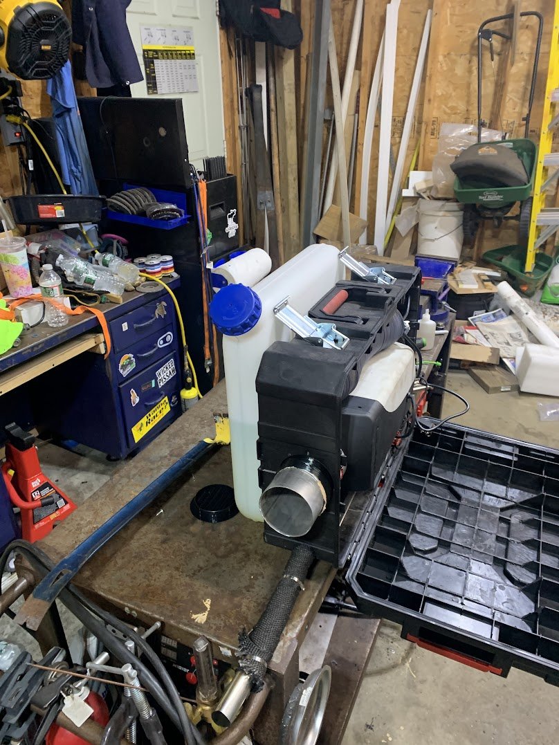

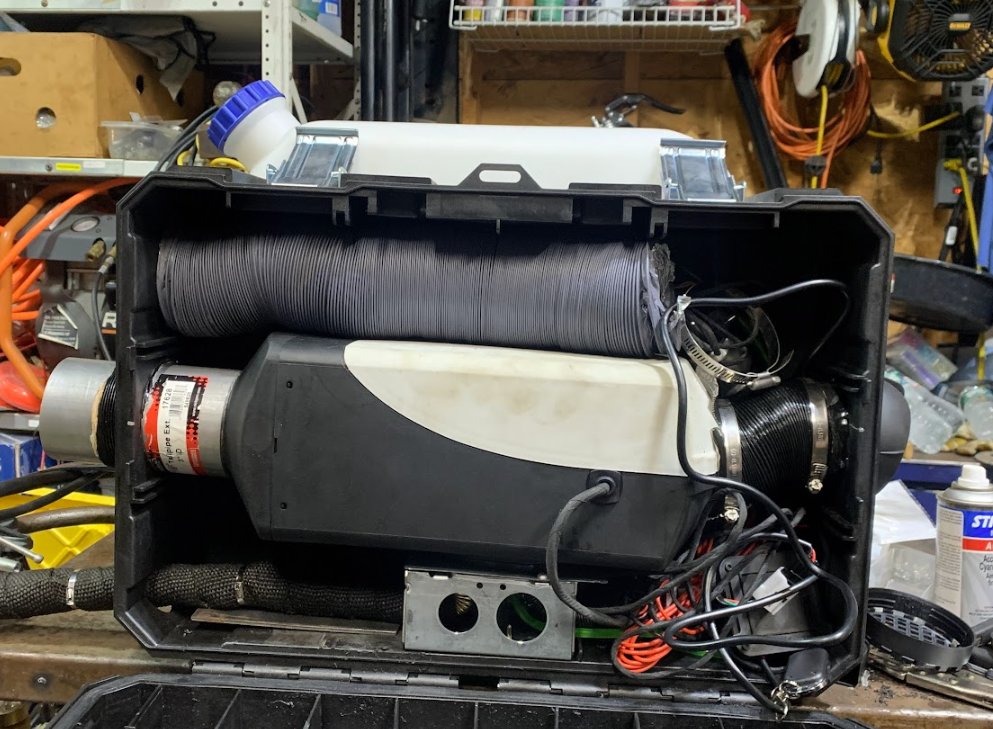

    Diesel heater
    AL9nZEVF3T9u4wjV2ZWfcsWgmXHdtwXzQmmJAkw8_af7af63a6fc5d8a450ea628271b30b1a1a1dbf02.jpg
    Parts - Heater https://www.amazon.com/gp/product/B07JZCJ563?ie=UTF8
    - Case -Hose https://www.amazon.com/gp/product/B07QG1F4YZ?ie=UTF8
    - Other Under the heater that is a double up electrical box, This wants to be a bit taller to keep the exhaust off the bottom of the box. The outlet is a chunk of autoparts exhaust tubing, I need to seal around this with some type of high temp silicone.
    This heater works great but it was a PITA to fit in this box that is slightly too small. In the end it is the most compact diesel heater setup that's all inclusive (other than 12v) that you can get with one of these Chinese diesel heaters. It will also be weather resistant too after I seal a few things.
    It works great, we used it this weekend in 20 degree weather and stayed nice and warm with it on low in our non insulated tent along with a sleeping bag. No moisture to speak of in the morning.
    Used about 0.5-1 gallon of diesel and used about 100 whrs of 12v.

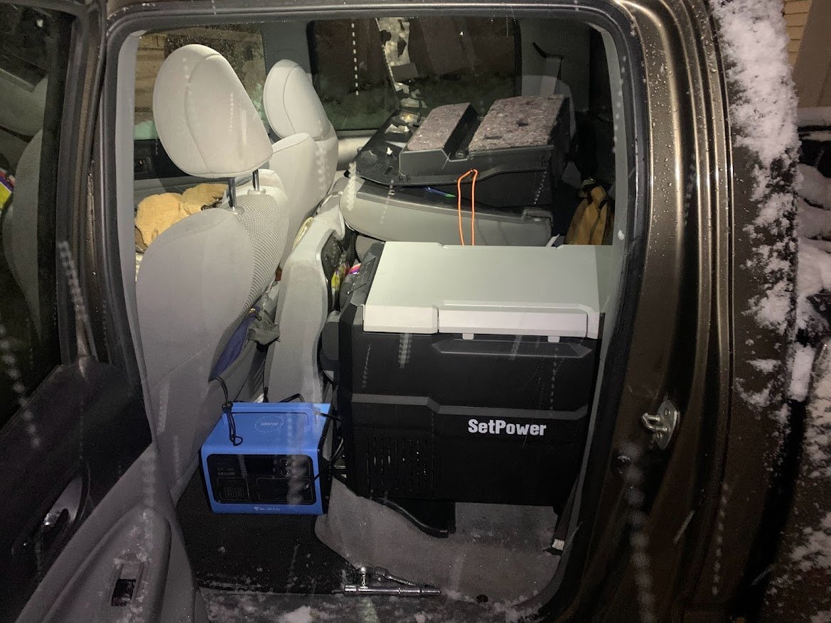

    What are you running for a battery? Any solar/second battery?

    Its a bluetti eb55 I think. No solar with this setup, but I think i am going to run a Northstar 27F single battery then put solar on the hood when my starting battery dies. Wouldnt need the portable battery then.

    Ahhh I didn't see you had a second battery setup. I thought you were just running your starting battery.

    I dont have the balls to go solo up in the NMW with running it off a normal lead acid starting battery. Even when I switch to AGM I am going to put it through a low voltage cutoff.
