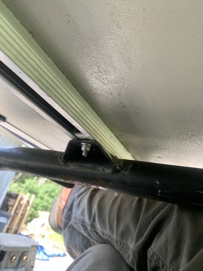

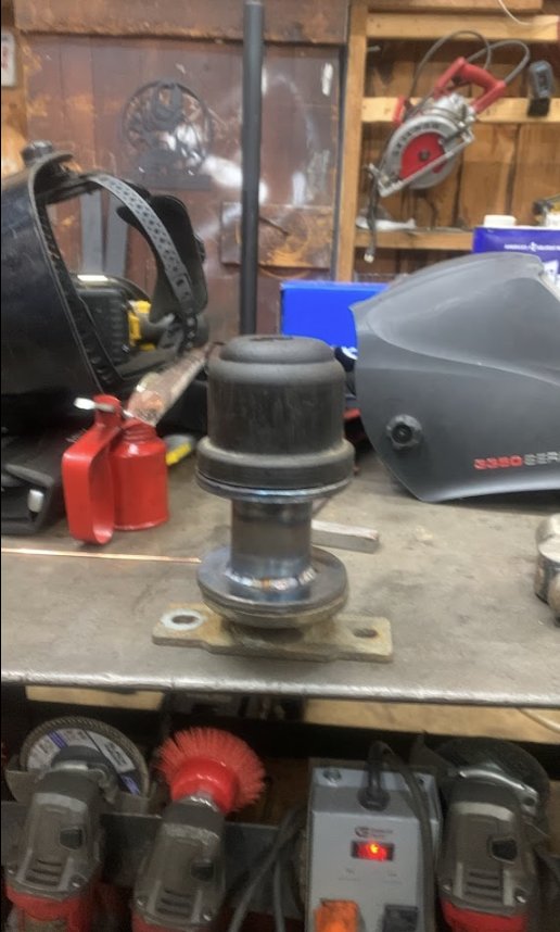

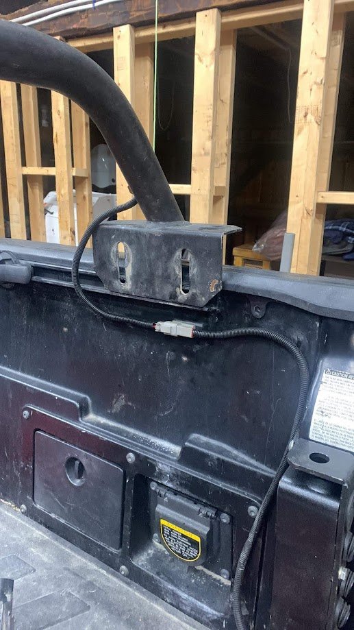

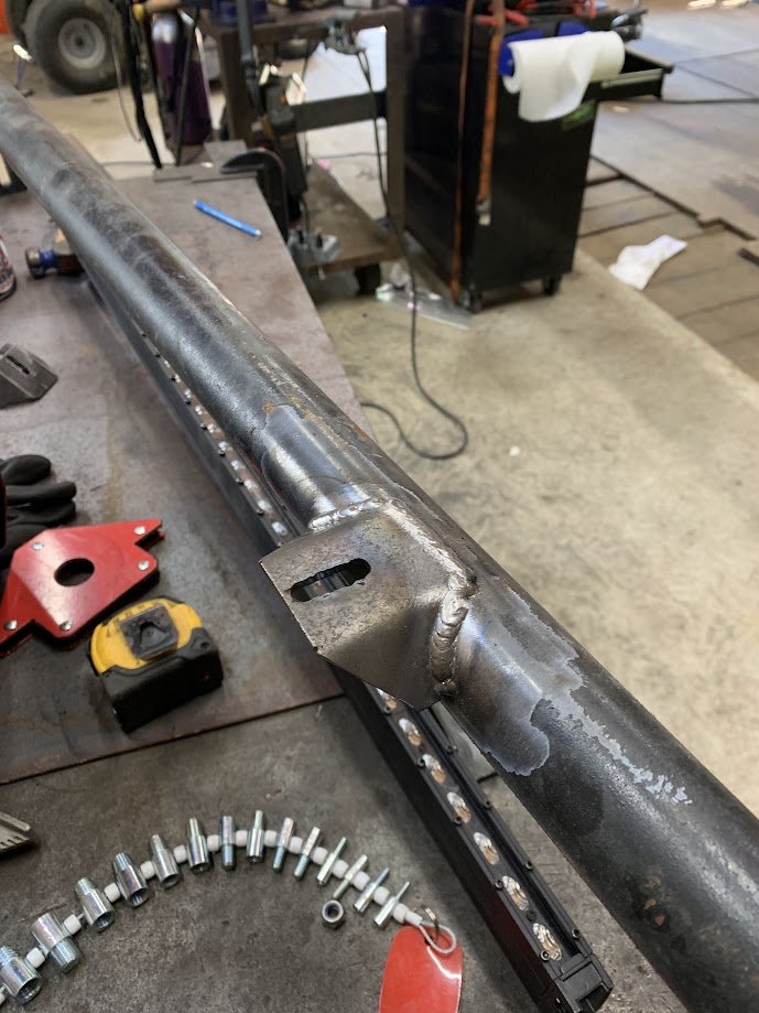

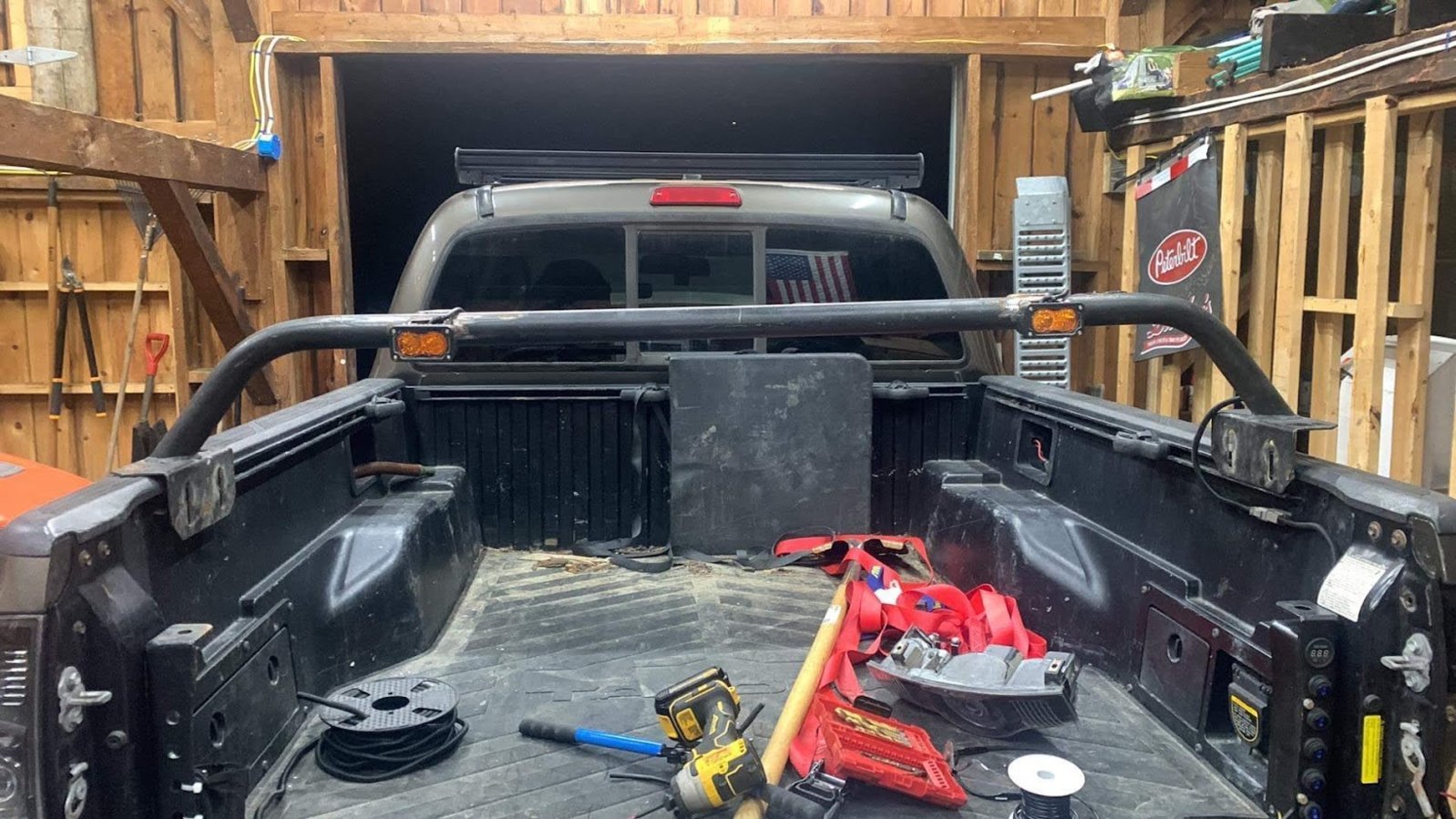

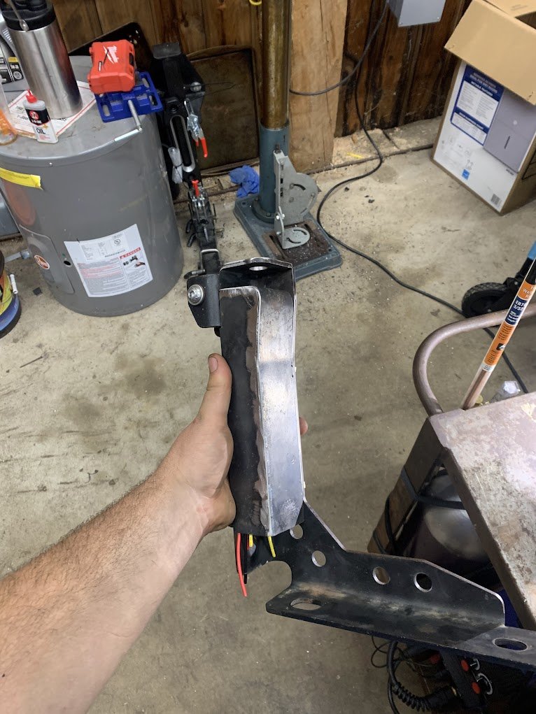

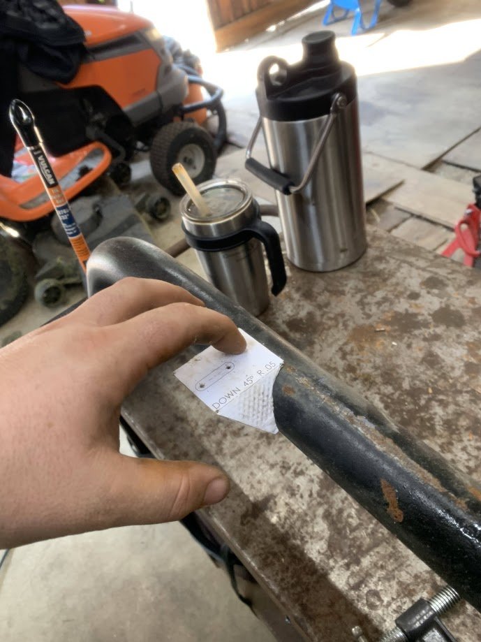

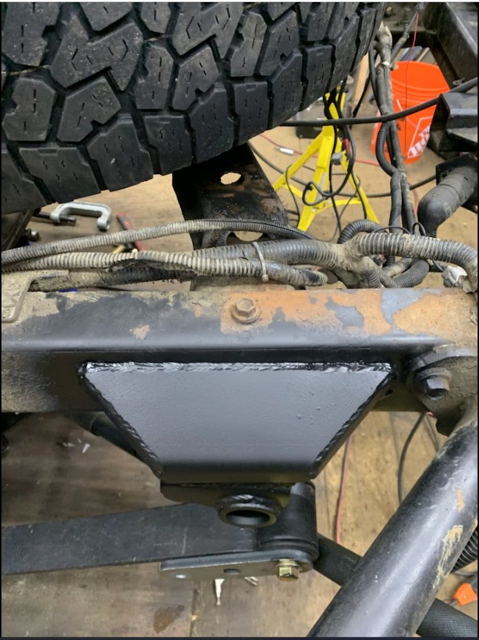

    Bedbar Improvements
    Ever sense I got the RTT I thought the two bolts and clamp plate was a sketchy way to attach it. I have had it loosen up a couple times because of it.
    I decided to make these mounts instead. I may have them lasercut in the future if anyone wants a set.
    ADCreHf2aT6gxcT0HNdYLf8nTP4-CnMtOXnKWBuE_c4591d7d6a5975f2f7d96f8fe87d644c6b4a0670.jpg
    ADCreHca0i9YQblQ92J67bz-vn_xmPTslx_S_CfG_1b9a6356aae49ee9b1c7eacb2876953d3df58c5c.jpg
    ADCreHdeJsvINgKjvWtaBn9ozpOUPLTpImKysTo7_5430cedcd26b071b7629766c950cb99151839a2d.jpg

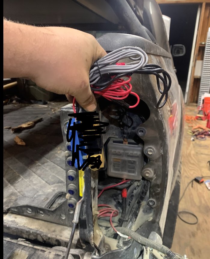

    I also made some chase light brackets and wired them in with a deutch connector so the bars are easy to take on and off.
    ADCreHfF1ZMldrh8RBWHysCtbRPHC5iSICihTd8b_32ca81e39a48da3f39b01495b44f65ad6b4c02e0.jpg
    ADCreHd4rT1QOtLmpsgguLRWew-PkVVN8pFLeA20_3ddcf8c7a8a8d059138b902af6a2fb6db8c8bff3.jpg

    That is a nice solution, may need to steal borrow the idea I like the idea of not having the bolts sticking down an taking up my limit headroom.
    what would a set of 8 run if you was to produce them?

    Not too much, I am not ready at the moment but I was thinking something like $25-30 + shipping. $50-75 burned on at my shop for a set of 4. I do not have any cnc capabilities yet so it would be a send cut send job.
    I don't think you would need 8. I just put on 2 per bar. I see you have a plasma, Id share the file if you want to make yourself a set.

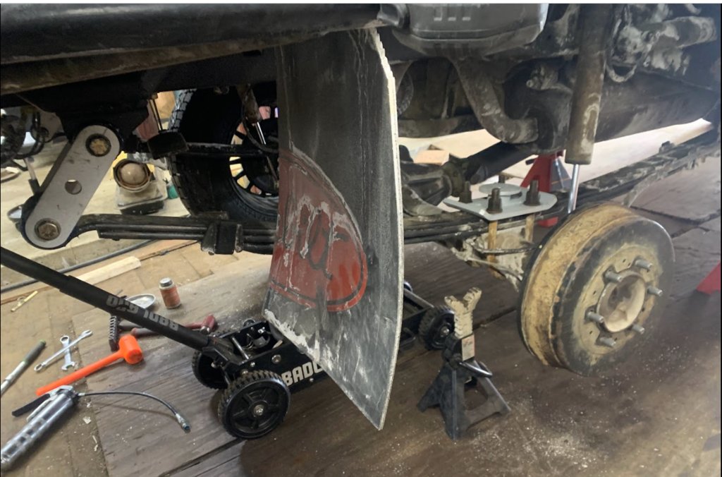

    Highway trash mudflaps

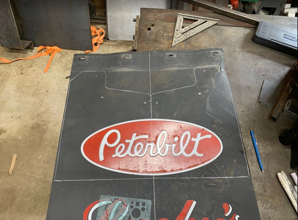

    Found a mudflap likely off of an 18 wheeler and I just had to.

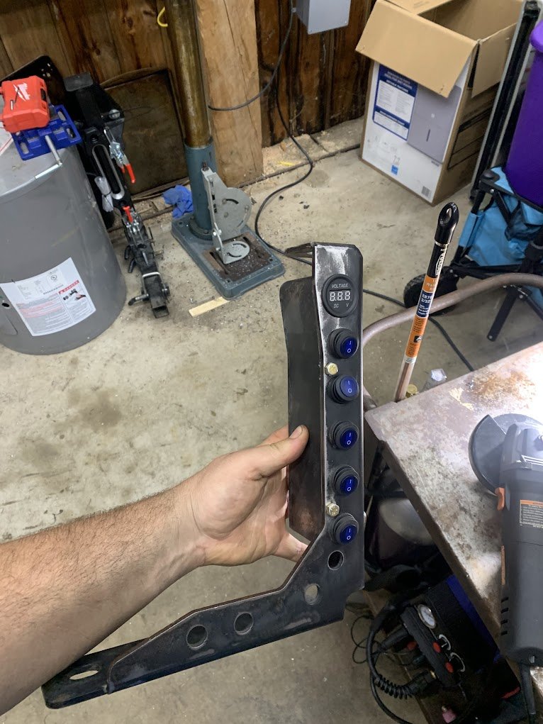

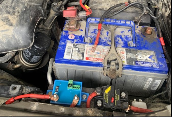

    Single Battery House setup
    Goes through a low voltage disconnect so it will turn all the house stuff off when the battery gets to whatever voltage I set it to. Tested it with a diesel heater overnight with 2 startups and the battery was at around 12.4 volts in the morning
    Stating at the battery for house circuit
    -25A Blue sea breaker
    - Victron 65 A Battery protect
    - Behind the taillight fuse panel
    - Switches on bed stiffener (camp lights, bed lights, future water pump)

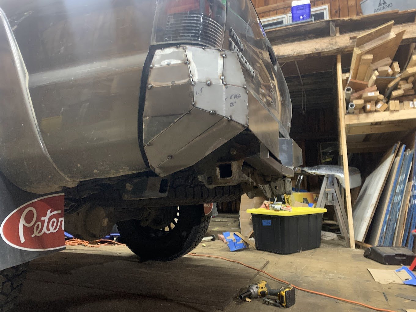

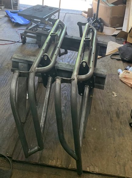

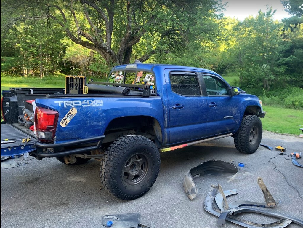

    Rear Bumper #1
    Design intent of this bumper (not for me).
    -not an offroad bumper
    -keep OEM tow hitch
    - Hold some reverse lights that will go around the trailer attached
    It is built out of 1/8 plate for the most part. OEM removed parts were 33lbs and the new bumper was 47 lbs

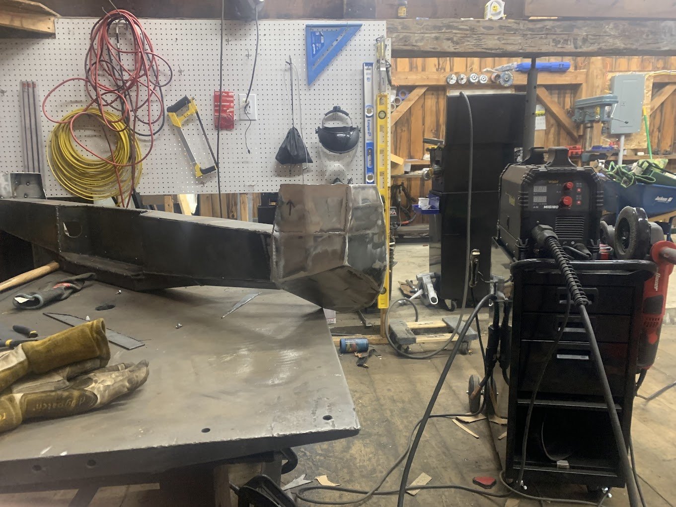

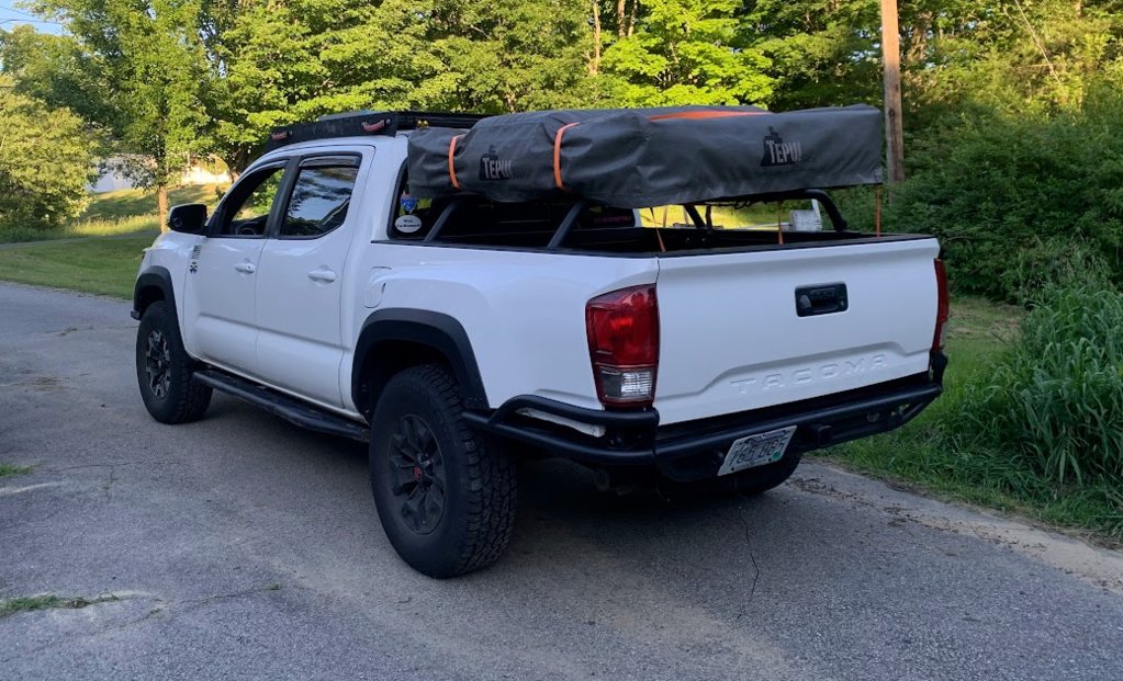

    Bumper #2
    Also building these to sell.
    Bumper features
    3/8" main plates partially doubled up partially, to hold the tow bar (2.5"x2.5" .25 wall) and to make solid 3/4" recovery points. Compatible with both hard and soft shackles.
    1.75" x .120" wall DOM tube
    All 1/4" Gussets
    Tabs for SSC2's or similar
    Weight is around 90 lbs (OEM removed parts should be around 85 lbs)
    There will be minor changes in between this first initial prototype and what I would sell. Probably nothing anyone would notice.
    This exact one is 2005-2015 but I want to build similar for turd gens.
    Pricing
    Normal price at $1K
    TWers $950
    Timing would be Summer 2024 and on

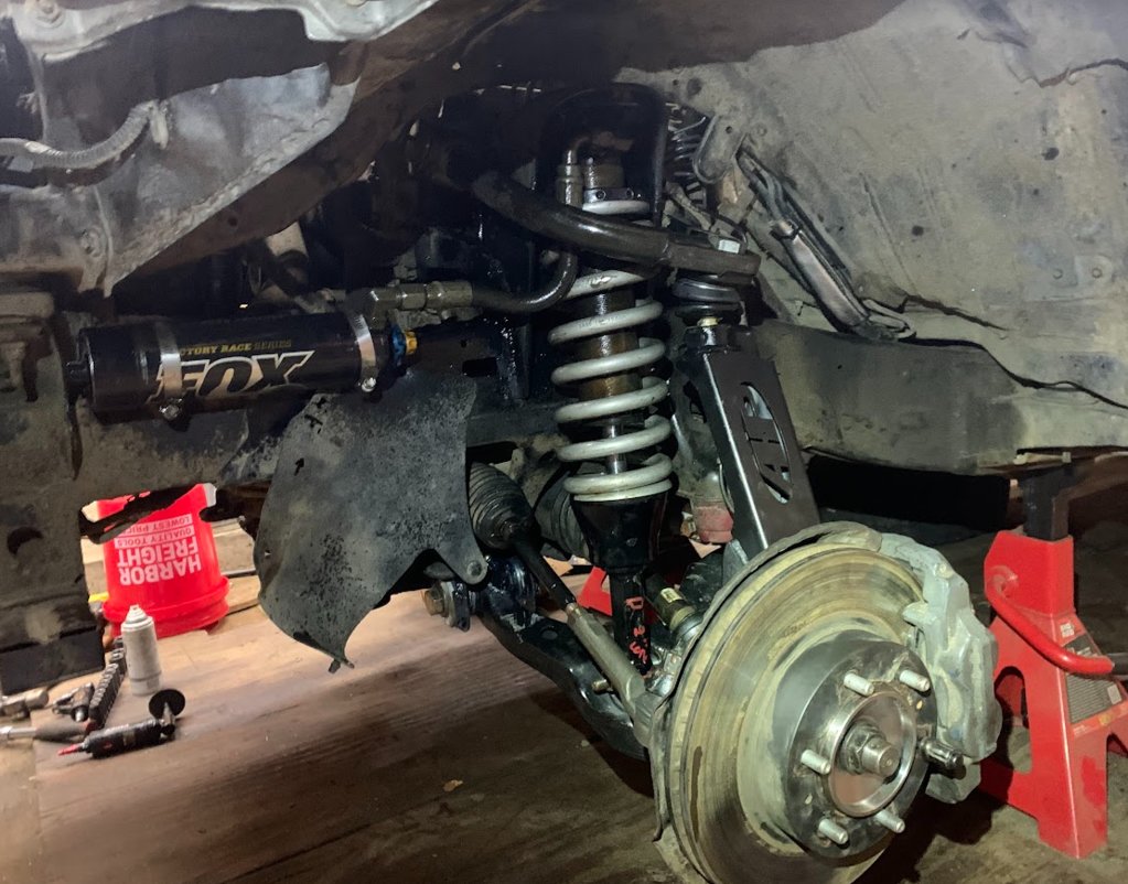

    170 K maintenance
    Uca bjs
    New faux dk arms
    Kpo octogon alignment hardware with gussets
    Wheel bearings
    Inner and outer tie rods
    Raise up the front a bit
    New lower sphericals in the foxs
    Wheel speed sensors
    Spindle seals

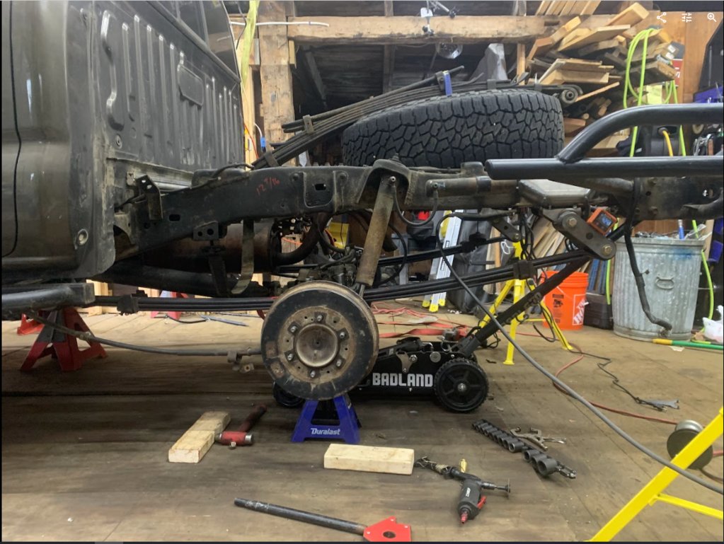

    63 Swap
    Took about 2 days for my first time doing it all alone. Turned out pretty well but I should have moved the rear hanger forward a little more. I am building a flatbed soonish so I am planning for extra weight.
    Shock relocation will be happening with flatbed.
    Notes for next time
    • centering axle with 2 people would be much easier
    • drill and tap rear hangers before welding sleeve onto bracket
    • Leafs felt softer than stock leafs
    • Not much change in ride, I think my shocks are making it stiff. One has no n2 and extremely hard to move
    • Paint shackles and u bolt plates before starting.
