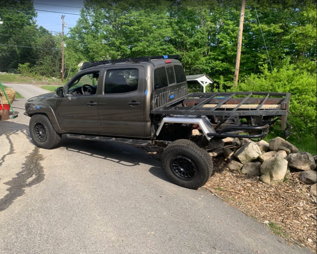

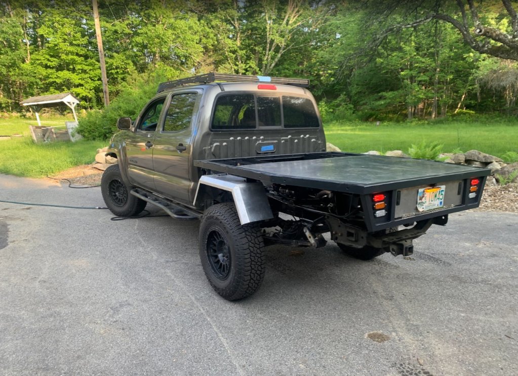

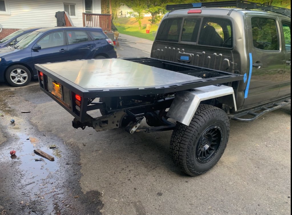

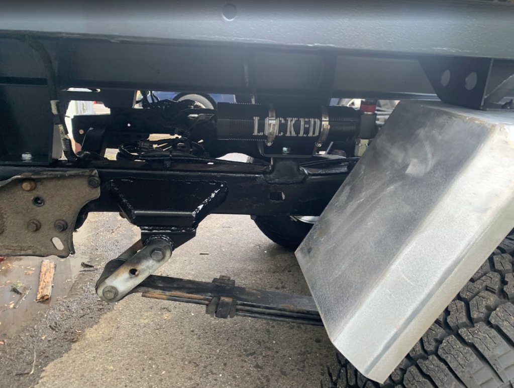

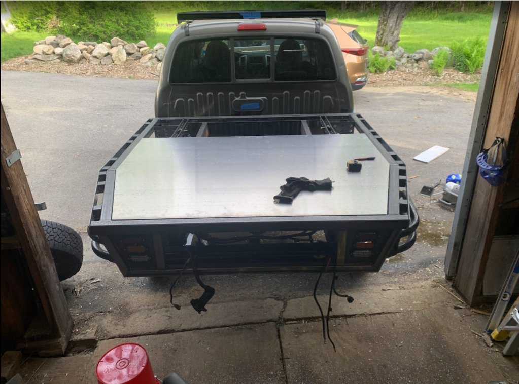

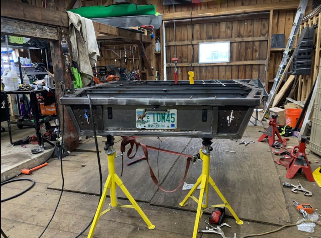

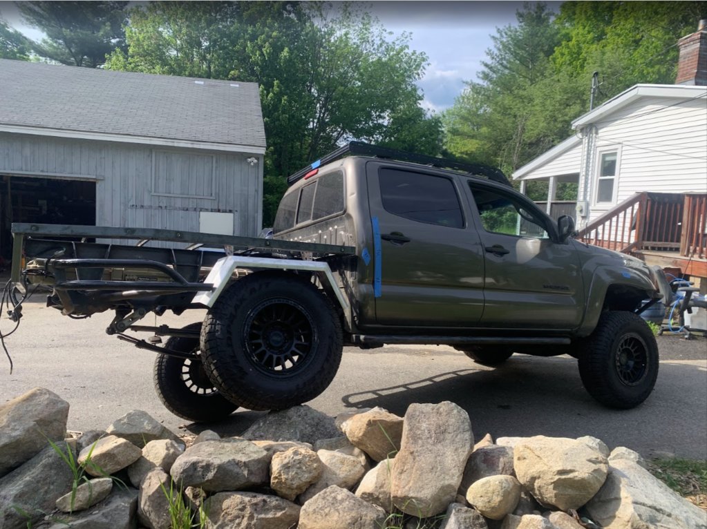

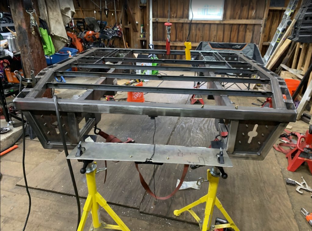

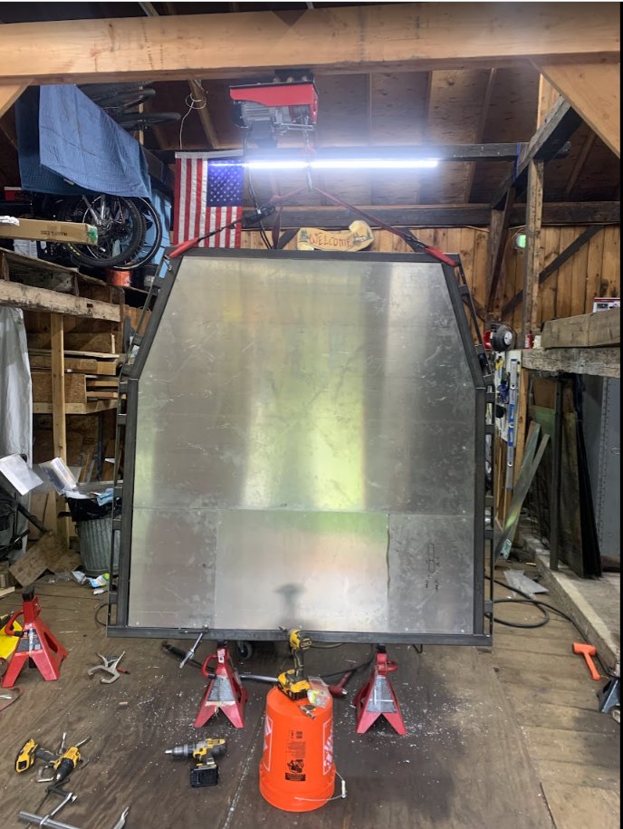

    Flatbed Part 3 Filler neck, flex test, grinding, deck, grinding, Tailgate, grinding, and paint 332 lbs

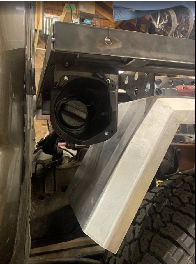

    Filler neck, does it work? No clue

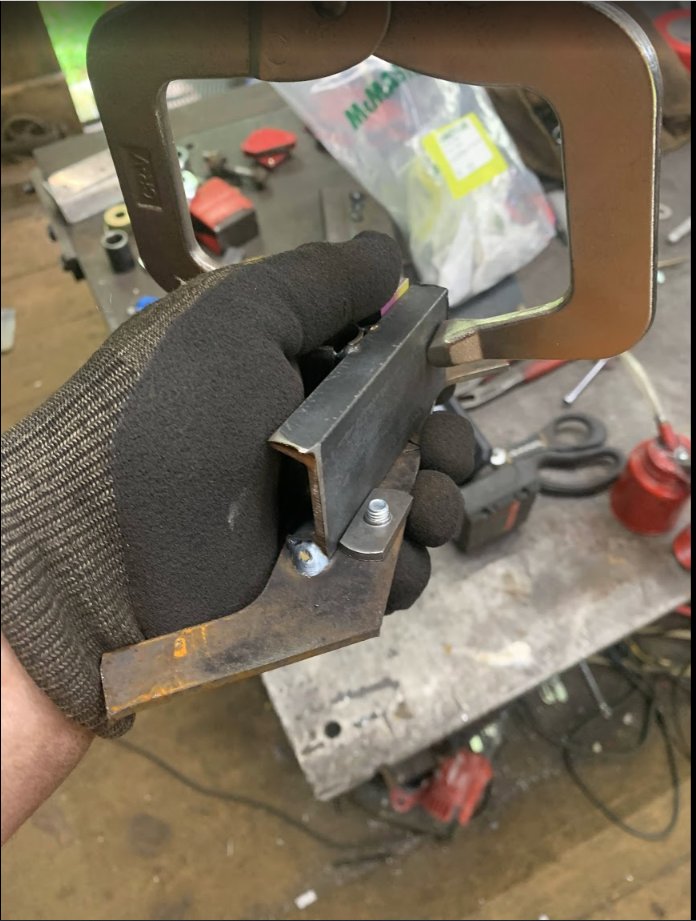

    To attach deck I made a little drill guide to drill from the bottom and space the weld nut out the correct distance from the channel

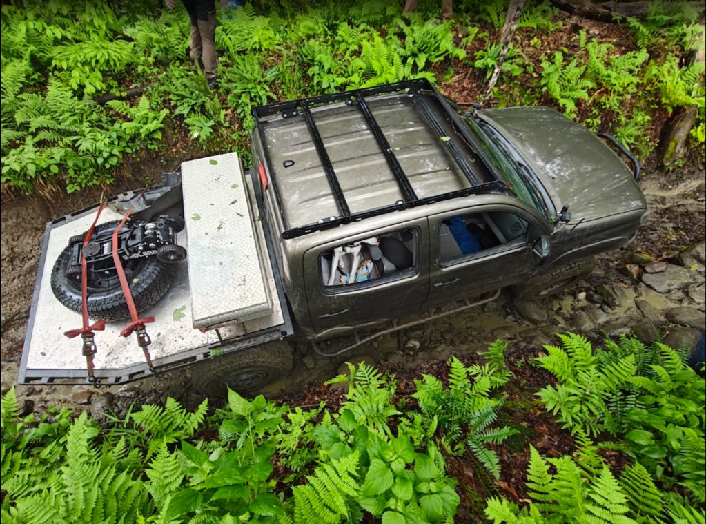

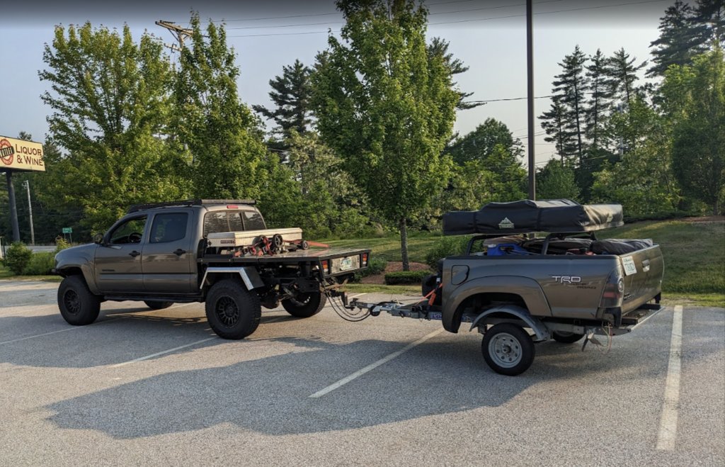

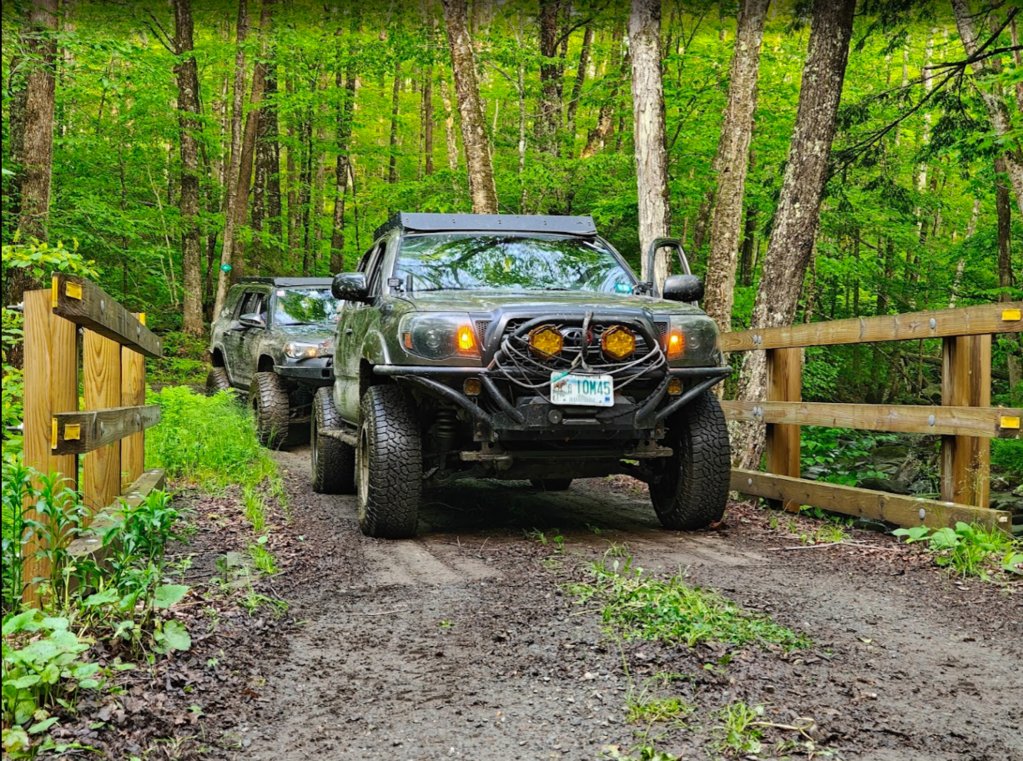

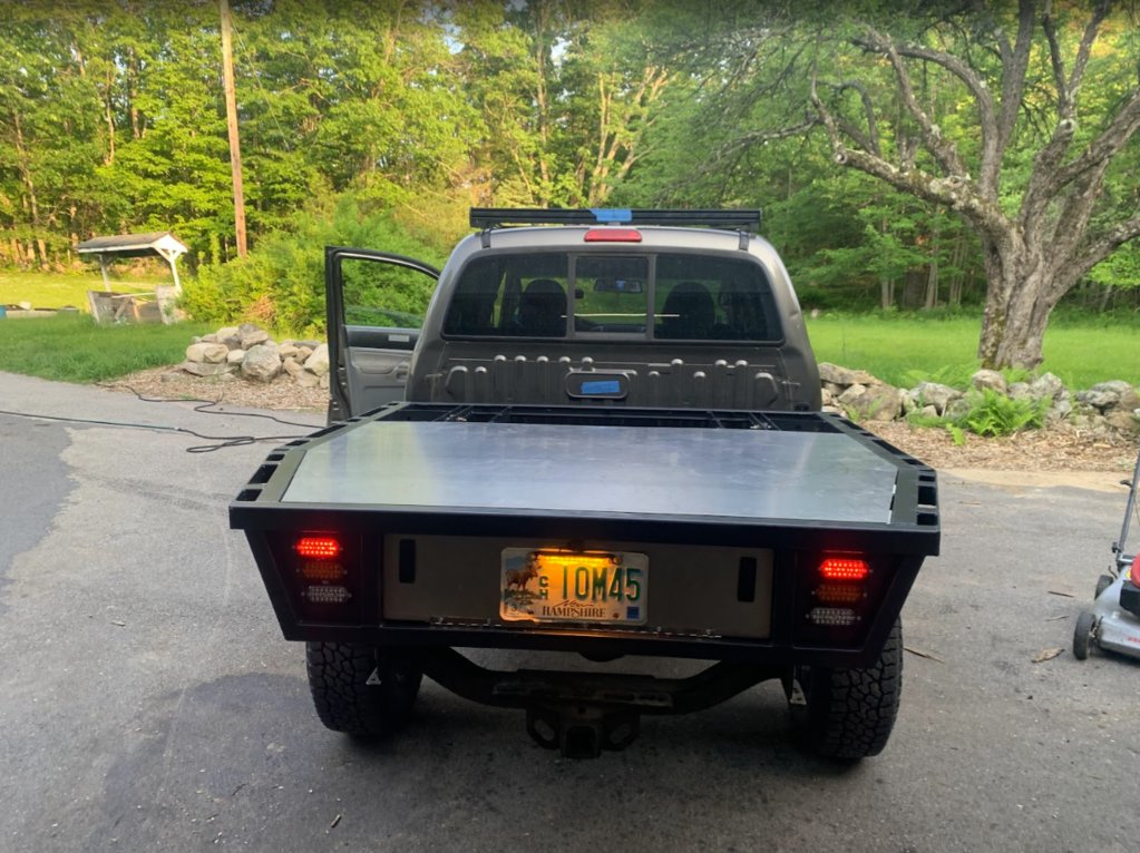

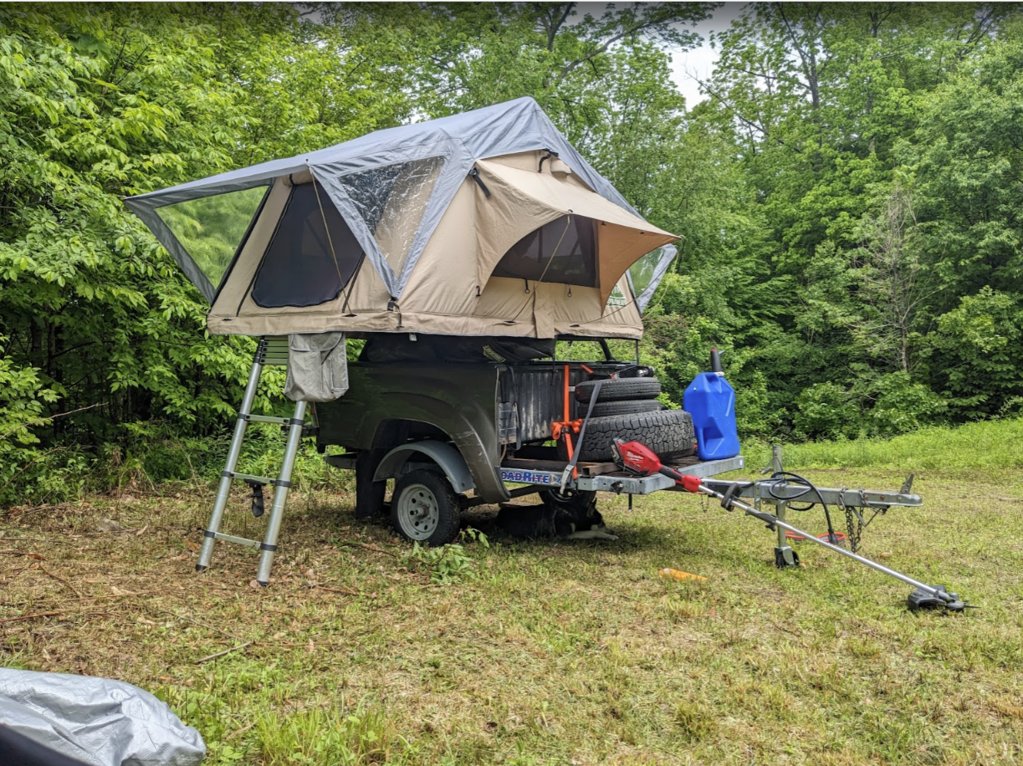

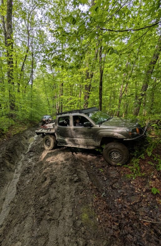

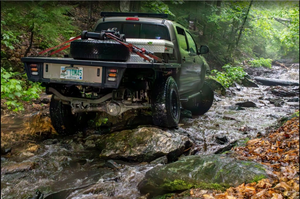

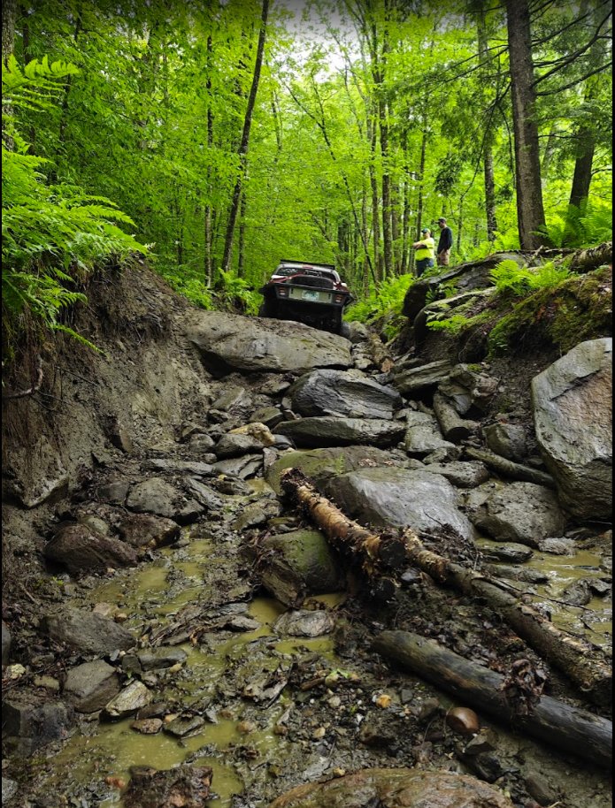

    Flatbed/63 Testing and Vermont Trip
    Wheeling a flatbed is great. Get the cab past stuff then just let her eat.

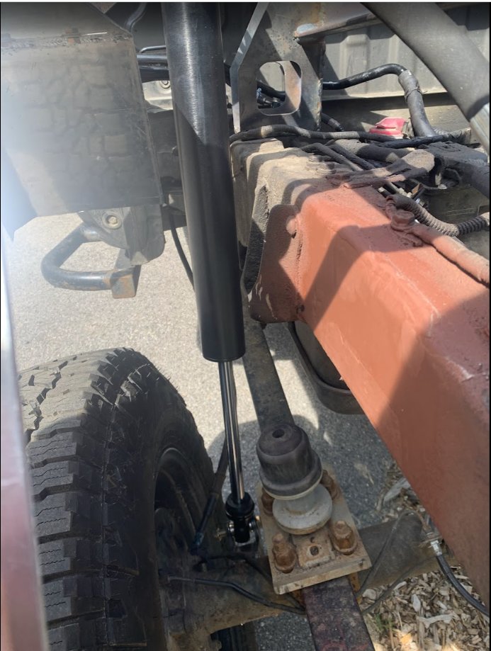

    With no spacers the tires rub the shocks a fair amount. I think I may be able to move the upper mount in towards the frame to avoid this and spacers. Filler neck works fine too.
    Need to build hitch and headache rack

    Omg, so many things going on in so few photos.
    Bringing a week whacker to clear your camp site is such a pro move :laugh:
    Old bed on the tiny trailer tires is hilarious, but it looks like it worked wonderfully.
    Flatbed looks absolutely phenomenal!

    Weedwacker? What kind of amateur do you think I am? I brought a nice honda lawnmower to clear the site. Big chainsaw for firewood. We were setup.
    I put the old bed on that trailer and it fit too well, I could not do it. Didnt tell anyone else we were going camping with either so they all laughed on arrival.

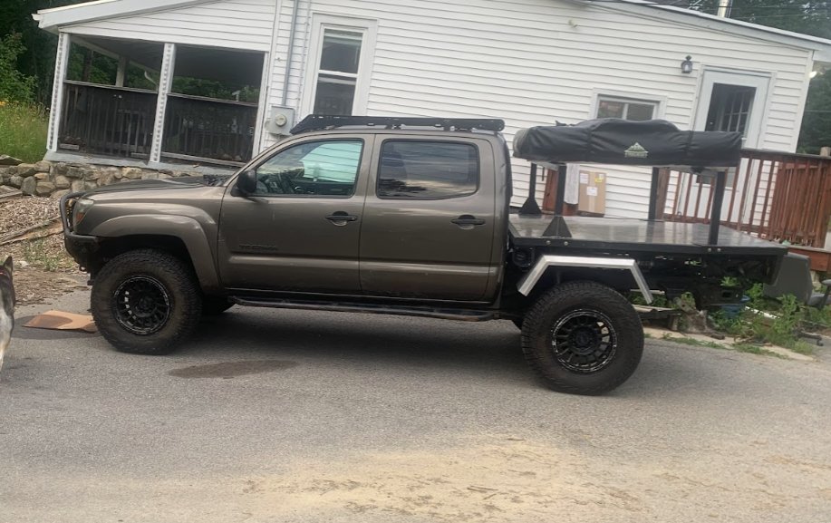

    Made some quick bedbars for the tent. Didnt spend too much time on these cause I have something else up my sleeve.

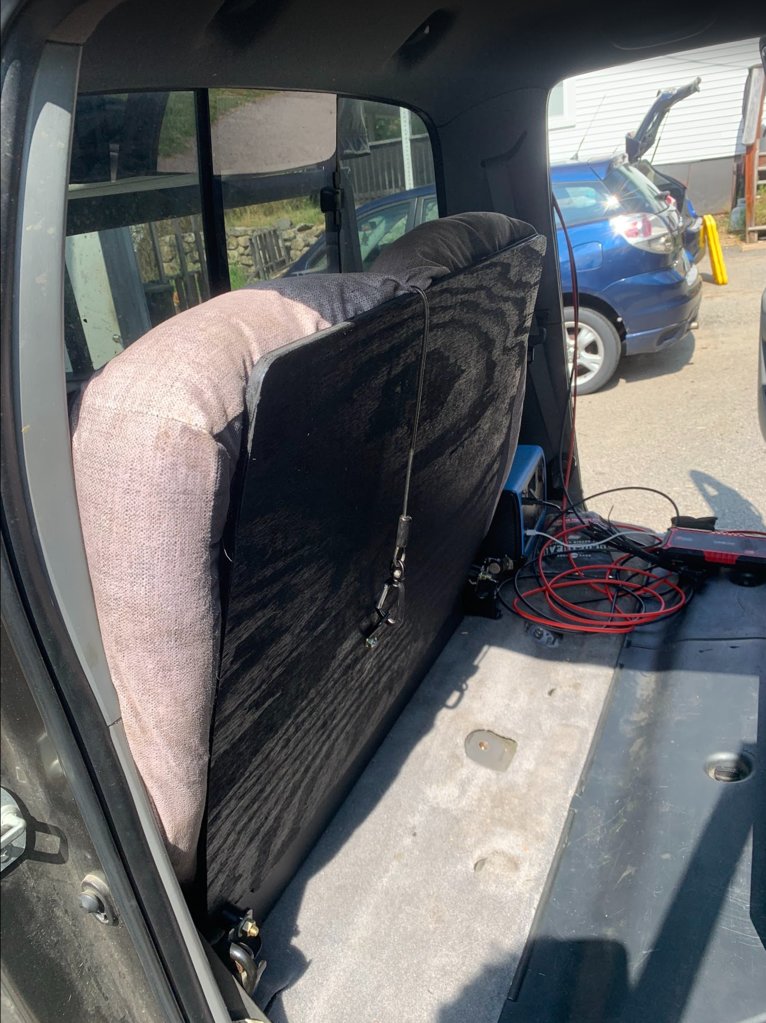

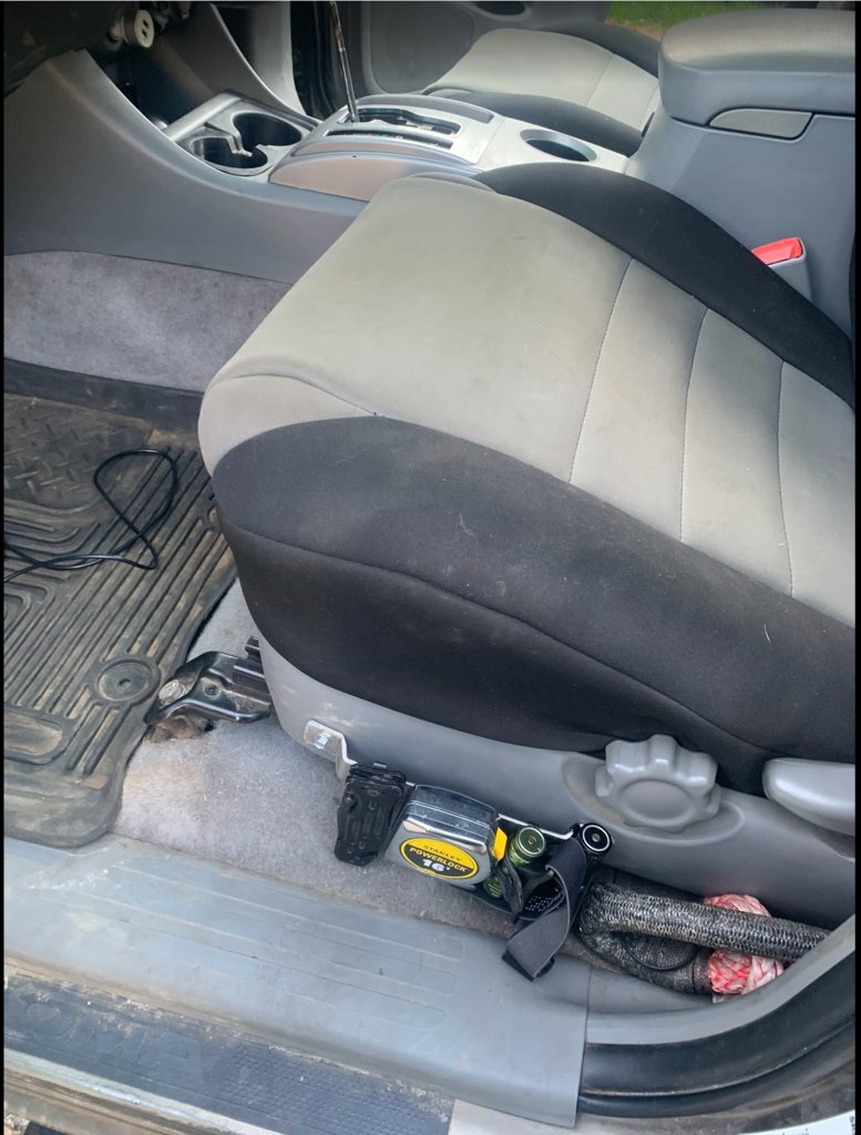

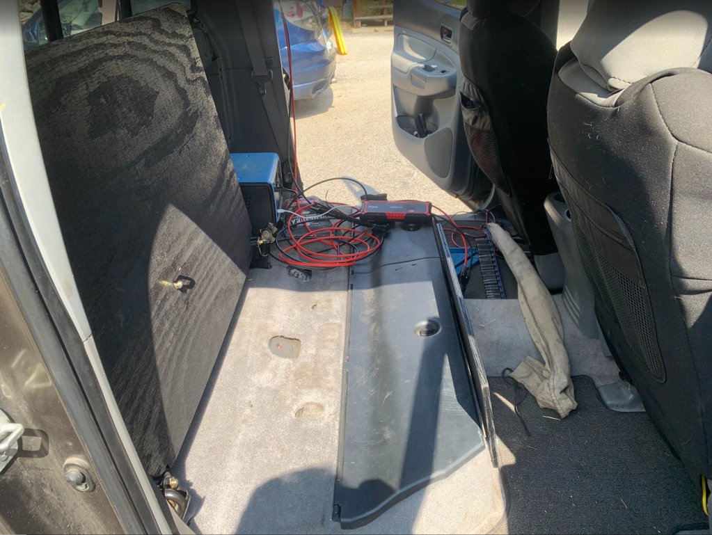

    Interior organization

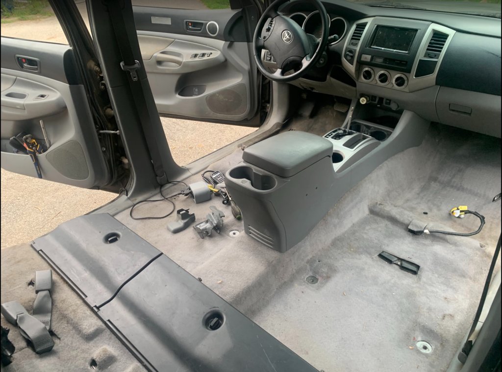

    After 4.5 years and 80k it was finally time to do a deep clean of the truck. So much husky hair.
    Made a stupid little belt clip thing on the side of the seat for a flashlight,headlamp, tape measure, and knife

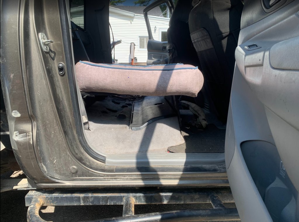

    And finally deleted the 60 portion in lou for a dog bed. Can use her seatbelt to hold it up when there is a dog bed in there
