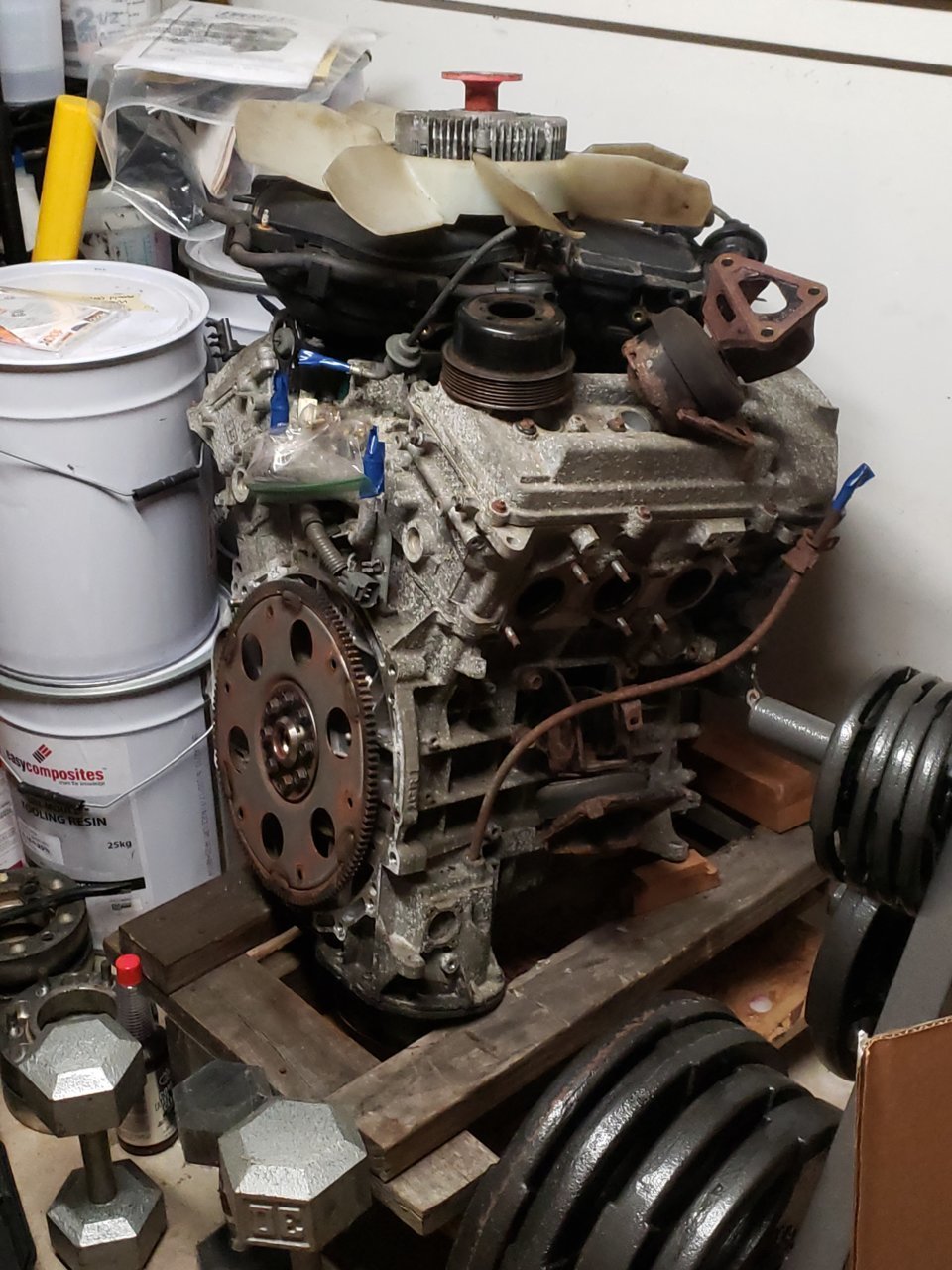

    Got a spare 1gr-fe

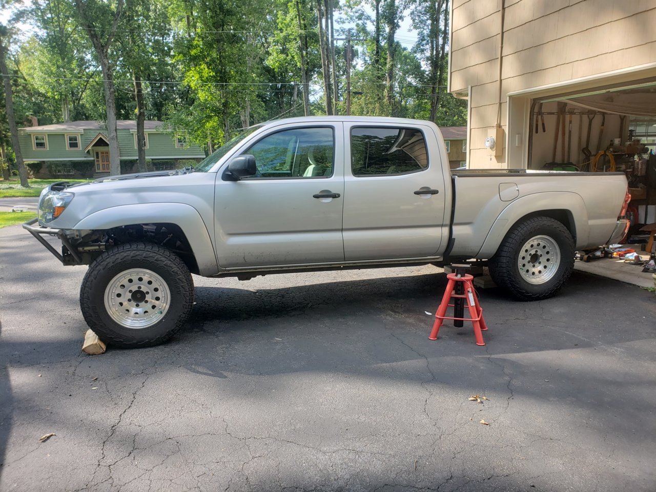

  2. Oct 13, 2019 at 7:04 PM
    #22
    not_nick
    not_nick [OP] Well-Known Member
    Sep 20, 2017
    #230574
    1,918
    keeping jersey dirty

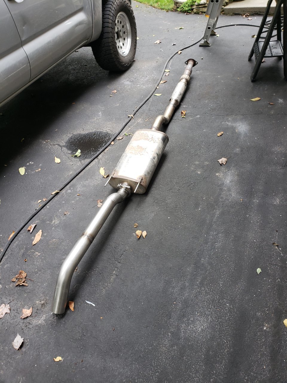

    And welded a new exhaust y-pipe back, 3in stainless, vibrant resonator, and same muffler as urd kit. Stinger style exit all the way at the end of bed, lots of tube but it kills a bit of the rasp and cab noise these trucks have

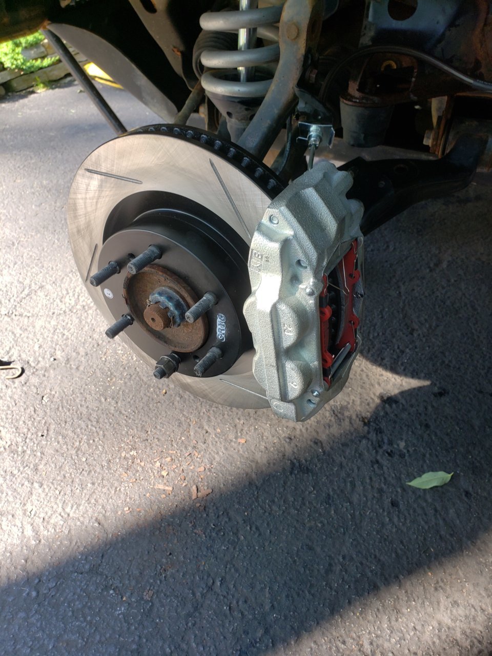

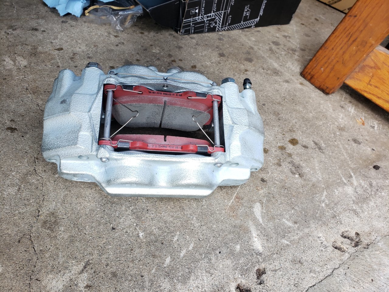

    Calipers:
    47730-60300
    47750-60300
    Rotors:
    126.44174CSL
    126.44174CSR -good stuff, LMperformance is where i got them. These are good but i'm getting DBA rotors next go round soooo
    Pads:
    PTR09-89111 -TRD
    Caliper mount bolts:
    90080-10213
    Pad spreader clips:
    04947-35050
    Brake lines from the soft line to the caliper(a good 'just in case'):
    47318-04110
    47317-04050
    Russell speed bleeders that fit: (makes bleeding a one man job!)
    639570 (1/4 in. clear plastic tubing helps a lot)
    (rear drums:639560)
    Redline RL-600 brake fluid to flush out some of the old stuff. I'm biased i use Redline errythang as of now but it's also just as good as the fancy Motul stuff at like half the price iirc
    Braided stainless lines all around
    Also
    https://toyotaparts.bochtoyotasouth.com/
    https://www.toyotapartsdeal.com/
    ---best prices by far - screw going to the dealer
    Found out one of my calipers was frozen up so i upgraded to 4-runner brakes. When i got my wheels i got 17s with the plans to do this in the future and finally got a reason to follow through. Much more bite than stock but the real difference is how much longer i can be on the brakes before i get any brake fade - a lot longer. Only big issue is the brakes are still drums in the rear so the brake balance is bad. I've been getting pretty good with left foot braking and light gas to control the pitch of the truck to combat this while goin fast out on the local track. All-in-all way more betta than it usta was!!

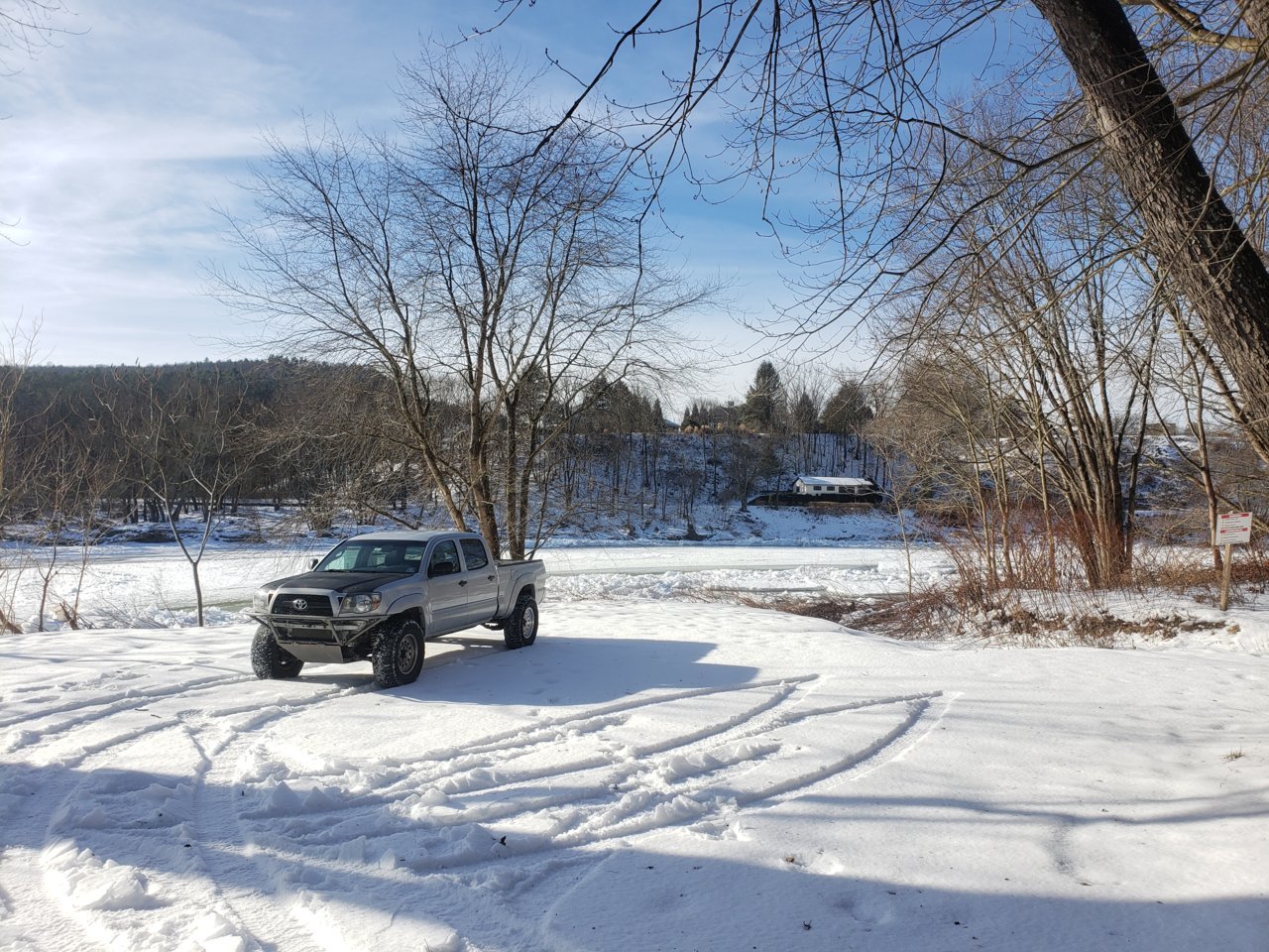

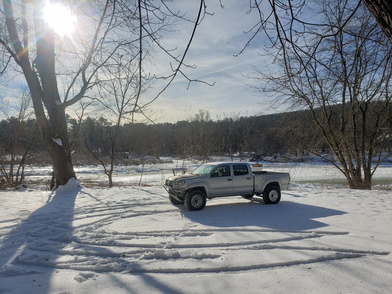

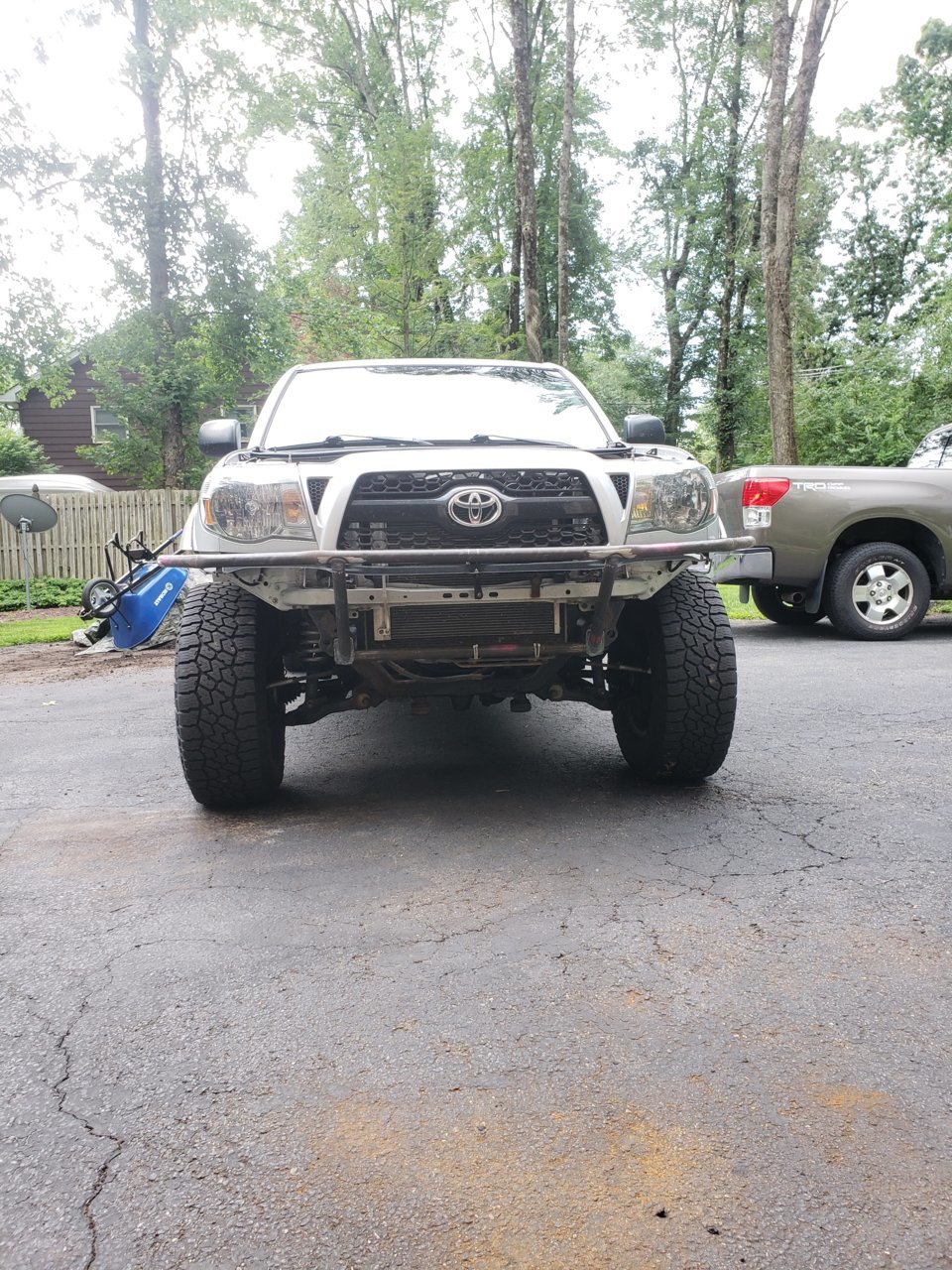

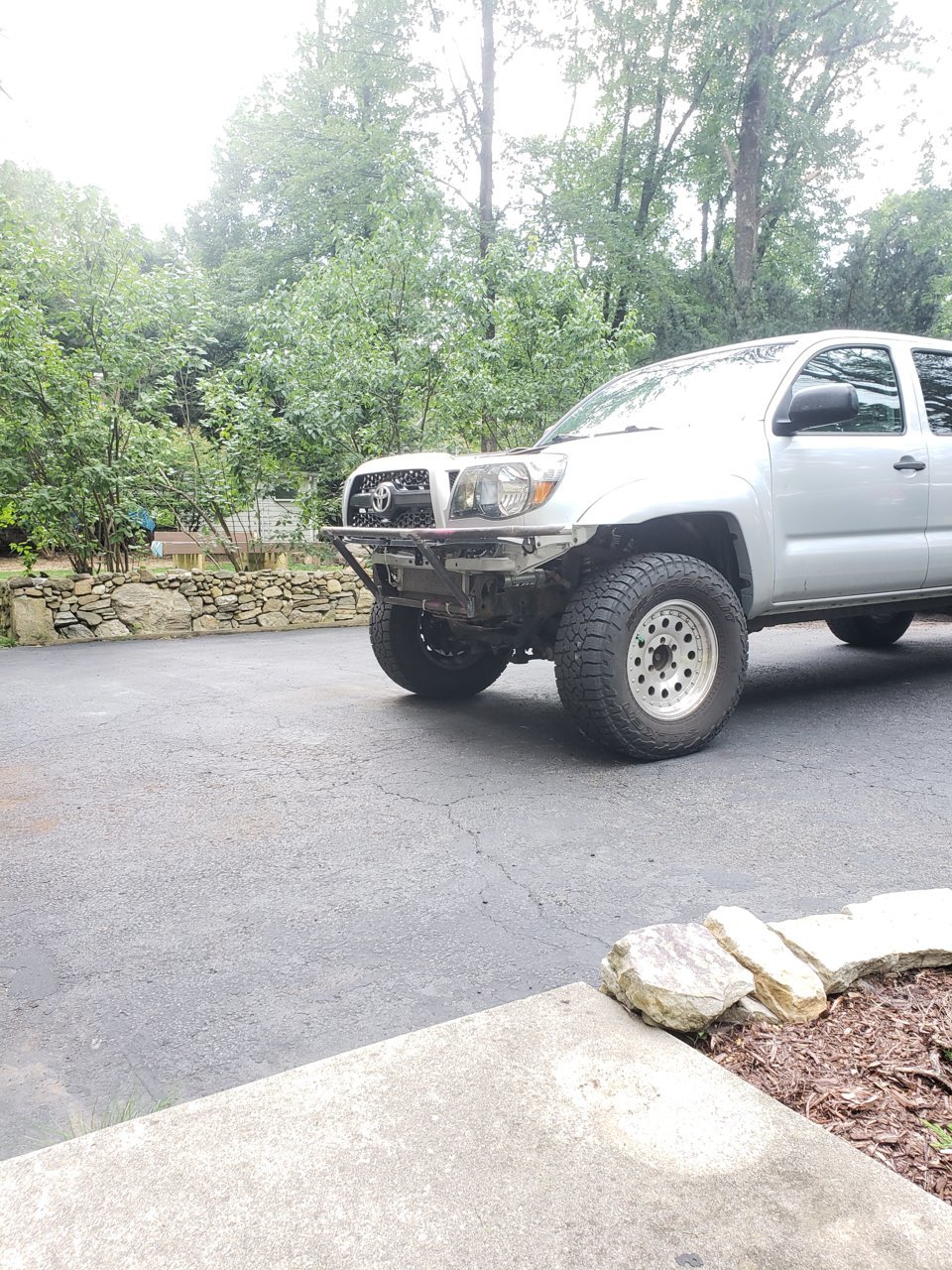

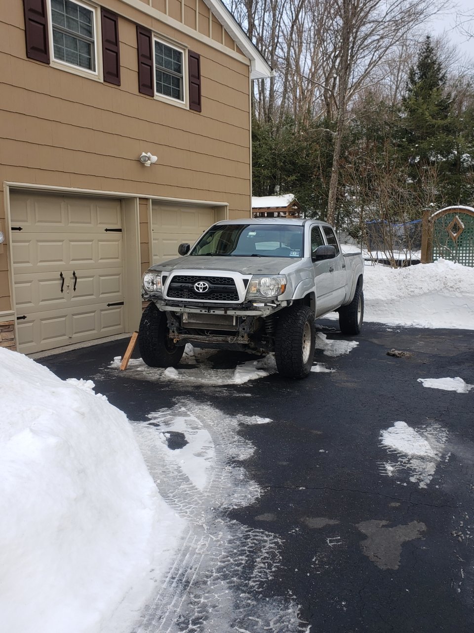

    30in of snow and my truck decided to get into a fight with a snow bank... .............snowbank won :burnrubber::goingcrazy::bananadead::notsure:
    Had plans to make a new bumper so I had pulled the support out a while ago, got a project in between and never got around to it. That upped the damage literally and messed up my grill too. So in a relatively redeeming fashion I used the opportunity to upgrade to a 2011 honeycomb grill. Not sure how much I like the color match yet. Also brings about 2 problems: 1. I really really gotta get around to making a new bumper. 2. Without the bumper tons of air gets caught up under the hood. The cf hood already shook around quite a bit on the highway, now it even bends a little and picks up air over the grille even. I hit about 70-75 and the truck literally wants to take off. I already had plans to redo the top layer of cf so its right and looks good this time. Along with plans to cut vents in the hood, but now I really really gotta get around to it. The big high pressure zones are in the front by the fan (the shape of the hood makes a little bit of lift by the top of grille too) and just in front of the cowl where the open space behind the engine is. I'm thinking cutouts like we're popular in Group B cars like the audi quattro or manta 400 style might be cool. The real deal would be to v-mount the radiator for prerunner-style bumper ergonomics and a reverse hood scoop like Peugeot 205 t16 or common to see on rx7s but thats severely ambitious.

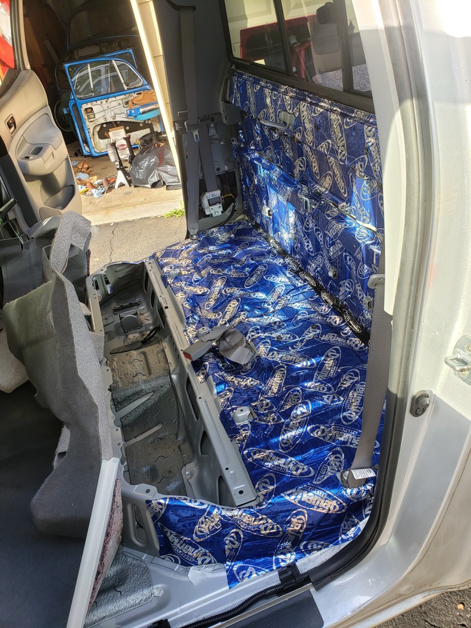

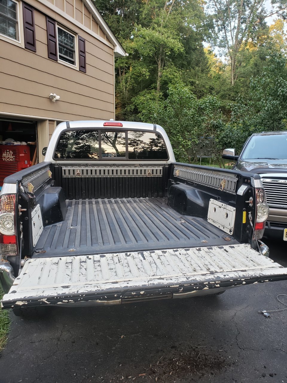

    Pulled the back seats a while ago for weight savings and to live my regular cab dreams vicariously through my DCLB. Don't plan on getting rid of this truck ever, so the dream of a reg cab extra long bed with the double cab roofline and access cab driveshaft will come to fruition eventually. Also more recently upgraded my battery to a LiFePO battery by Antigravity batteries. I'm real impressed with the weight savings 15lbs vs like 50-60 the stock group27 is; you'd think i would have a few scales by now with how much i like making my truck and wallet lighter. Couda sworn tacomas were left side positive so I got one that way but it's verrry snug. Right side positive would be the proper fit. Group24 40 amp hour

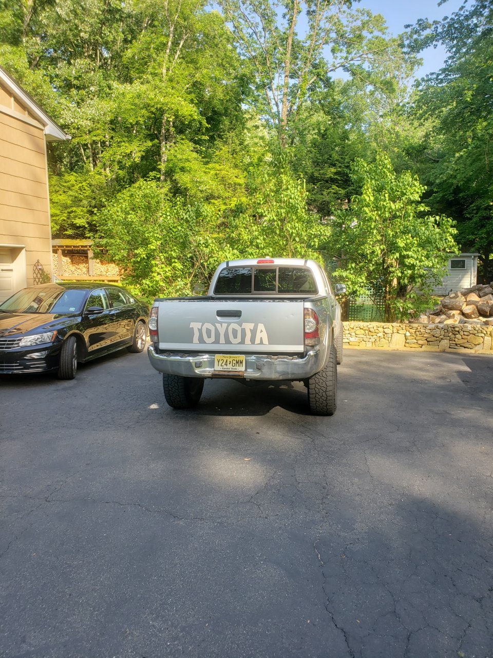

    Its a lightly modified version of font JI Burrito. Notable use in Los Pollos Hermanos logo. I'm a big font nerd. Not that I know em all by name n shit but I pay attention and like to see cool ones. Seen a little yota pickup on rt10 years ago with the decal font switched like this and it was a bit polarizing of a moment. I can't get the memory to unstick from inside of my head so this had to happen.
    Stenciled out and cut by hand. Laying out big pieces of vinyl like this is surprisingly difficult. Took a few tries on a couple of the letters. So proud of it

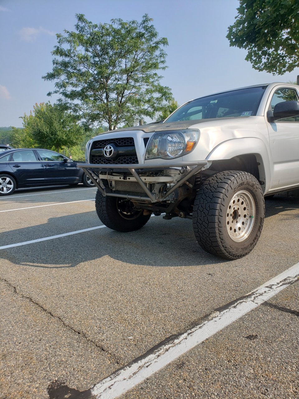

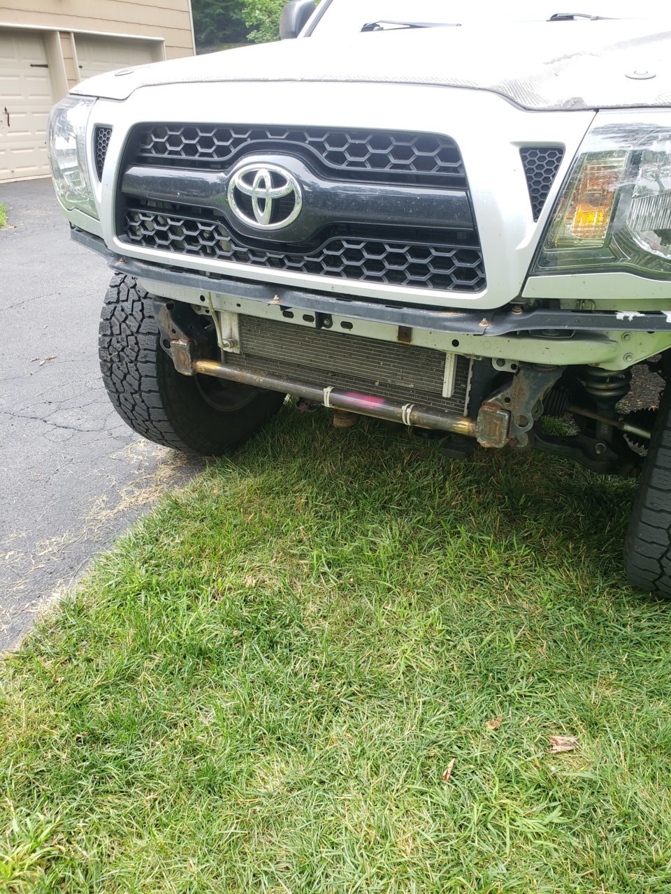

    Started the new bumper by cutting out and mo bettering the crossmember that hangs down in the front. Crazy how even cromoly flash rusts in just a few days around here. Though lotsa paint guys say that flash rust makes a good base for paint, which im not sure I believe, but it makes me feel better about shit rusting immediately so ill go with it

    A little wide and even when I pack the tube with sand the horrible freight pipe bender kinks the tubing a lil. Hard to justify the price of a proper bender for just my own projects so thats okay with me; room to improve

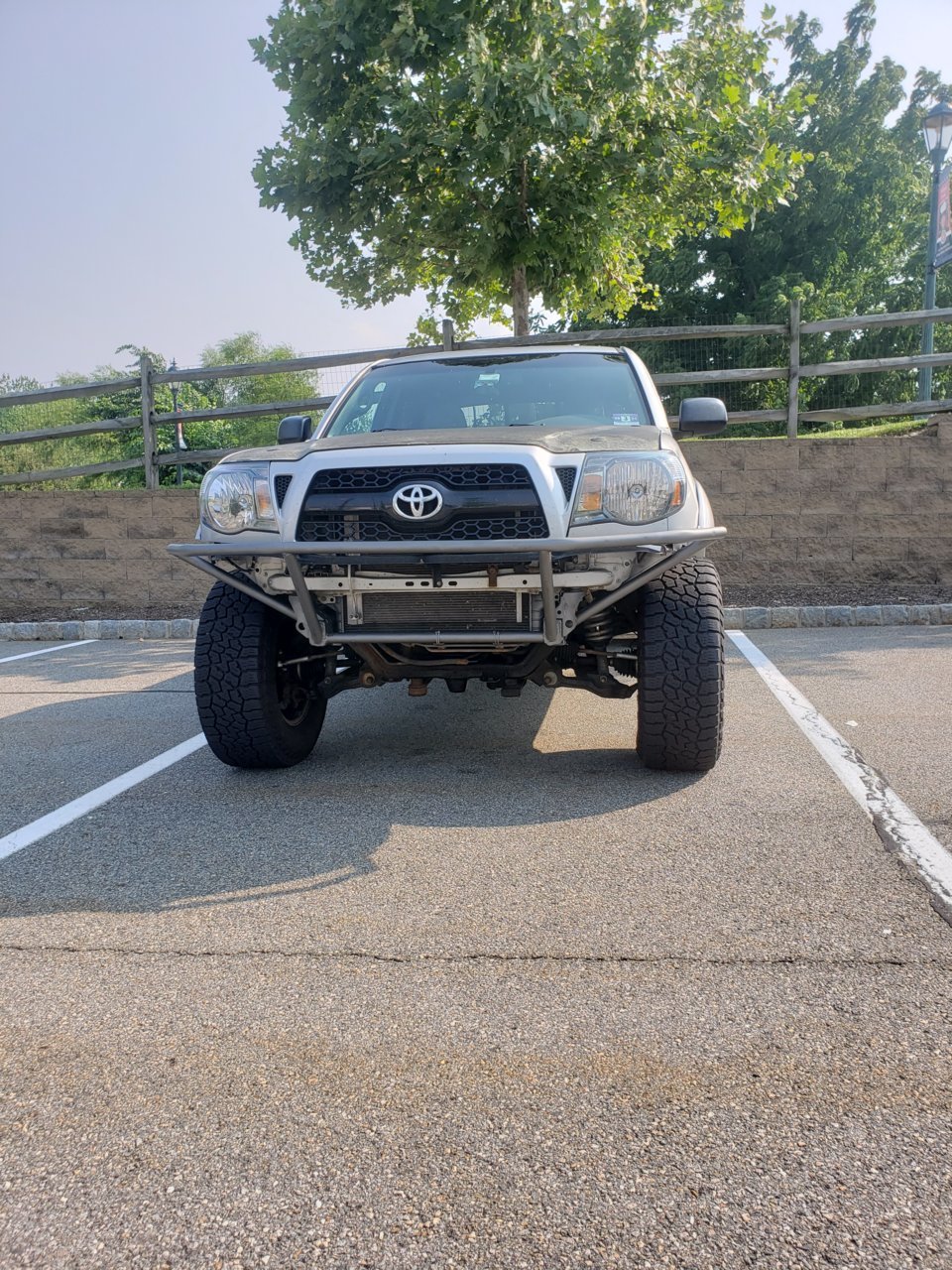

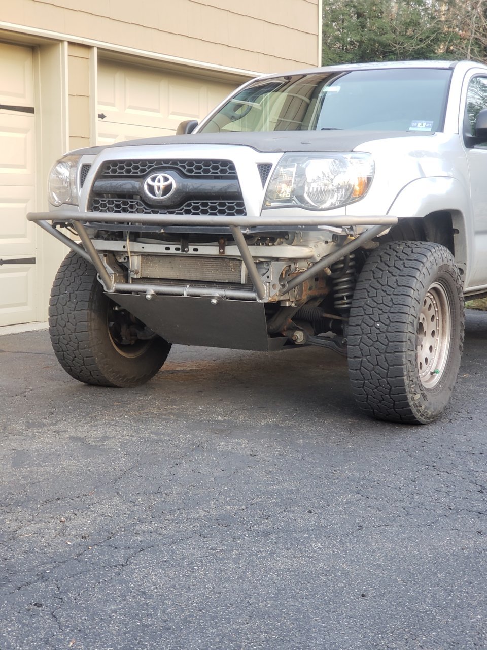

    The little tubes out to the side significantly helped reduce turbulent air in the front o_O Hood dun wanna move nearly as much when goin fast. Don't understand but not complaining. Just needa make a big ole skid plate and think of what I'm gonna do to fill the top part in front of the radiator, thinkin some kinda perforated metal or cf plate with vents cut out, idk
    'Face' of the truck looks like this now: :eek: haha

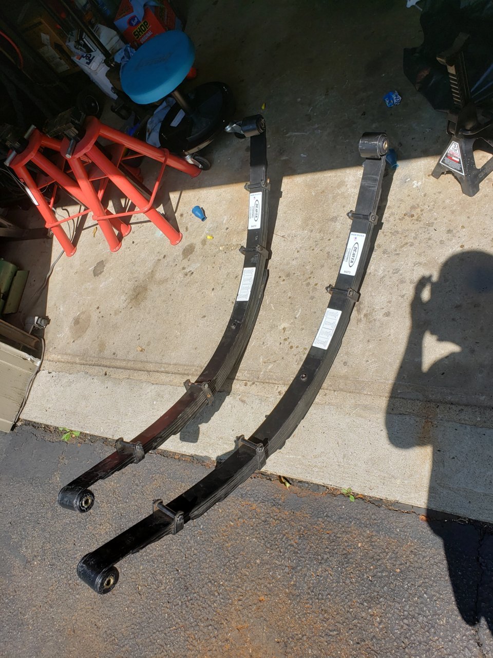

    Hmm.. maybe, just maybe, I need different leaf springs :goingcrazy:
    Maybe

    flash rust doesmakea really good base because of the texture, smooth steel never holds paint long

    Well that's good cause i din't really prep the metal at all. Woulda been too nice if i did that :D

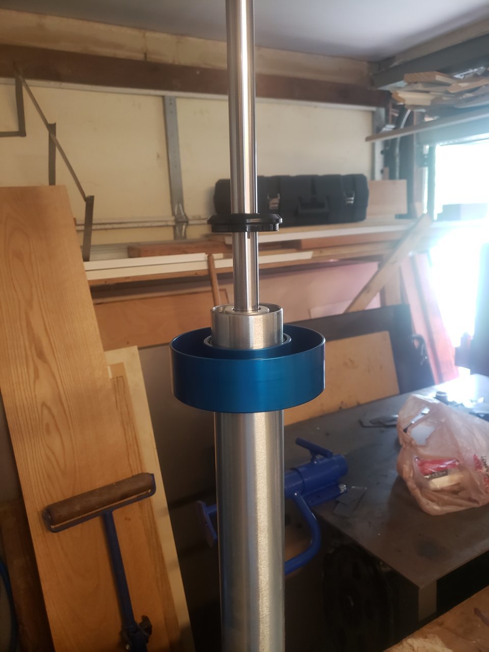

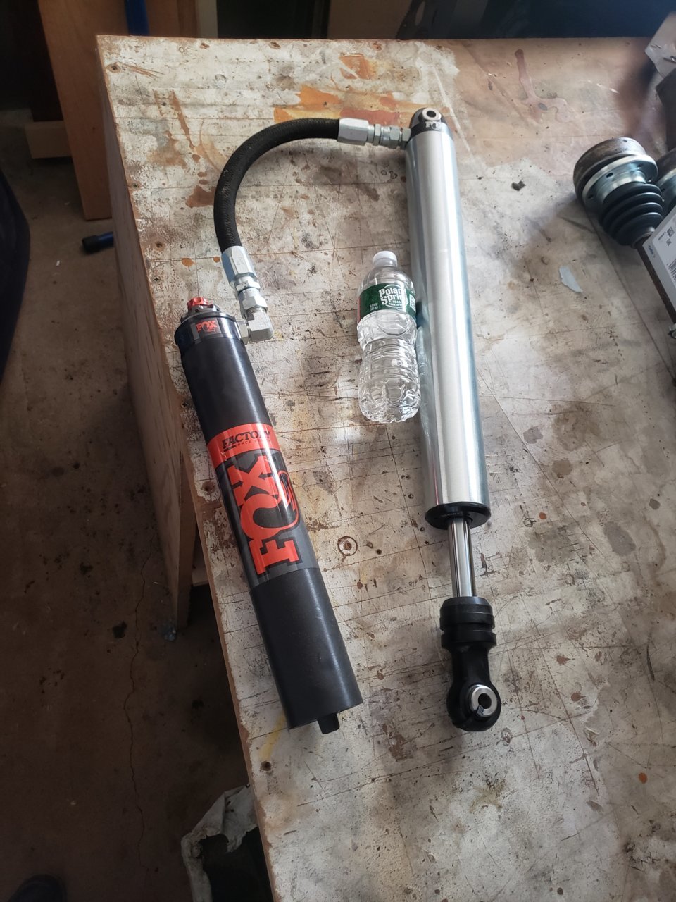

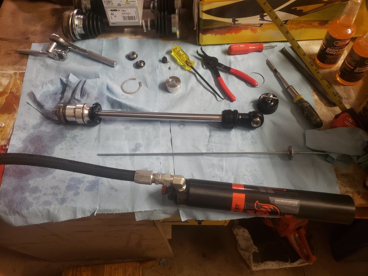

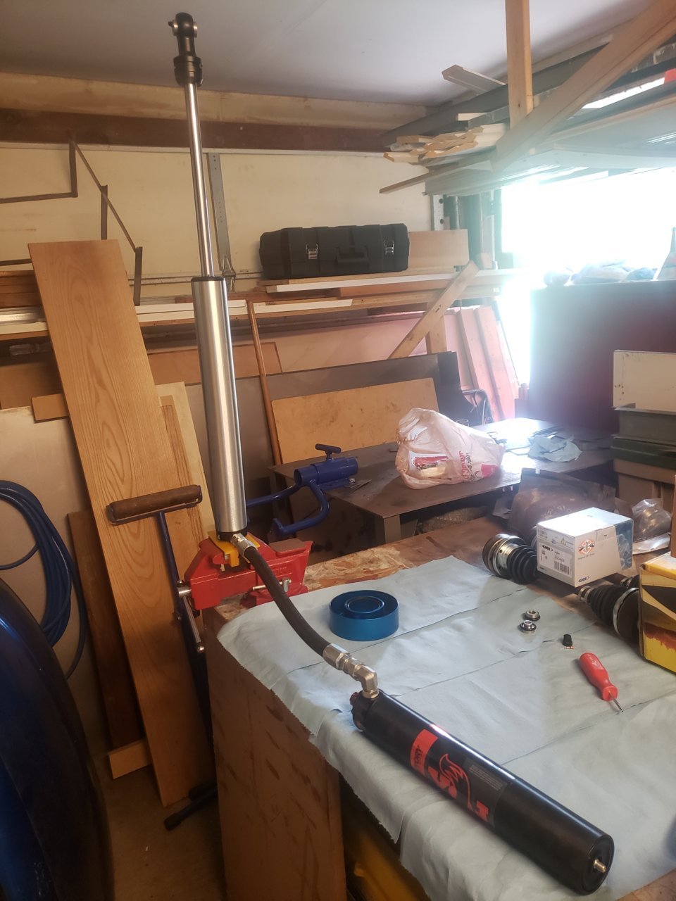

    Dun made a stupid and cycled one of my shocks without any pressure in the reservoir and got some air in the shock. The pressure sets the seal on the internal floating piston in the reservoir. Cycling the shock with only atmospheric pressure can pull air into the oil sometimes. This creates cavitation in the oil which eats up and corrodes the relatively soft aluminum parts in the shock. Big no-no and requires pulling the shock apart so the parts can be cycled to bleed the air out of the shock oil. Not that bad for me cause I want to get into shock tuning and rebuilds so it gave me a decent excuse to open the shock up to have a look around and get familiar. Fox 2.5 x 14s with DSC adj.. Pics don't quite do justice to how good quality and just how big they are

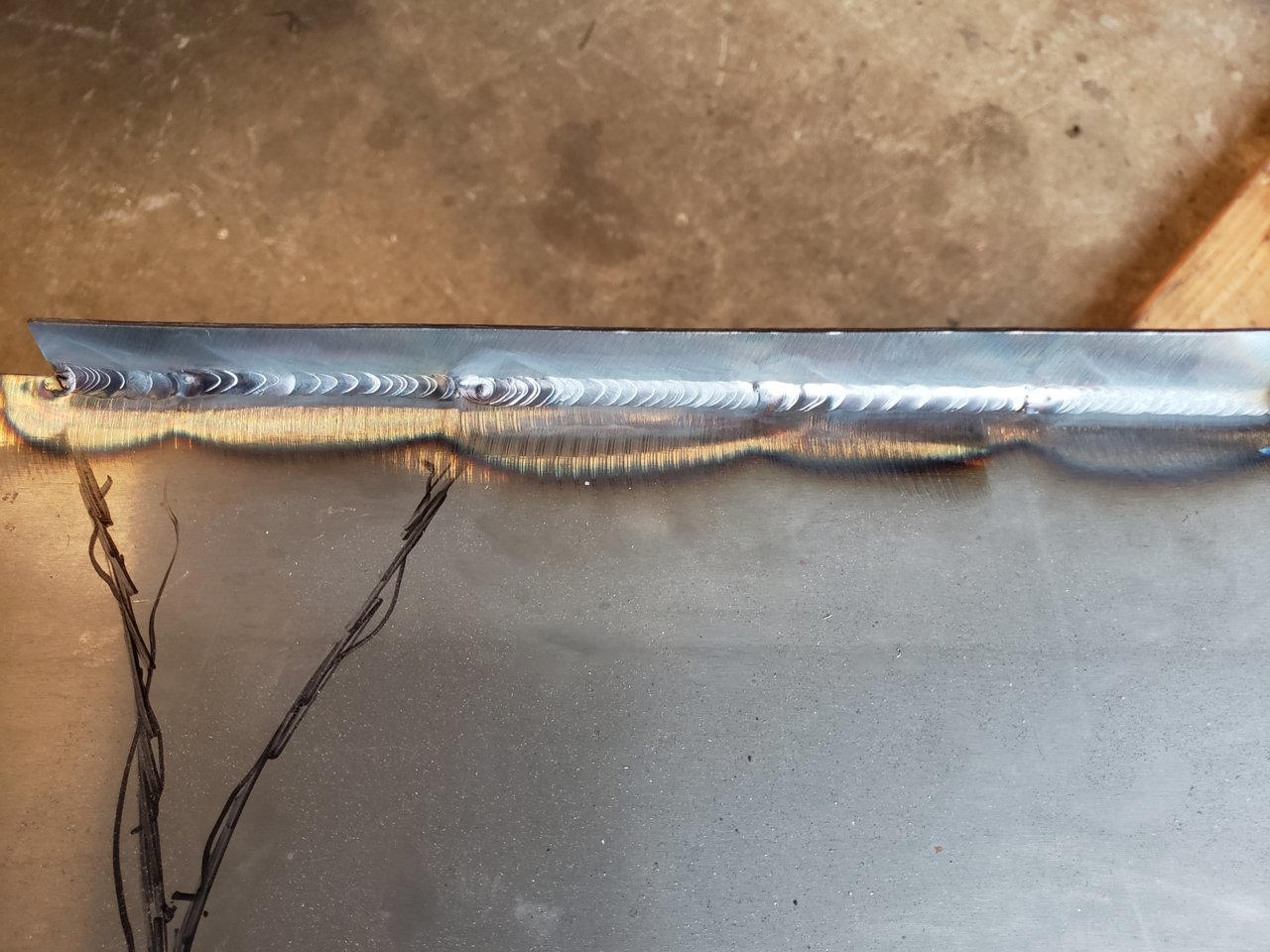

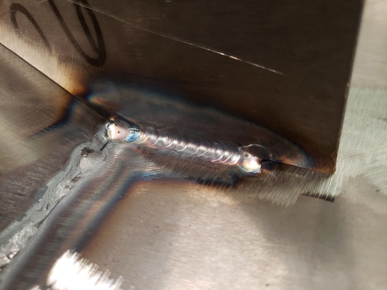

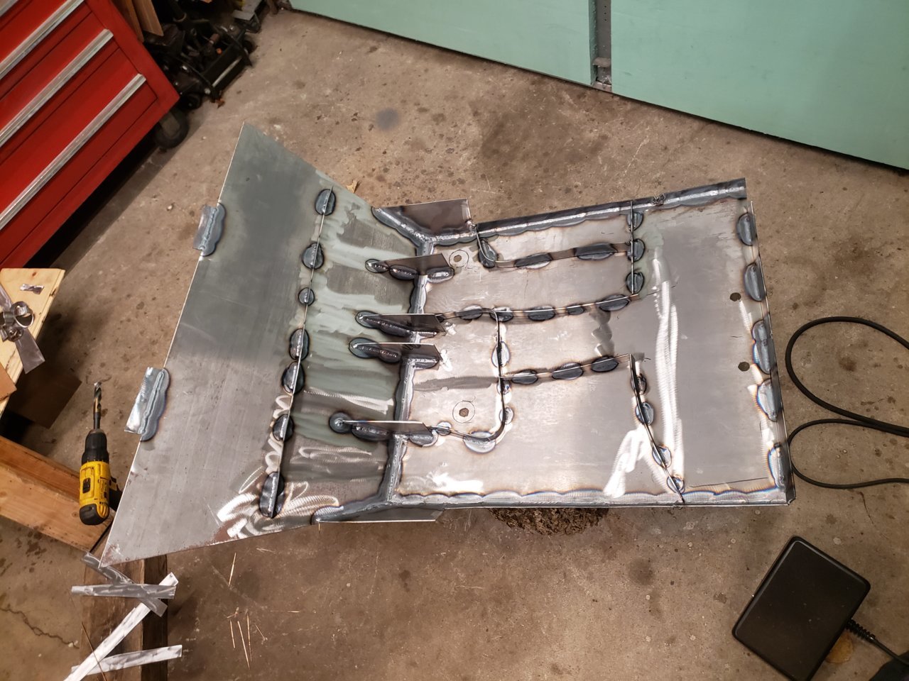

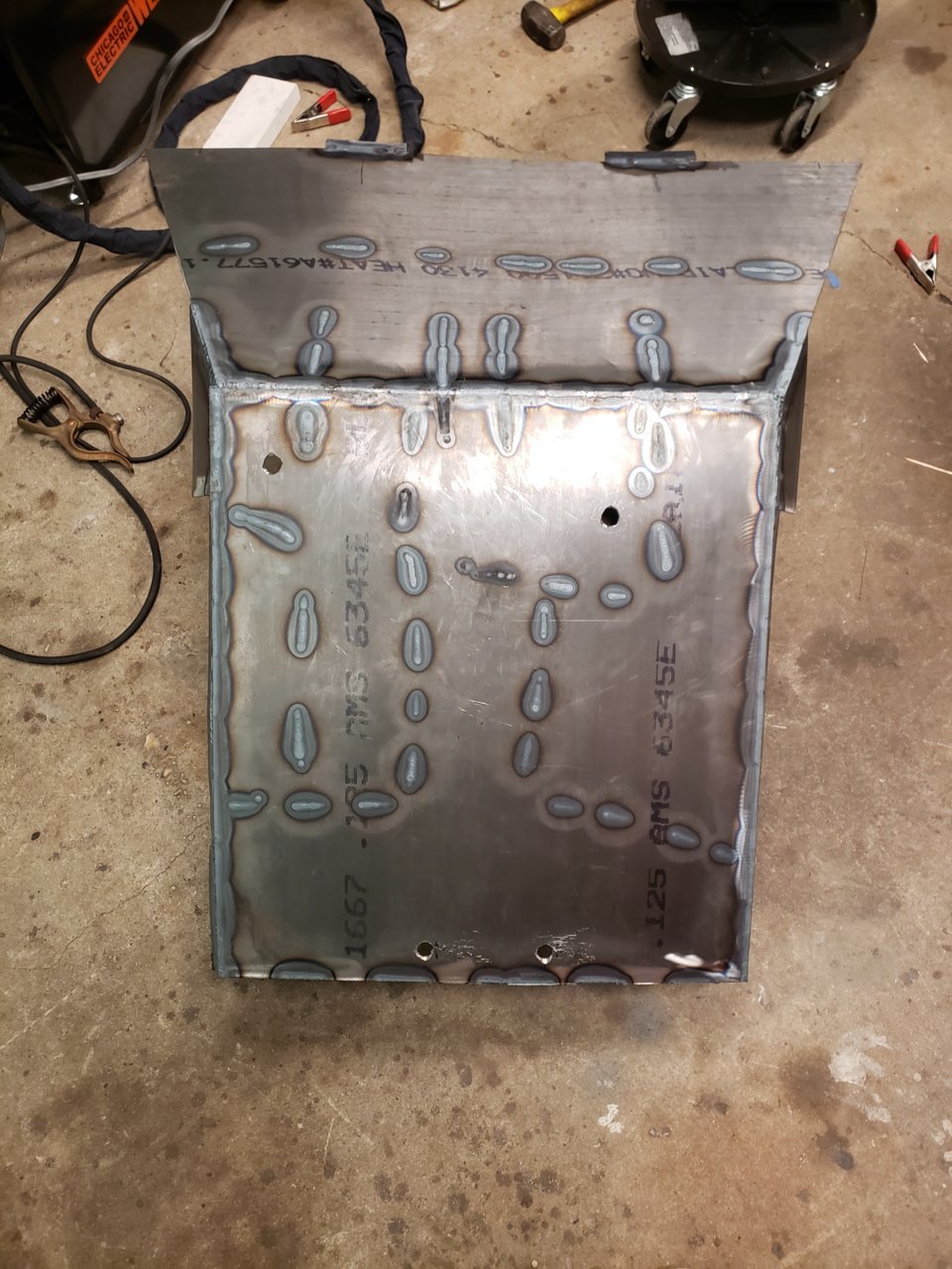

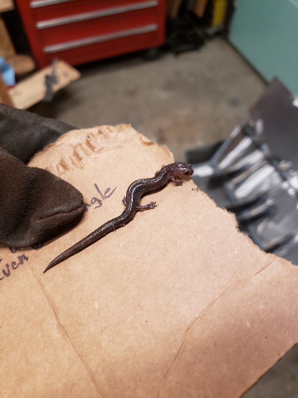

    Skid plate got done just in time for winter. Bit of a hack on some parts but the cold weather was coming fast
    All chromoly to keep it light/strong and slightly more rust resistant --MO on many of my mods. The bottom sheet is .125 the rest is .090 wall. Way easier to cut and work with thinner material so I stick with thin stuff and add lotsa gussets and structure to make up for the thinner material choice. Don't think it'll hold the entire weight of the vehicle for long, I'll take it off to jack the truck up, but it surely will for a little while if necessary and should handle big hits fine.
    Welded little standoffs from the frame with captive nuts to hold it. No pics now, I'll post some when I get them. Thinking up a way to get through bolts in the frame somewhere and climbing up under the truck with 2 ratchets would be too much so in this case it felt pretty intuitive to do captive nuts
    Had a lil pal to help me out with the work. Eastern red backed salamander. They are cool they breath through their skin and can shed and regrow their tails to fend off predators. Common here but I don't see many. I think the light from the welder draws em out cause they're around a lot when I'm welding at night
    Good opportunity to mess around with different weld strategies. I'm getting a lot better so I got that goin for me, which is nice :oops:
