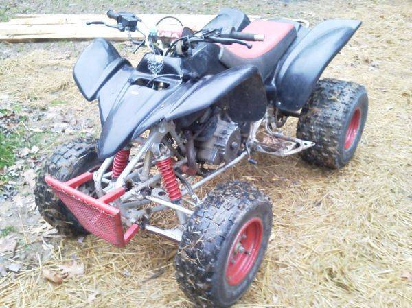

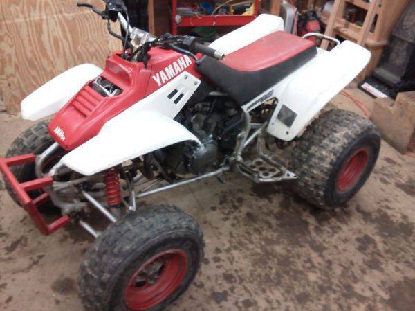

    A friend and I were looking for winter projects and found an ad on Pennswoods the other day and went today to pick up these machines. A 99 warrior, 2000 warrior and an Kawasaki Mojave. $750 for all 3!
    "Running" warrior needs timing work, other warrior is a parts machine. Mojave needs a crank and is my buddy's project.
    How it starts:

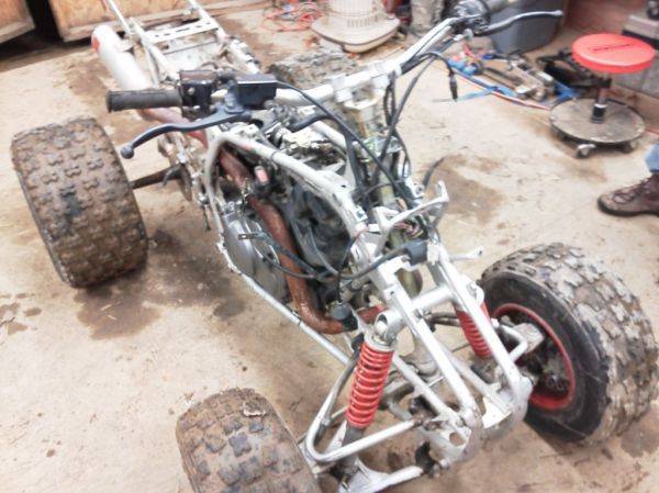

    Tore off the plastics and front bumper last night. Waiting on repair manual to show up and then it'll be on with the actual work!

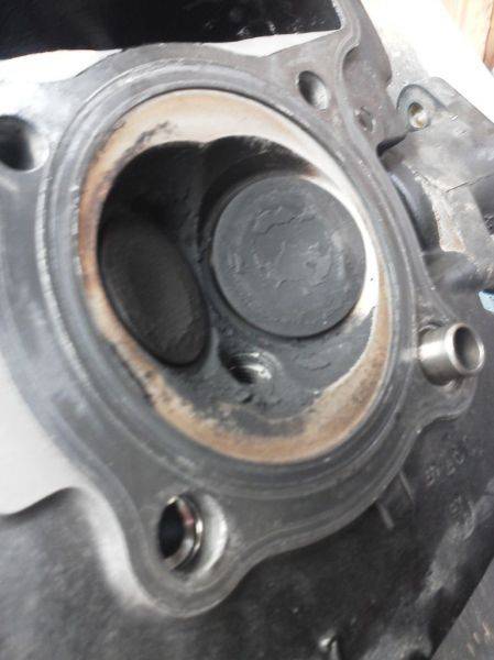

    Alright another update: Installed keyway last week, still wasn't firing. When we tried to fire the gas was blowing back through the carb. Ran a leak down test last night, heard some air pissing and yanked the head. Come to find a hell of a bent intake valve. No apparent damage to piston so I'm gonna yank the head on my parts machine tomorrow and drop it in. Hopefully have the bitch running soon!

    Big negative update: spare head was pulled quickly and easily. Took intake valve out of both heads to swap because one of the exhaust studs was broken on spare head. Once removed from original head we noticed the valve guide was broken. So now tonight I am going to try to remove the stud from the spare head. Wish me luck lol
