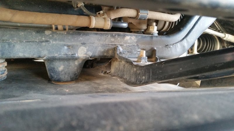

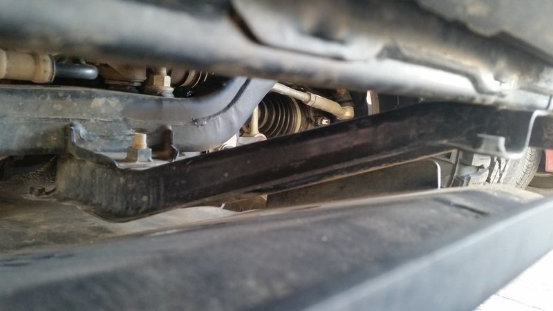

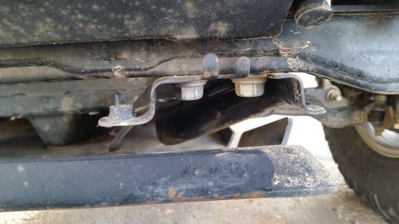

    Well got these a little later then in planed. but here are the pics of the brackets ryan. Let me know if you need anything else.
    Front
    Full side pic
    Best pic I could get of the back without pull my IFS and mid skid.
    If you need me to pull the skids I will though. I hope these pics help you out.

    I guess if I don't have them all I would really need is to make some sort of spacer that goes from here to here (drew a little red arrow in the picture)
  9. Jan 23, 2016 at 8:07 AM
    #409
    Night Eagle
    Night Eagle [OP] Aka Mountain Goat or mr. Clean
    Mar 22, 2014
    #125893
    2,714
    Leo
    Steamboat Springs, Co
    2014 TDR Off Road
    Enough to make it a lot of fun!
    So that measurement is 1". The back is 1.75" if you want it. But it doesn't touch the skid. But the whole angled part is touching the skid. If it was me I would weld the bracket to the skid. So you don't have to deal with it all the time. Granted the brackets are bolted to the Fram already.

    You rock Leo! Thanks. So you think I can get away with just having the 1 inch spacers over the front bolt holes?
  11. Jan 23, 2016 at 8:27 AM
    #411
    Night Eagle
    Mar 22, 2014
    #125893
    2,714
    Leo
    2014 TDR Off Road
    Ya no problem. Ya you can get away with just that. But I would do some kind of reinforcement on the angled part now.

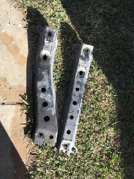

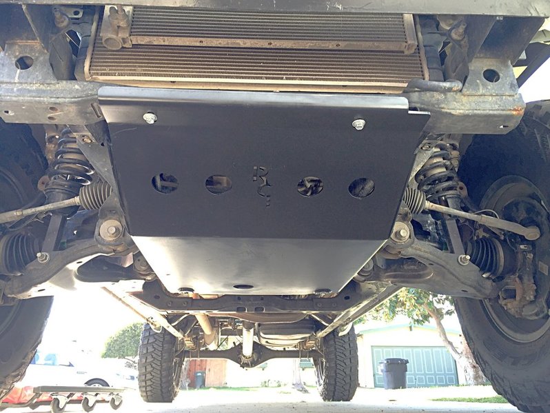

    Guess what I found in my garage trash!!!!! Wooooooo!!!

    Bolted up sooo easily after that. Thanks for helping me out man!

    Sweet man! Glad you found it.:thumbsup: RCI skids look really clean.

    I really like it and it fit perfectly!! Glad I don't have to worry about slamming there anymore
