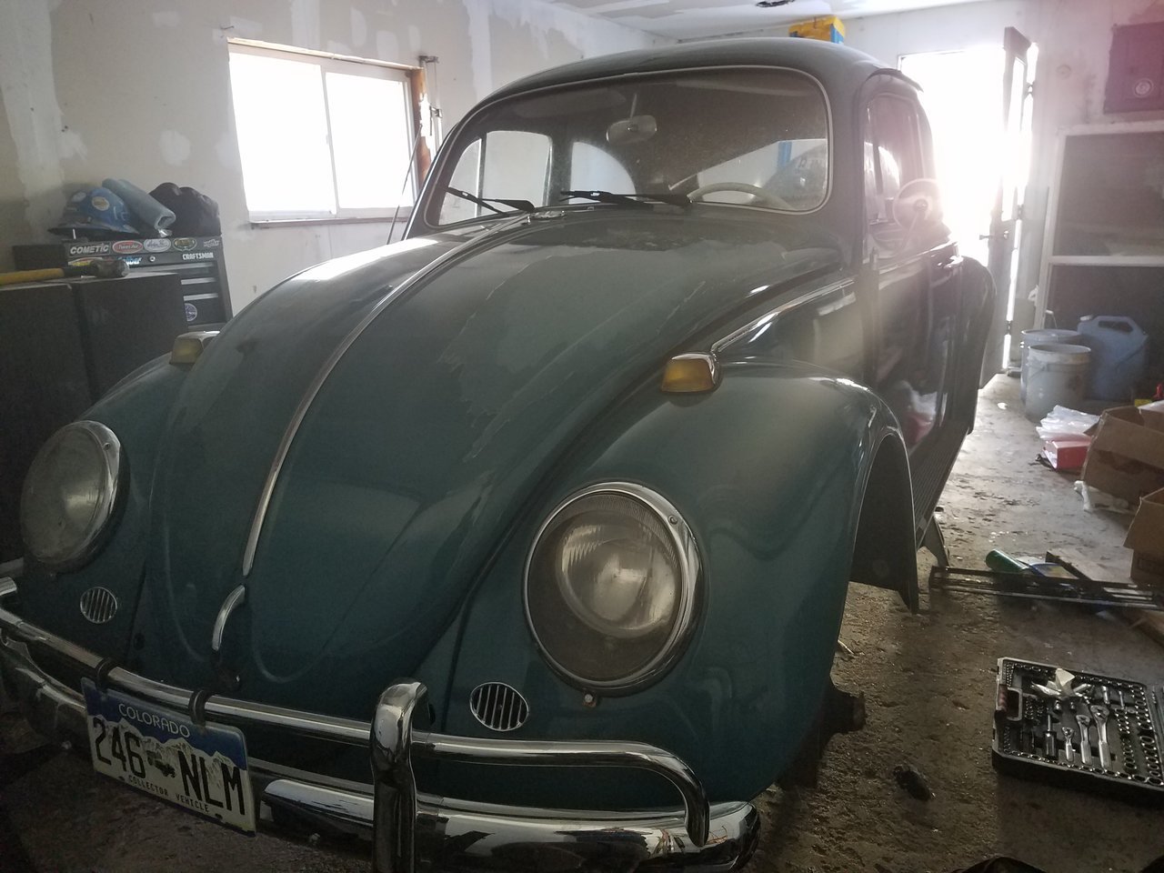

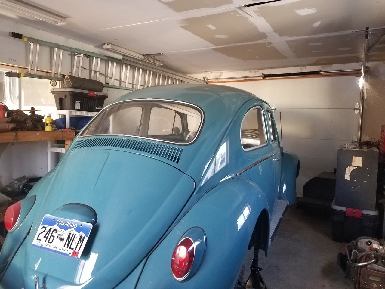

    Hey just so everyone knows I am still alive and have some truck parts on order. But the main reason for this post is to finally posting some pics of my DD build.
    It is a 64 VW bug. It has a 71 bus motor in it. Which means it has 300 more CC's then stock and has been converted to 12v. So I still need to replace all the shocks, king pins, gas tank, battery, and just go through and make sure it runs good. This is my car from high school and has been sitting for about 6 years, so she needs some love.

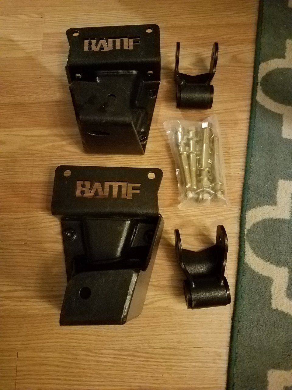

    Well these guys arrived today, now just have to install them tomorrow.

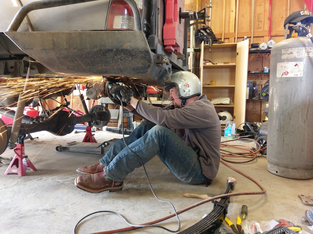

    You may be making fun of me but you ended up using that helmet also.

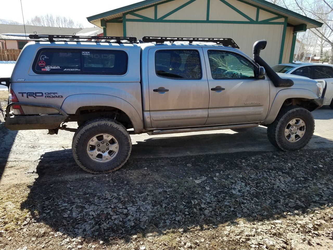

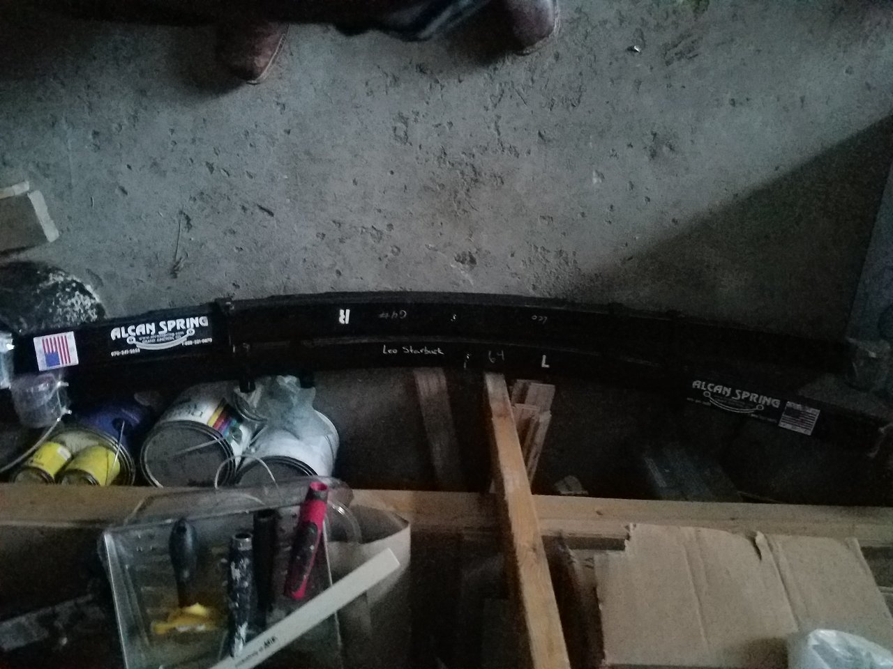

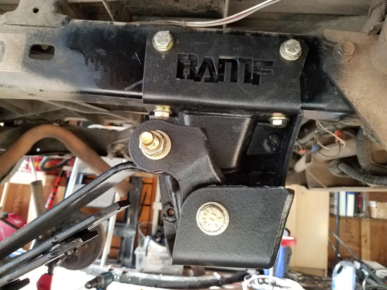

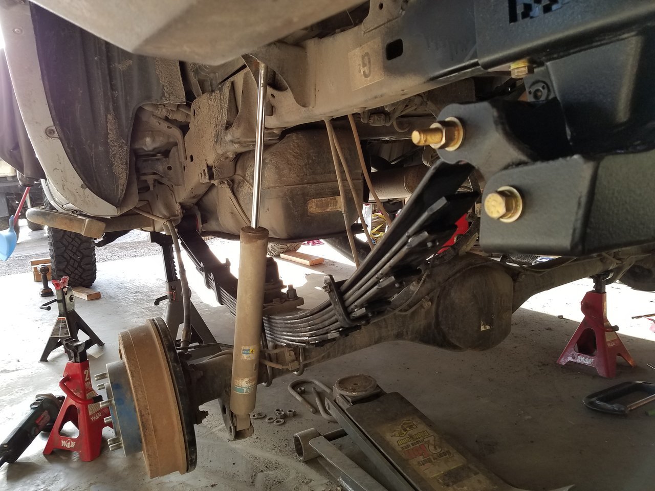

    Ok time for the right up.

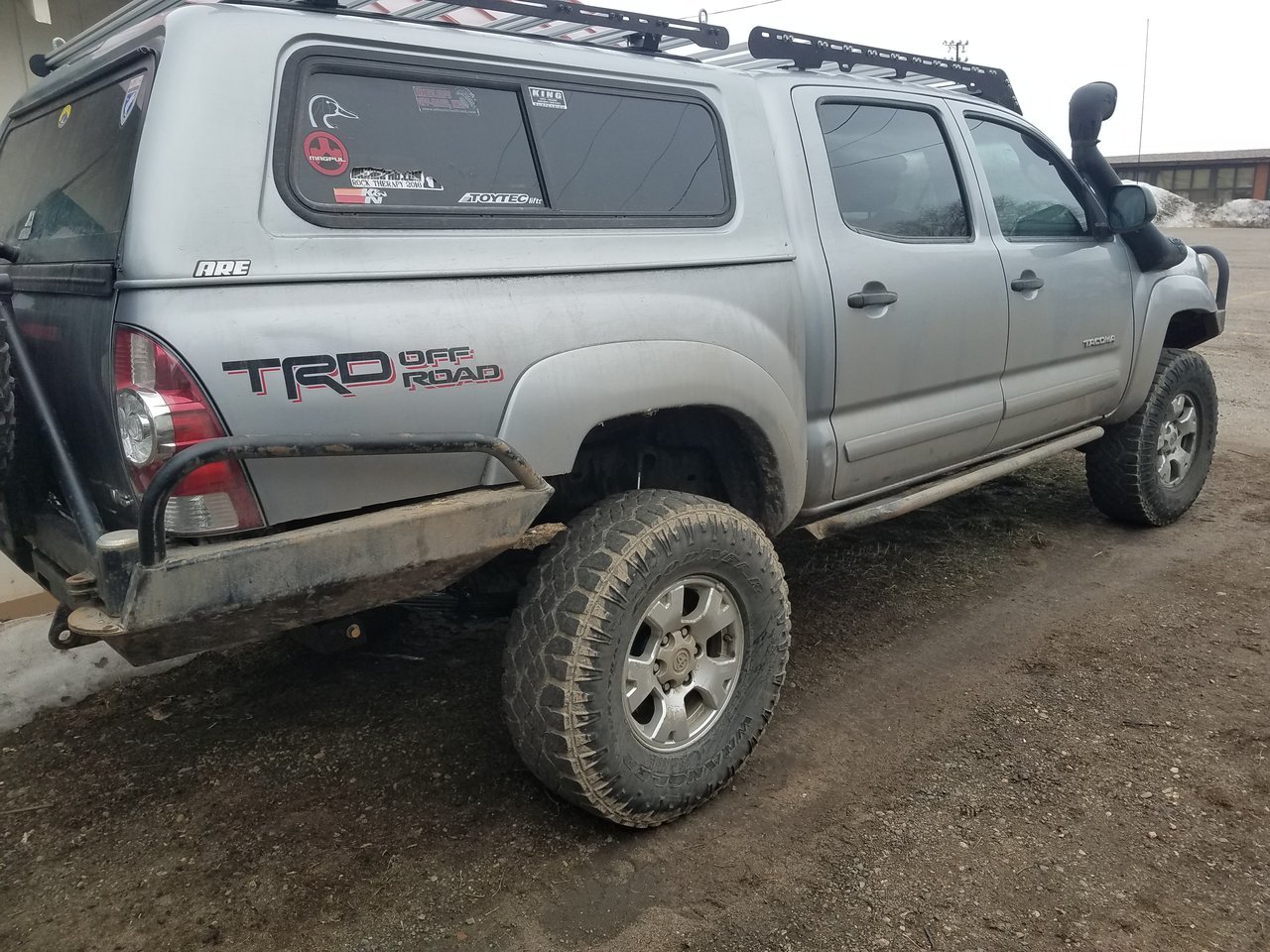

    So yesturday with help from @Squeaky Penguin I put my BAMF HD shackles and shackle hangers and my new Alcan leaf springs. The hangers turned out to be a little harder to pull off then I thought. So each stock hanger has 4 rivets holding them to the frame. BAMF says you need to cut the bottom part of the hanger but you don't, just cut the visible rivet heads off and then take a bfh to them and they will pop off. Now to get the rest of the rivets out of the frame. You will need a couple different size punches and a few different size still bits to get them out. The rivets on the side of the frame are pretty to get out but the ones on the bottom are a pain. The main issue with the bottom ones is that rivets are also tacked to the X brace that is under the bed. You will want a c-clap to hold the x brace to cram as you beat the rivet out of the brace. Forgot to mention you will want drill about half way through the rivets before you start beating on them. Once you have them all out you will want a 1/2" drill bit to open the holes up just a little for the bolts. Once you have this all done start bolting everything up.
    Before pic
    After pics
    So I gained about 3" of lift before settling so I figure after settling I will have about 2" of lift. That isn't the best part I gained 4-5" of down travel.
    Now I am in serious need of a shock relocate. My new leafs have more down travel the my shocks can handle by about an inch.
    So everybody knows the next step. Find a shock relocate that I like and order some shocks with the right travel, and most importantly save the money up for it all.

    how is the rake ? it looks to be a bit of rake now. looks good leo. id like to do this too
  17. Mar 18, 2018 at 1:44 PM
    #797
    Night Eagle
    Night Eagle [OP] Aka Mountain Goat or mr. Clean
    Mar 22, 2014
    #125893
    2,714
    Leo
    Steamboat Springs, Co
    2014 TDR Off Road
    Enough to make it a lot of fun!
    there is a good bit of rake now, which I like a lot, I had no rake with my old pack. Granted I did have rake when the all poo's were new. To me it feels more like a truck now, with the rake. I will have to let you know how they hold up but I am sure they will be worth it.

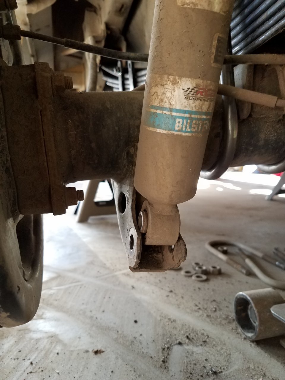

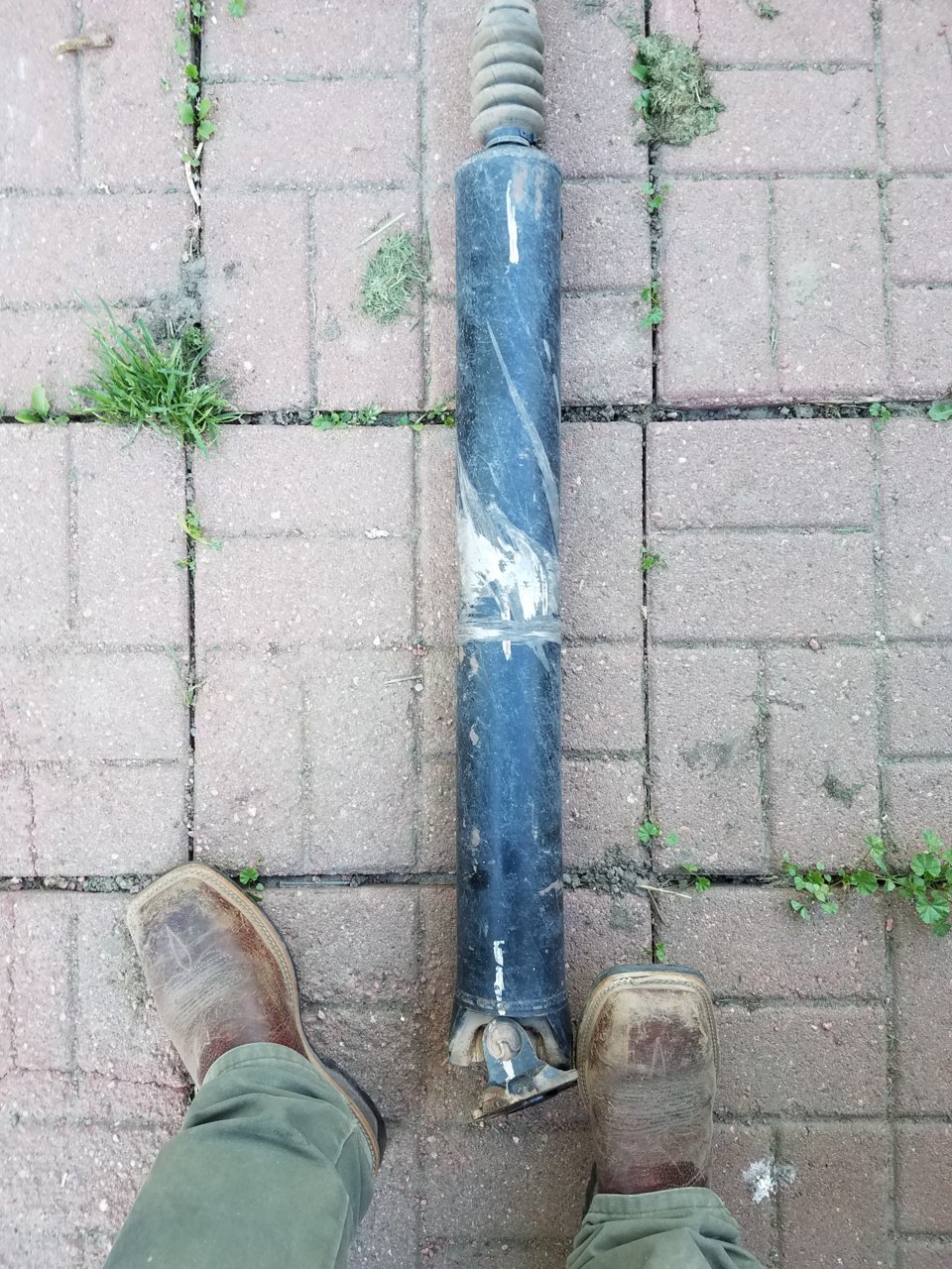

    Got home on sunday from a ten day trip through Arizona and Nevada, with @Squeaky Penguin , @Wishbone Runner , and @Reh5108 . Was an awsome trip and hope to get some pics up this weekend. I had a couple miss haps on the trip, I ran into a rock destroyed a tire and busted a cam tab gusset off. After busting the gusset my alignment kept moving around, which led me to jack the truck up and found an upper ball joint was shot and had to change that. The day after changing the ball joint I got in contact with @snowsk8air2 to weld my tab back together. So a big thanks to Ryan for helping me out in pinch. Also on the second to last day I found my driveshaft got beat to crap at some point but not sure where.
    It was no longer round in the silver spot but more square.

    Also a big thanks to James and Brett for helping me fix my truck.
