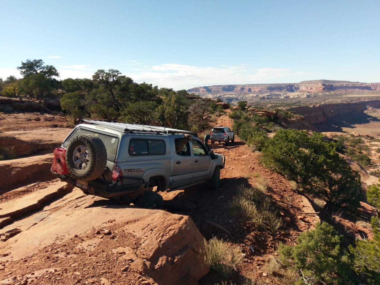

    Yeah my buddy gave it a shot in his rubicon on 37's and just had the wrong wheel base for it. My atrac had stopped working so I was "open" in the front and didn't even bother rolling up to it lol. It's nasty looking. Short wheel base and narrow looked ideal for making it up, or a massive rig on 40's+

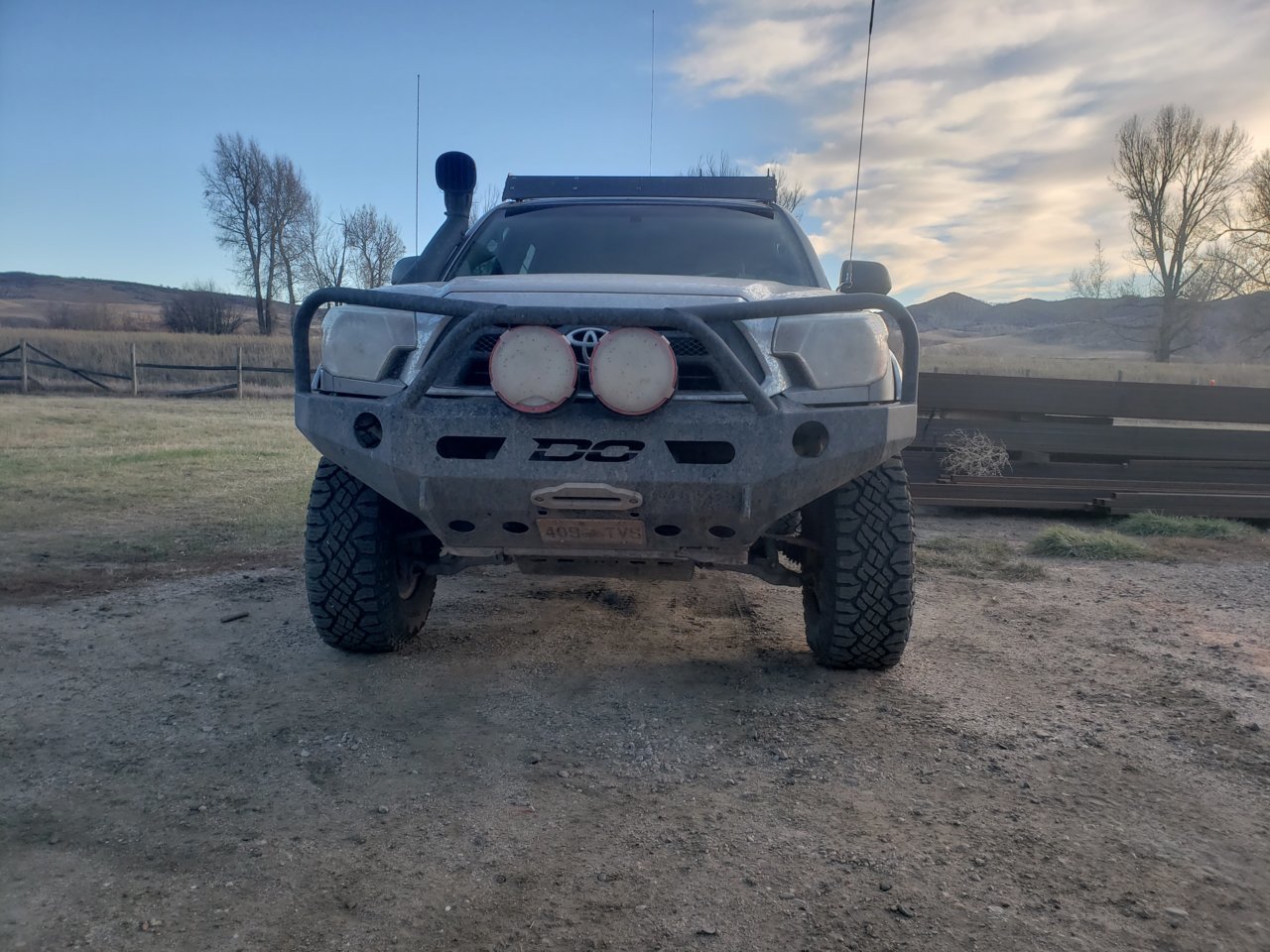

    So the main objective for the weekend was to get some new PIAA Ion fog lights put in my bumper. I had been running square LED lights as fogs but since moving back to Steamboat I have found I hated them for the snow. I have had the lights for about two weeks now and was not able to install without a little modification to the bumper. So I went over @Squeaky Penguin house to pull the bumper and weld some new tabs into place.

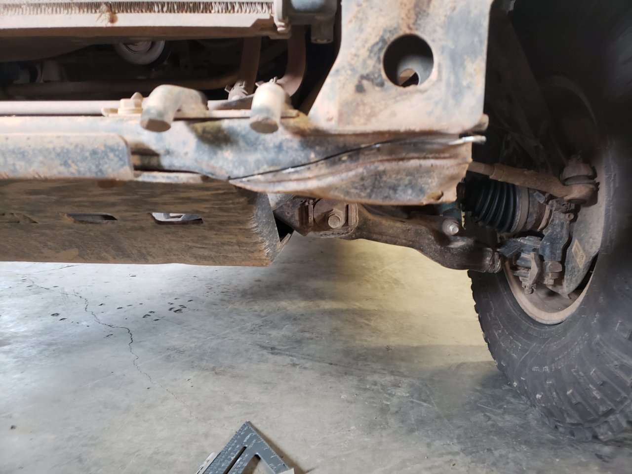

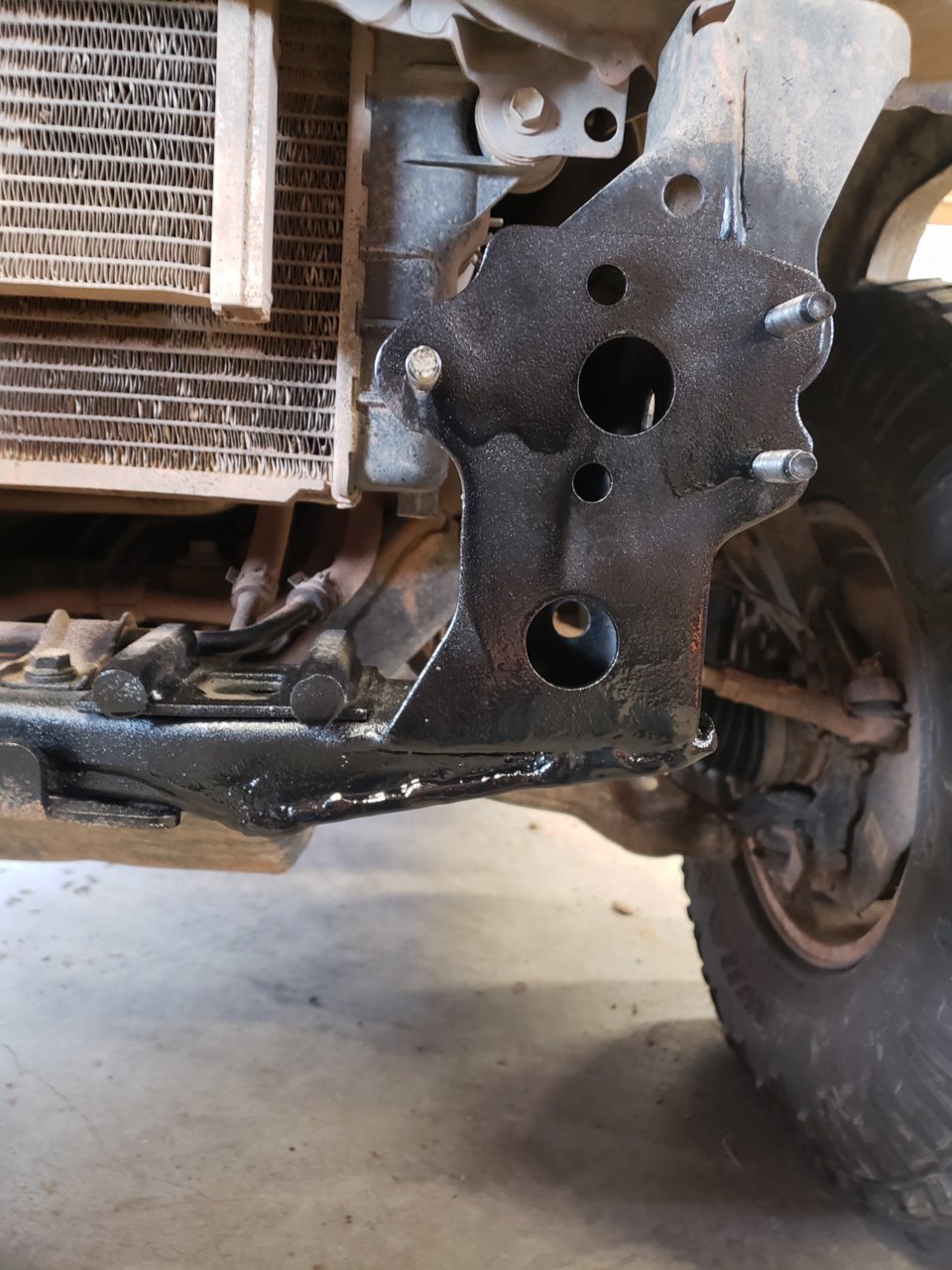

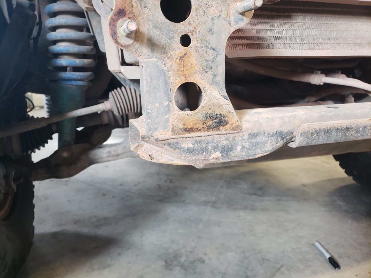

    Well after we got the bumper off we start looking at my front end and decided to finally do project I have talked about for about two years now. So everybody that has a 2nd gene knows the crossmember that you front skid bolts to is a nice rock buster. So the ends of mine were starting to look a little worse for wear.
    So I have always wanted to chop the lower half off and then plate over it, that is exactly what we did.
    So now when I go wheeling I wont be making that crossmember even worse then it already was. Oh and I love my PIAA fog lights so much more then the LED ones. Now what to do with my old fog lights. :notsure:

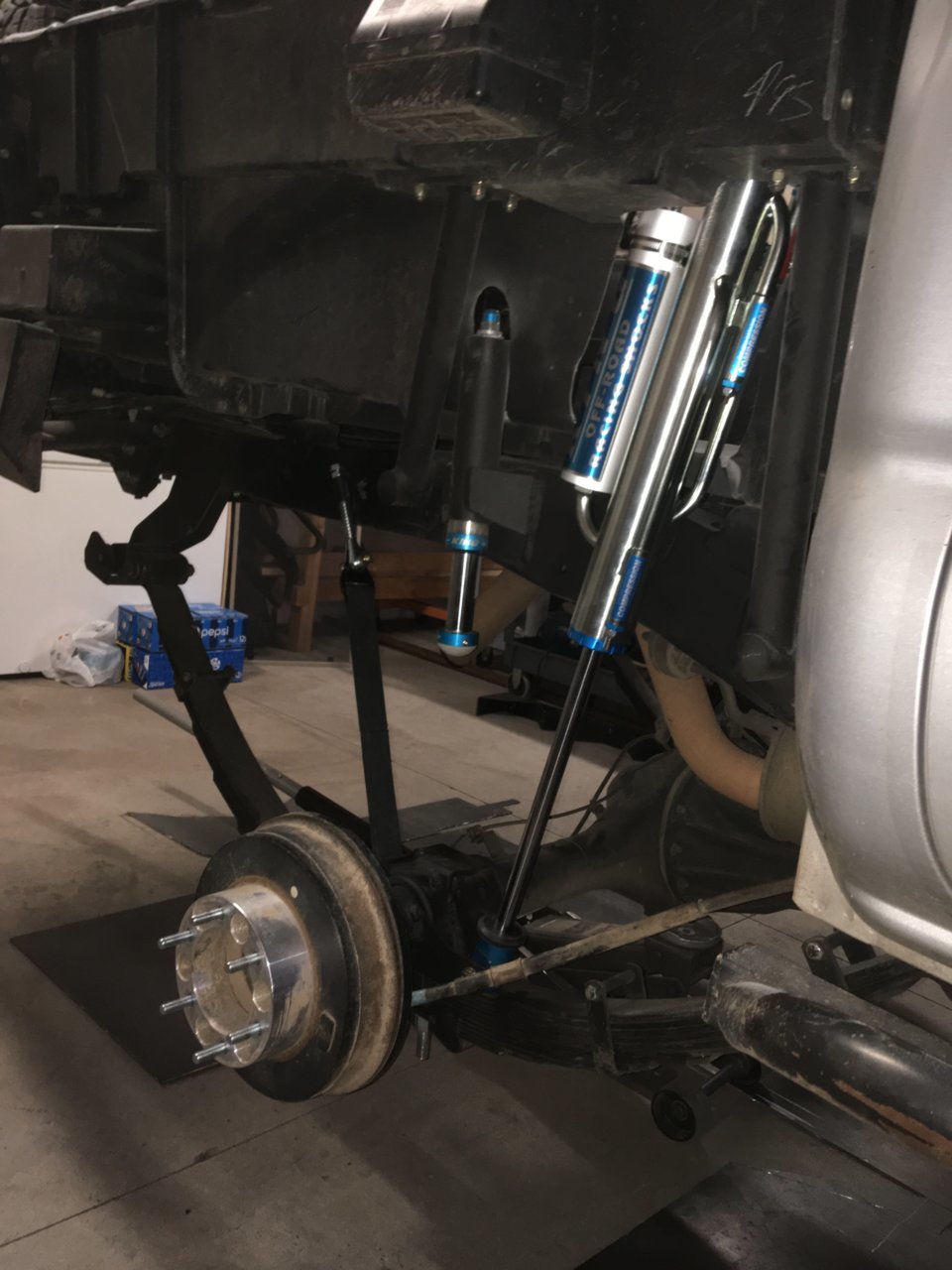

    Me and my truck should be a lot happier this next wheeling season. Got some fancy new 2.0 King 12" smooth body shocks on order from DSM. Sadly I missed out on their 10% for November because my paypal account got locked down because somebody hacked it but got it all taken care of today. But oh well that is life, so time to move on and get excited about doing a shock relocate this winter. :bikewhoops: :dancingbacon::broccoli::jellydance::kona::bananadance::taco::yay:

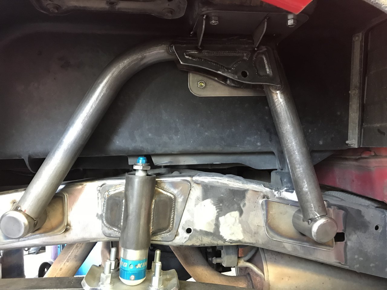

    Ya those aren't bad but I am going to fab up some mounts like this.
    I really like the look of tube mounts under the bed, and I like the fact these tie into the bed.

    Those will work perfect as well. Plus you have a fun fab project. Also don't necessarily need to remove the bed for these.

    To me these seem a little more bullet proof then the BAMF ones and allow for future growth or revisit if need be. This will be the biggest fab project that I will have ever done on my truck so it should be interesting and hope it goes ok. Not having to remove the bed is one of the nice things about doing a relocate on a 2nd gen.
