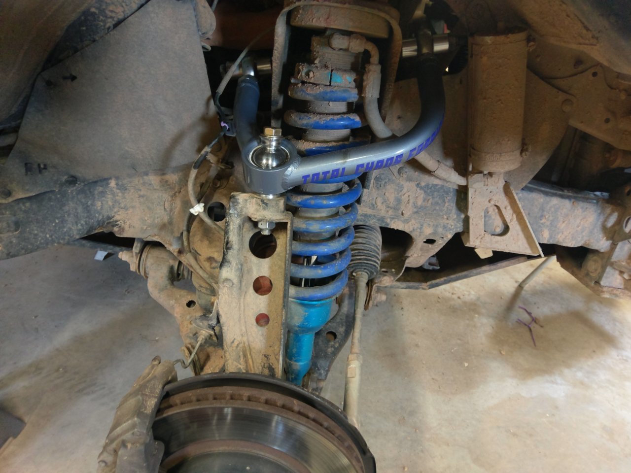

    Cant decide if I should buy these or not. :confused:

    So you can weld your lowers stationary or so you can get a 6" db lift?

    If I were to do it again I would get heimed uppers.

    Yep I have decided to go full mall crawler. No I want them for the adjustability and my current UCAs are limiting my down travel.

    #balljointlimitstraps are no longer.

    Where are he new lint straps? You’ll bend the uca to spindle bolt without one. Ask me how I know.

    His uniballs are maxed out though, so not sure it would bend the bolt. The misalignment spacer is up against the cup.
    You can see in that picture the lower double shear brackets we welded in a while ago, need to see if he has the clearance for the clevis with the new wheel and tire setup.

    Ya I have had straps sitting in my house for a while now, just needed 35s to make sure they were going to work.

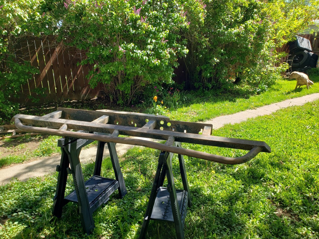

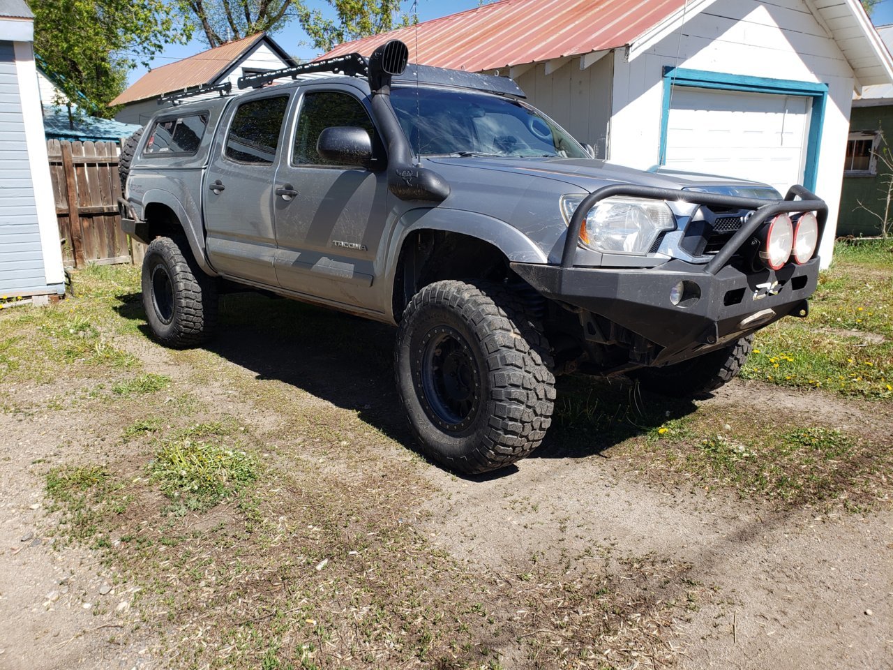

    Truck is looking a little naked as of right now.
    I figured it is about time I clean up these sliders and other armor this summer.
    I will also end up replacing a lot of the hardware for the sliders. I ended up breaking one bolt that goes into the fram and having to drill the other out. So I will end up drilling them out completely and put new carage bolts in their place and adding a 3rd bolt to the bottom.

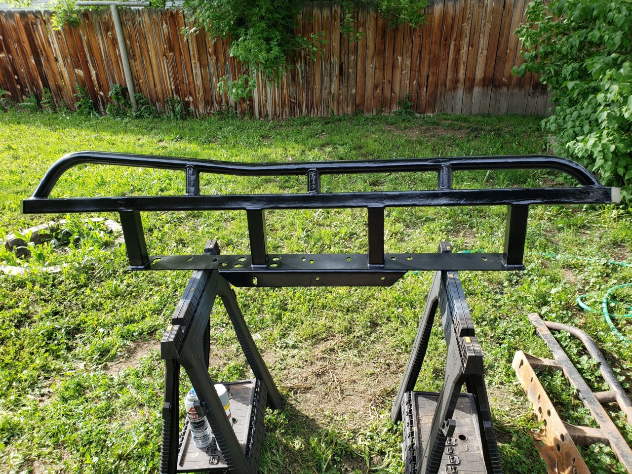

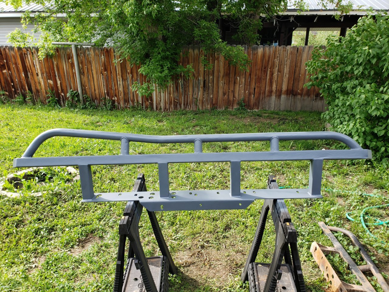

    Well I am finally finding time to strip the paint and rust off my sliders. I almost have one slider repainted. I ended up using a combination of paint/rust remover wheel, flap disk and a wire wheel to clean them up.
    I also decided I was going to paint these the right way this time, primer then paint. Still need to clean the frame up a little and do the other slider. Oh and I have to buy some new hardware as well.
