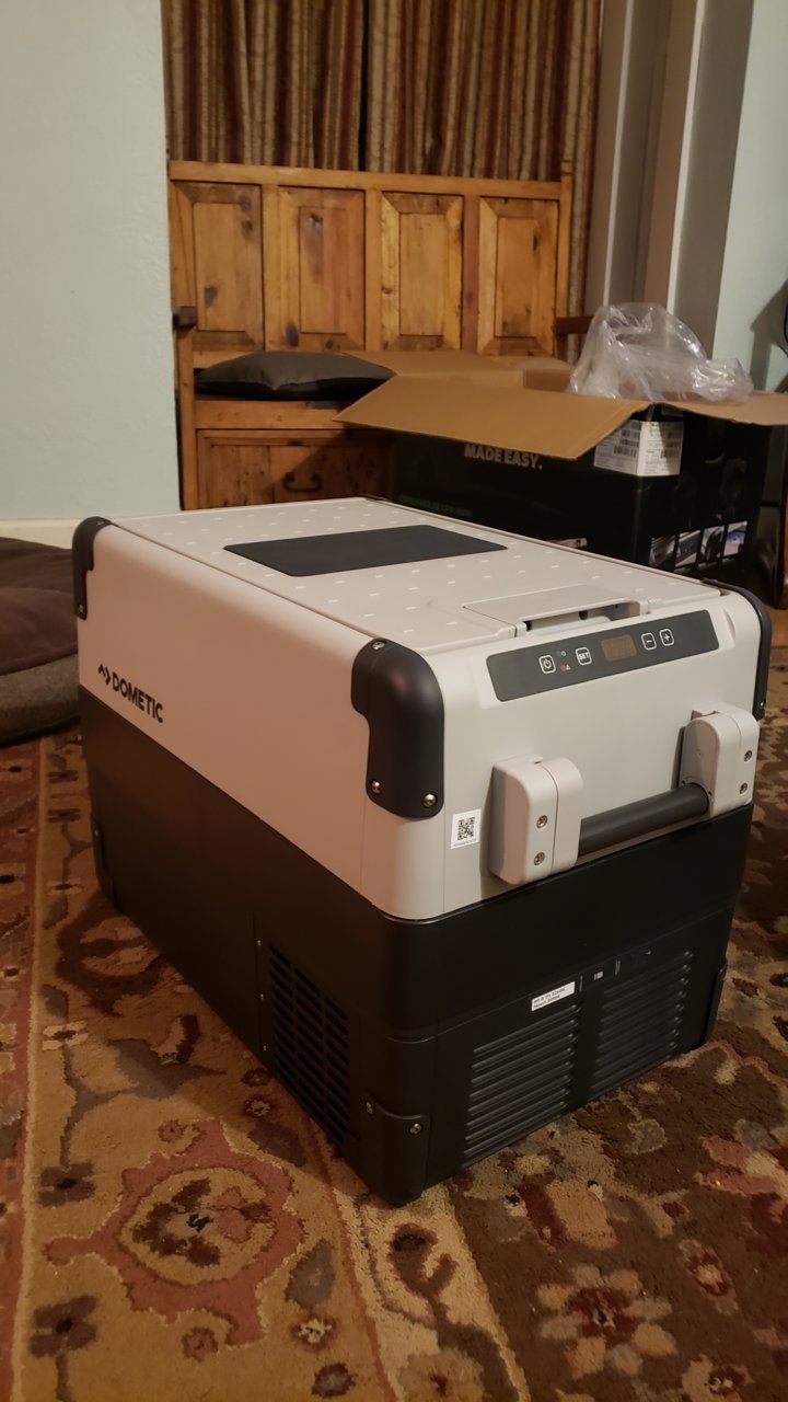

    Yes I kinda copied brett on the fridge but I have tossed the idea around for a while but kept telling my self it was not practical. over the past few years I have spent a shit pot of money on ice and the fridge should cut that out for the most part. No I will possibly still end up with a cooler for beer and drinks on longer trip. My girlfriend won a smaller yeti cooler that she kinda gave me and I will use that.

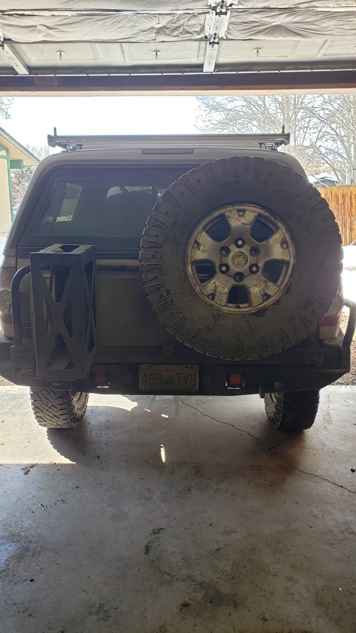

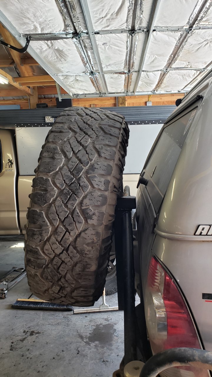

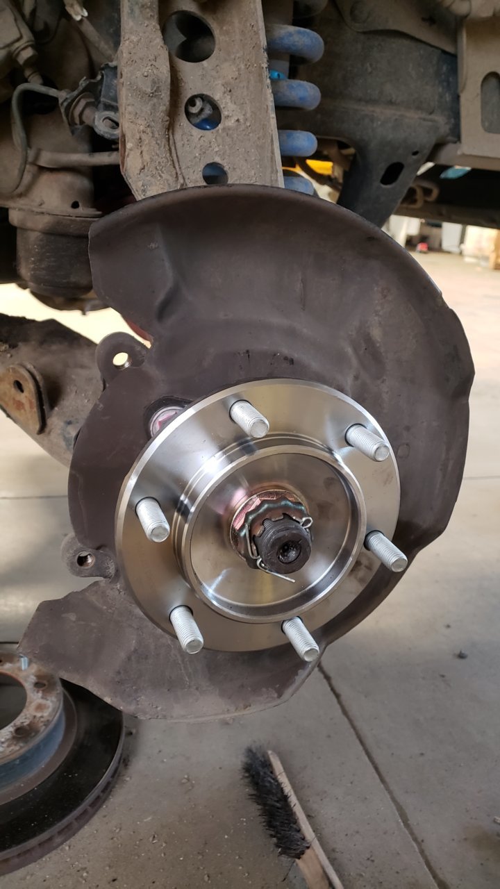

    Well I got a couple of updates on the truck. So this weekend I got my tire carrier cut off and welded up a new stronger on.
    The original carrier was vertical and made out of thin walled round tube. So I put on some 1/4 wall square tube and slanted the tire back 10*. I think the slant cleaned up the back of the truck. Happy to have tire back on the back of the truck and not in the bed.
    I also tore the front end down after work today and put some new bearings and hubs in.

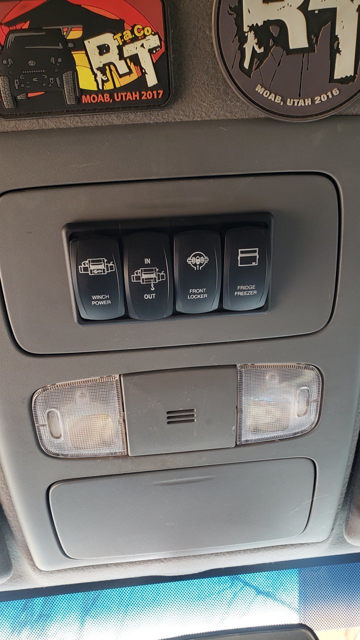

    Install 4 new switches in the head liner
    Install blue seas circuit breaker and fuse panel

    You slanted the wrong way for the GFN...

    I know I did but a GFN will need a lot of mods to the swing out to work. We also need to make one first

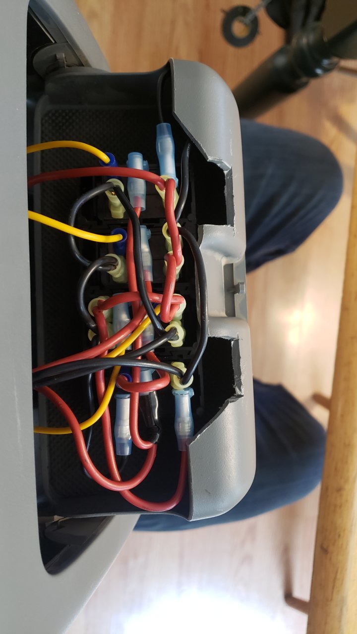

    Got some wiring done on the truck yesterday. Not fully wired in but plan to pull the head liner during the week and wire them in next weekend.
    Finally got a new solenoid for my winch. So that can finally get to put it back in the truck.
