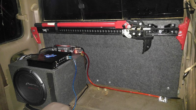

    Is you box just a big cube ? We're did you put it ? Do you think that the 12 was to much for the small cab ?

    This is where I have it.
    And idk, im no expert, but it may be too much for the small cab. Only reason I say so, is because it sounds like shit with the windows up. Rolled down it hits way harder and is kinda perfect. Although I do want more. I have plans to make a whole storage box in the back, integrated into the back panel I put in. And integrate dual 12's in the bottom somehow. No idea when I'll get around to that tho.

    Nice!! That looks pretty clean.How's that back panel attached ?
    Thanks for the input. I've seen the integrated storage boxes, there pretty sweet.

    I drilled holes in the panel and bolted it to the back where the backrest and seats were attached.
    And a 10 would be good. Depends on how much bass you want. With this 12, it sounds great. But it's barely enough to rattle the truck. Don't get me wrong, it hits, but I wanna feel it in my chest. Ha. It can tickle my nose with the right song tho. Lol.

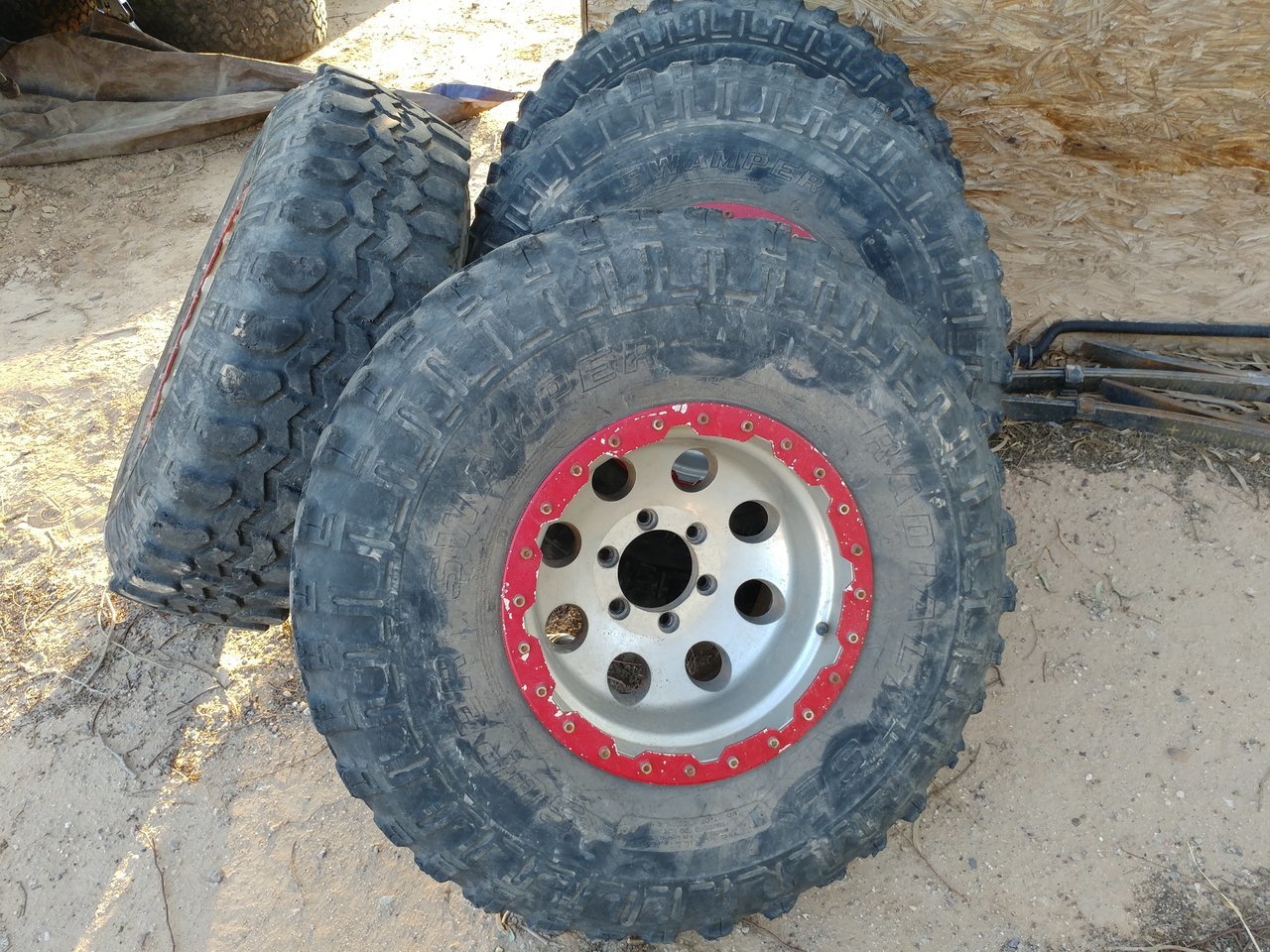

    Just picked these up yesterday! Think 36's will fit!?
    lol jk. I just got them for the rims. And hopefully fit tundra brakes. Printed out the template and tested fitted that and looks like ill need to put on some spacers. The guy i bought the rims from also threw in some 1.5" spacers, of which looks like the tundra calipers will clear with those for sure. A little thicker than i want, but oh well theyll work for now. Or at least whenever i get around to getting some 305/70/16's to slap on... Same style rims as i have now but 16x10 to replace my 15x10's. With some fake beadlock rings on em. They've been wheeled pretty good tho but look fine structurally. Just some rock rash on the trim rings, which im hoping to restore those. Paint em and get more bolts as a bunch are missing.
    But yeah theyll have to wait for now. Been working on other stuffs. Put in oem lbj's and oreilly tie rod ends.. Swapped out my passenger side spindle as the ball joint race was worn out causing play with the slug adapter.. Took it all apart to replace the slugs as well as get some new bearings pressed in. The guys at napa were awesome and i discovered one owns a 3rd gen 4runner, the other a modded cherokee, so that was a bonus to have trust in them to work on my junk. But we decided a new spindle was in order before proceeding with the bearing swaps. Found a 4x4 4runner spindle with abs that a guy sold me cheap, even making a block off plate for the abs bung on the spindle. Took that in and everything swapped over fine(as mine is preunner hub and non abs). Just picked those back up yesterday too..

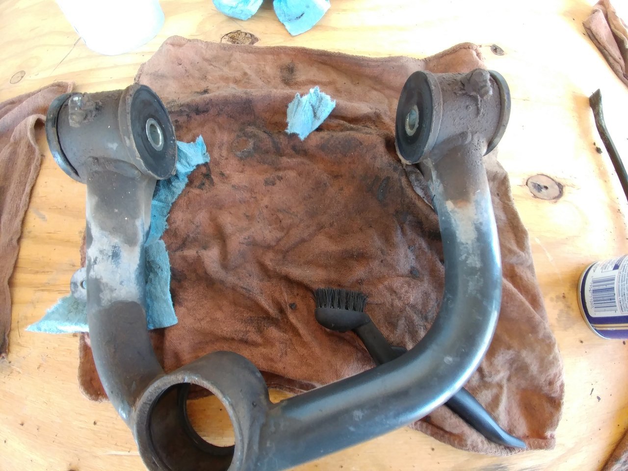

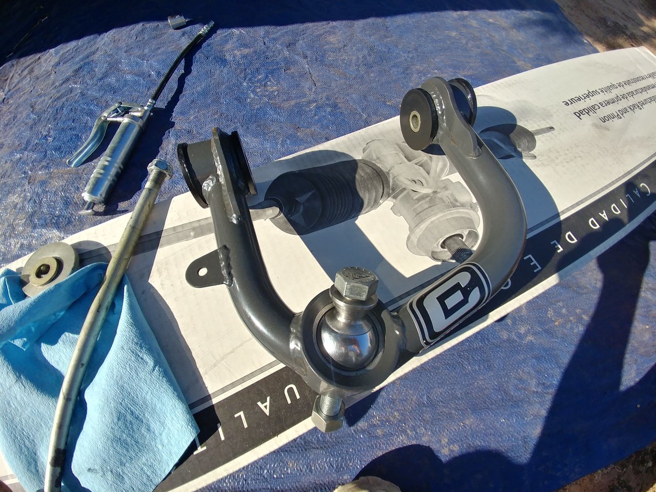

    Also cleaned these up today too.
    From this:eek:
    To this
    But almost all the zerks are leaking at the threads so ive decided I'm gonna pull them back off and attempt to re-tap the holes. Not happy with that but oh well. I kinda forgot they were wonky when I first installed them but they've held up and not leaked, at least till now. One got completely stripped out so it's gotta be done now.
    Picked up my rack today too. Hopefully next week I'll have her buttoned down. Ugh.
