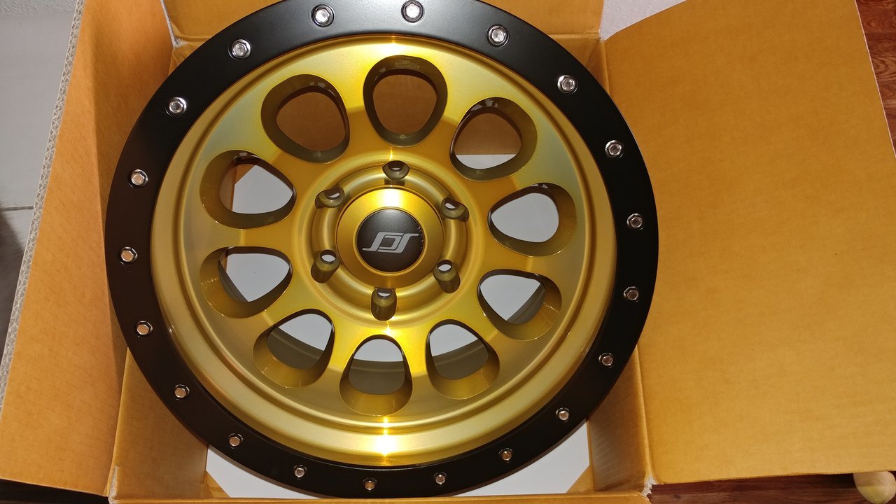

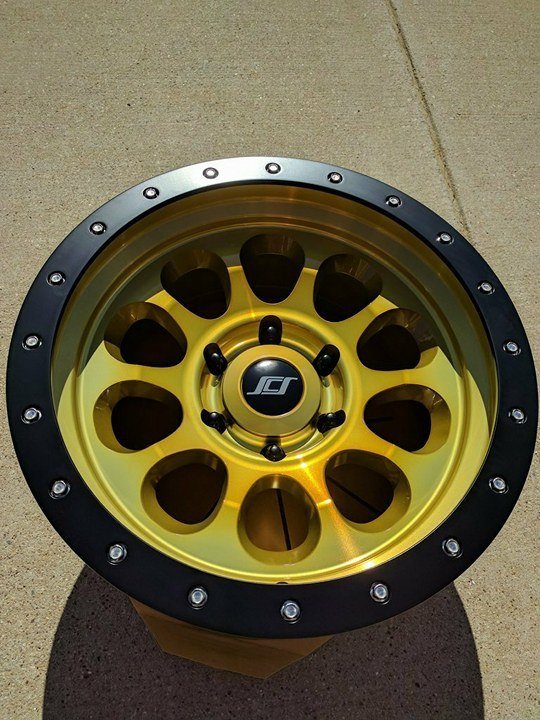

    I kinda wanna just get some proper fitting (hub centric) SCS Ray10's and not even mess with these used rims. But man they's gone be $$$!
    They've supposedly got some of their SWEET brushed gold versions coming out with a new batch release soon. BUT.. The golds are only gonna be offered in 17's (from now on and never 16"!) UGH!!! Idk why, but I just don't think i'd like the look of 17's on my 1st gen.. sigh.
    Idk I gotta keep looking... It's just a whole new shit-show right now. Ha. Idk.. I think I'm just gonna wait it out and not spend any money on anything until I see how the next batch of wheels go from scs. I may just say fuck it and get some new rims regardless of color and size. At least they'll fit properly! And with how I had planned on doing things with these used rims, it'll probly save me lots of time/money/hassle than dealing with swapping over tires and my tpms sensors over and over. ha...
    But anyways... here they are!! These have 315's iirc. Not sure how they'd look with 305/70/17's on a first gen...

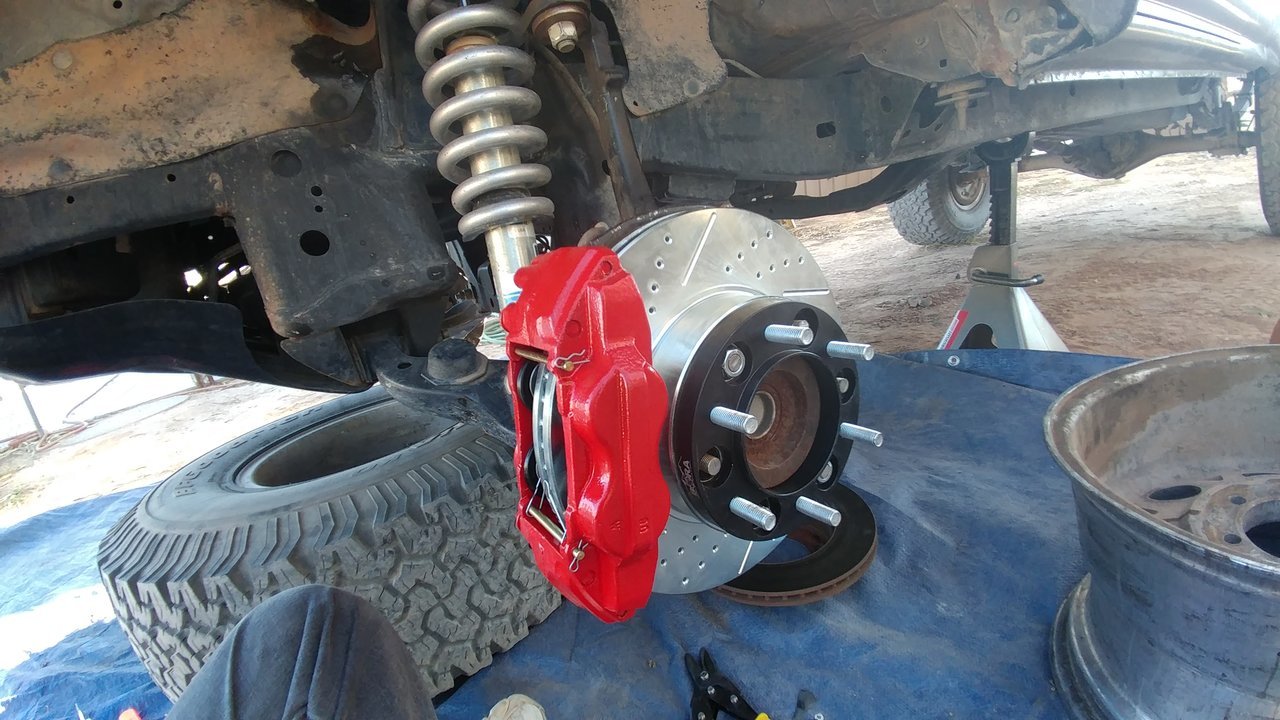

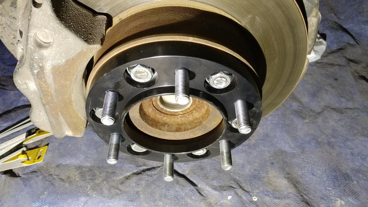

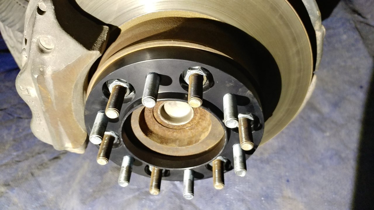

    Tundra brakes arrived and test fitted them with that set of 16" wheels I got.. Everything clears!!
    Just gotta get brake lines and some 305's to slap on the wheels.
    Got all new rear brakes; shoes, hardware, cylinders, bell cranks, and OEM drums delivered. Wanted to wait on tires and the front brake lines in case the tundra brakes didn't clear, otherwise I was just gonna stick with the 15"s wheels I have and get oem calipers and stuff... But ecstatic they work!! Should be able to do a stoppie after those puppies are on, lol.
    Also got rid of the 1/4" spacers with extended studs. Hack-sawed the extended studs and put on some hub centric bora 3/4" bolt ons.
    Old wheels are back on for now and took her for a test drive and ZERO vibes!!! Pretty sure all my balancing issues were due to those crappy 1/4" spacers.
    Hopefully soon I'll get some new tires and then I'll tackle the front and rear brakes all at once. Can't wait!!

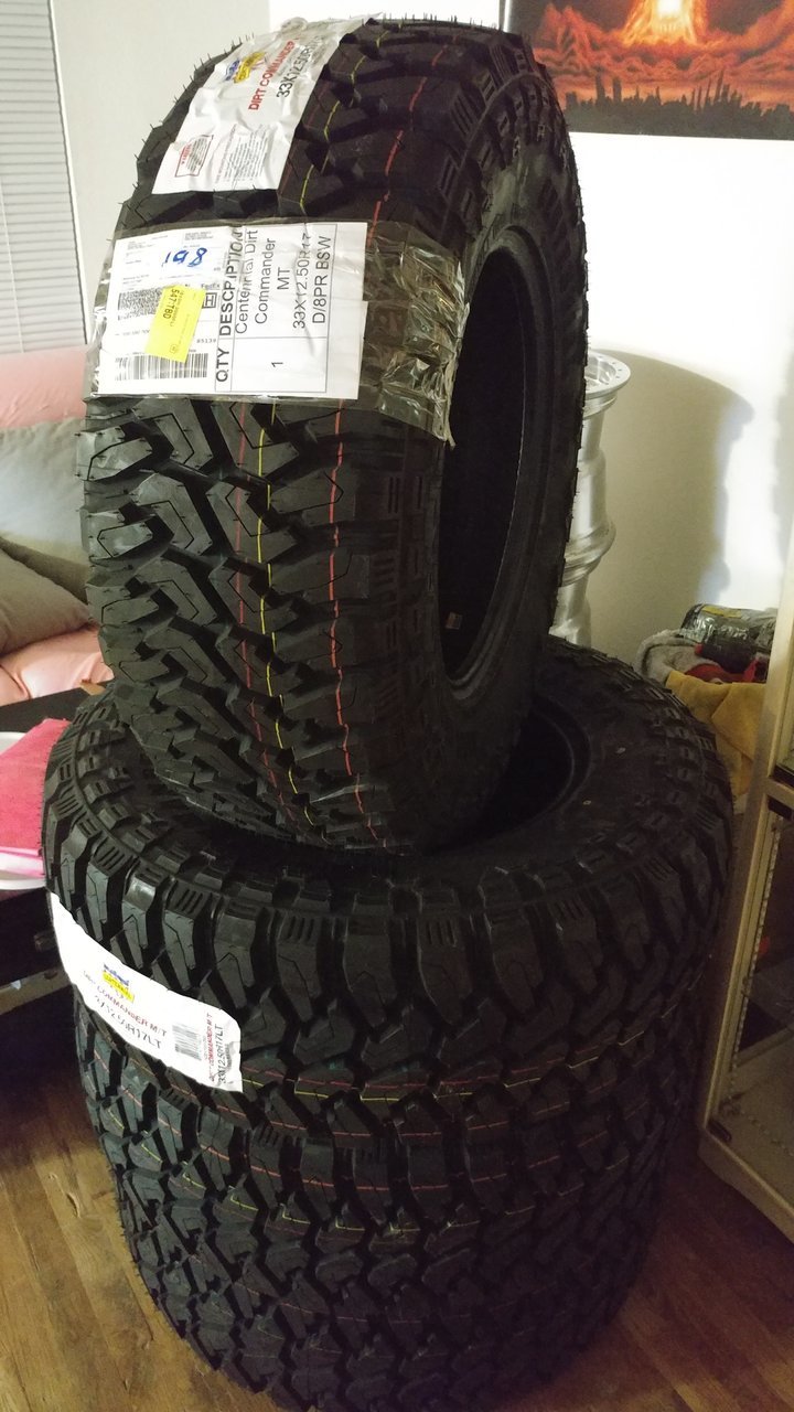

    Welp, I love em!!! Not sure I love the tires tho... They came up an inch short not being true to size. So I ended up with 32x11.5 instead of 33x12.5. Maybe I should try them in 35's and barely clear with 34's if thats the case with all their tires!? lol. Because they are a taaaad too small for my liking. Especially up front with the high clearance bumper and appearing too small by not stuffing in as well... Oh well... Plus they took a shit ton of weights to balance(more so on one, like triple) and have a slight vibe.... Sigh. They do ride super smooth though (D rated) with just a lil hum to em. Pretty quiet actually.
