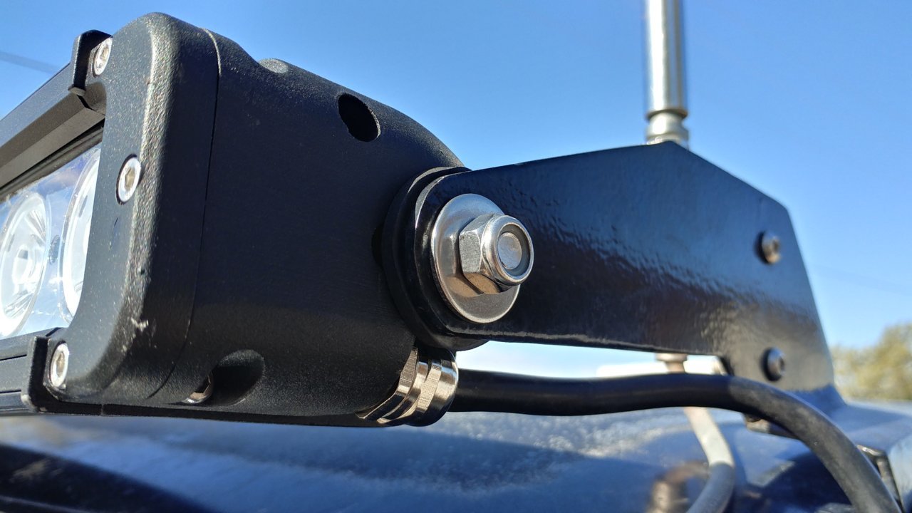

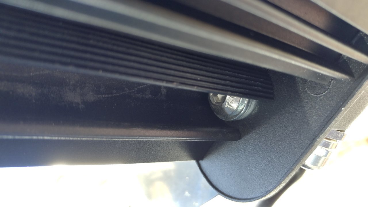

    Nice. So if you end up needing to use the end caps for mounting and not the bottom mounts it comes with, they're a bit tricky to remove. Some of these style lights have a cutout in that channel, so that they can be removed if need be. But this one does not. So what i had to do, is remove the end cap on one side(left side, or opposite side of where the wire goes in) and slide them out. Was tricky getting the end cap back in tho because there's a rubber gasket that sits in tiny channels of the end cap, and the gasket didn't wanna seat back in easily. But I got it.
    Then I used some 8mm Allen bolts fed in from the inside, out, with nylocks on the outside. (Had to do it that way because you can't get a wrench in that channel, but you can with an Allen key.) With a rubber washer between my brackets to hold the bar in place from rotating up or down. (I'll Probly have to change the rubber washers tho. I tried that before and they got crushed and deteriorated. Probly use some of those star shaped lock washers again).
    Here's those bolts if you'd rather just purchase those. Not sure how they thread in to the bar tho. I guess put a nut inside. Because it's just a blank hole. Unless on the real vision x ones they might have something different inside with threads. Idk. But you should be able to install these(and maybe get a wrench or socket in there to tighten that nut) before installing the light bar on the truck and make it easier.
    https://www.ebay.com/ulk/itm/261936899986

    Oh sweet! I'm gonna try to fab up a mount to go to my roof rack. I have some extra Yakima towers laying around for the cab of my truck, so I'm gonna try if I can get those to work with it. How is the wind noise with it?
