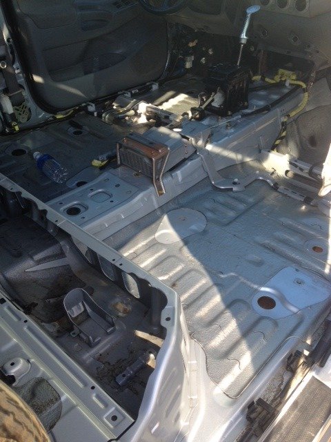

    Here is when I bought the truck not knowing what I was getting myslef into. Definately looked good from a distance. Road wise it was just plum horrible. I hated the humming of these tires and the front end facia would bounce after bumps. Dang body mount nuts backed off. The body lift was the worse thing ever done to the truck and I would never have another one on any truck I own. Just plain not safe in IMO. Ill post some more pics tomorrow getting closer to where the truck sits today.

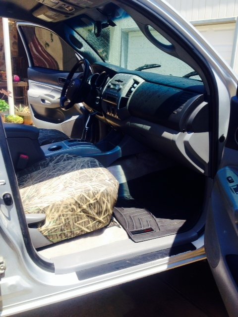

    The inside of the truck was horrible, but the seats and dash were in good shape. I didn't take many photos before the carpet install or center console painting. Here is right after I pulled the old carpet and started to clean the floor boards.
    Here is after the new carpet

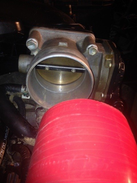

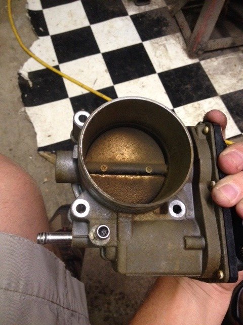

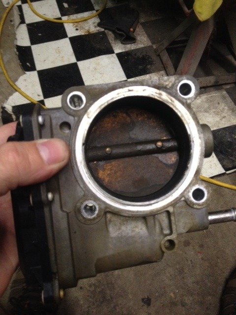

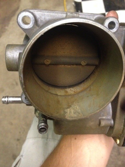

    Well I got around to the throttle body last night, I have no idea how this truck was even idleing decent. It was horrible! I'll let the pics do the rest of the talking.
    forgot to take pics after cleaning till I was putting it back together. Here is one pic from the front. The rear was the worse part and I made sure it was spotless.

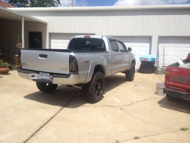

    Here is a couple of up to date pitures of the truck.
