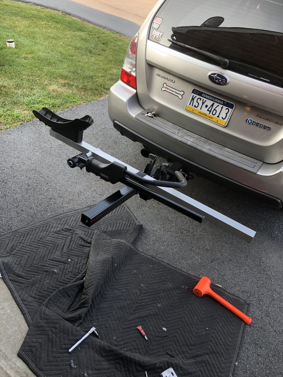

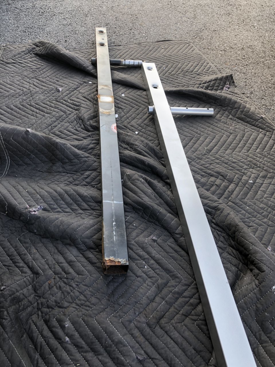

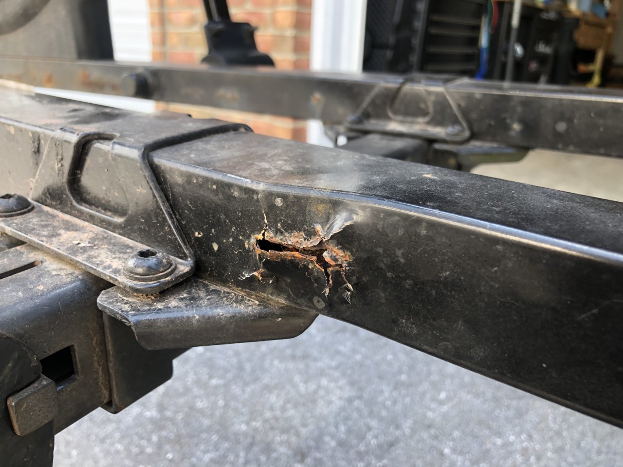

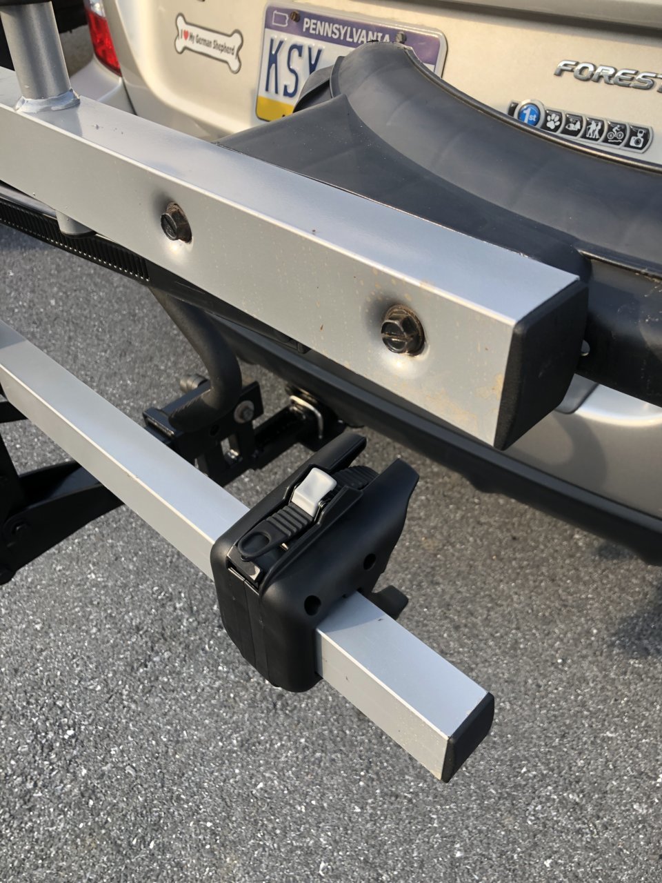

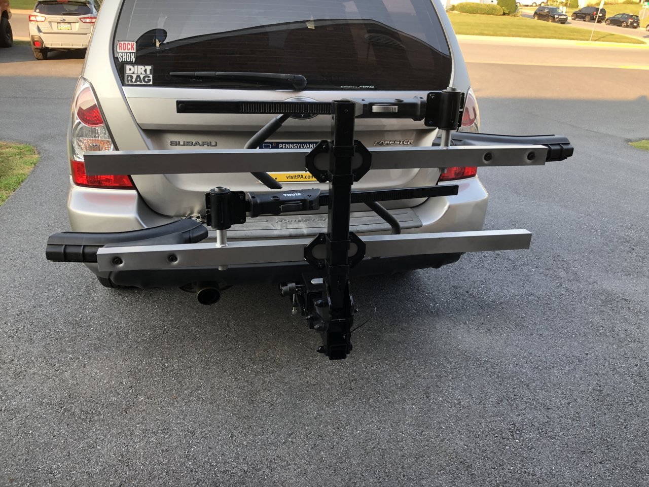

    I decided it'd be cheaper to rebuild my Thule T2, than attempt to sell it for parts and buy something new.
    It’s attached to my Fozzie so I’ll post the pics in here:
    Why I needed to rebuild it:
    Had to swap the plastic bearing pins

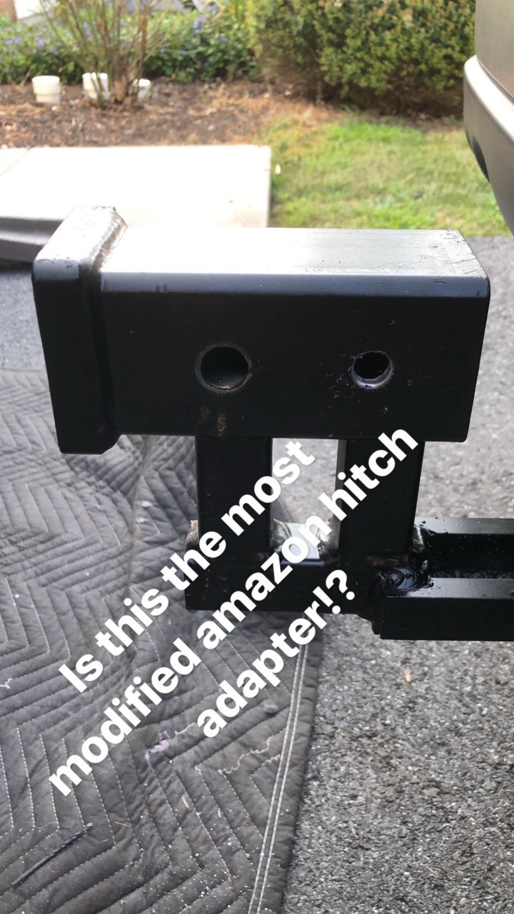

    Drilled new holes in the hitch adapter to move the rack forward 2”

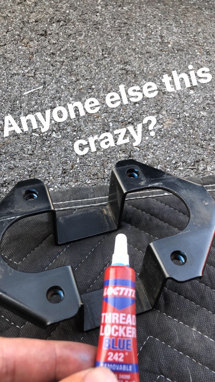

    Blue loctite on everything
    Painted everything while I was at it

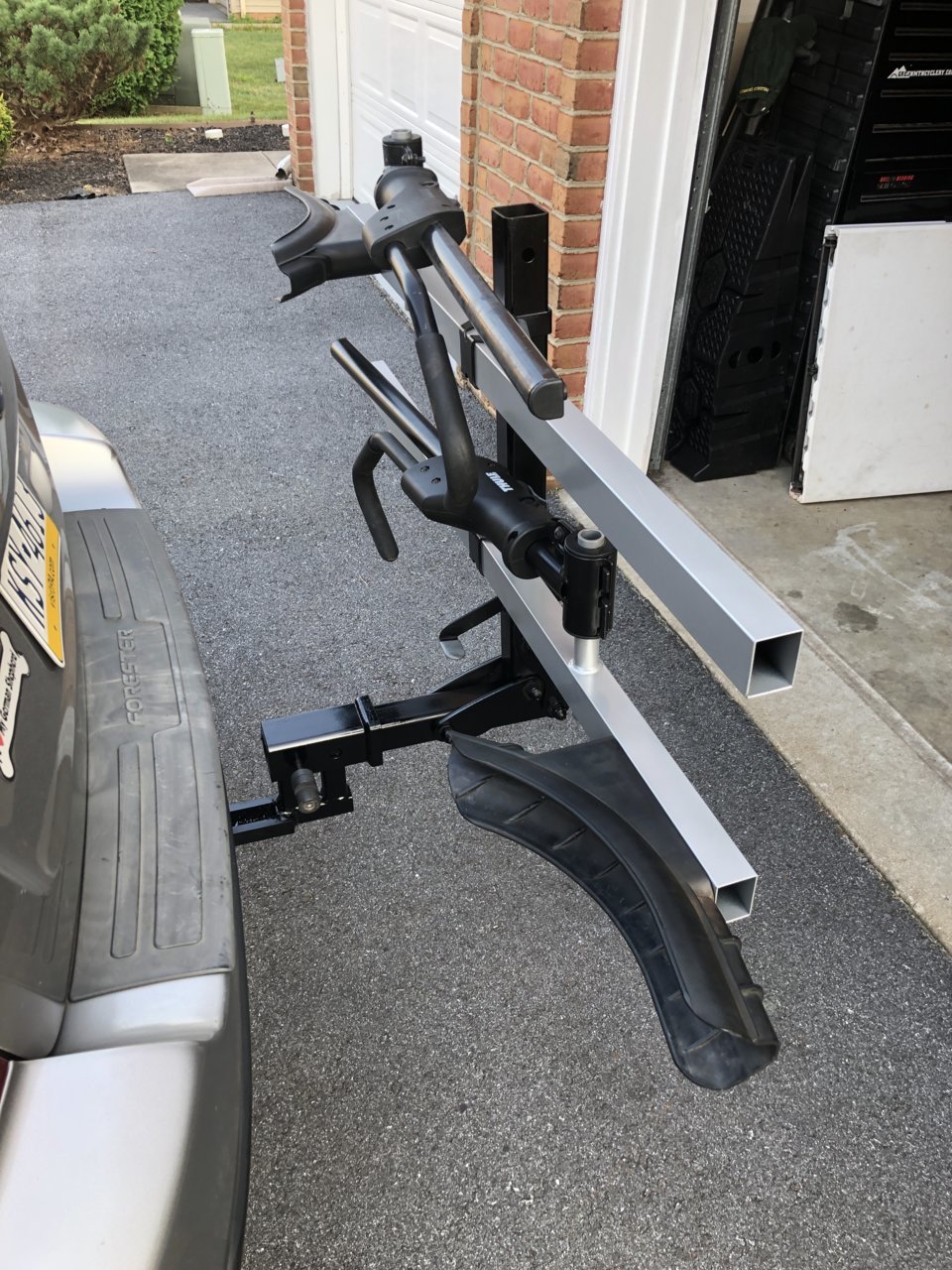

    All done! Just waiting on the new wheel strap assemblies to arrive
    Parts arriving this week:
    End Caps
    Rear Tire Holder

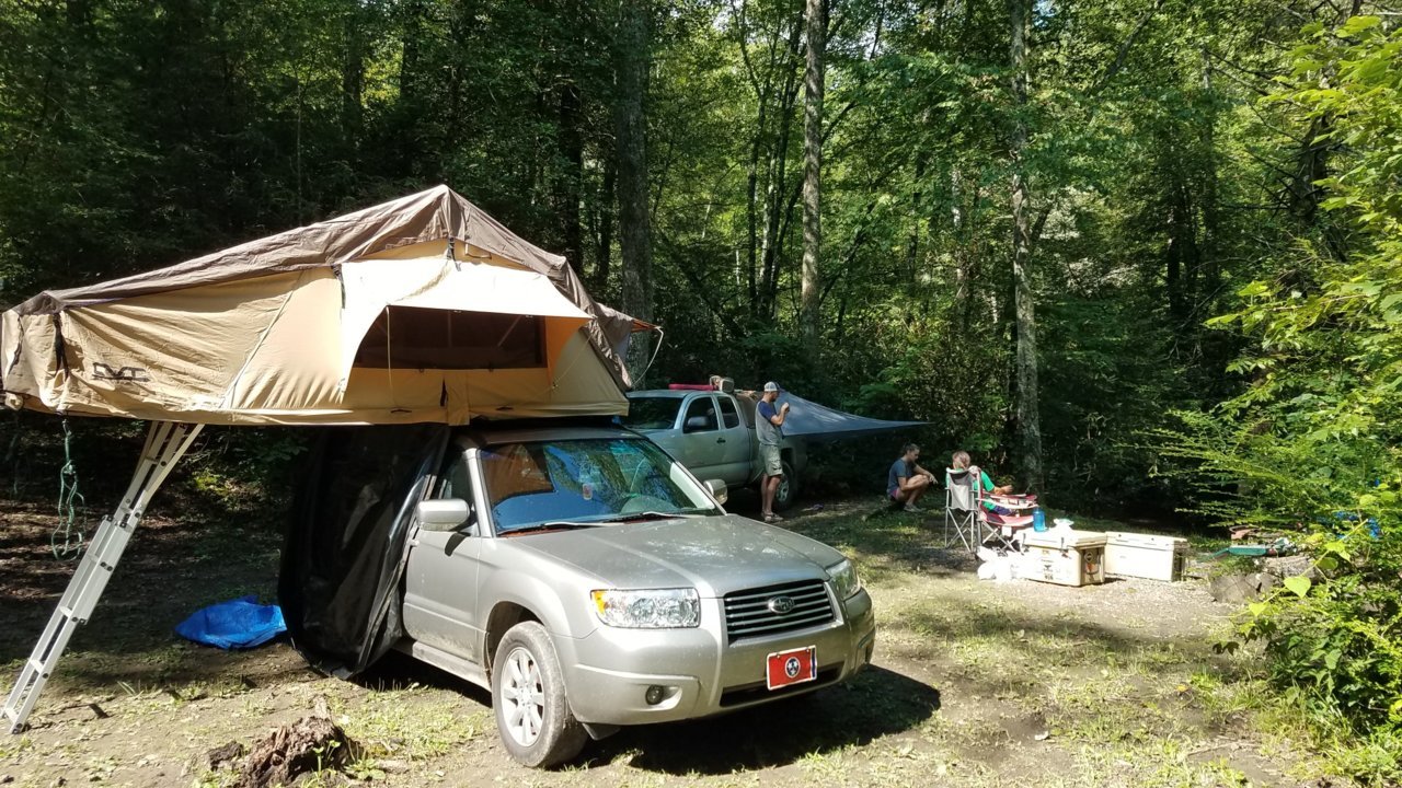

    We took our little beast camping this past weekend. Cool cars for sure

    That’s awesome! How did it handle with the RTT on top?

    The car definitely floated more while turning but I attribute that to air pressures, too. I was surprised the stock crossbars did so well. Matter of fact we are going camping again this weekend and I just left the tent on the car for the week

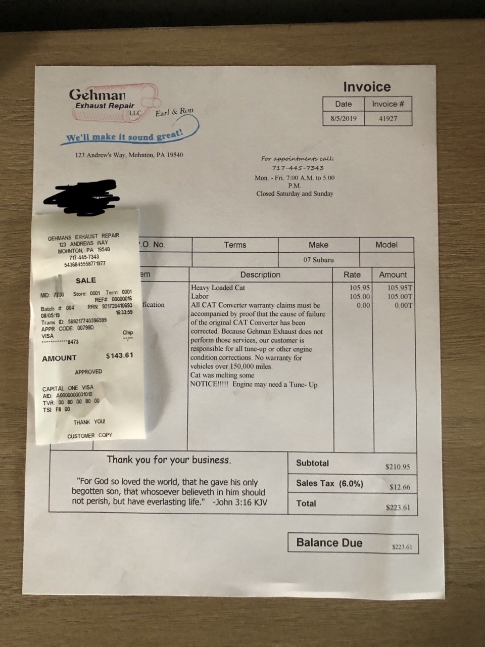

    New front cat to take care of the P0420 code :rasta:
    Now I can finally get this thing inspected
    Also, this thing ran like crap when I bought it, but with a little TLC and parts thrown at it it’s running stronger than ever. With better MPGs as well!

    That was CHEAP!!! An OE cat would have cost you $1025.10-1621.77 depending if your car is Cal emissions or not.
    Make sure you're running the OE NGK Plugs. That makes a big difference too. 22401AA65A (NGK FR5AP-11)

    I'll check, I don't remember what plugs i'm running lol
    And I know it's cheap AF! those guys are great! Terrible customer interactions (grumpy old dudes) but they are cheap af so IDC
    for $223.61 they removed my headers, cut the old cat out, welded a new one in, and re installed the headers.
    Whenever I finally get my tacoma re route done I'm going there, it'll cost me like 50 bucks haha

    Also, wrapped up the T2 with new end caps and rear wheel assemblies

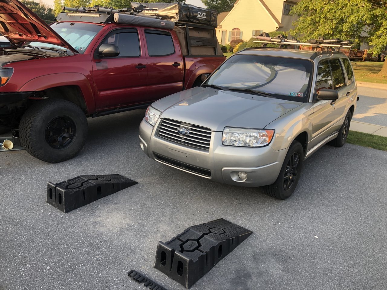

    Late, but on 10/1/2019 did an oil change

    What’re the ramps for? It’s a Foz. I change the oil on wifey’s Impreza on the ground. Lol!

    I'm too big, my ribs hit the plastic skid! haha
    maybe one day if I get taller tires for it.

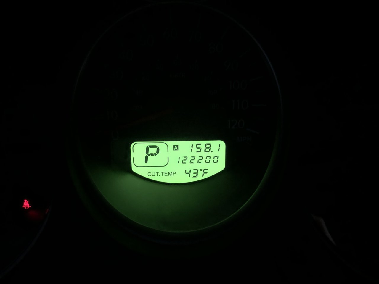

    Racking up miles on the daily!

    Low miles. It's practially new!
