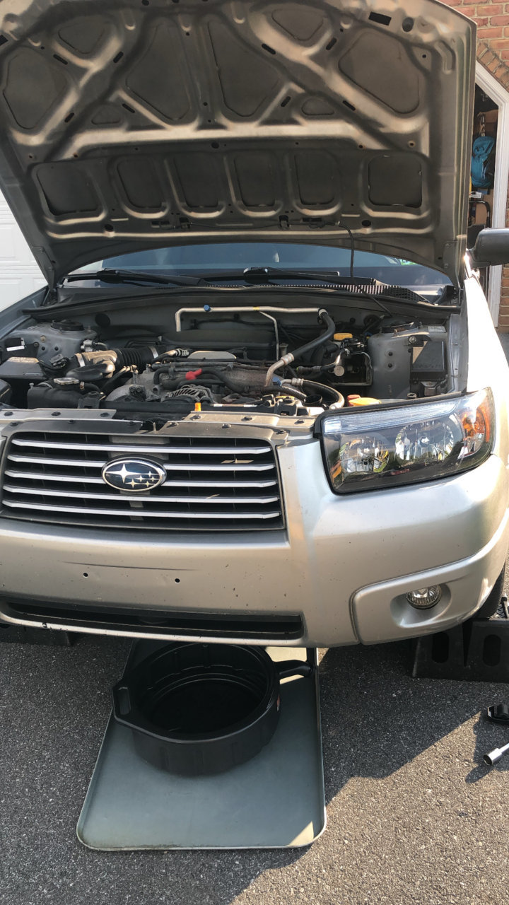

    Oil change time!
    5/17/2021 136,711 - valvoline high milage 5w-30 and k&N oil filter

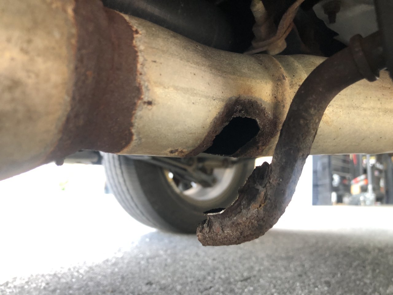

    Getting some terrible exhaust rattle from the heat shields, I think I'm going to have to do some cutting or something to get rid of that issue.
    Also I'm chasing a P2096 code.
    I had a new cat welded in and me thinks there might be a leak post cat. - https://www.amazon.com/Permatex-80333-Muffler-Tailpipe-Putty/dp/B000BKEBOU
    OR the rear O2 is going bad.

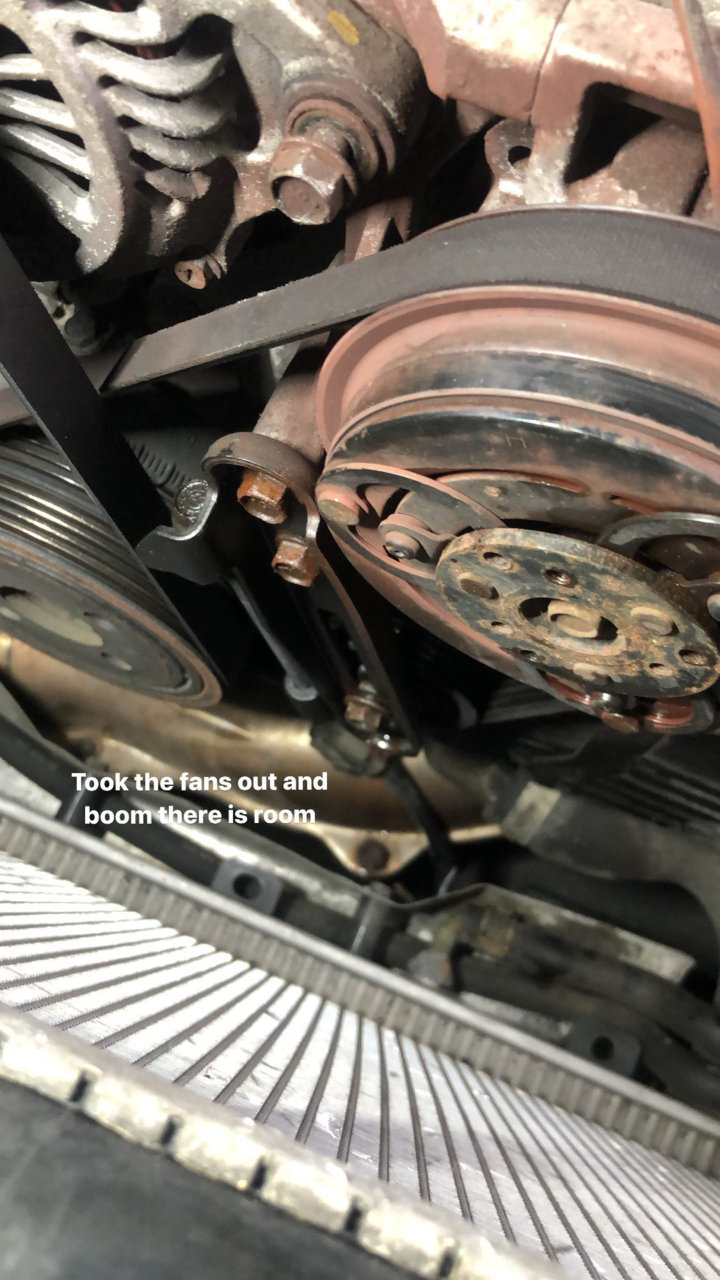

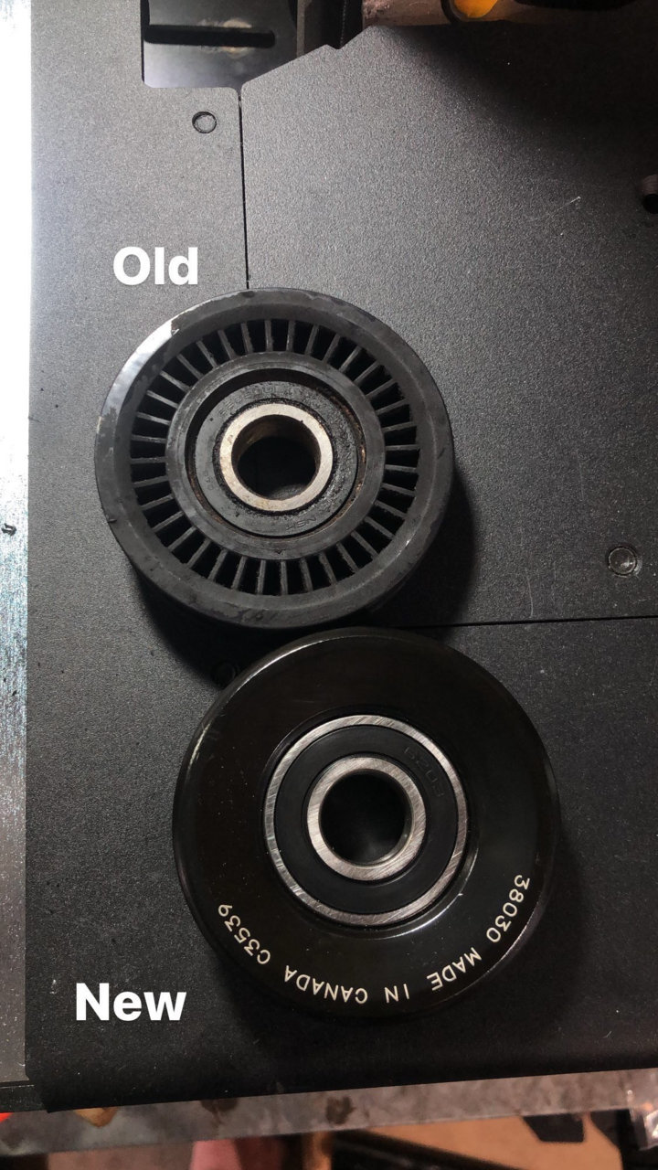

    Also getting a nasty squeal with the A/C on, so I'm hoping it's simply the Idler Pulley - https://www.rockauto.com/en/moreinfo.php?pk=506551&cc=1433581&pt=6956
    https://www.youtube.com/watch?v=wM_NzwqGUtw
    https://www.youtube.com/watch?v=1ejDynSX7Bc
    Ordered https://www.amazon.com/dp/B000C2WI7O?smid=ATVPDKIKX0DER&ref_=chk_typ_imgToDp

    mine is getting worse and is embarrassingly loud lol
    I've been toying with the idea of some UEL headers but they're all too expensive (for a beater car), plus I've never head luck with O2 sensors and headers in the past..

    Got the AC tension pulley in. Required more steps than I originally thought but not too bad.
    I also attempted to fix my exhaust with with exhaust putty so we’ll see how well that holds up before it gets chopped off and a new exhaust is welded on.
    For now she seems quiet and hopefully fixed! :fingerscrossed:
