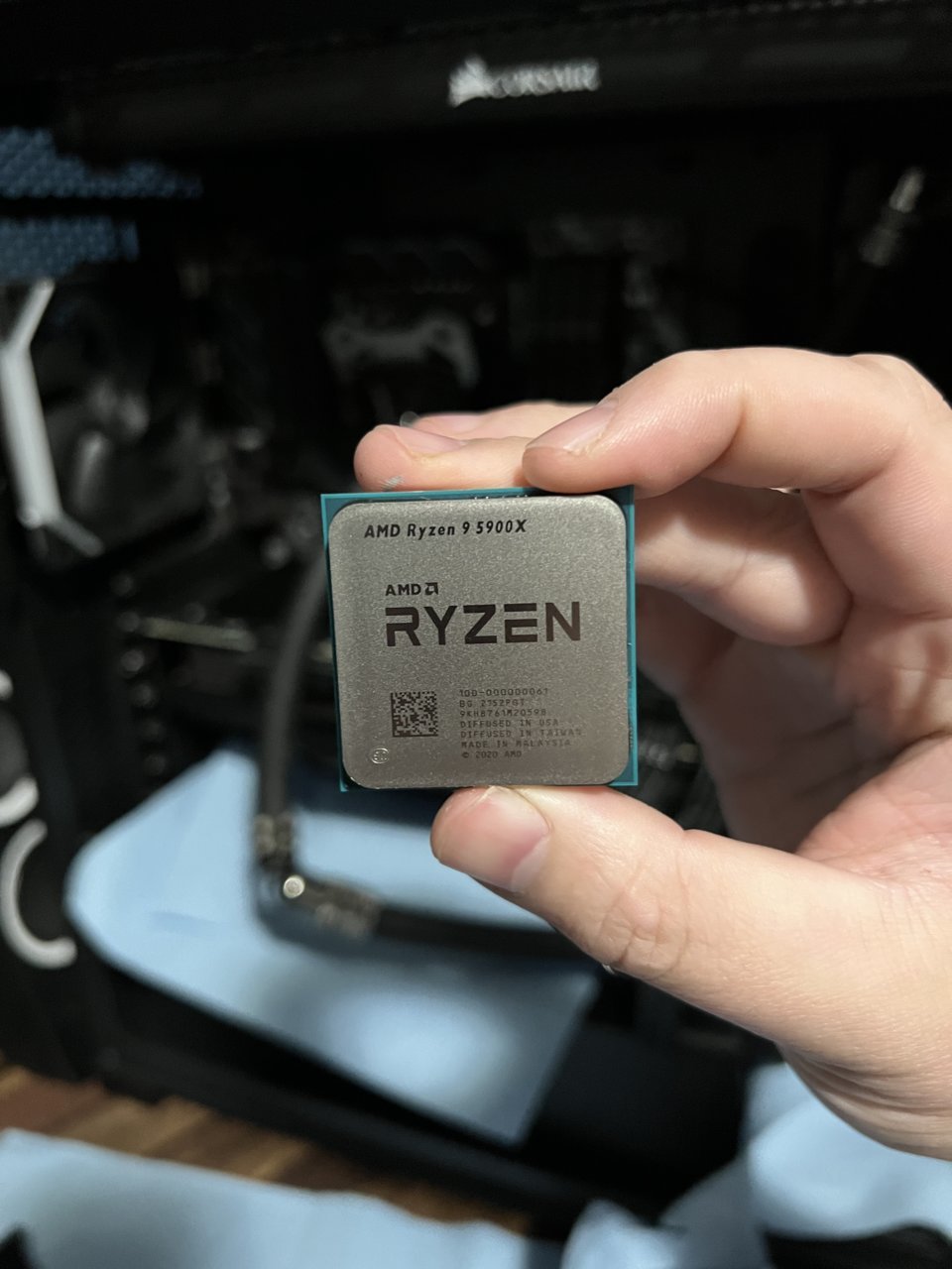

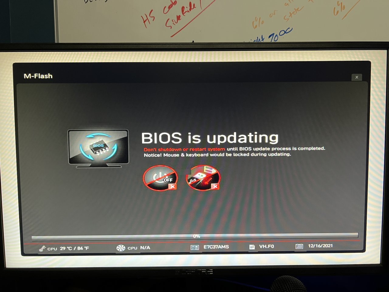

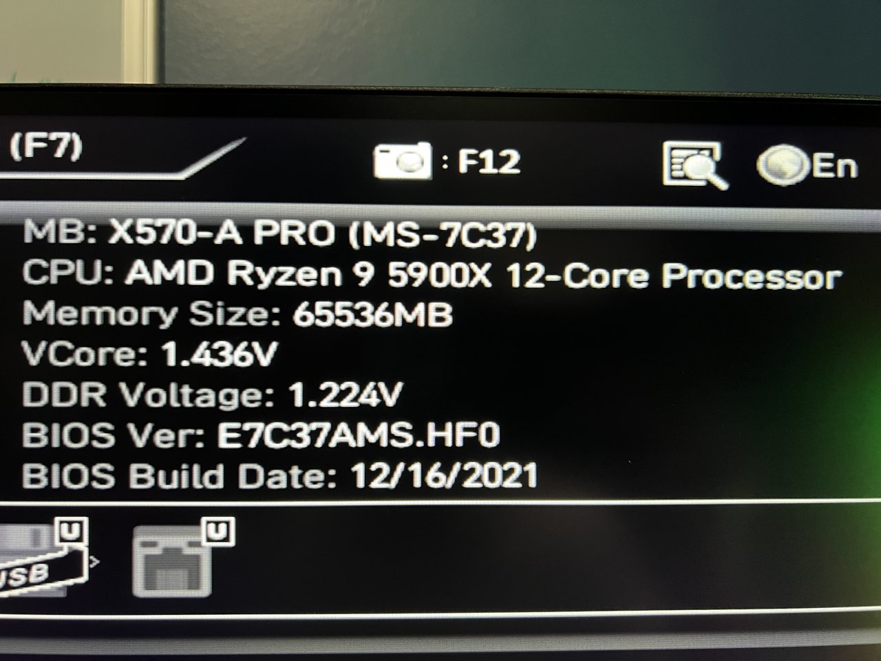

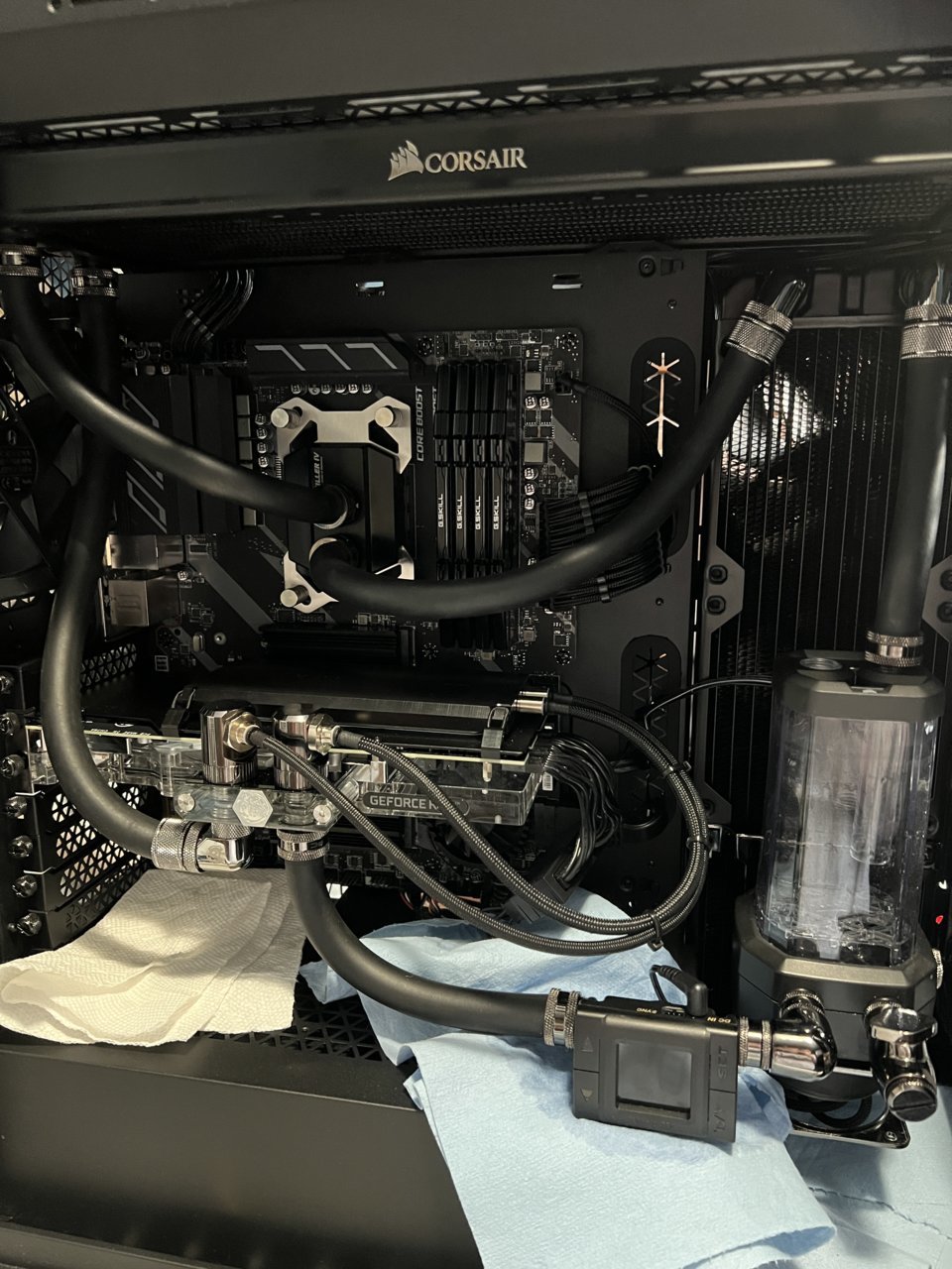

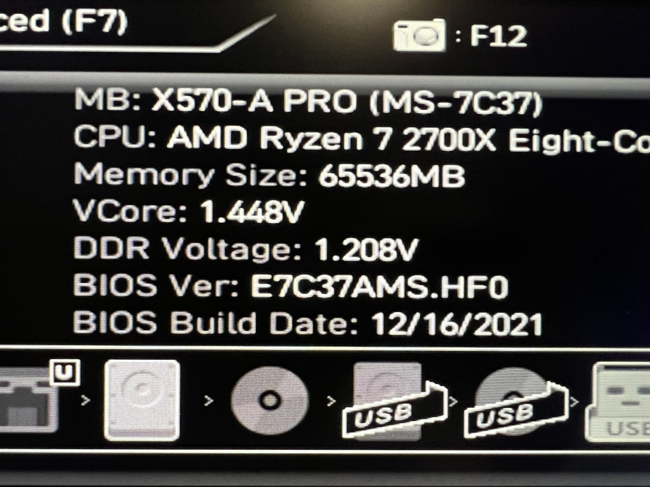

    M Flash made updating my bios super easy!
    All done!
    And this is why I went with soft tubing. I can swap parts super easy!

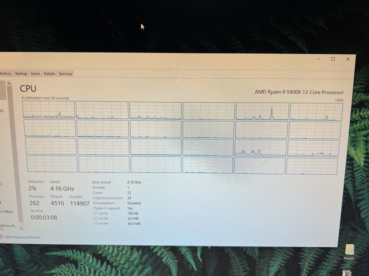

    5900x ready for install!
    Annnd done
    Basically 15 minutes including the bios update to swap CPUs. I can’t wait to push this thing!

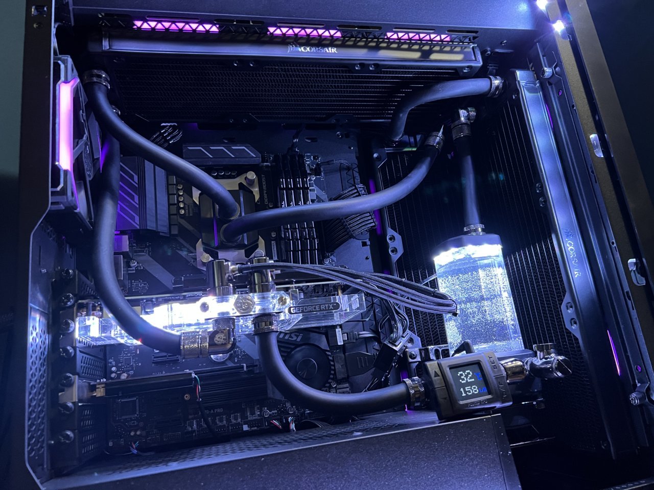

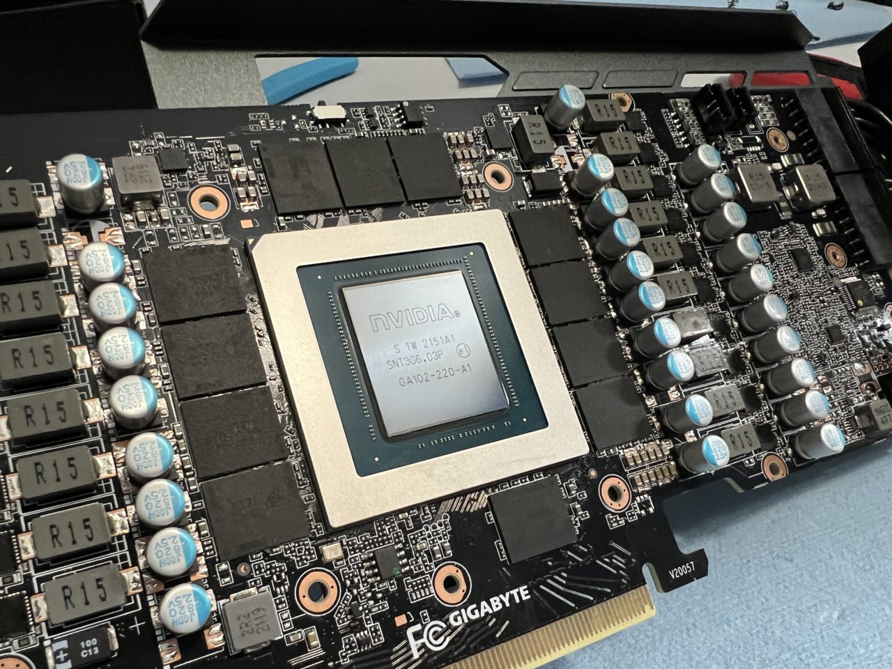

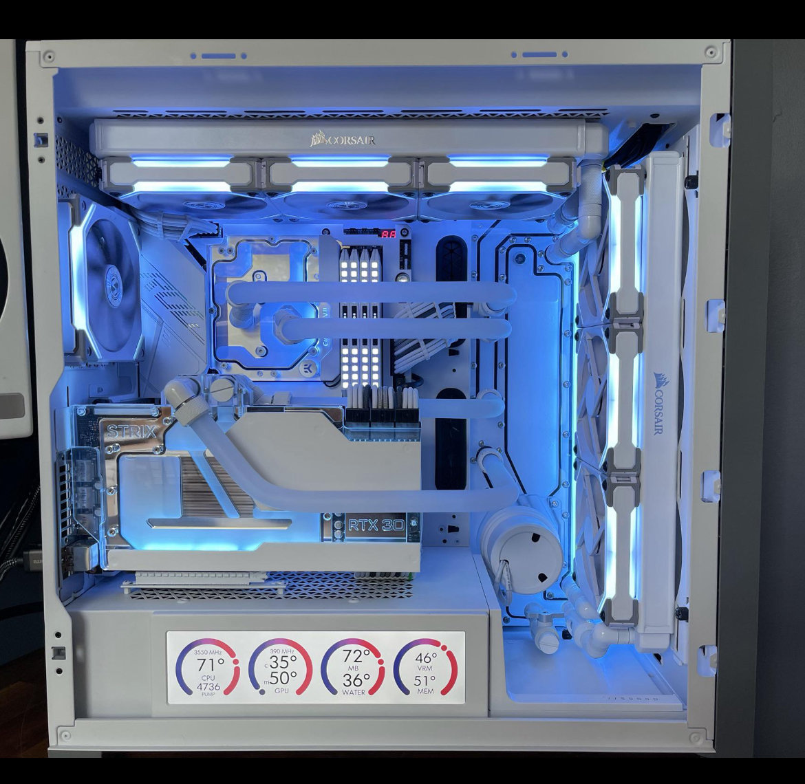

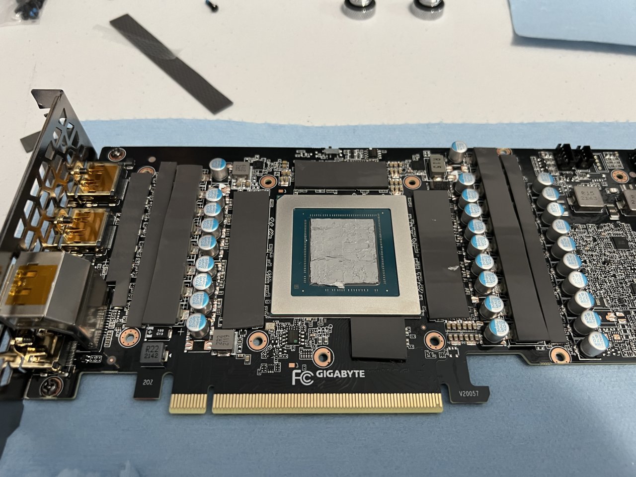

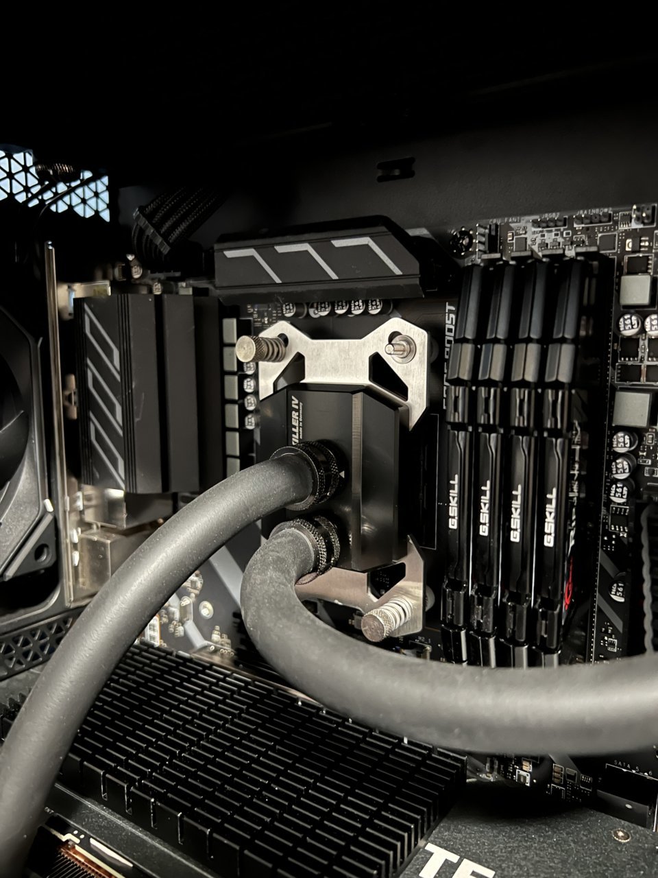

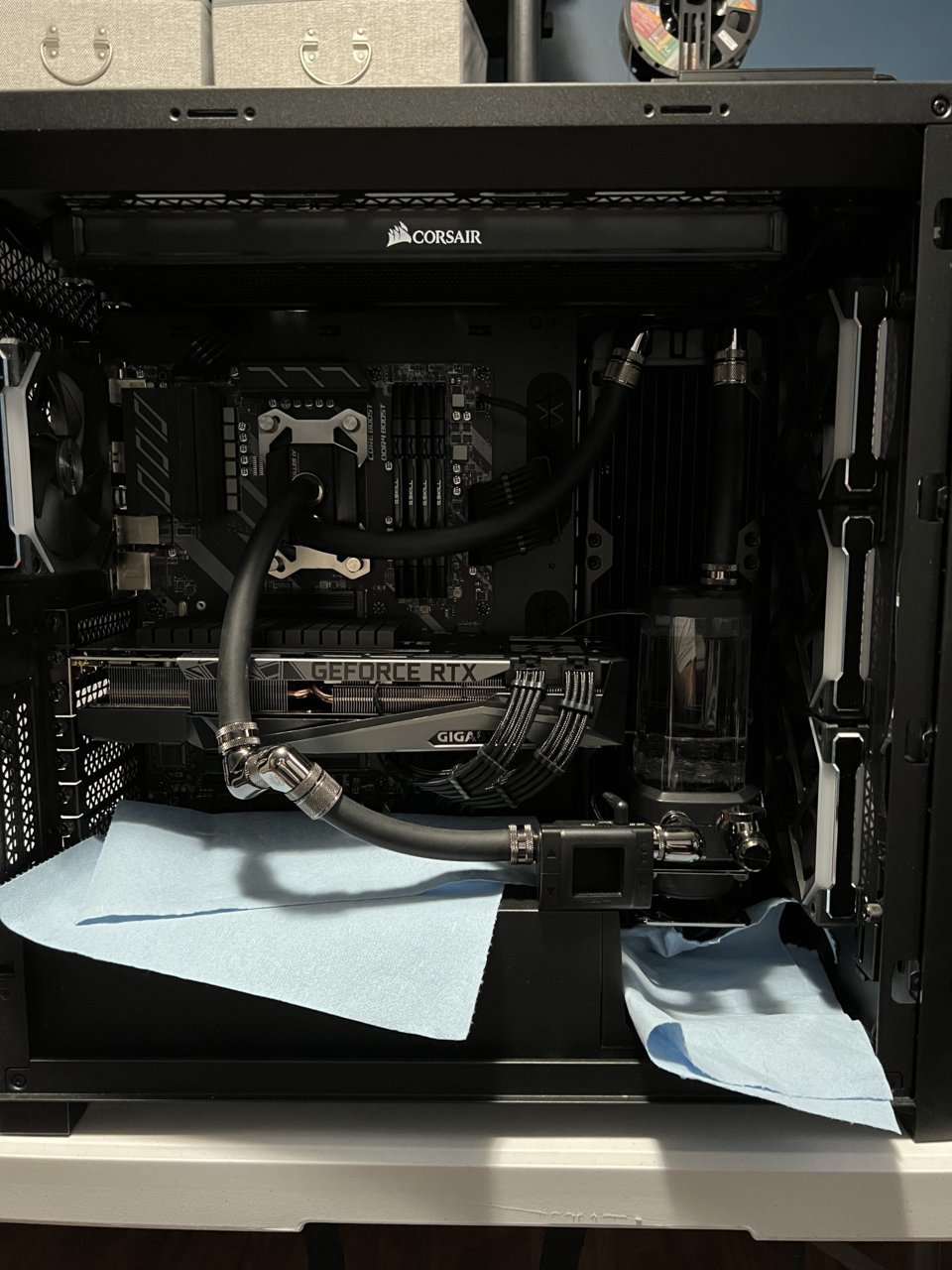

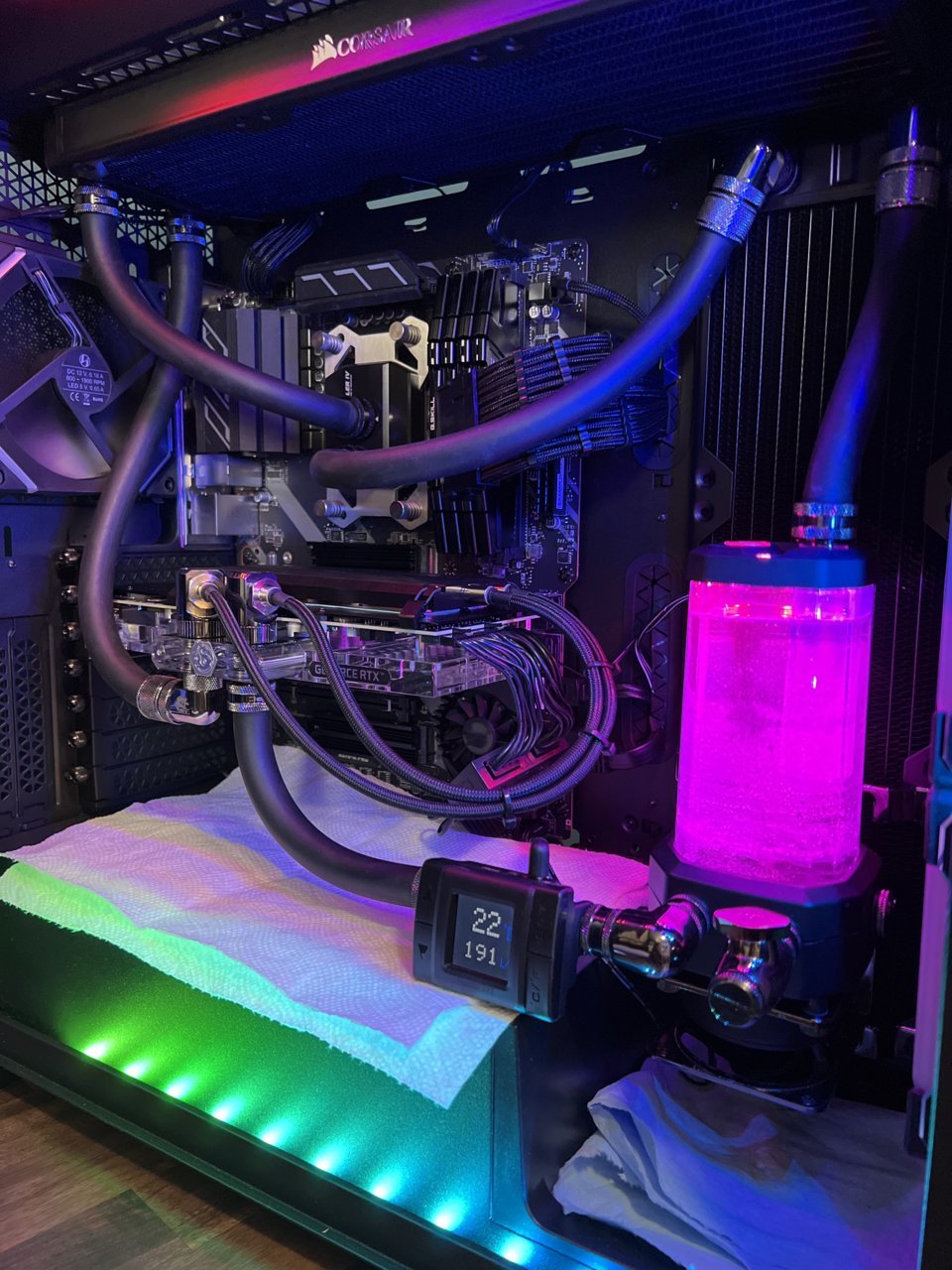

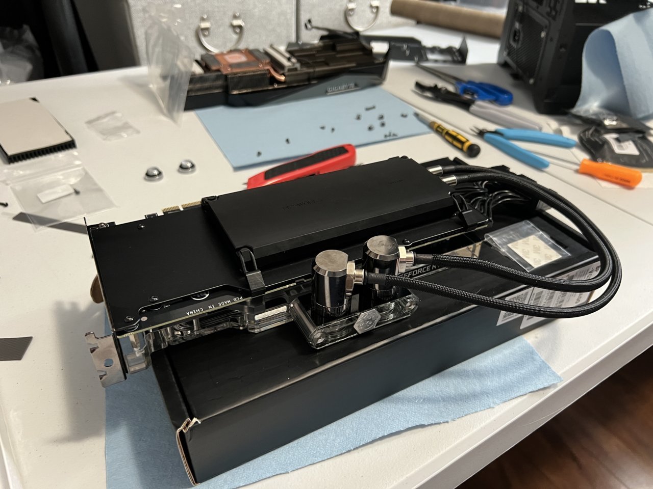

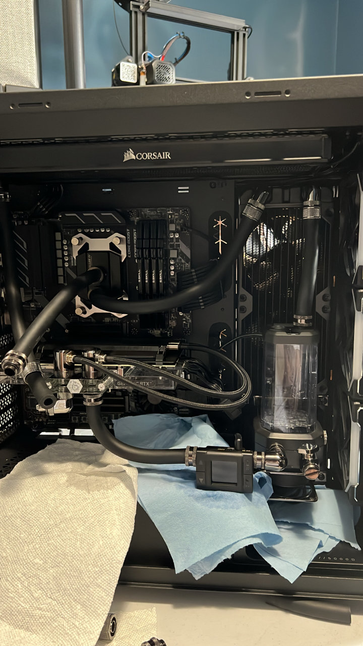

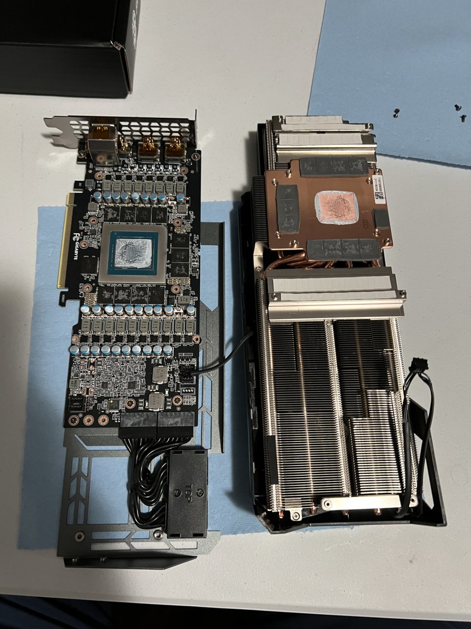

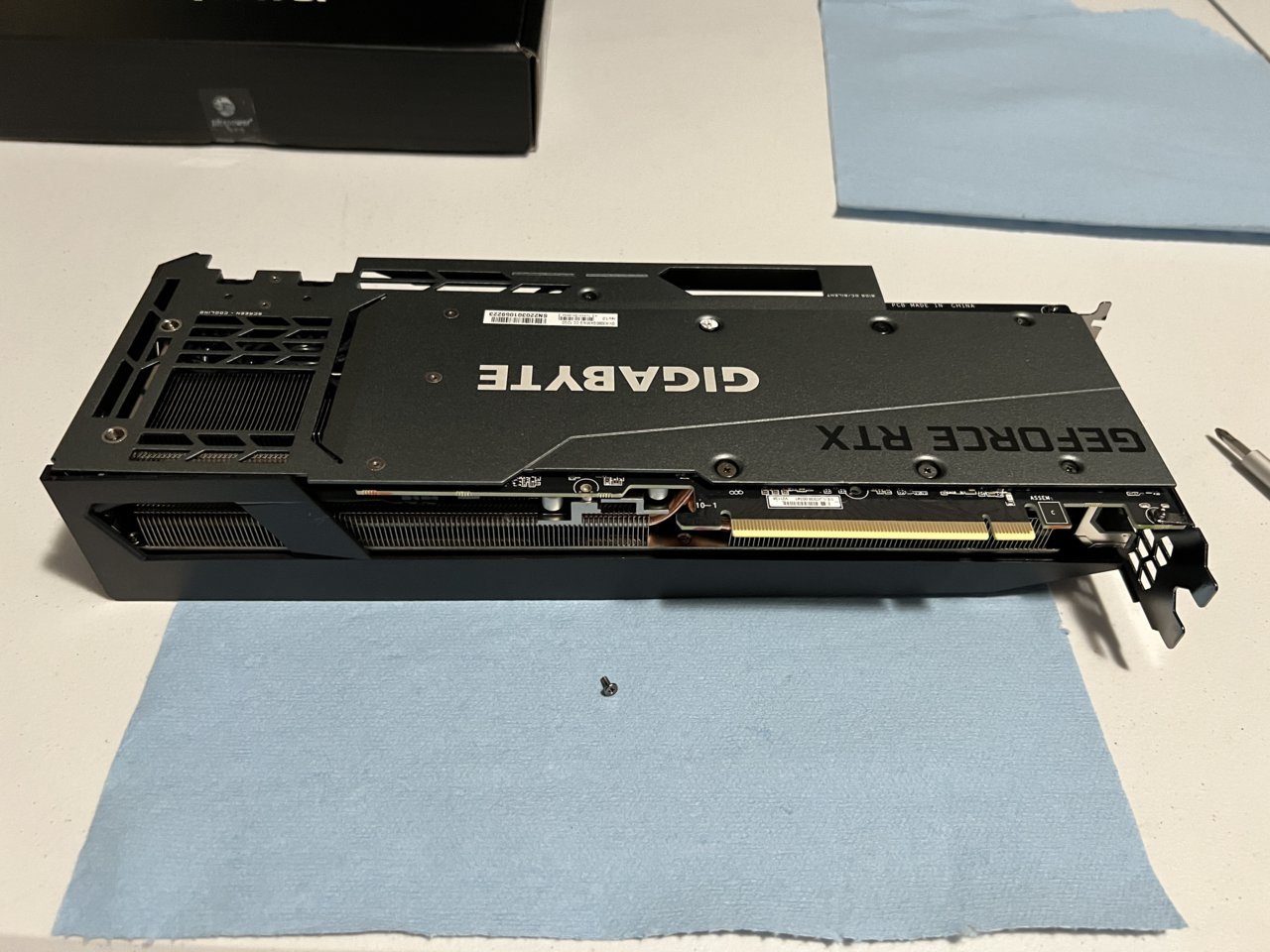

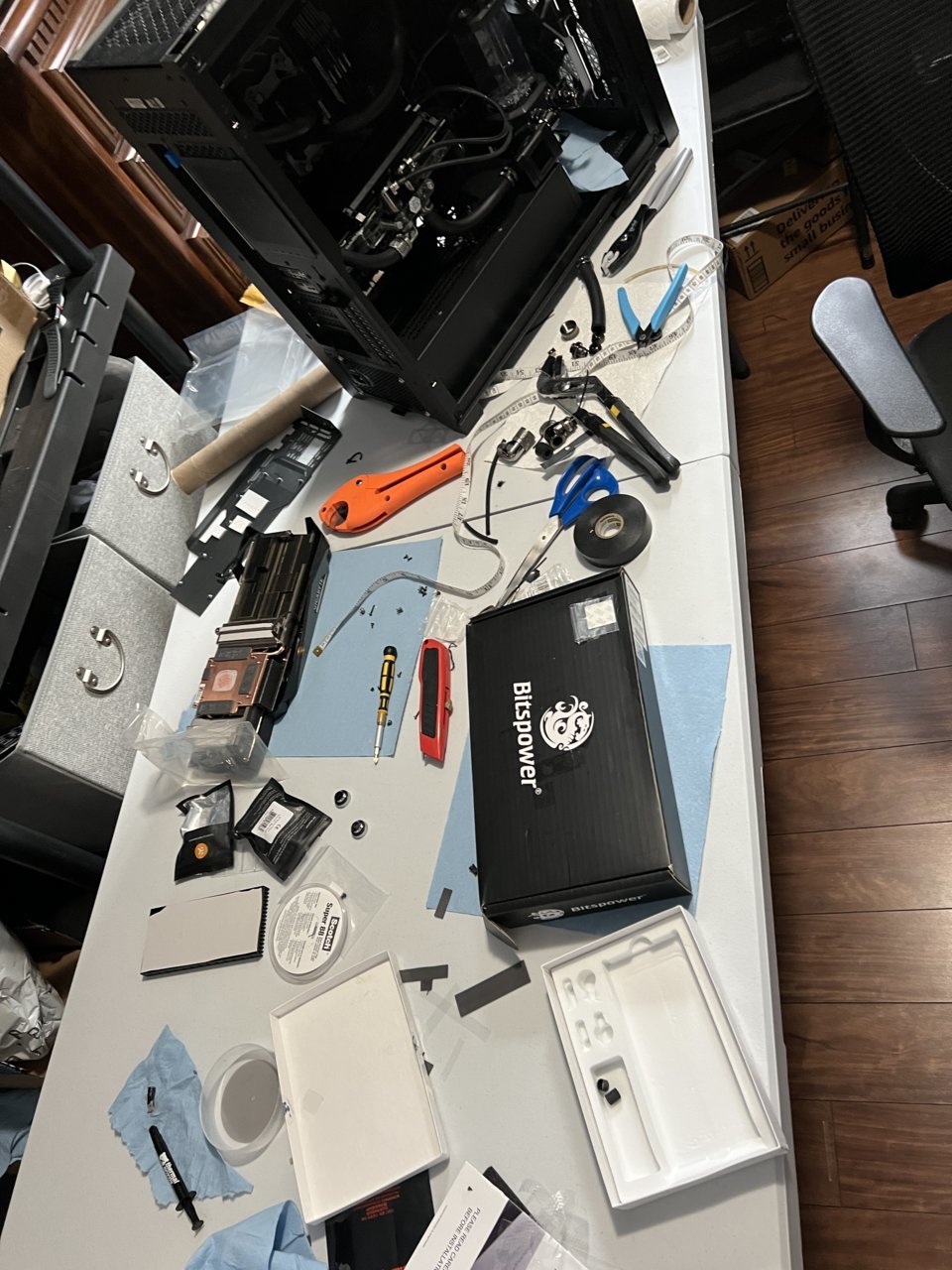

    Well yesterday was water block day!
    Last day for the temporary loop.
    Teardown time
    All cleaned up
    Thermal pads and thermal paste on!
    Active backplate installed in parallel
    First run done
    All done!
    The mess from the install
    First fill and leak test

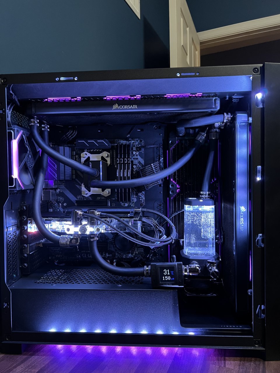

    95% done! Also, I swapped the fan to blow fresh air to help with the VRMs.
    Ran a few games of halo peaked at 48c down from 68c so decent delta!

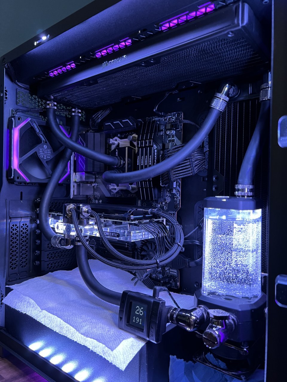

    Okay I promise after this I'm done.
    I'm convinced I can add another rad to the loop.
    Pump > GPU > Top Rad > CPU > Side Rad > Front Rad > Pump - In this Config, Front rad is intake and Top and Side Rads are exhaust
    Or
    Pump > GPU > Top Rad > CPU > Front Rad > Side Rad > Pump - In this config, the Side Rad would be intake and the Top and Front Rads would be exhaust
    I think option one makes the most sense.
    I can run a longer line from the CPU to the right inlet of the Side rad, from the left outlet of the side rad to the right inlet of the front rad and hopefully re use the run from the side rad to the pump to the front rad outlet to the pump

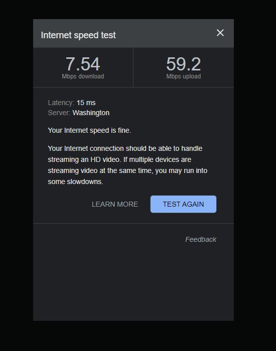

    Verdict is in. I ran back too back speed tests and the wifi 6.0 card wins over power line.
    Power Line:
    Wireless

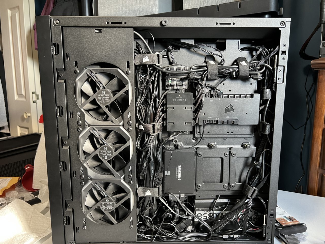

    3rd 360 rad added!
    And the cable management lol
    To fit the 3rd rad in the front I had to modify the case a bit and get creative with the mounting. Happy with how it’s turned out.

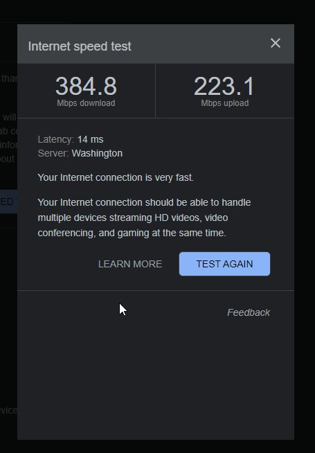

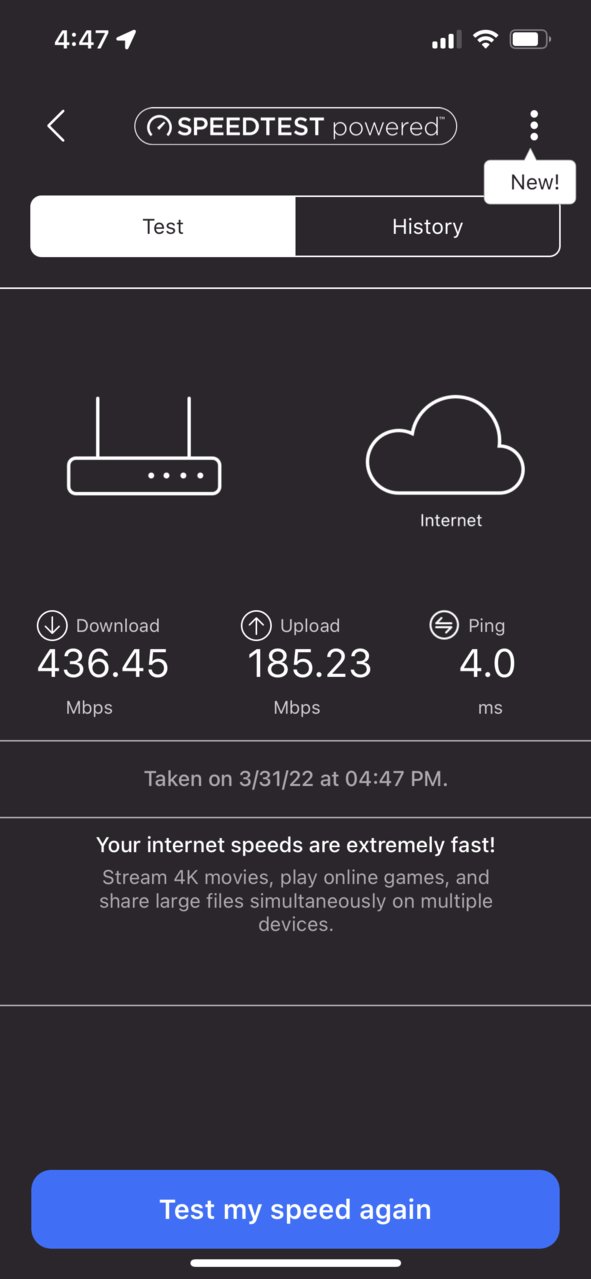

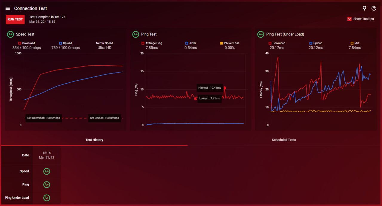

    Installed and configured this bad boy last night
    I’m pretty happy with it so far. Speed test on phone
    duma OS is fantastic. Lots to tinker with in here. Here are the results of the speed test on my computer which is a floor away

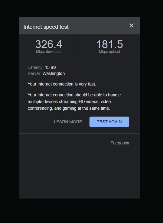

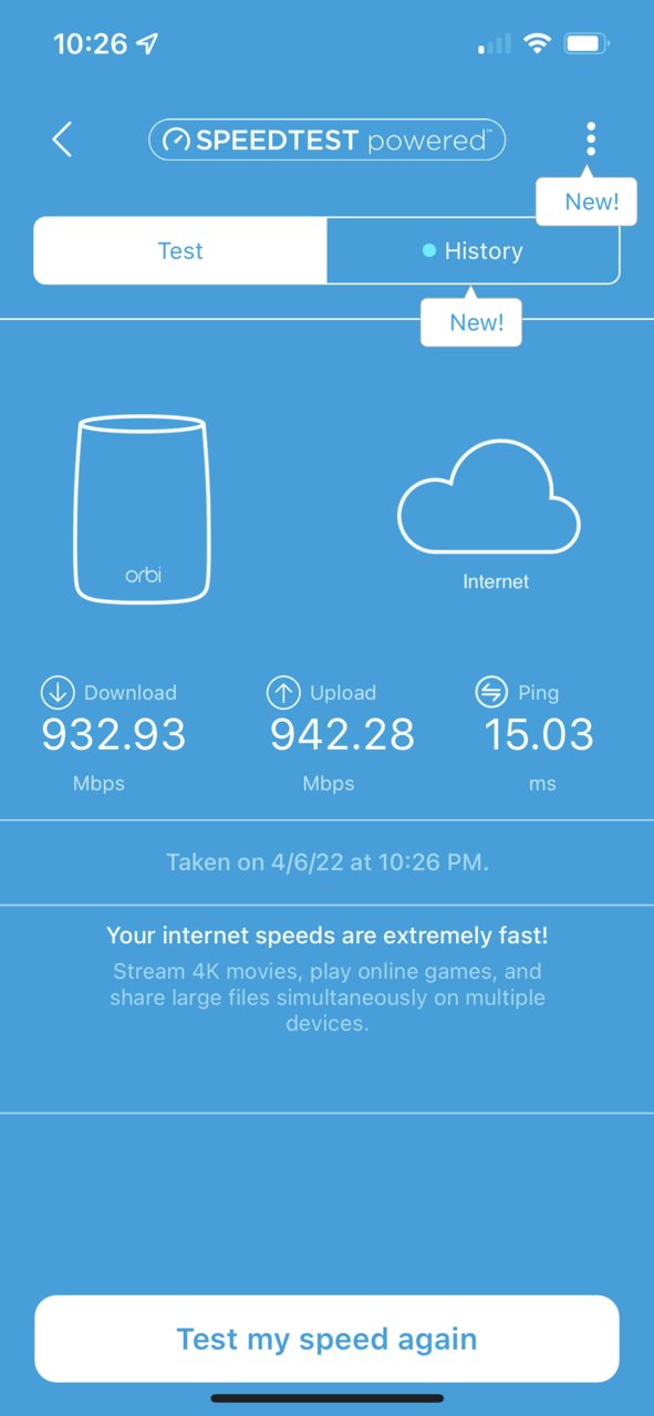

    XR1000 router was actually bottle necking my performance
    upgraded to Orbi Mesh
    This is a floor above and not near the satellite.
    these are the speeds on the router
    I’m pretty stoked with that
