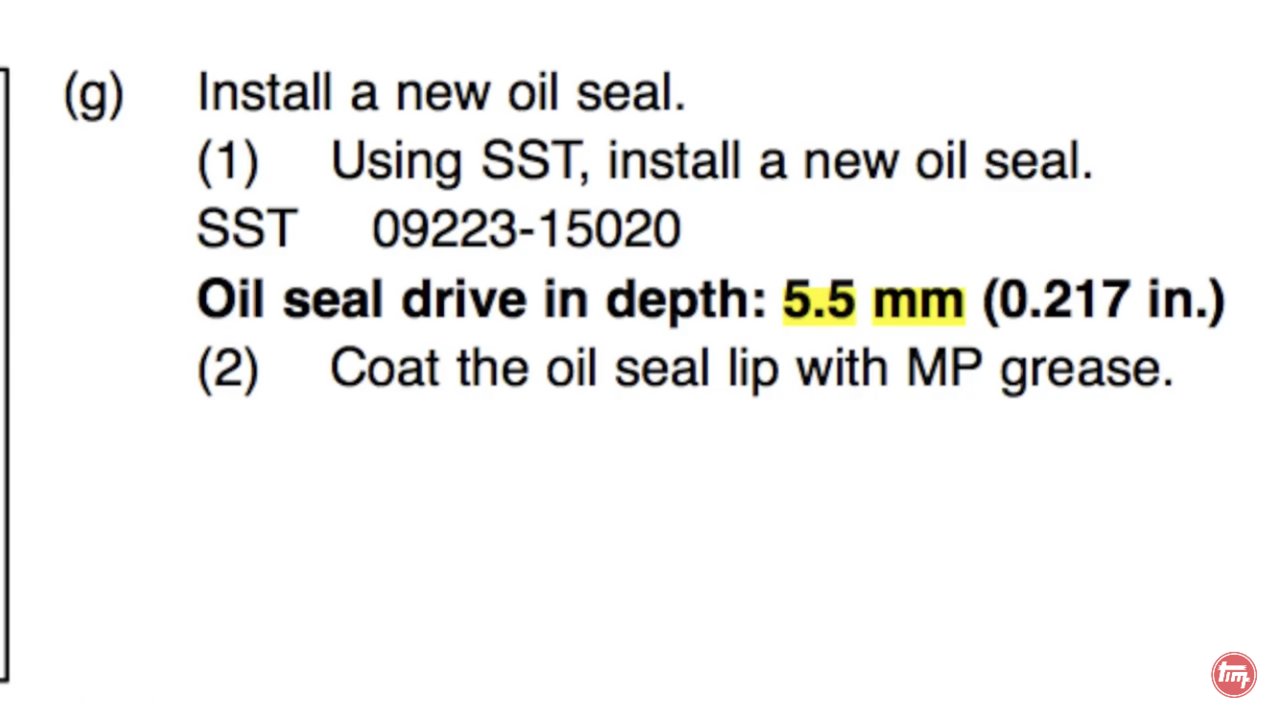

    2" PVC piece for the passenger side too. I had a picture in my phone for how deep that one needs to go. I think its 5mm in.

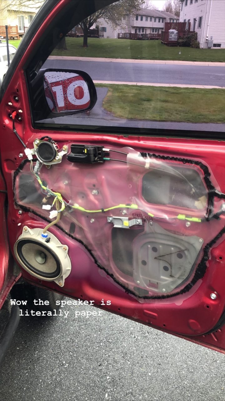

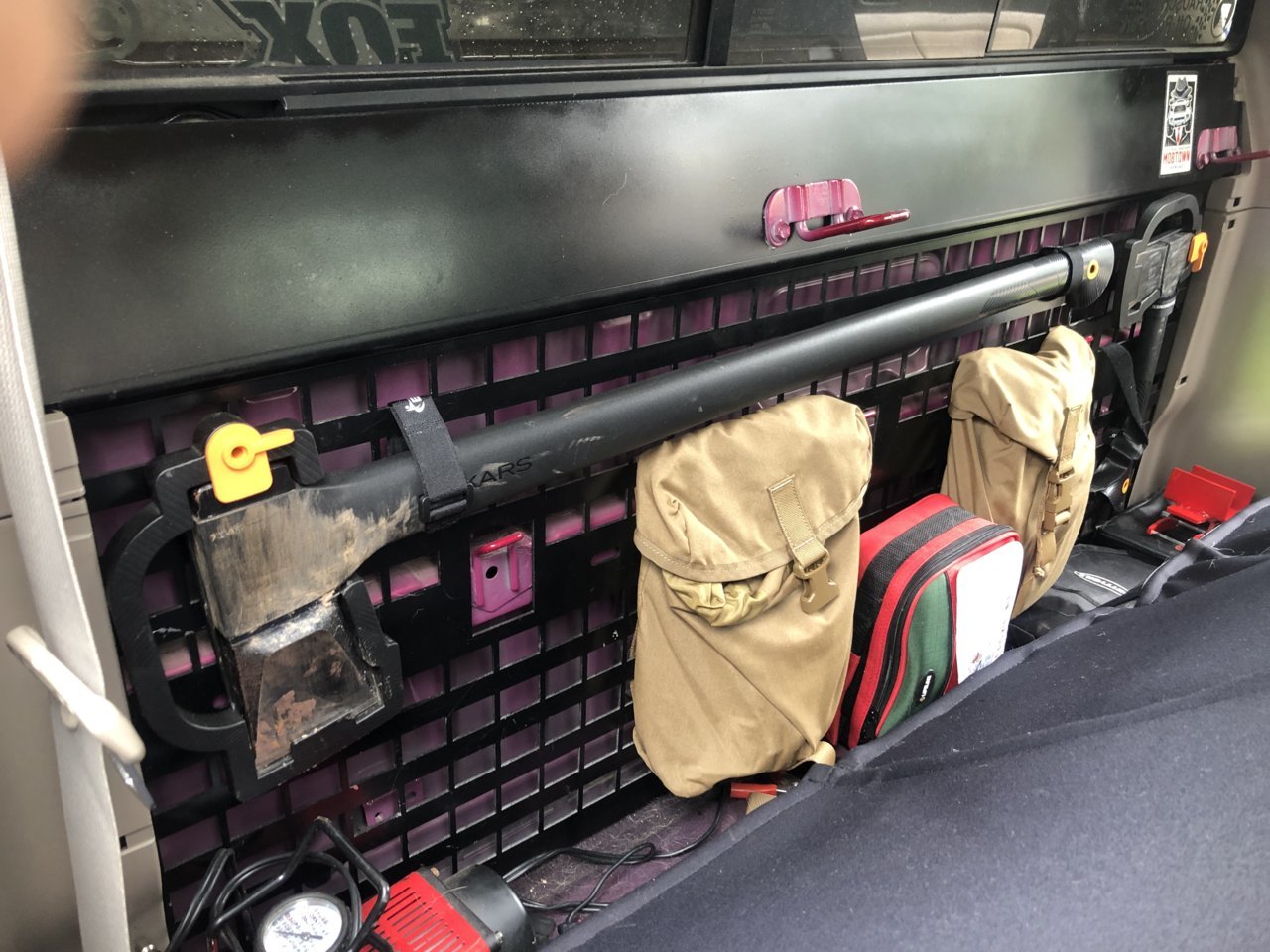

    Pulled the Molle panel out and got one door panel off before the rain came back :(
