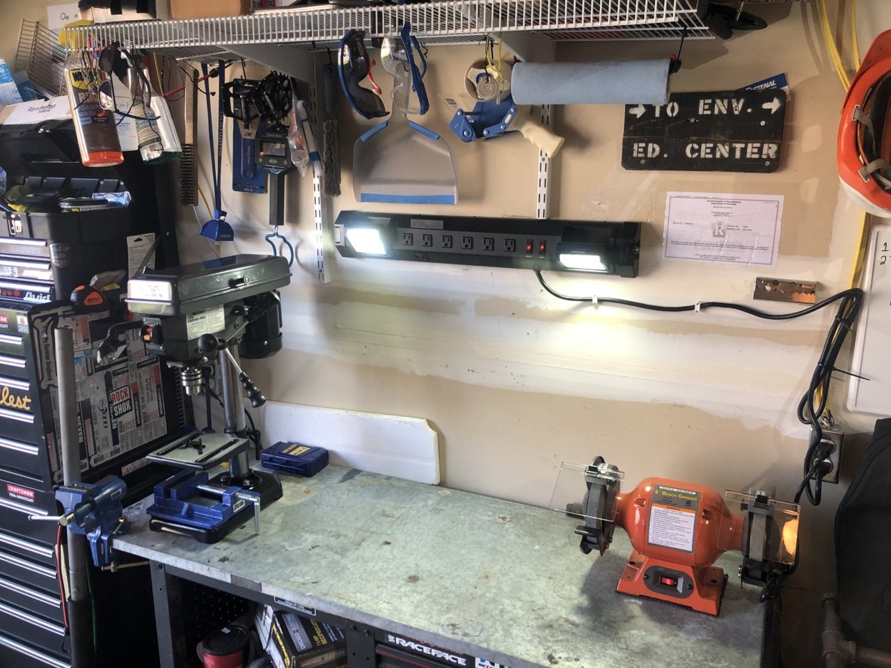

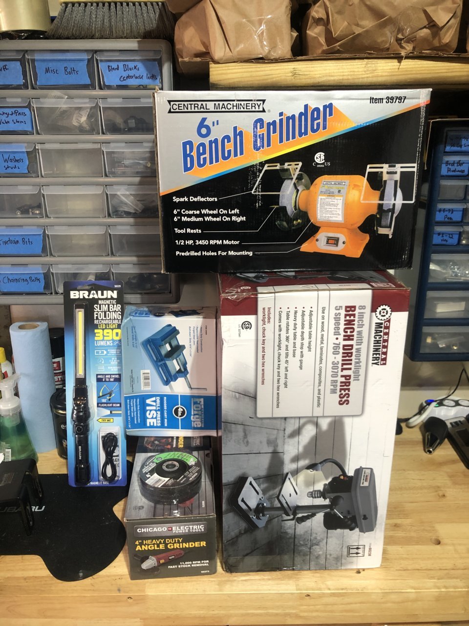

    Been busy prepping the garage / fulfillment center!
    Harbor Freight had a sale and I fell victim

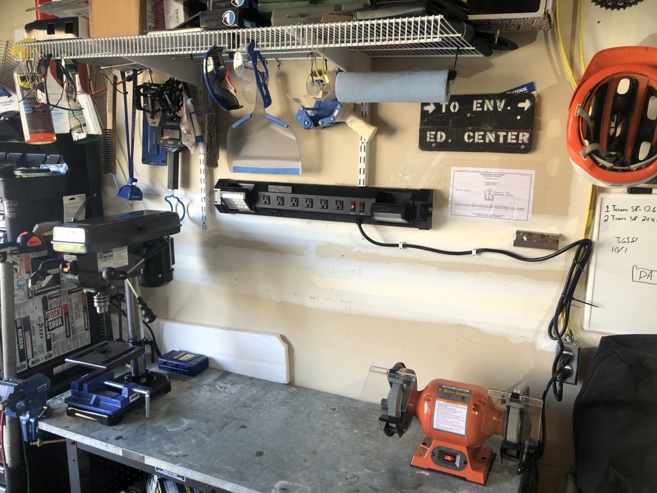

    Cleaned up and organized my tools, snagged a power strip with work lights and USB ports for cheap from Lowe’s
    Notice my sketchy outlets I added to the wall, as I only had one on the ceiling

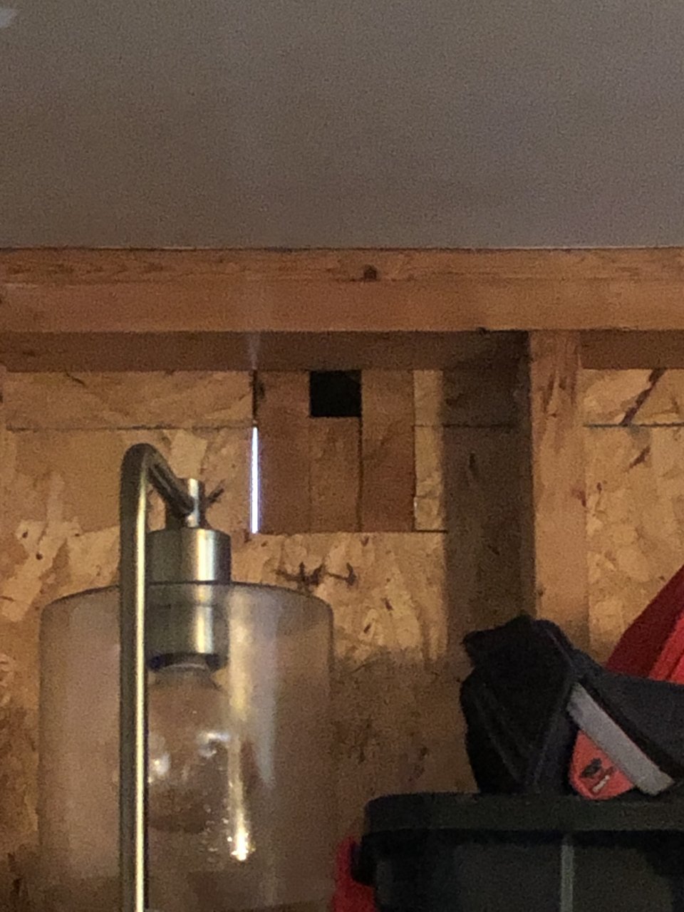

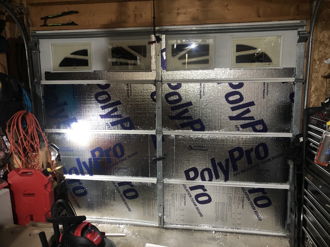

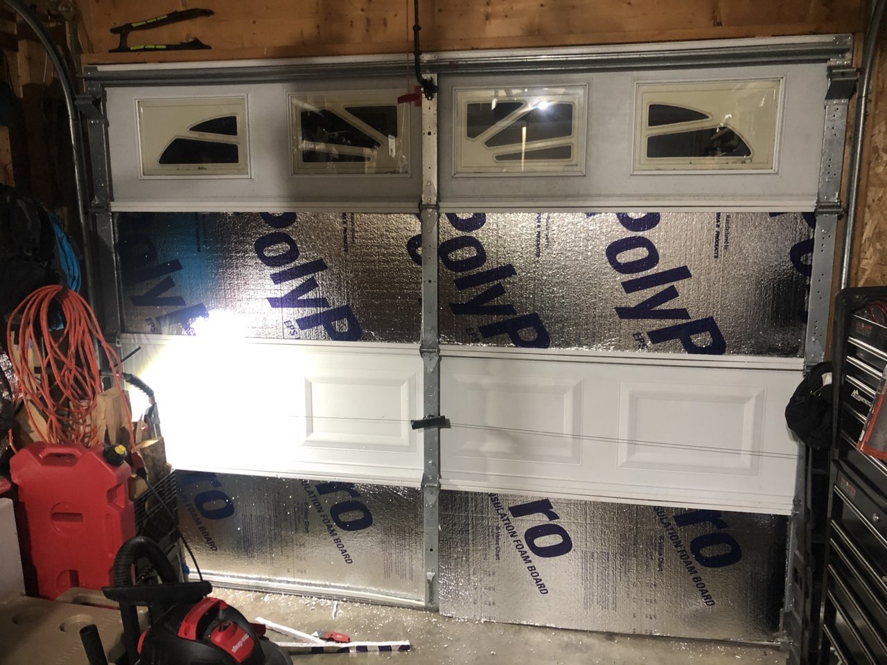

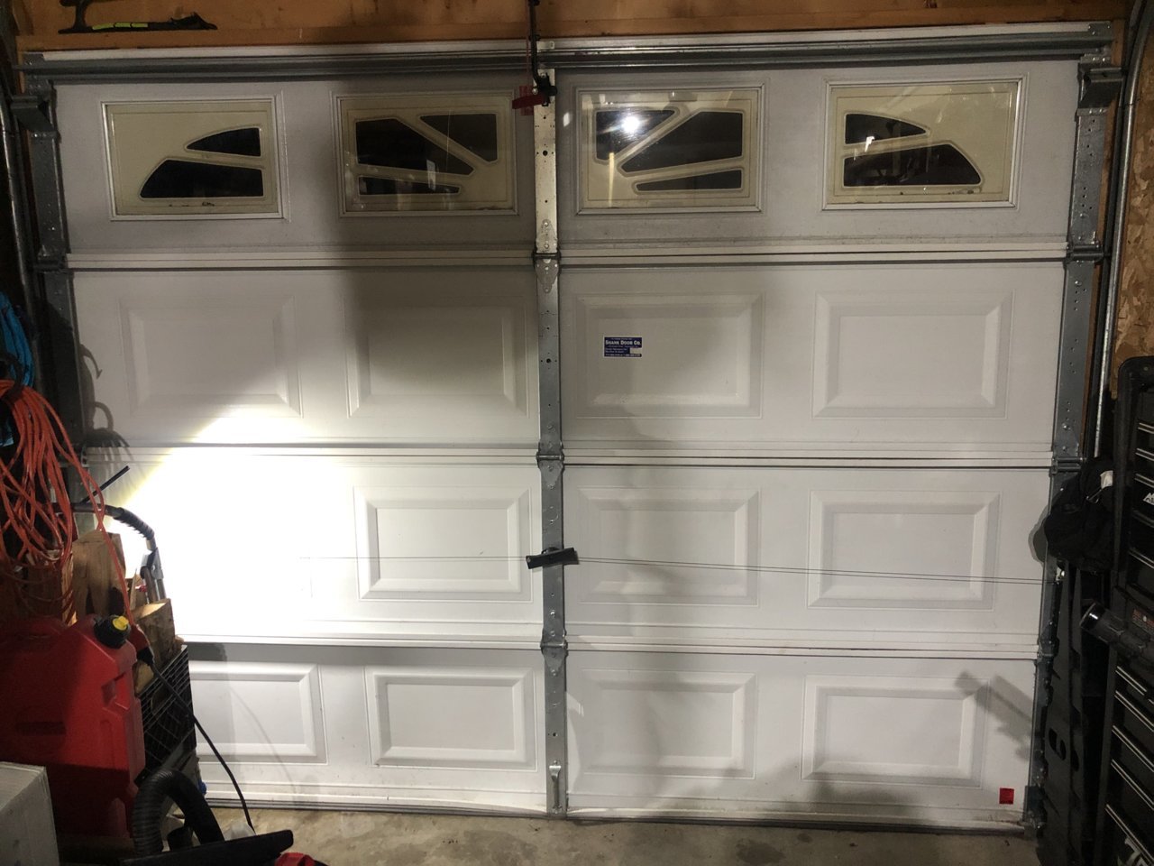

    Prepping for the cold by insulating the garage door
    wipe the door down
    Pop into place
    Used the scraps to get above the garage door too.
    Started sealing all the gaps I could too

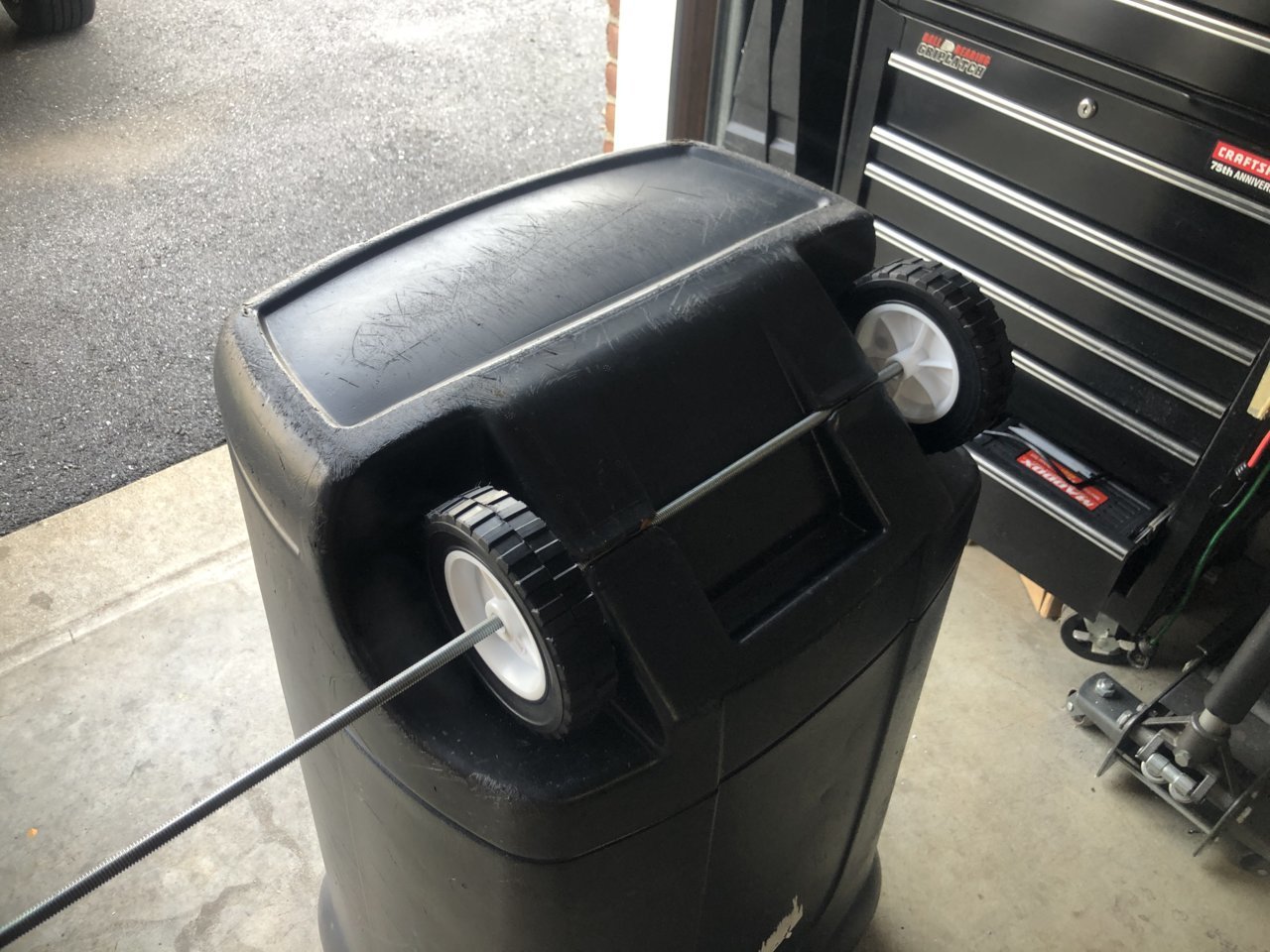

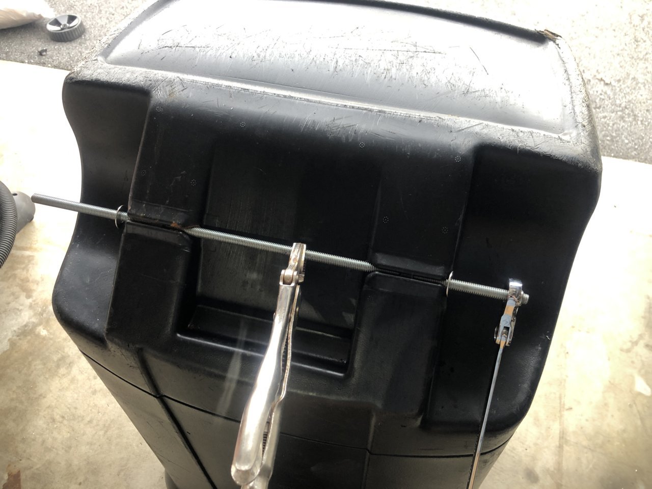

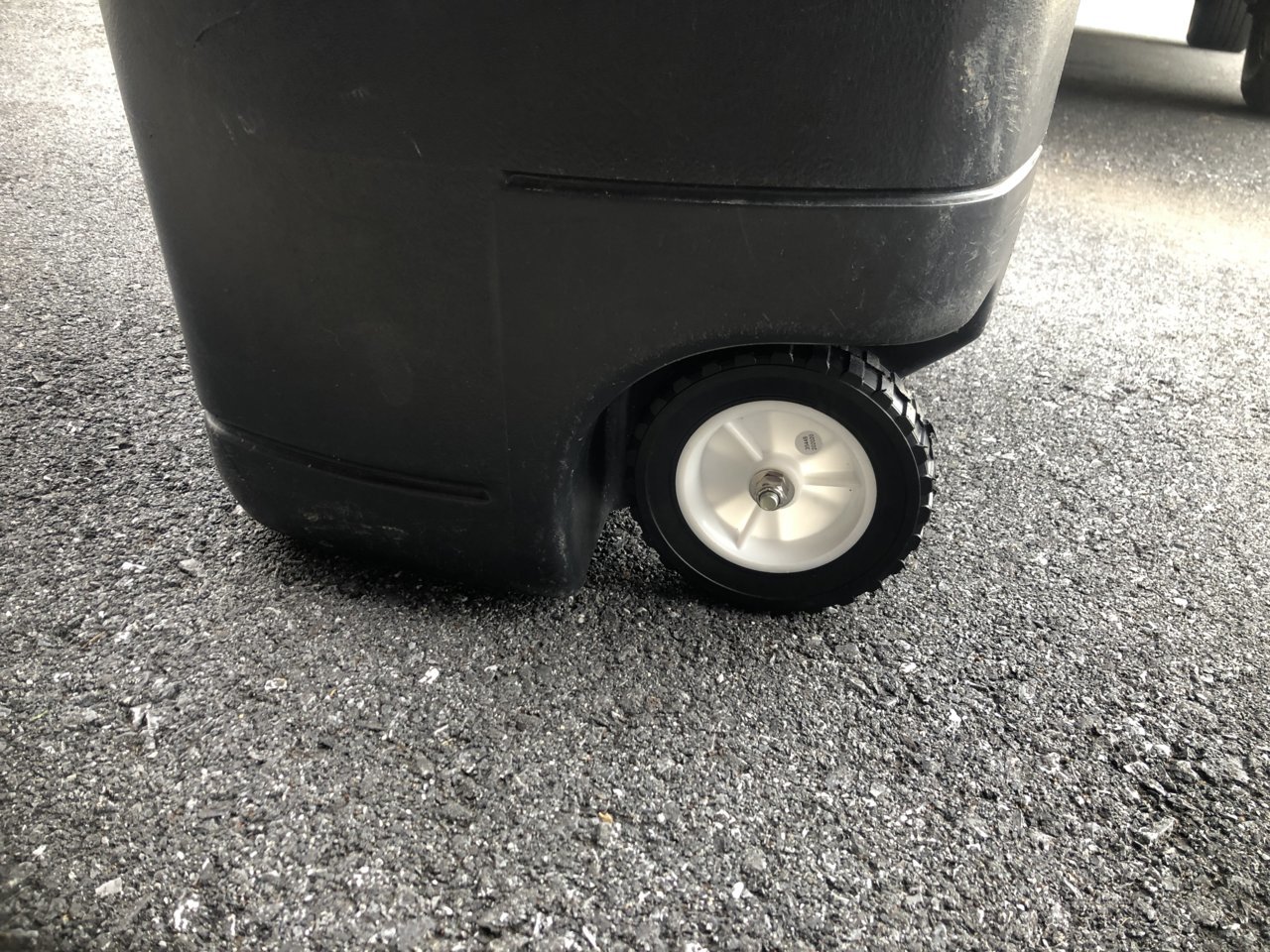

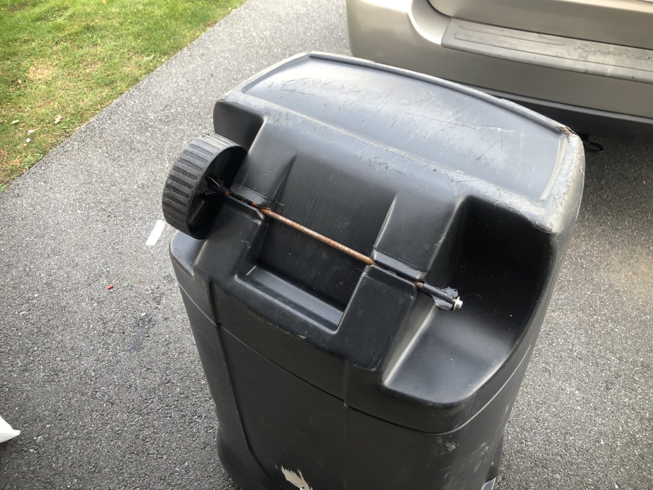

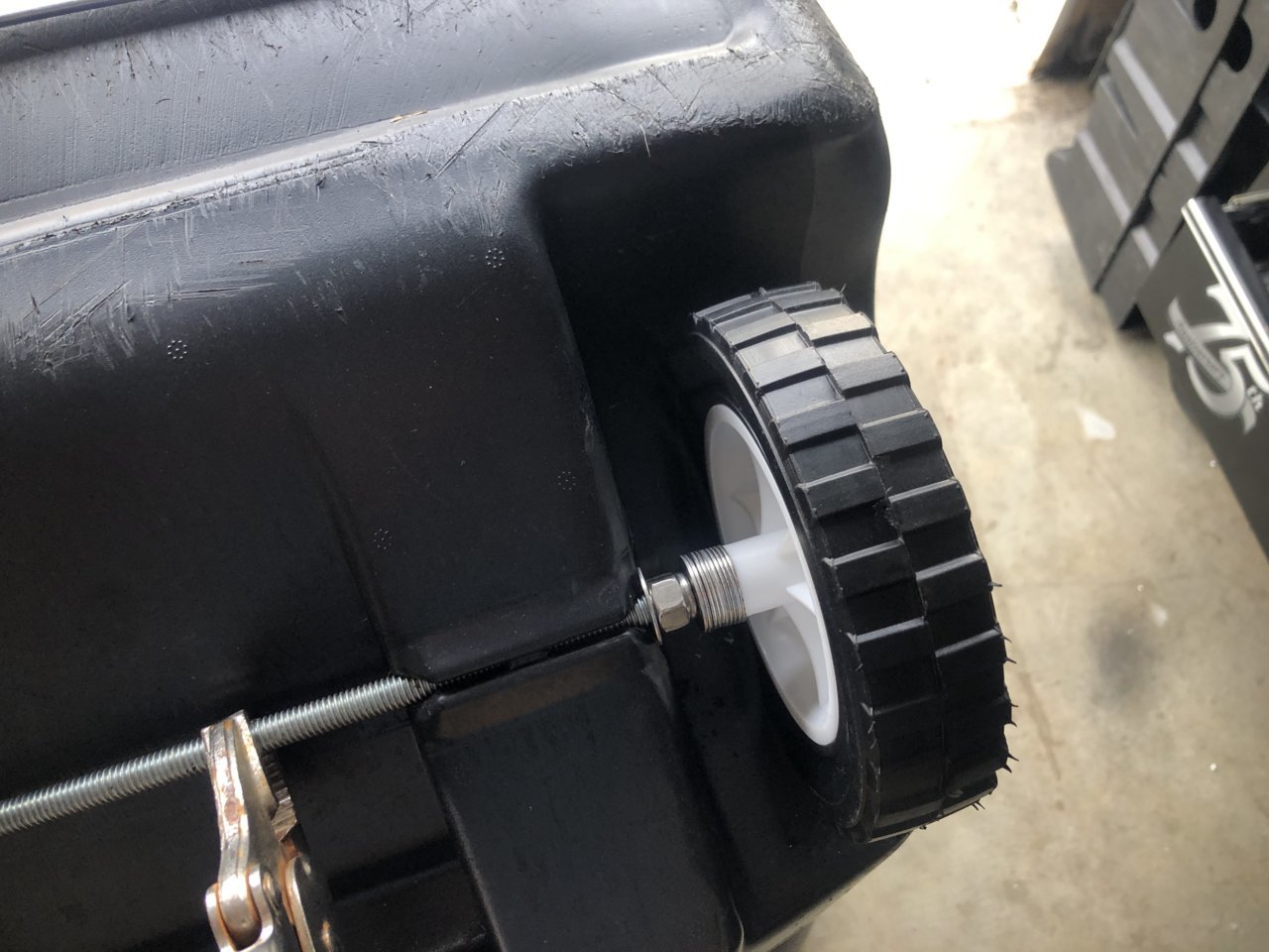

    Also, welcome to my trash can build.
    the wheels were trashed and one fell off, so I upgraded the wheels and axles :rofl:

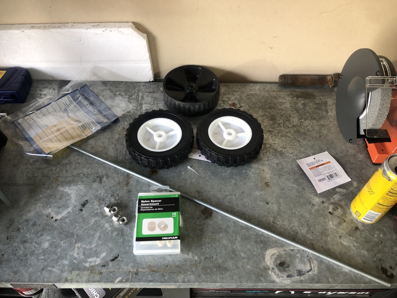

    3/8” threaded rod axle, heavy duty wheels, spacers for axle bushings
    Eye ball the length
    Drilled the spacers out to act as a bushing
    Nylock nuts to keep the threaded rod in place

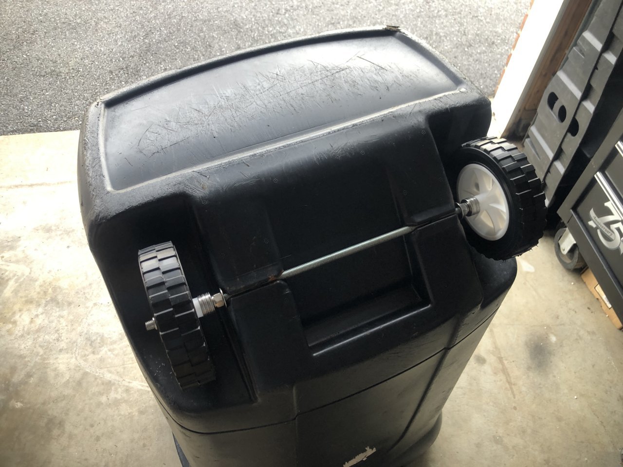

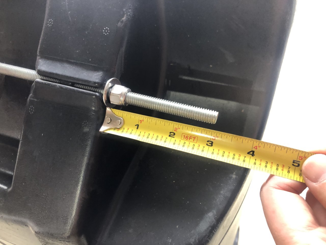

    My OCD made me measure so the shafts were equal length
    some washers to set track width (yes my hardware is stainless, I’m boogie)
    Annnnd done. $15 spent on a worthless trash can
    An Added benefit is its bottom heavy now

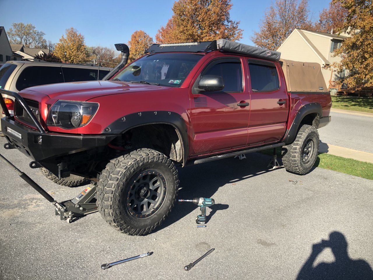

    Tire rotation today
    @MY50cal old timberens are showing what the east coast does :rofl:

    You actually made out. By me any garbage can that’s even worth buying is $50 or better
  8. Nov 9, 2020 at 12:44 PM
    #2248
    Nimble9
    Nimble9 [OP] visit squareonecreations.com Vendor
    Oct 20, 2015
    #167184
    11,157
    Lebanon, PA
    2006 4x4 DCSB
    enough to have fun
    That's actually why I did it. I went to Lowes to get a replacement, and they were like $50 or more! :eek:
    So I picked up threaded rod and hardware there and some wheels at HF and saved some coin lol

    Crikey, not only is that illegal it's downright dangerous. Put some THHN in metal conduit, doesn't cost any more money and it'll be done right. Once that wire shorts out against the box, insurance won't cover your house when it burns down.
  13. Nov 11, 2020 at 1:00 PM
    #2253
    EatSleepTacos
    Mar 24, 2015
    #151688
    59,834
    Randy
    West Valley, AZ
    2017 4Runner
    It’s dangerous to have a wall mounted power strip? How?
    edit: oh wait you probably mean the outlet.

    Haha I’ll get around to it :)

    That's not something to wait to fix.

    Yes, outlet
    Electricity travels faster than a round tuit, don't understand why someone would take the time to half ass that when it's no more work to just do it right the first time :annoyed:
    Hopefully doesn't come back to bite you in the arse.

    what should I use?? I didn’t actually do that myself, a friend of a friend offered to hook me up while we were on our honeymoon lol

    a new friend
    armored cable with proper clamps and anti-short bushings
    or maybe an electrician :notsure:
