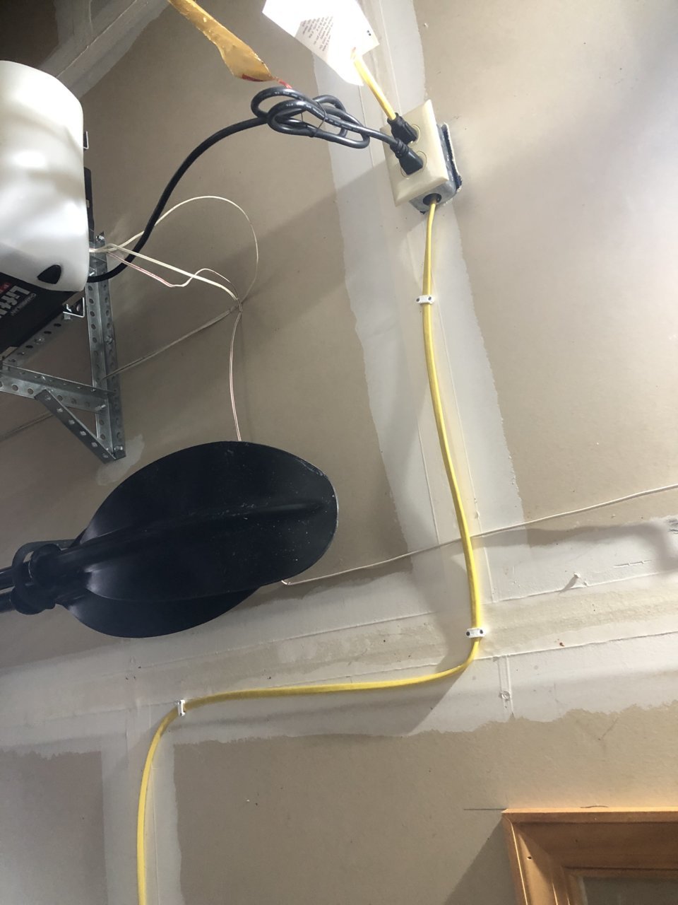

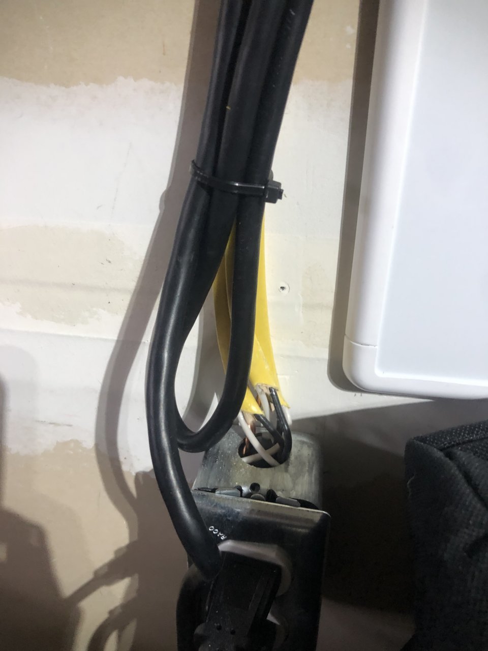

    That sounds no friend I’d want to do any work for me. THHN in PVC or metal conduit. Or MC cable with anti short bushings as mentioned above. Exposed Romex in a garage is a no no. Let alone shoved in a metal box with no bushing.

    @Nimble9 listen to this guy. He knows what he’s saying. The guy runs nuclear power plants for a living.

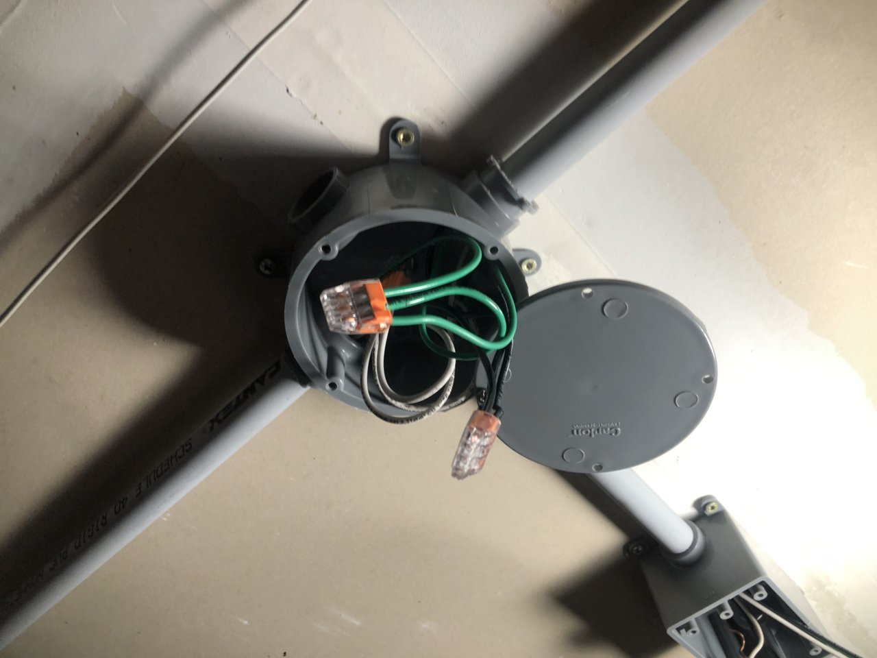

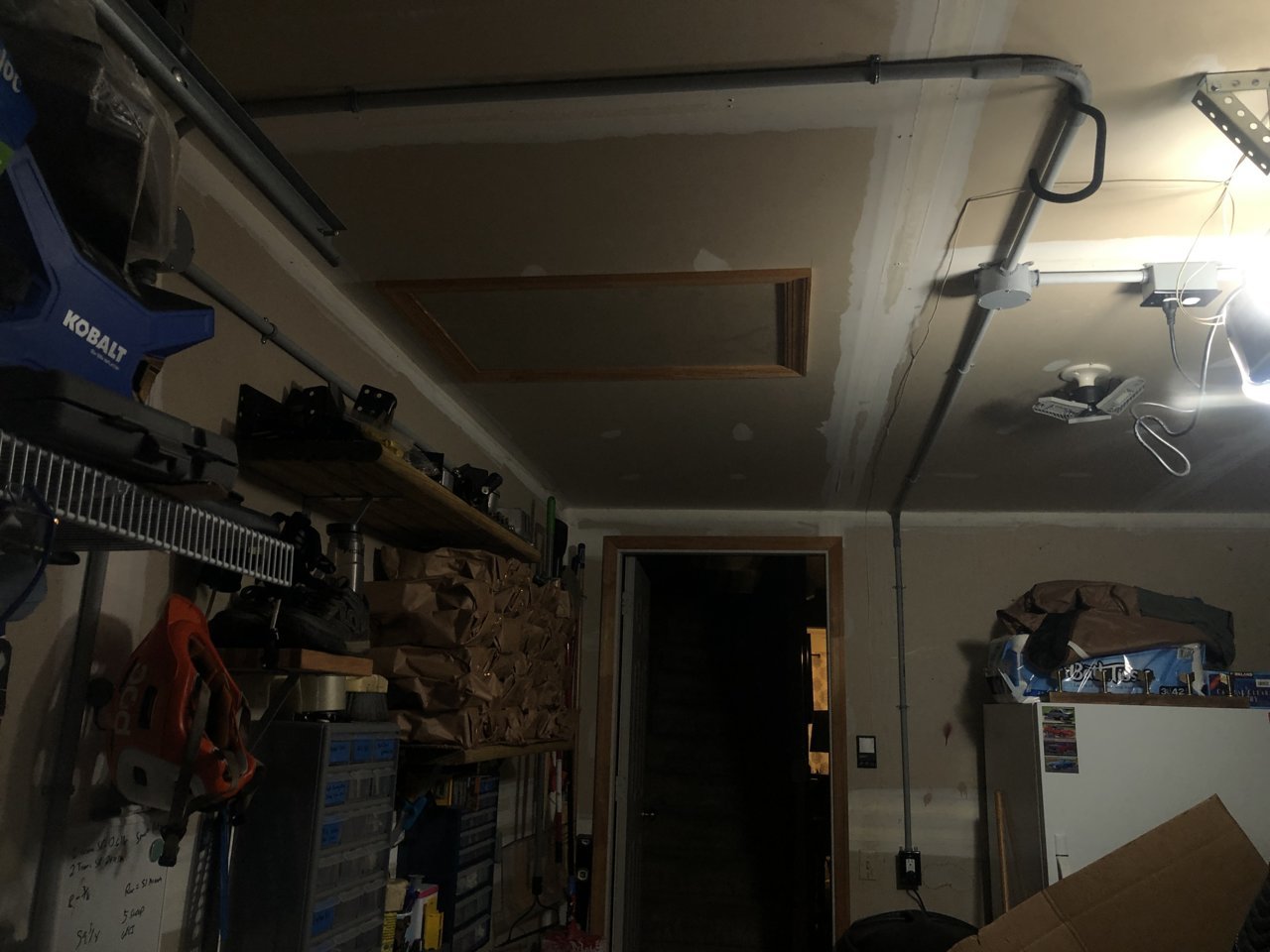

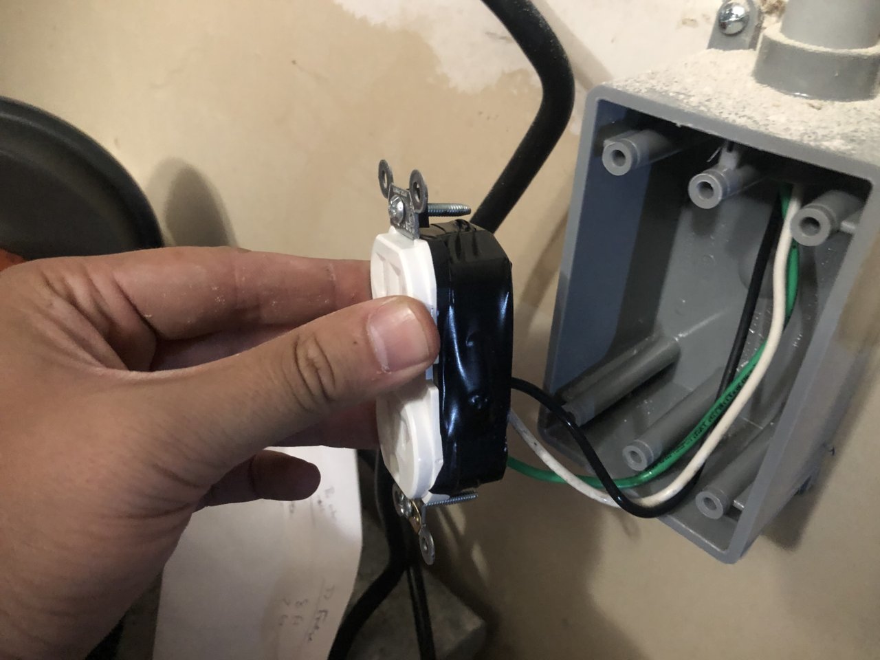

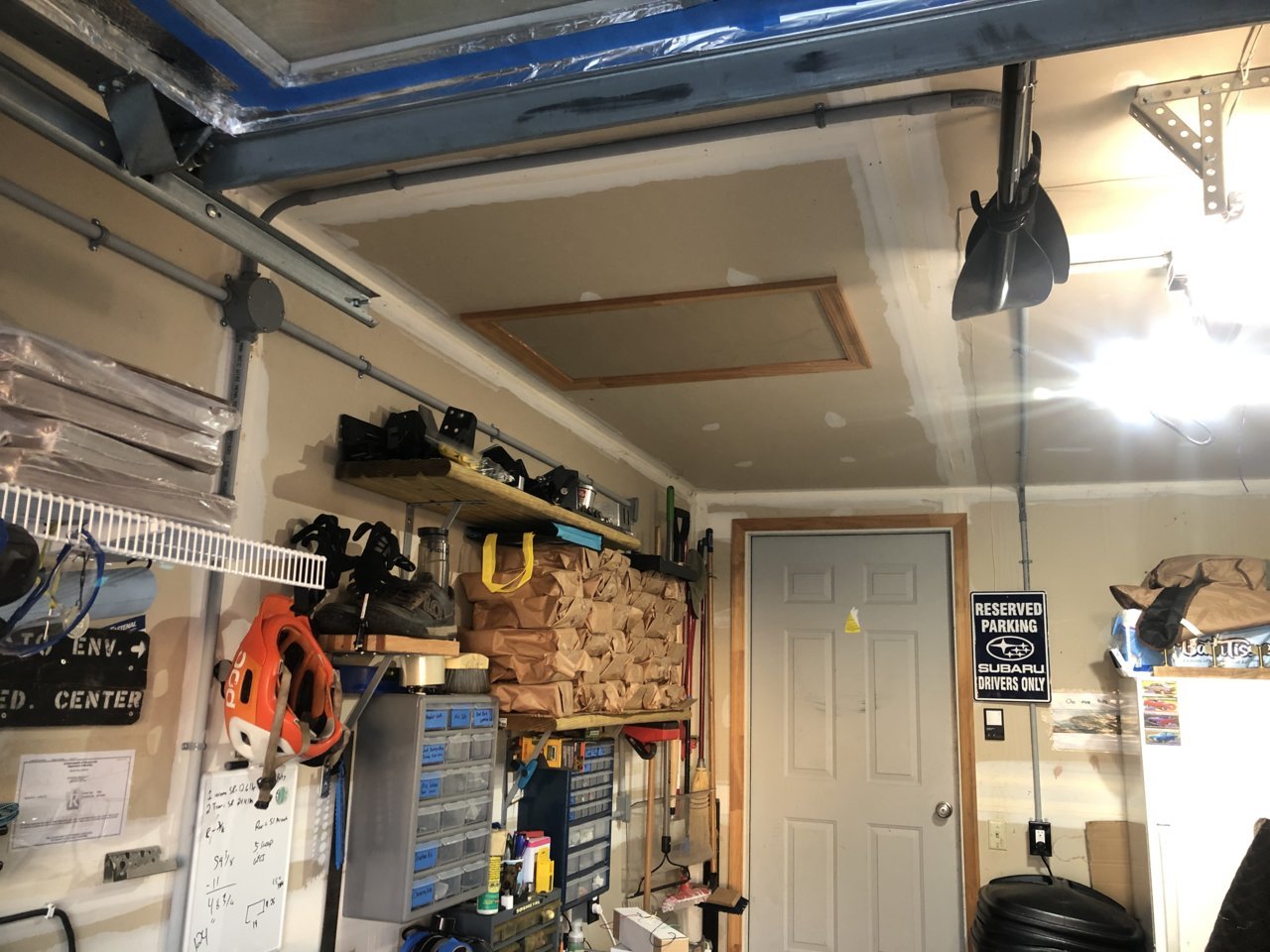

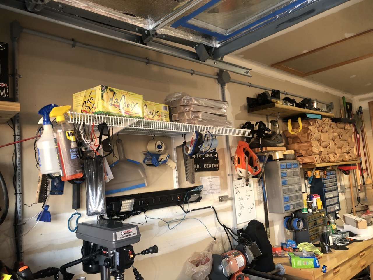

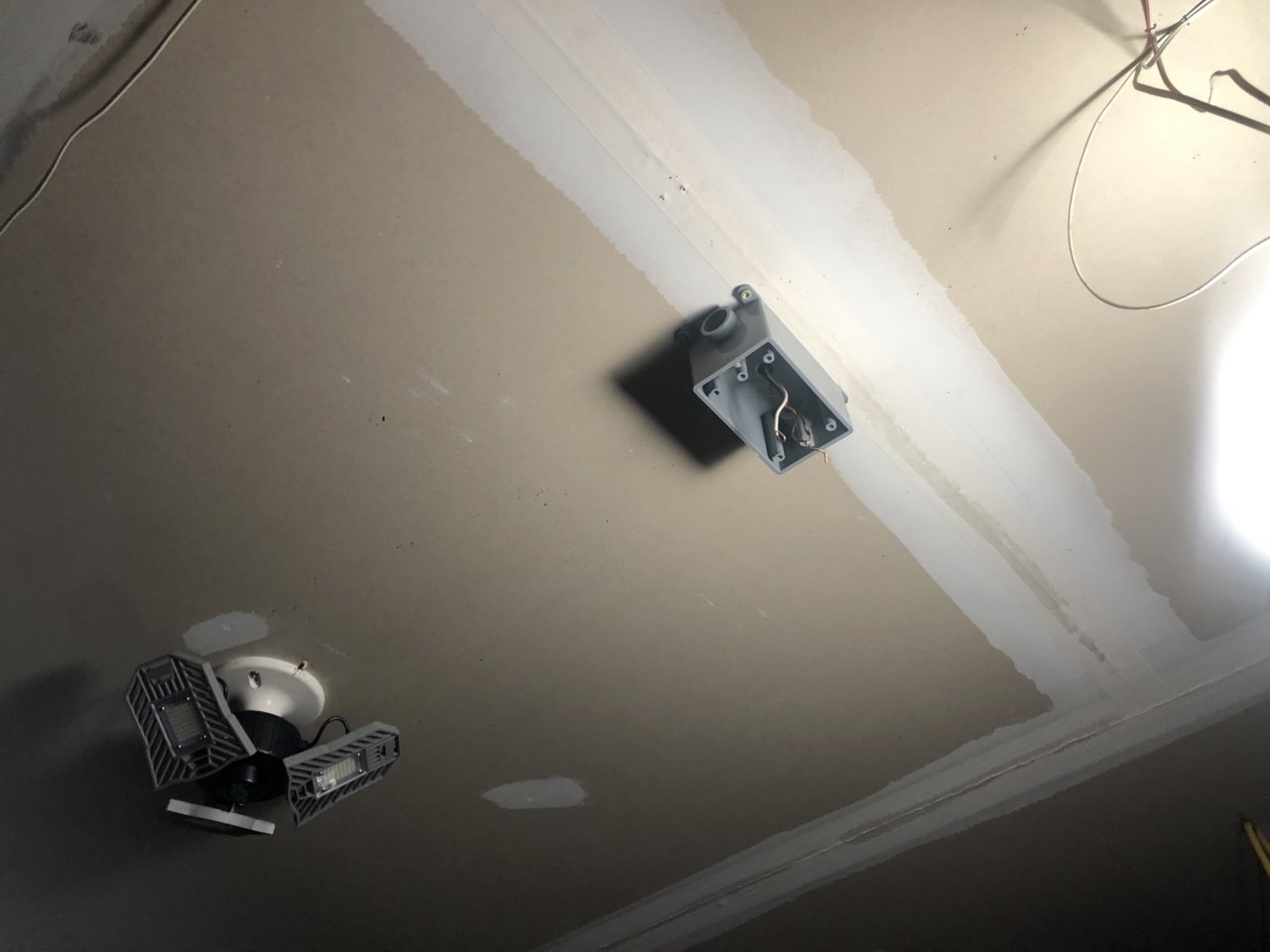

    First of all thank you to @6 gearT444E for the heads up.

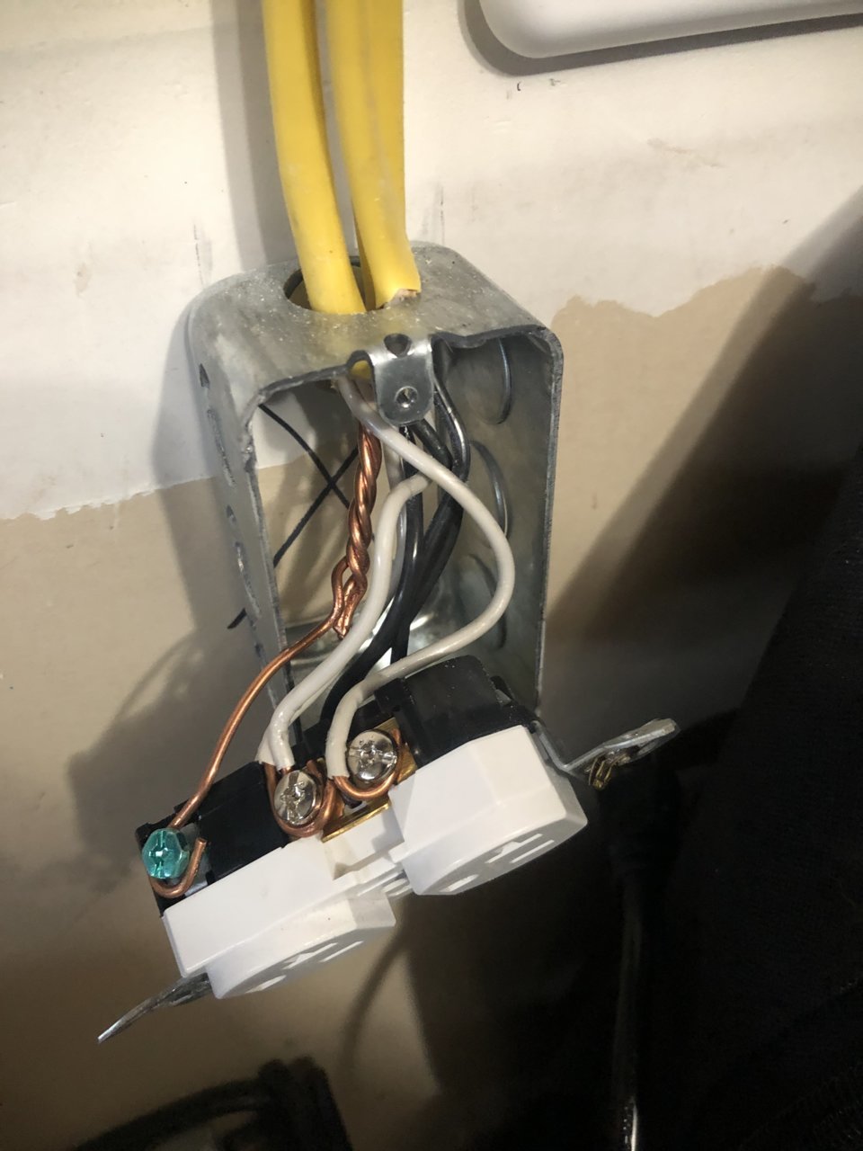

    I wanted to say that after learning how to add outlets myself, I now realize what was so wrong with the old outlets.
    The before photos - I knew it looked sketchy but I didn’t realize how sketch
    from the ceiling
    Center outlet had all the wire tied into it
    Made a trip to HD
    - wayyyy better than Lowes. Better prices and they actually had everything, unlike Lowes where we went for a simple 90 since we decided to add an extra outlet and they had no inventory for anything we would have needed

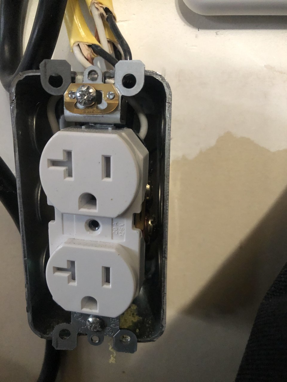

    So turned the breaker off and started tearing the sketch out. Found out the outlets in the metal box weren’t even taped. This is the hot side exposed. Also they weren’t anchored to the walls properly

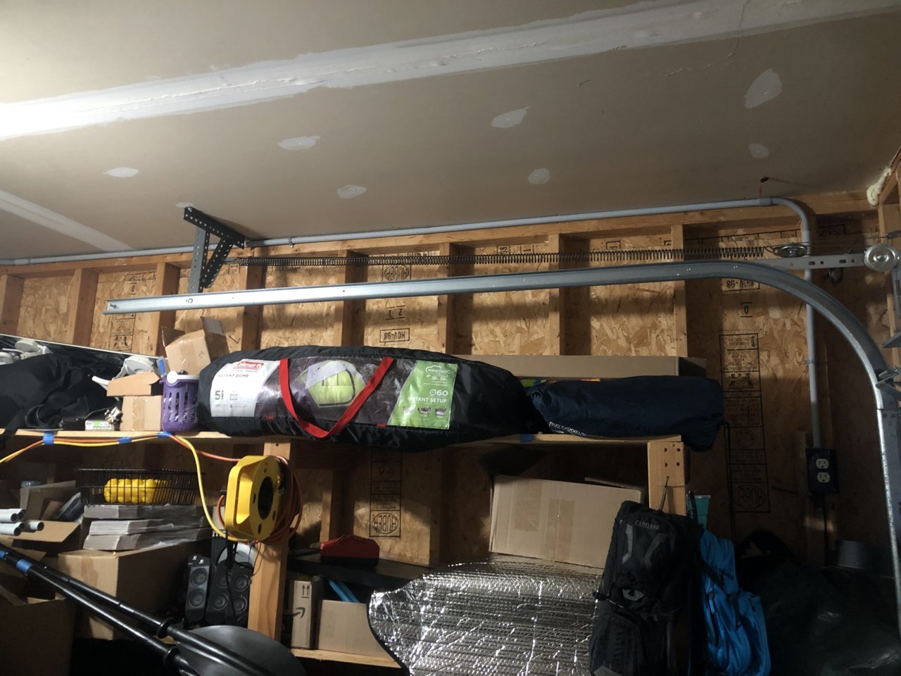

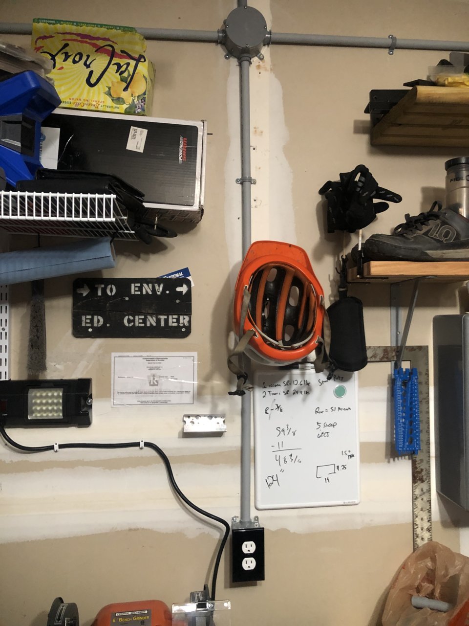

    Existing crap

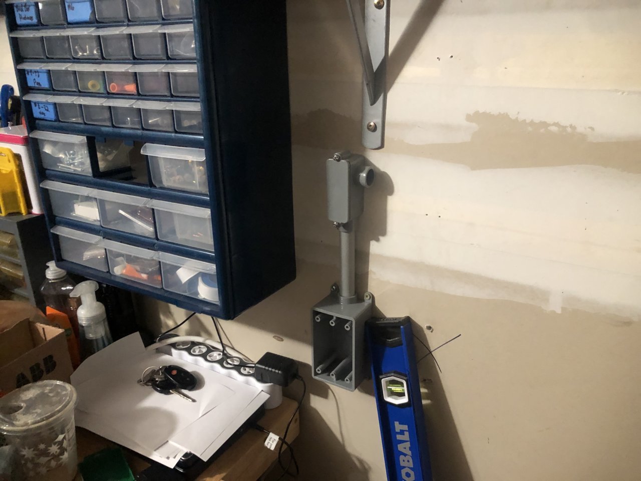

    New surface mount boxes
    90s around my shelves
    Sweet 4 way connectors
    All taped before buttoning it back up
    Added another outlet towards the garage door for things like the pressure washer and shop Vac
    I’m very grateful to have some friends that know what they are doing, and take a day to show me how to do it! So I learned how to run conduit, fish wires, and a bunch of other stuff. Overall the first attempt that was done wasn’t just lazy, but downright dangerous.

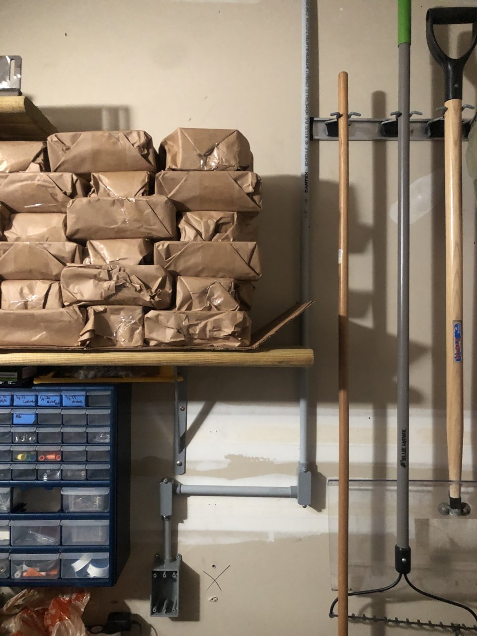

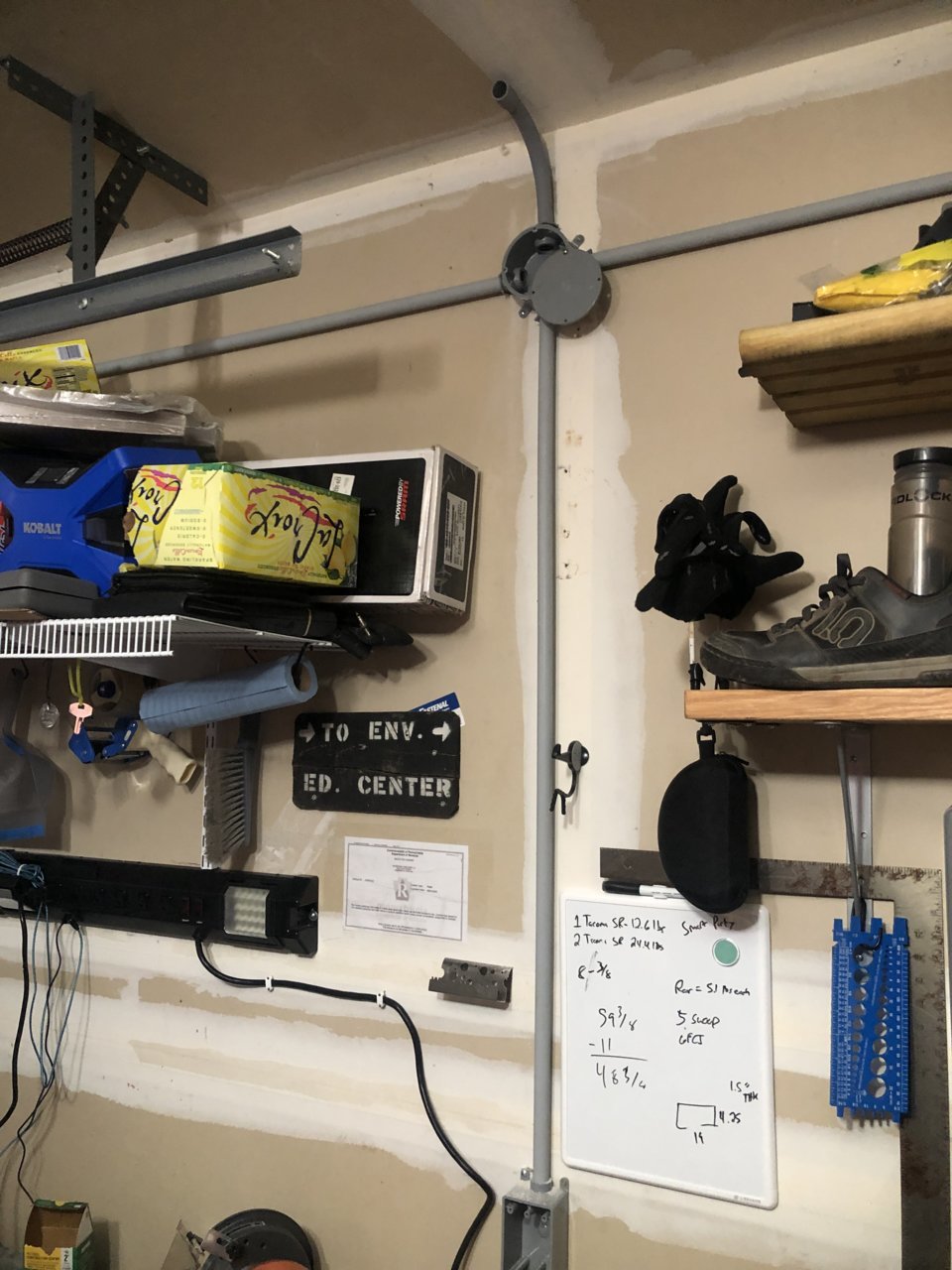

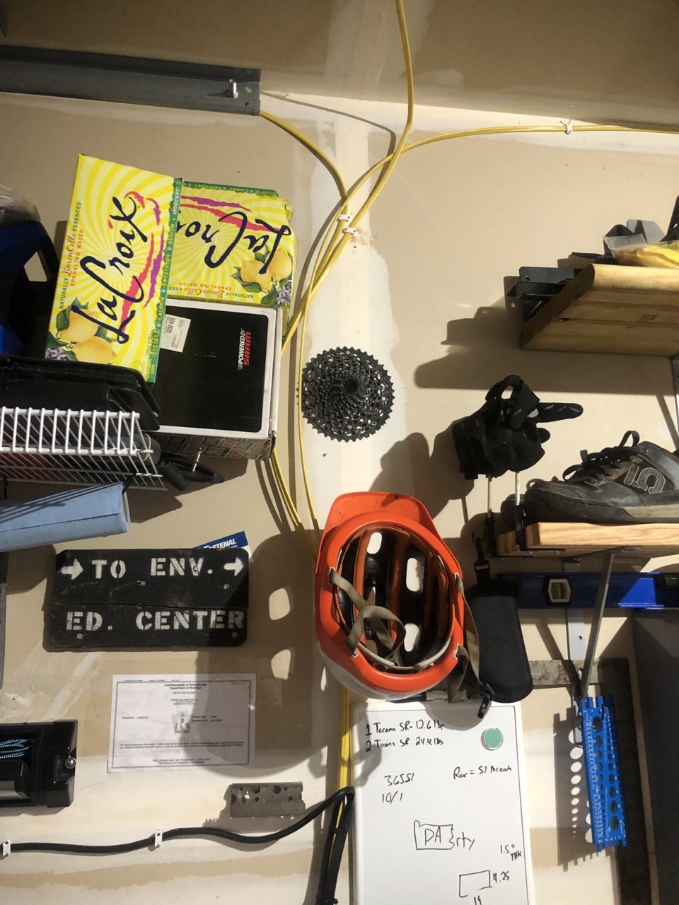

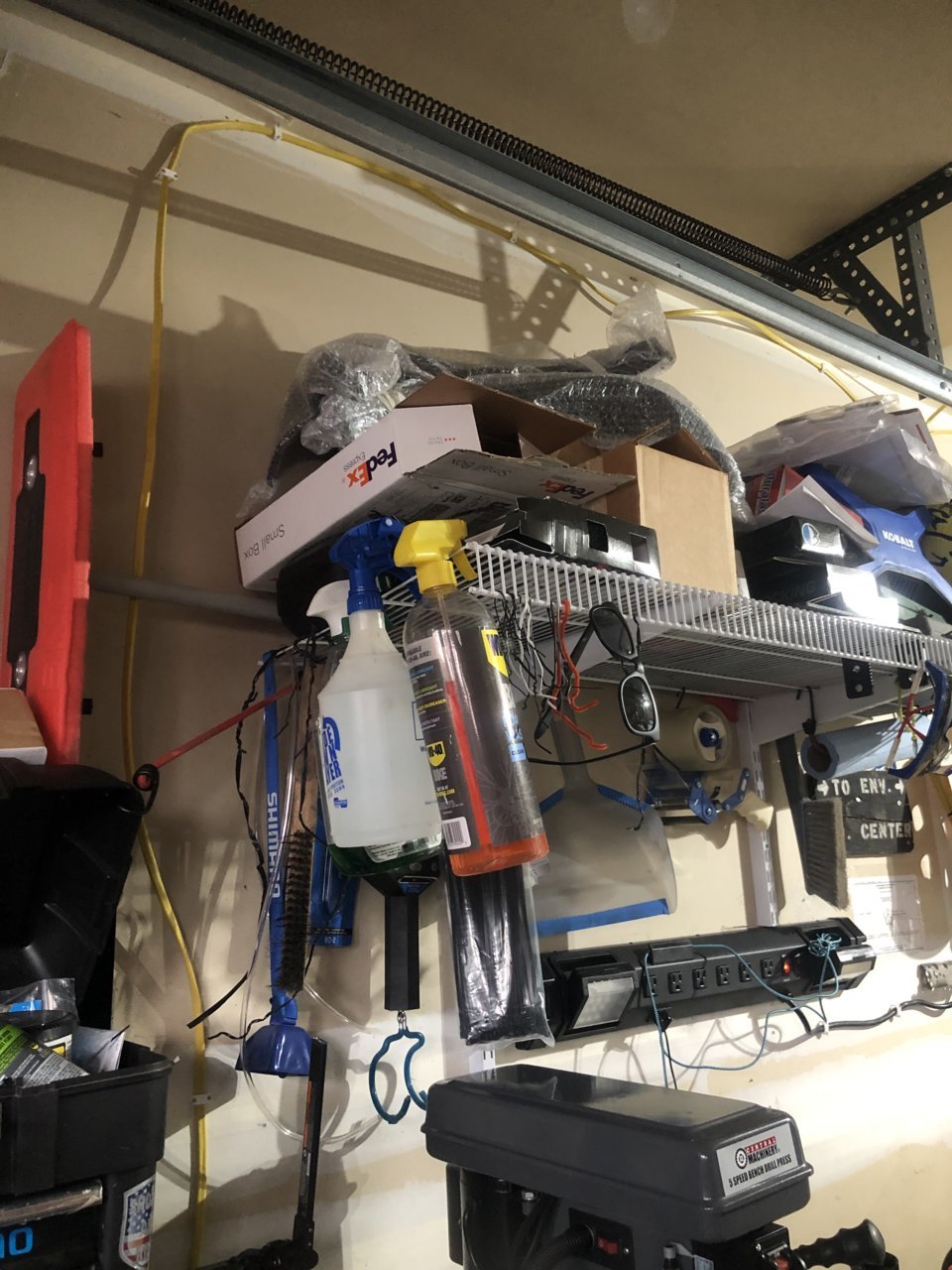

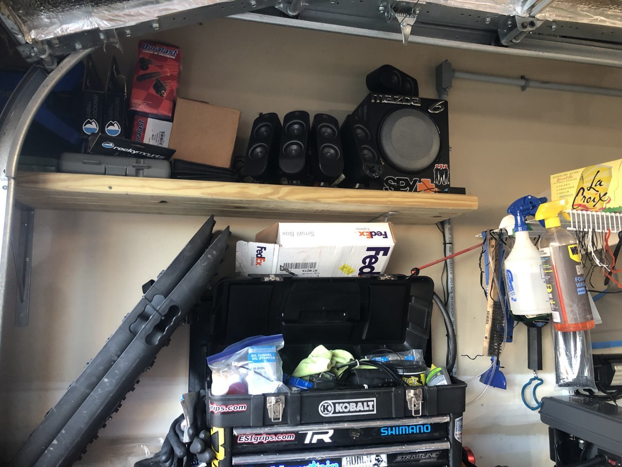

    Some day time photos! Excuse the mess, as Squareone Creations is starting to take over my garage lol
    Added another shelf for storage and speakers

    looks great! Now that I saw the top part where the routing was it was even worse than I thought, nice work on getting it up to code!
