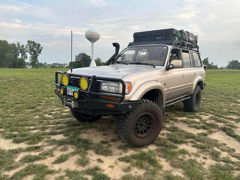

    Well here she is, all full of spare parts that are no longer needed (if all checks out on the LC)
    I’ll eventually have a FS thread of what’s leftover!
    Here’s what I’m getting in return
  3. Sep 7, 2023 at 3:33 PM

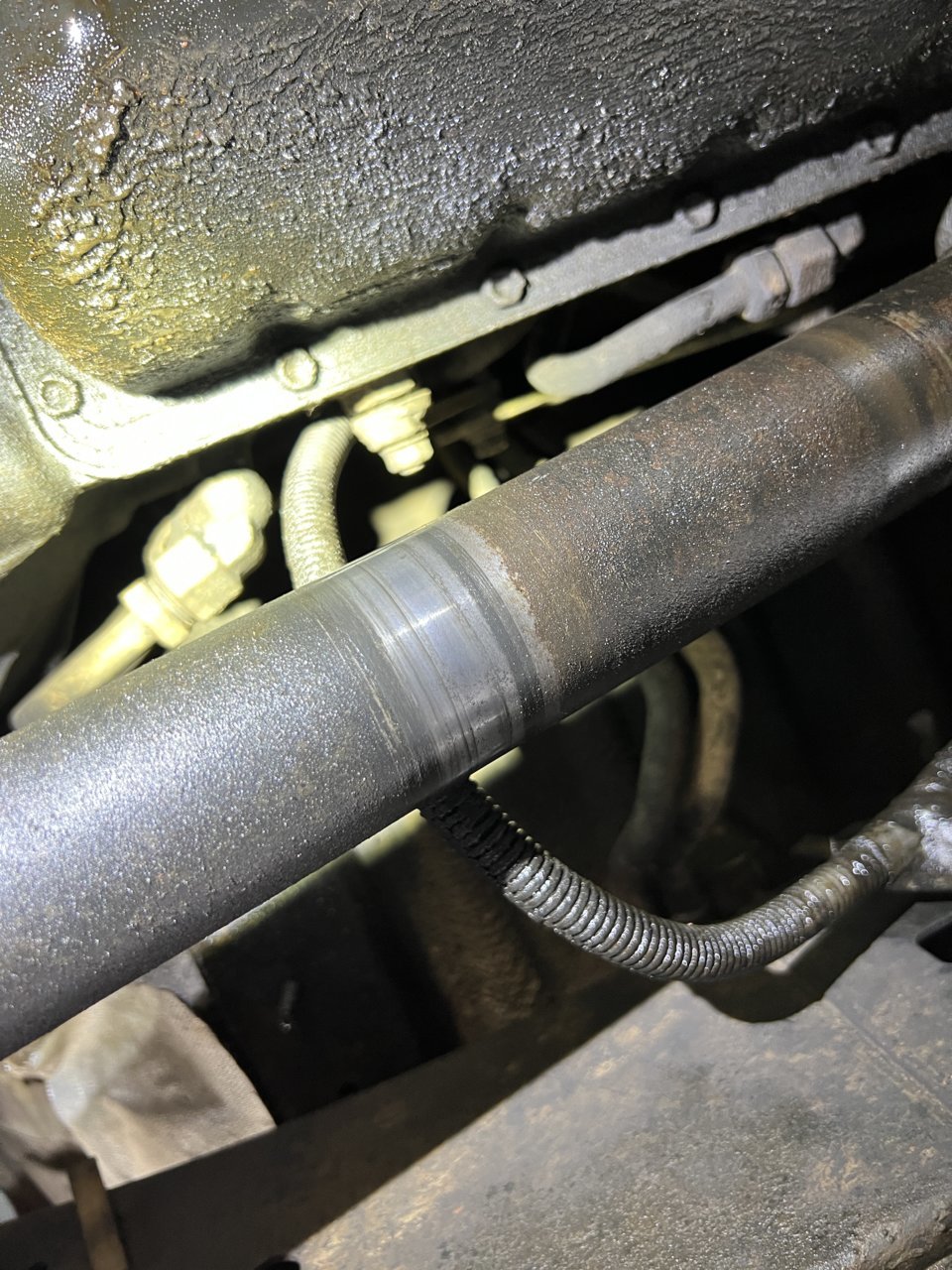

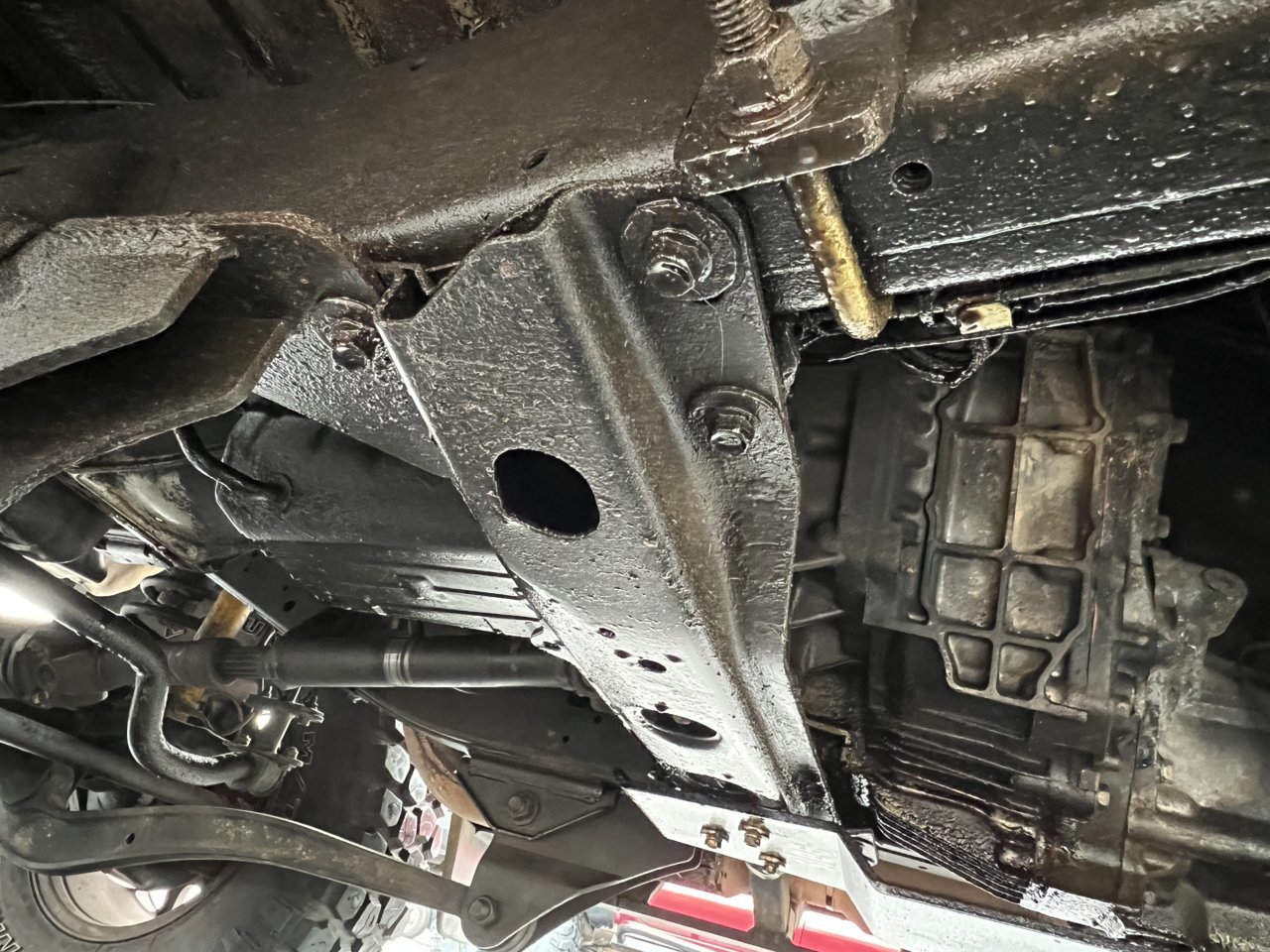

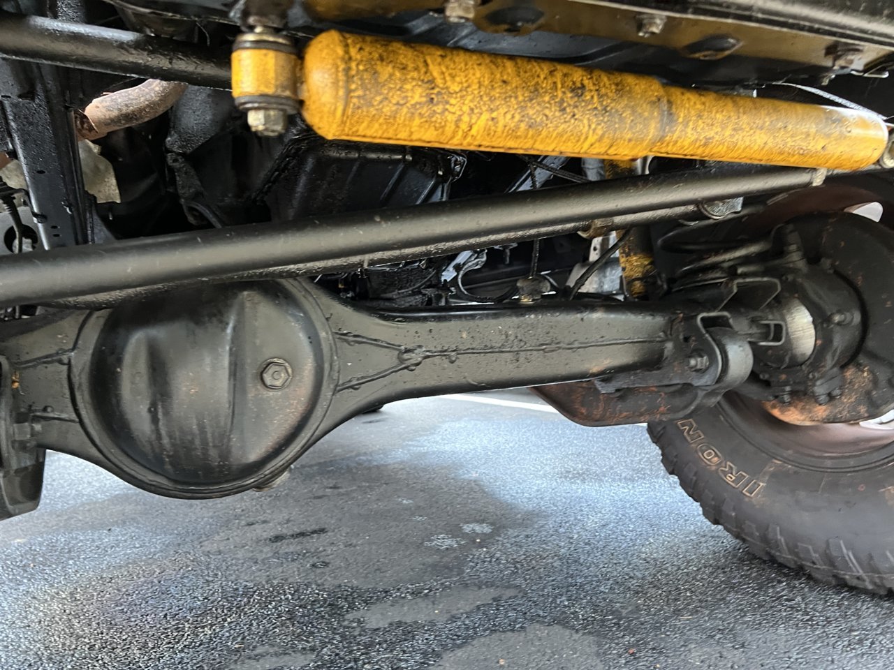

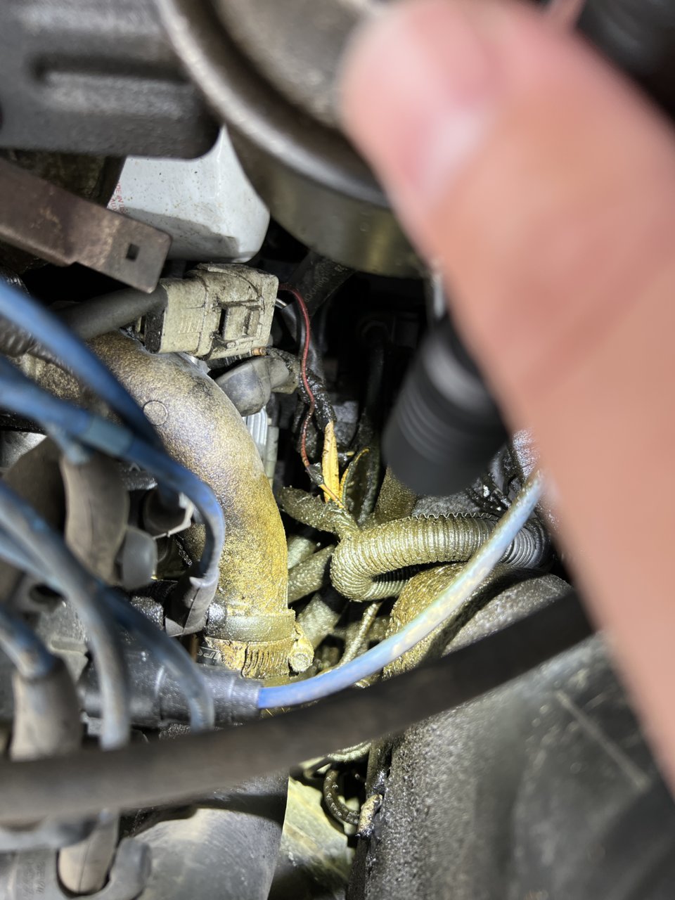

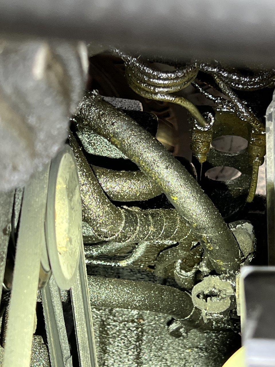

    the LX450 owner didn’t disclose how rough it was. I diagnosed:
    Oil leaks:
    Valve cover
    Oil pump
    Distributor
    Possibly front main
    Low coolant level
    I did a combustion leak test which seemed to pass
    Codes:
    P0115
    P0335
    P0340
    P0385
    P0401
    Then the known issues like the EGR and ABS
    Random cut wires
    Random cable on front driveshaft
    The owner said he did an oil change a week ago and didn’t see any oil…..
    It was sick but BEAT.
    no shots of the interior, but it was filled with crap. Like disgusting, cigarette holes, cracked dash, and the odometer was rolled back….
