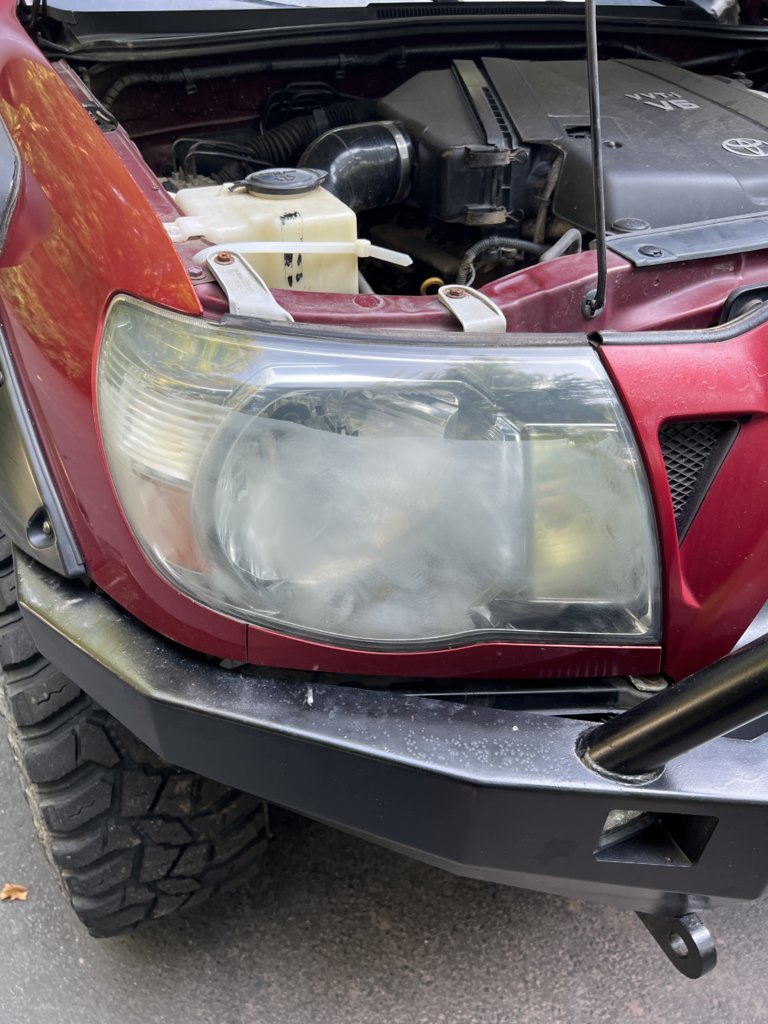

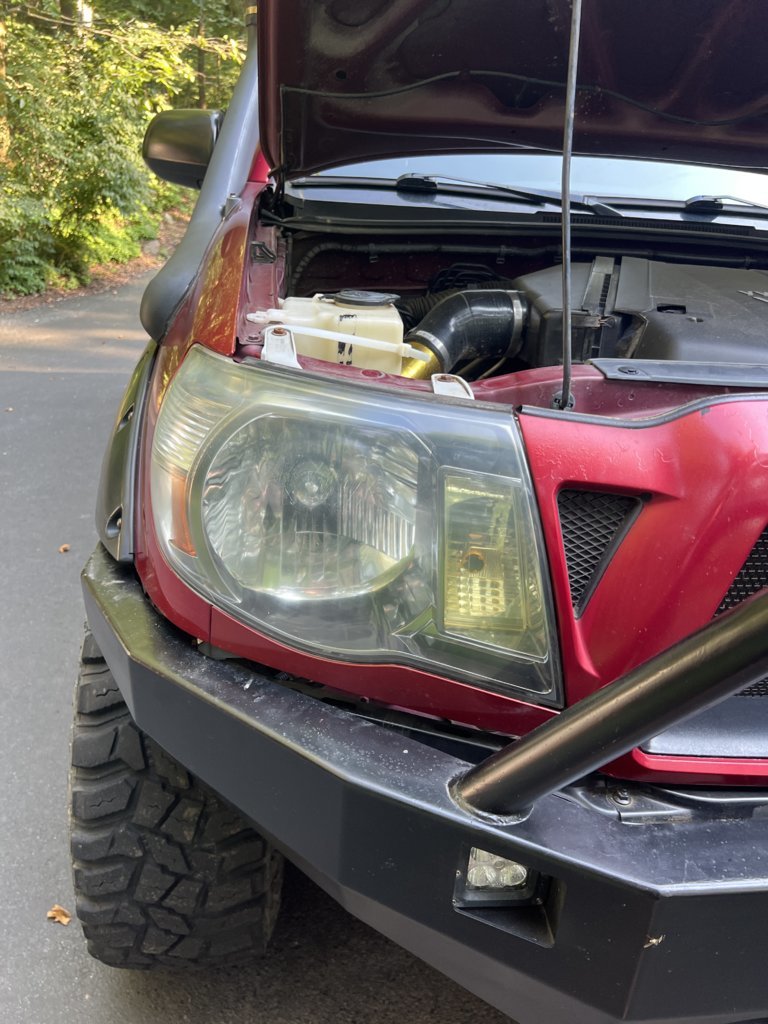

    Old free ebay headlights had such bad output I bought used OEMs locally, slapped some fresh bulbs in and am already seeing better at night.
    going to try and restore them, but if that doesn’t work I have a pair of depos as well
  4. Jul 29, 2025 at 7:44 PM
    #2504
    Nimble9
    Nimble9 [OP] visit squareonecreations.com Vendor
    Oct 20, 2015
    #167184
    11,173
    Lebanon, PA
    2006 4x4 DCSB
    enough to have fun
    Keeping with the theme of this build of used parts, I wanted OEM housing so I found these used locally for cheap, and spent 15 minutes cleaning them up.

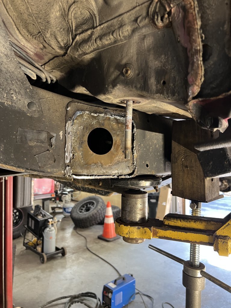

    I’ve got a set of the Warfab sleeves I’d send you for free if you pay shipping. I got them when they first came out but never got around to installing them. I’m going longtravel and don’t need them. If you would like them I’ll send them to you just pay for shipping.
  11. Aug 23, 2025 at 6:33 AM
    #2511
    Nimble9
    Oct 20, 2015
    #167184
    11,173
    Lebanon, PA
    2006 4x4 DCSB
    enough to have fun

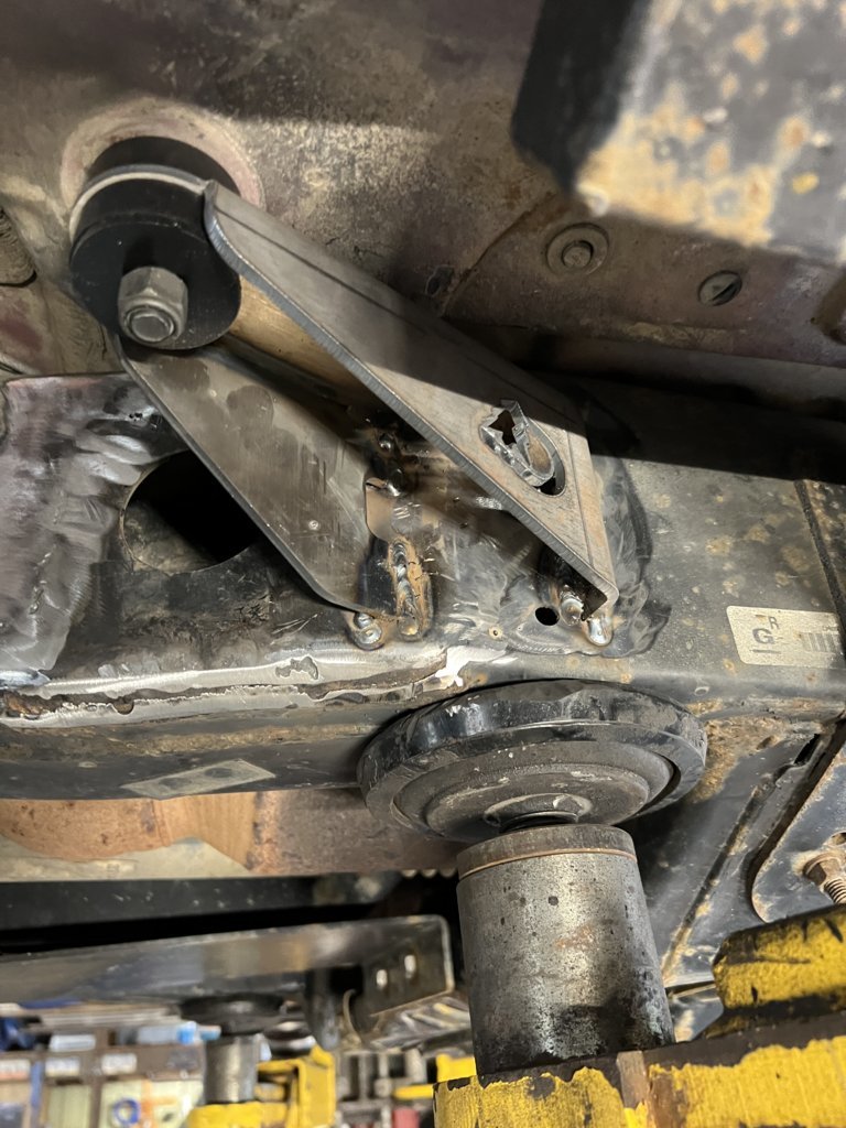

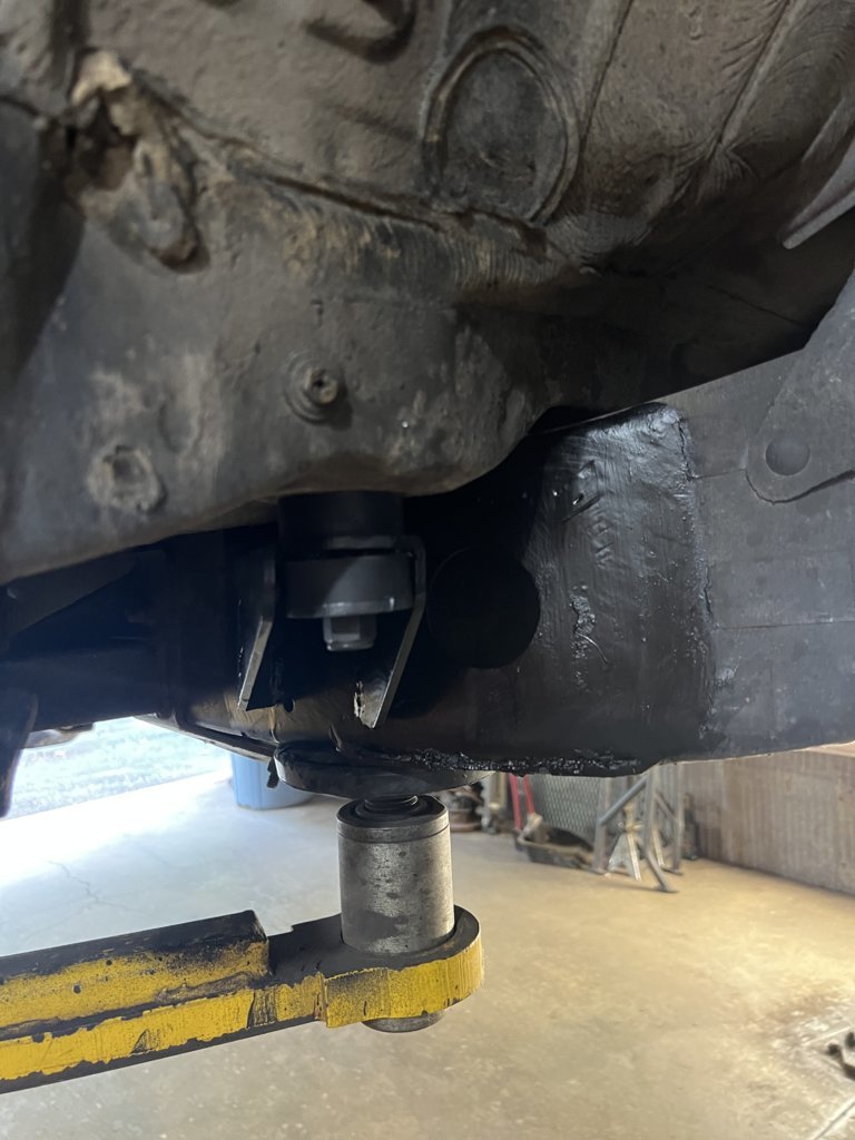

    I have some extra steel I'm going cut and scab on so the mount isn't pulling on the frame directly, plus I've had these mounts and upgraded bushings for 4 or 5 years at this point lol
    Appreciate that!
    I'll PM you
    fatfurious2[QUOTED] likes this.

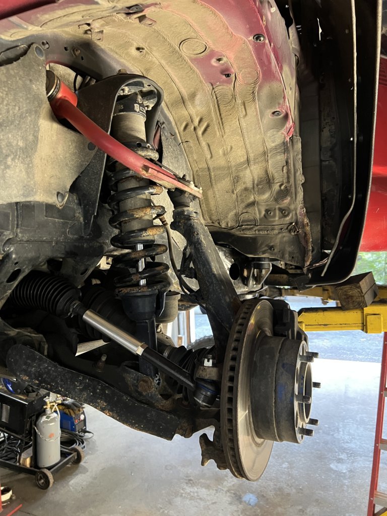

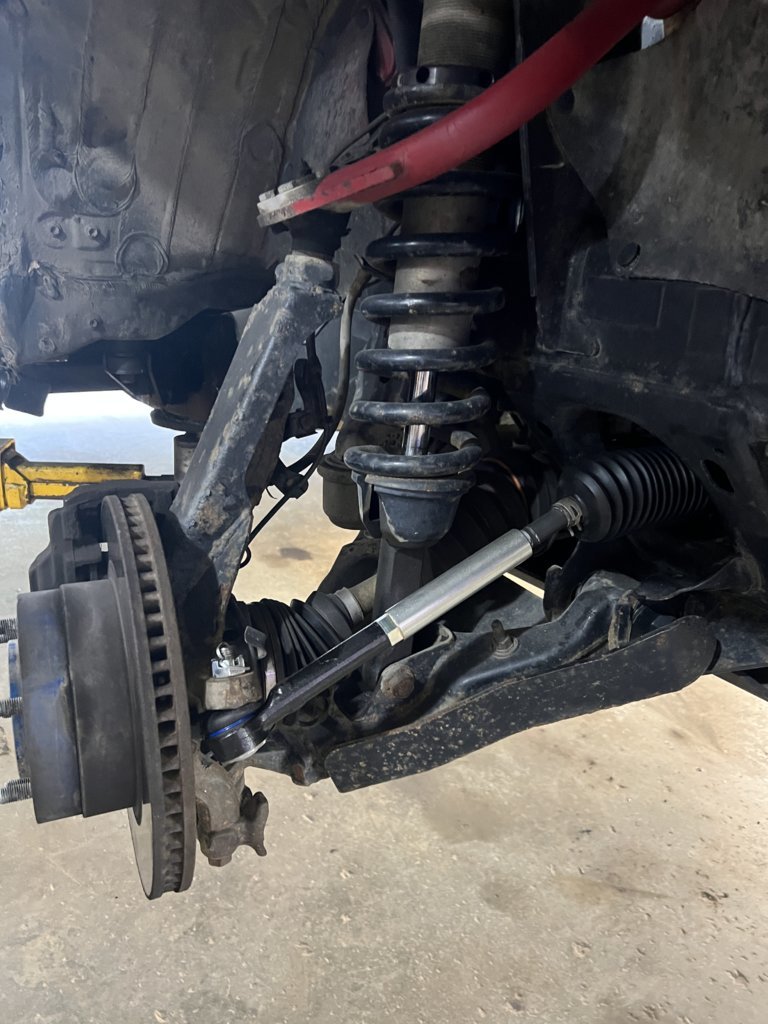

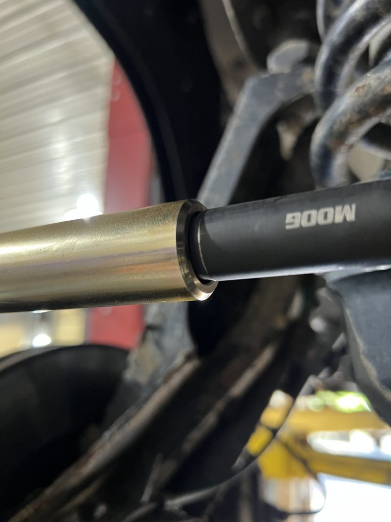

    Thank you so much @Cyberman for your time and expertise wrenching on my truck!
    While @Cyberman worked on the body mounts, I threw new inner and outer tie rods on with warfab sleeves thanks to @10tacotrooper
    Also PSA I learned that Moog tie rods won’t work with the sleeves.
    Now I rub on the wheel well! I haven’t been able to turn lock to lock in years!
