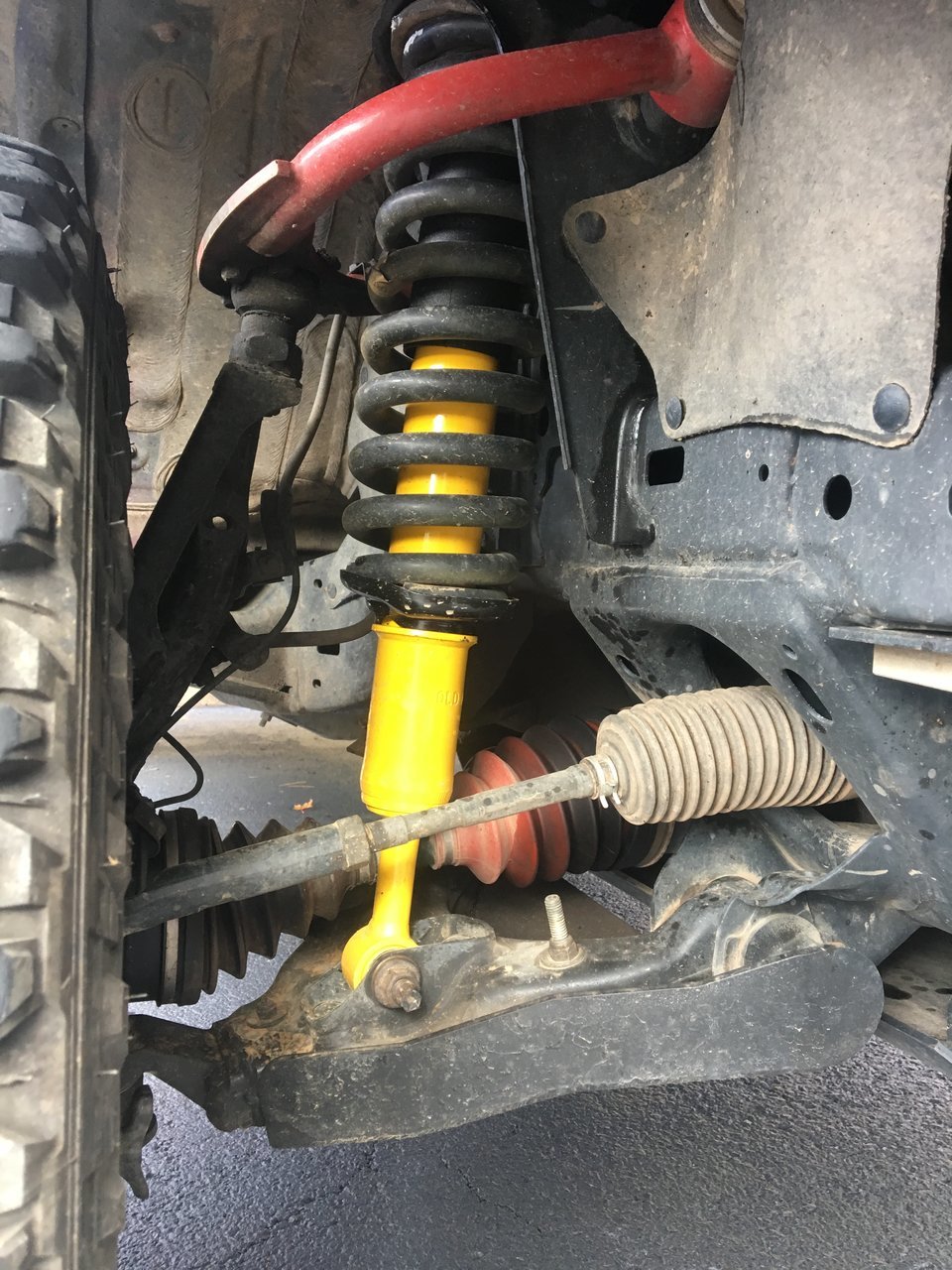

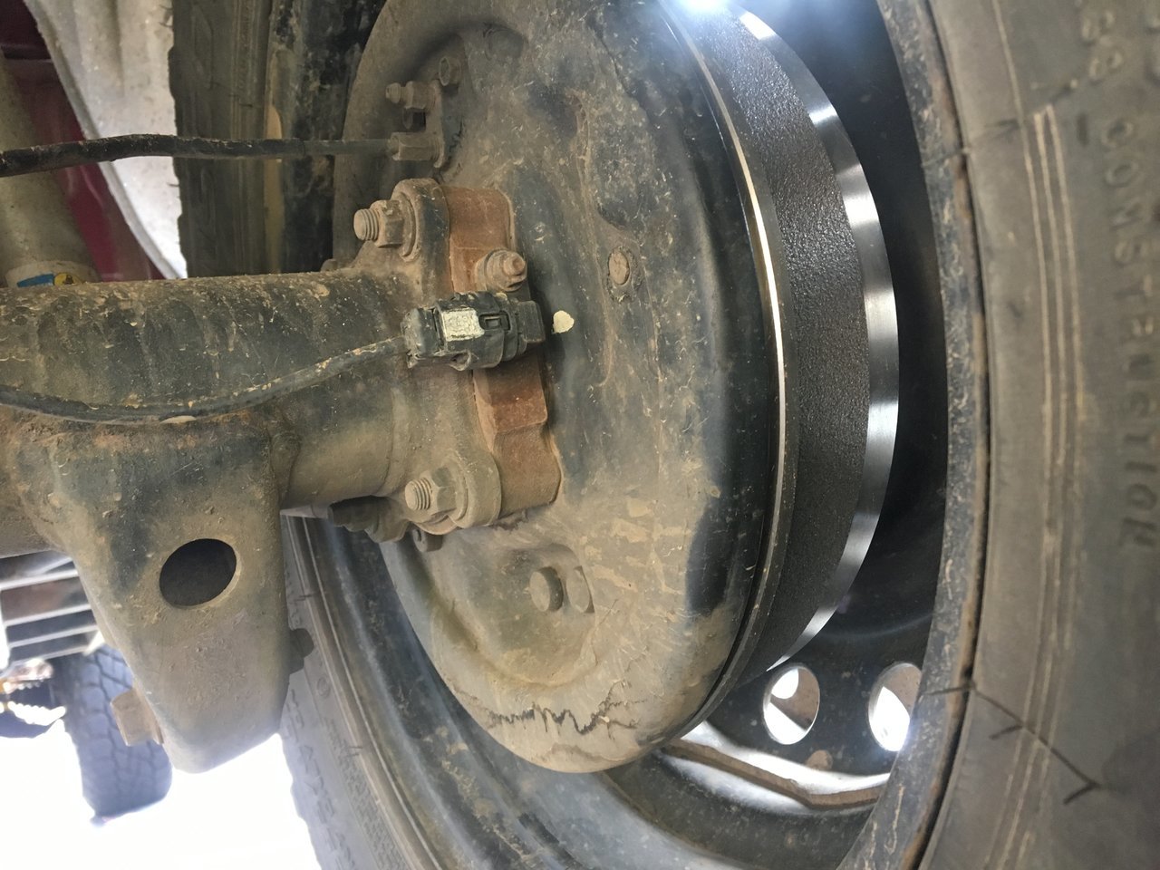

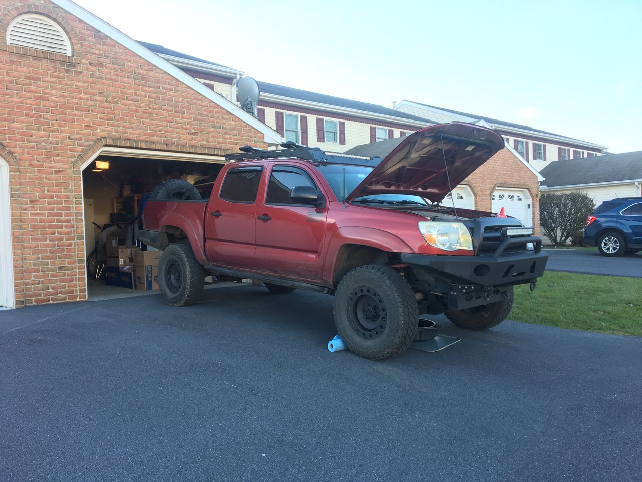

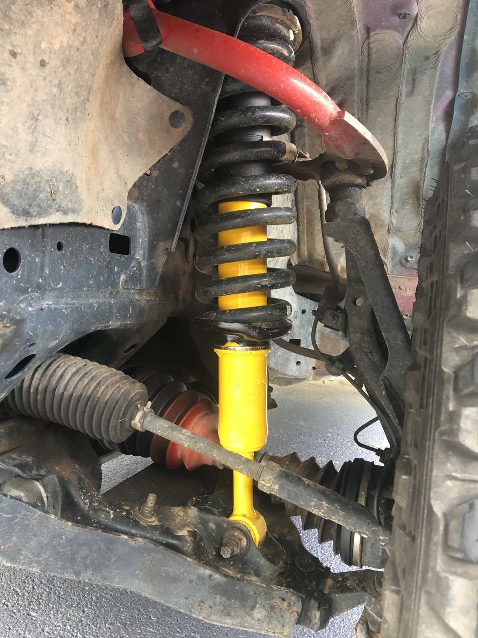

    New shocks and trim packer!
    New rear shoes and drums!
    She drives so much better. The new softer shocks are definitely softer than the old shocks.
    Thing stops on a dime now too!
    Yay for Maintenence!

    nice! I have a @nj636 wheel bearing on deck, as well as a CV seal when another WB goes out. might have a small leak or something? do you have fluid showing anywhere? My pedal was super soft when my rear shoes had no meat left haha.

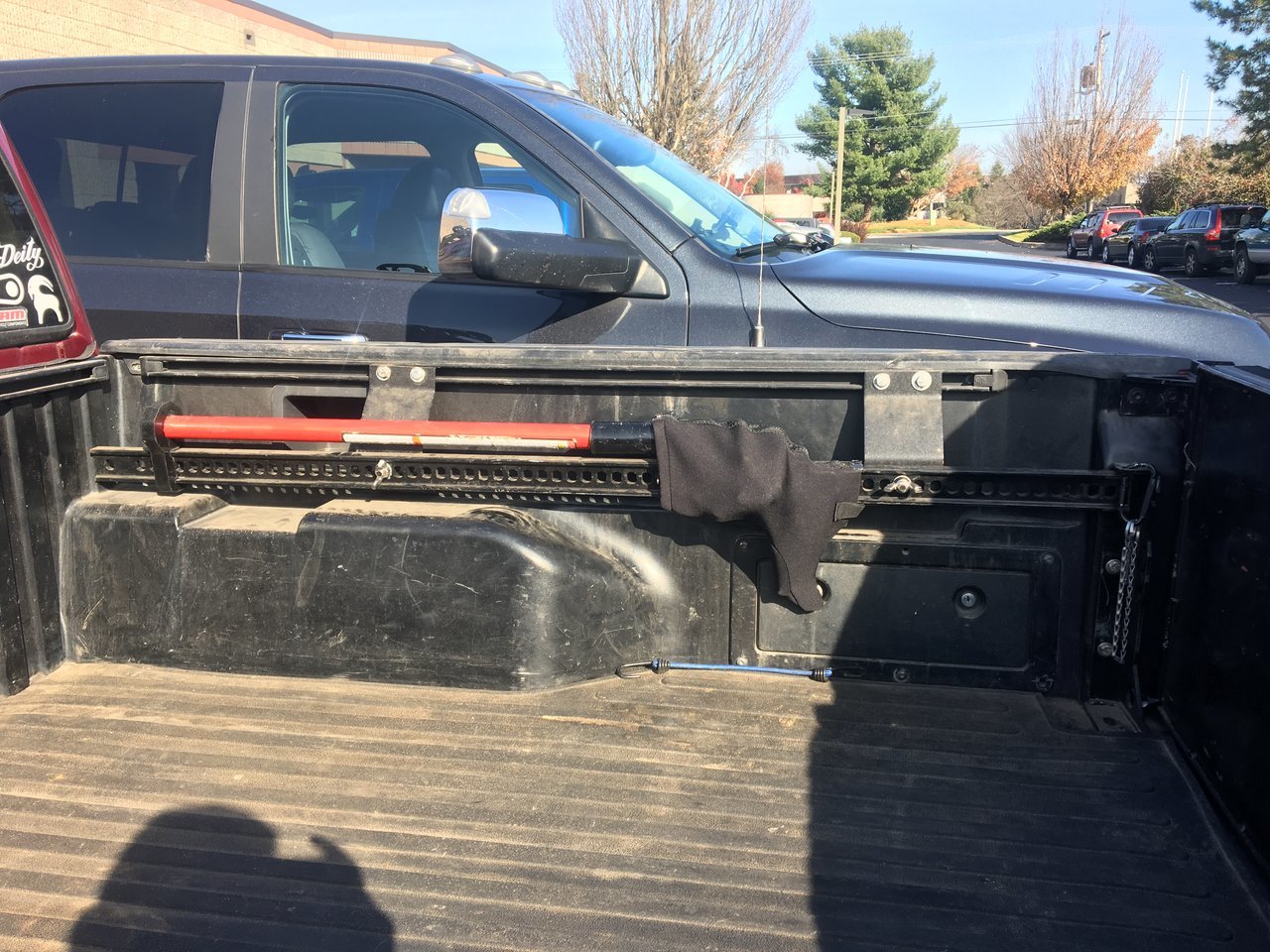

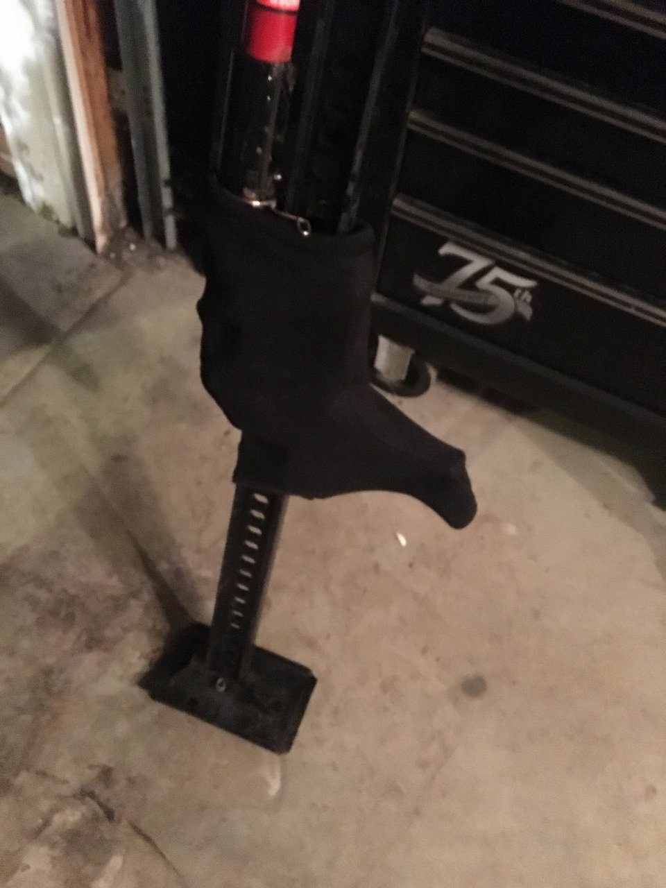

    Boot on the highlift to protect the mechanism from the elements!
    Taking the Softopper off for the winter. Last winter the vynal window split a tiny amount, so I'm not trying to do that again! Truck looks naked without the topper!

    Had to take the foot off the high lift to fit it with my bedside stiffeners, but she's all there!

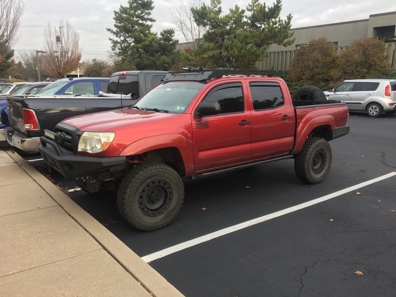

    Oil change at 198242 miles!
    New home base in the background!

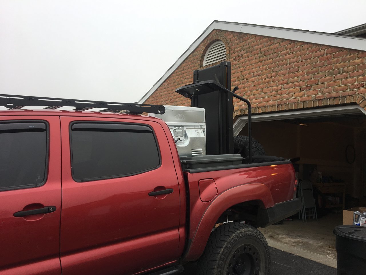

    Doing truck things!
    Loaded:
    Empty:
