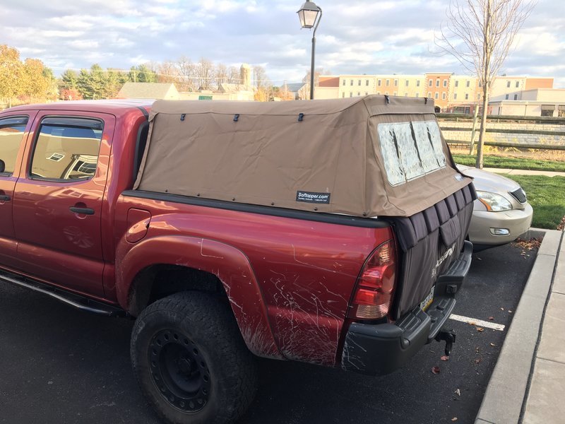

    Softopper installed! The fact that I can use it with my tailgate pad is amazing.

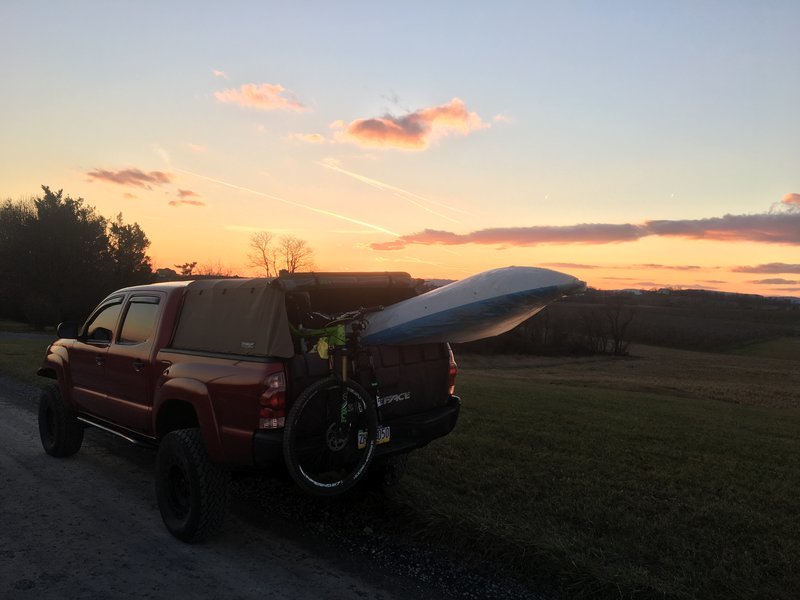

    Photo the morning after partying in the city haha

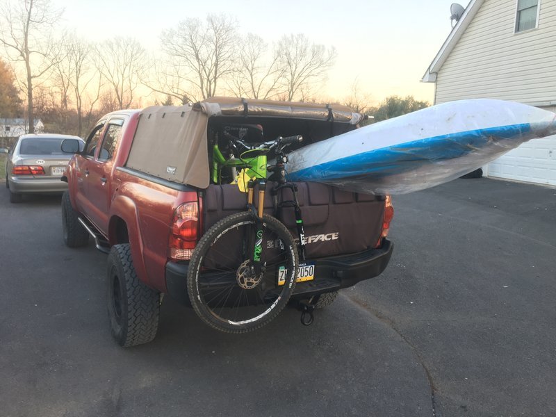

    ~450 miles driven today!
    Drove to VA and Traded my mountain bike for 2 mountain bikes, lots of parts, and a kayak! Then went to philly to pick up a plyo box for s friend.
    VA is pretty!

    It's true. I've used hockey pucks multiple times now as a base for bump stop spacers or rubber isolators. Best part is how cheap they are.
    Do they bikes fit under the soft topper with the rear wheel still on?

    They fit perfectly! You just need to put the dropper post down.
