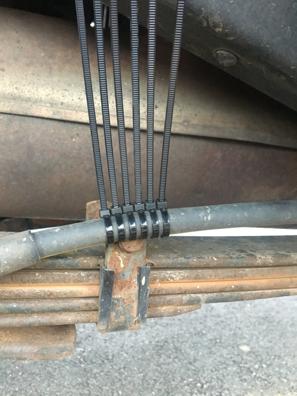

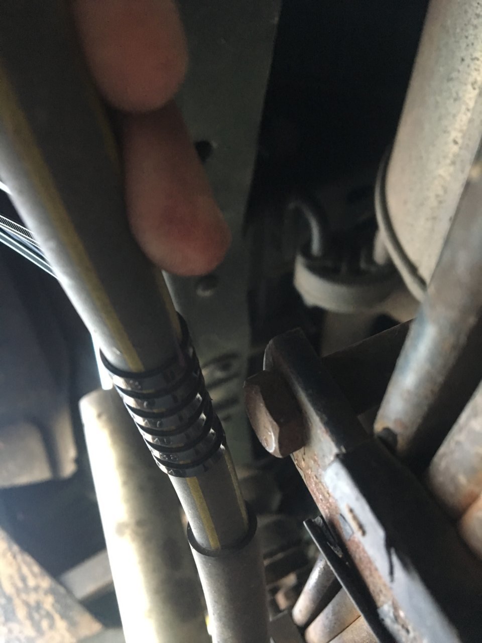

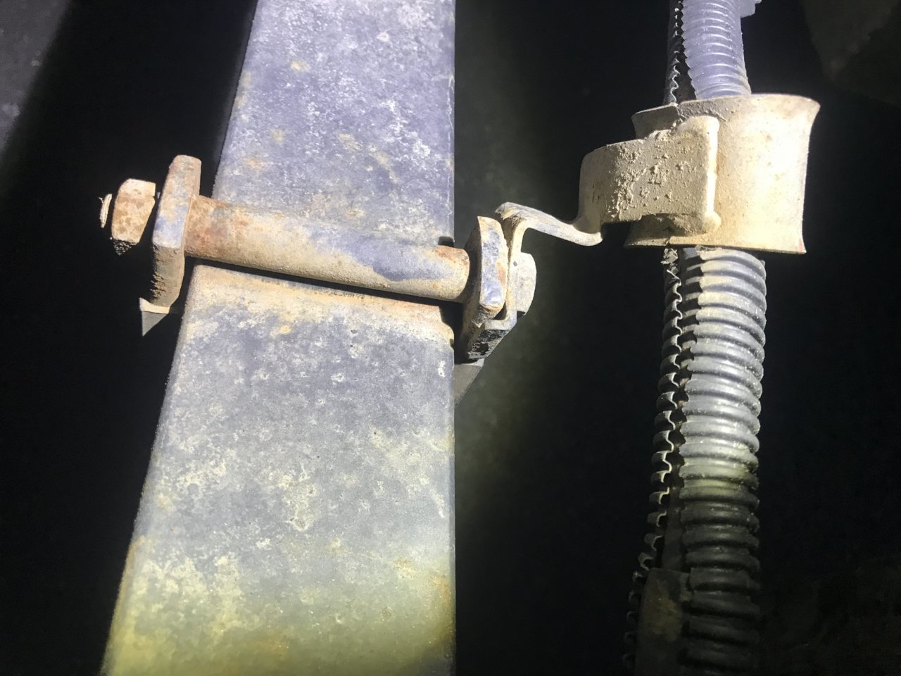

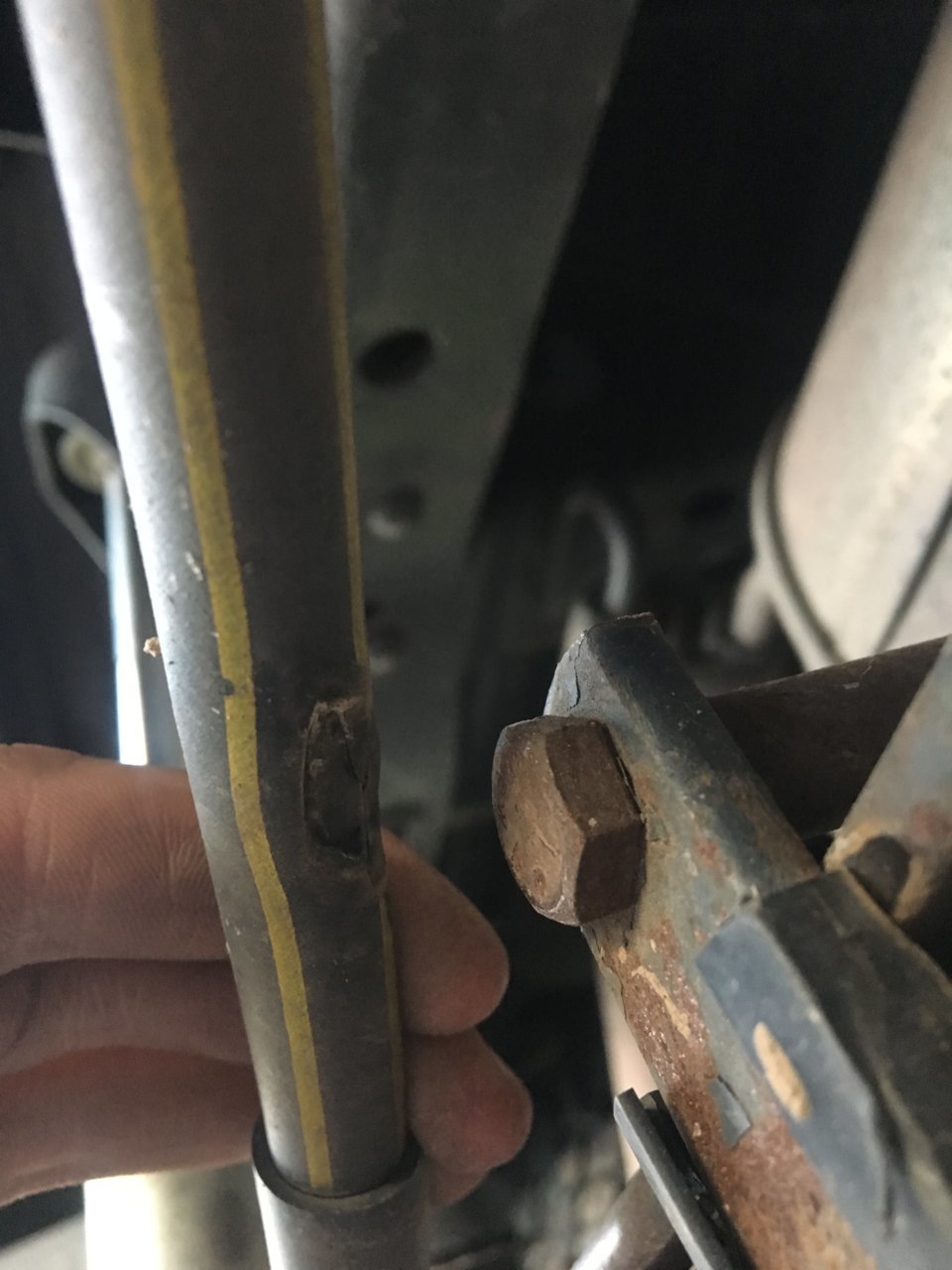

    Isn’t there supposed to be a brake cable standoff that attaches to that leaf pack bolt?
  2. May 2, 2018 at 5:12 PM
    #742
    Nimble9
    Nimble9 [OP] visit squareonecreations.com Vendor
    Oct 20, 2015
    #167184
    11,173
    Lebanon, PA
    2006 4x4 DCSB
    enough to have fun
    No idea lol mine does not have that on either side

    Maybe pull on a split piece of garden hose (or similar) and then zip tie the garden hose to the brake cable casing.

    OEM Stand-off plus a piece of split loom protecting the cable. Don’t remember why I did the split loom, but I did it 2 years ago. Maybe rubbing somewhere?

    That's a great idea! I was trying to rotate my tires after a run and the zip ties were the quickest solution I could come up with lol

    Works pretty good although it smacks the shit out of things when Im rolling around with it on. I need to make another hole in my bracket to handle the swing of that thing more. No regrets though.

    That zip game!

    it's a glimmer of my OCD lol
    And actually I gotta file my cutters. they didnt' cut evenly which killed me lol

    Stolen from @inesshell 's build thread to reference for the future!

    The new frame didn't have it installed?

    hmm I don't think so, i'll have to look i don't remember noticing them lol

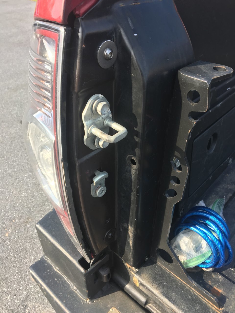

    @mojo came in clutch! Thanks again dude!
    Solved the rattle problem with some mastic tape (which I use to quiet chainslap)
    Tailgate is back on!

    I think the boneheads at Toyota just didn't re-attach the parking brake cable stand-off when they replaced your frame.
