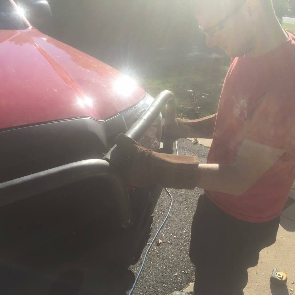

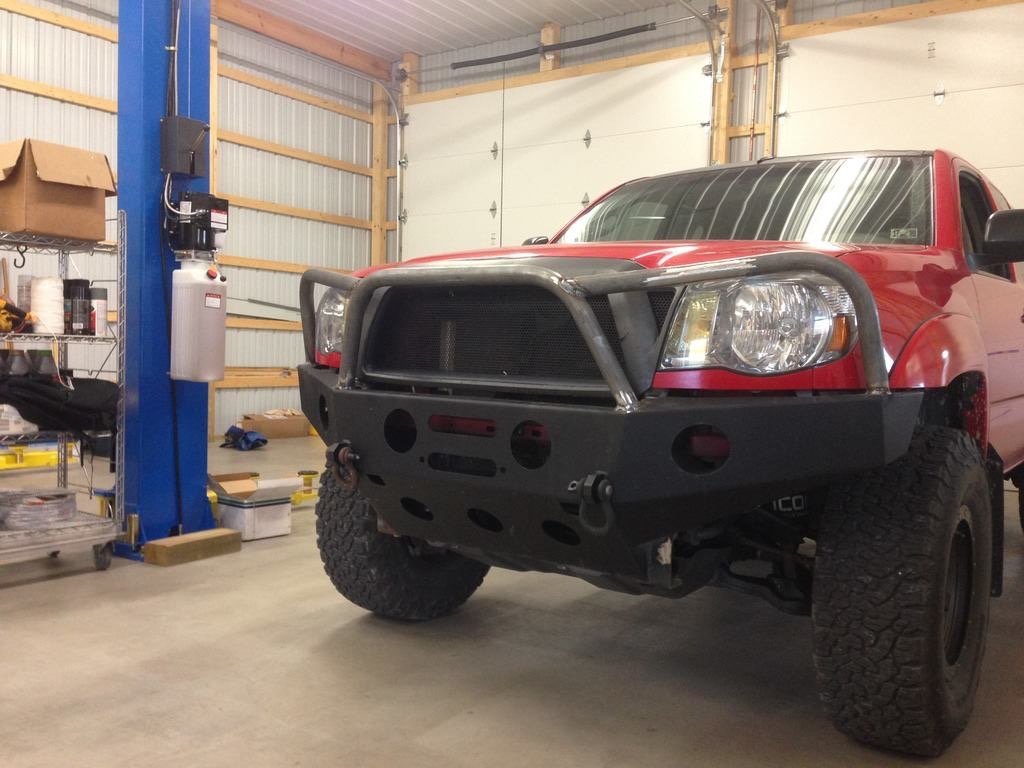

    I know lol but luckily it’s only touching the flares! I’m talking to @Mobtown Offroad on next steps lol

    were the mounting holes elongated? aka you can adjust the bumper up or down?

    What's do the hoops hit, the headlights?

    I got u, yeah I would just cut them off and start fresh. I remember many moons ago I added a set to a guys truck on TW. only takes a couple hours.

    I would think they'd be the same. When converting from the 05-11 to the 12-15 front end, you don't need to change the fenders. Take that FWIW.

    The problem is I have washers behind the bumper to push it forward, to move the hoops forward and away from the fenders.
    That’s what I was thinking!

    The ends of the bumper would look better with the flares if I didn’t space it out! Just gotta get the hoops fixed!

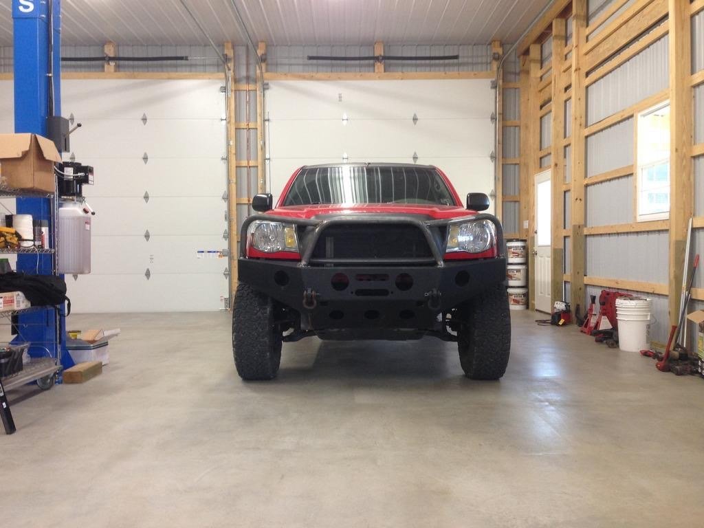

    Well I buggered this up! I need those @Skell Kore offroad plates and hardware ASAP

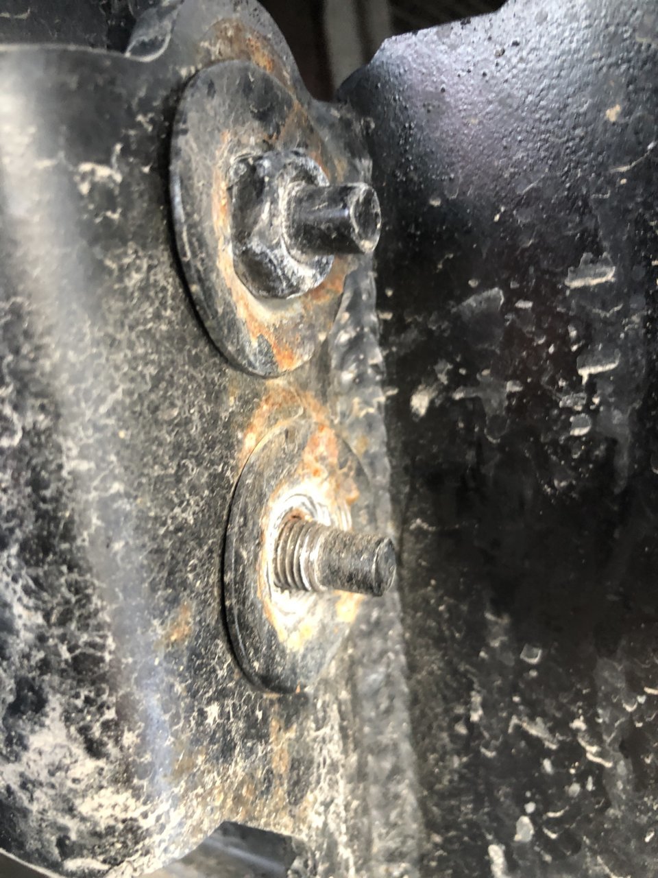

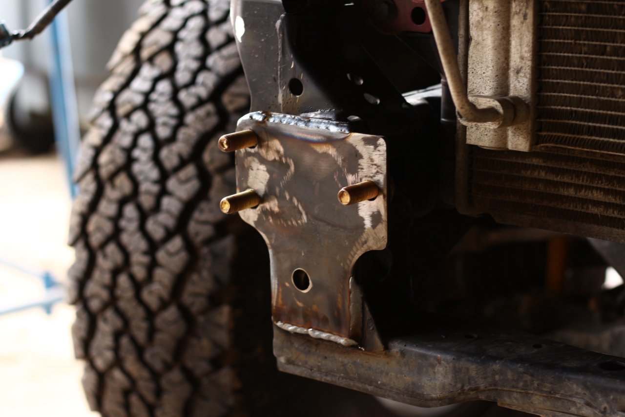

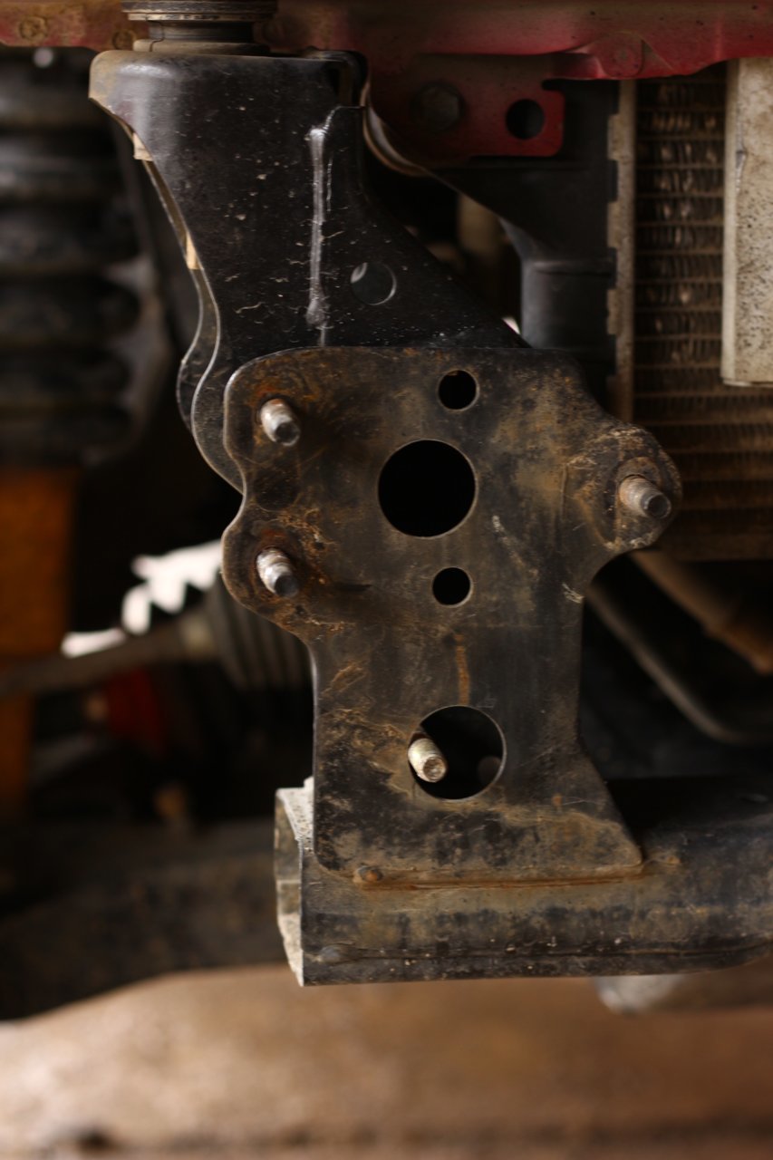

    Rad day at @Skell (Kore-Offroad)!

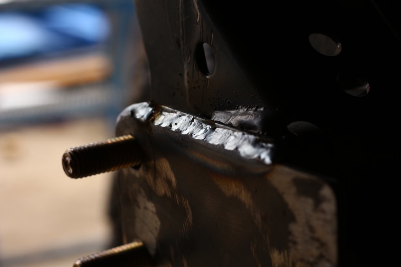

    Bumper plates reinforced, which means no more spacers to clear the bumper and a much stronger mounting point.
    Before:
    After:

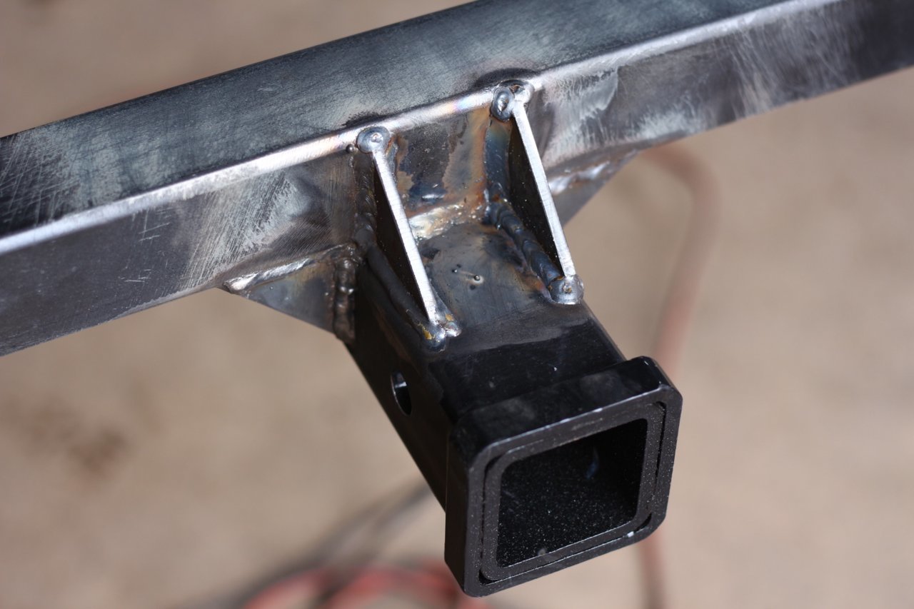

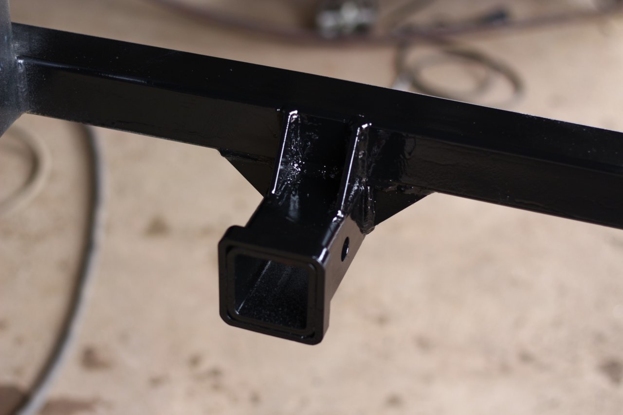

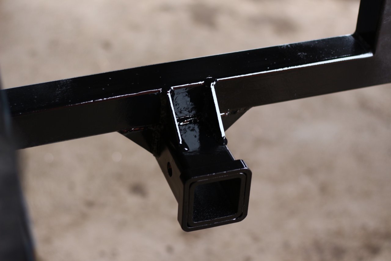

    Part 2 is something I’ve wanted for years! A hitch mounted on the swingout!
    @Subway4X4 check it out!

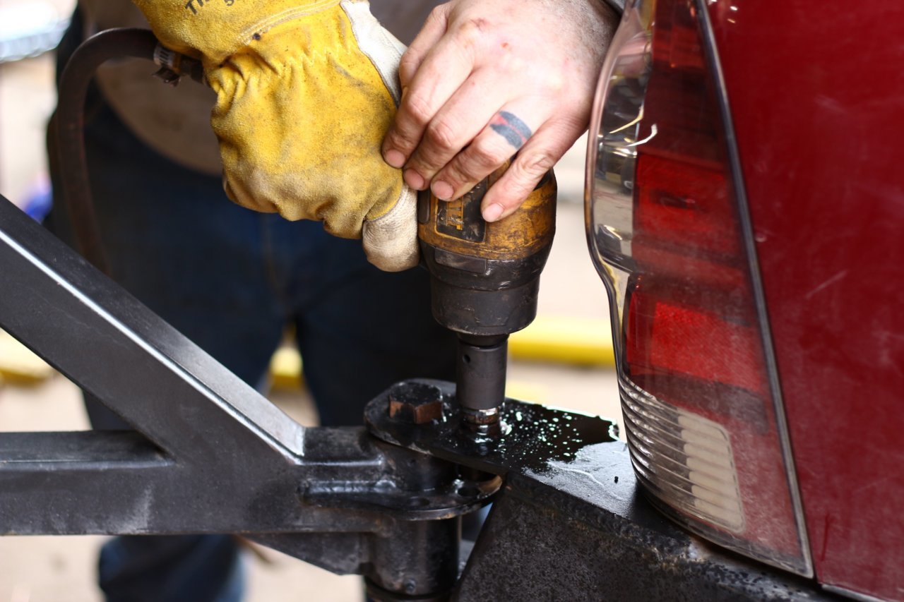

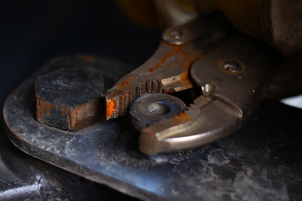

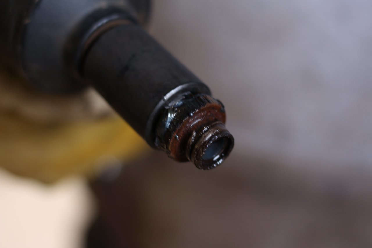

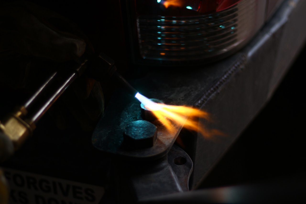

    Part 3 is the saga of the T handle body. It’s supposed to be unscrewed, however it liked its home and wasn’t leaving without a fight!
    Vice grip? Nope
    Torch and vice grip? Sorta
    Chisel and mini sledge? No.
    Nut welded to it, then impact?
    Yup!
    Success! Threads are messed up but hopefully I can put another one in there!
