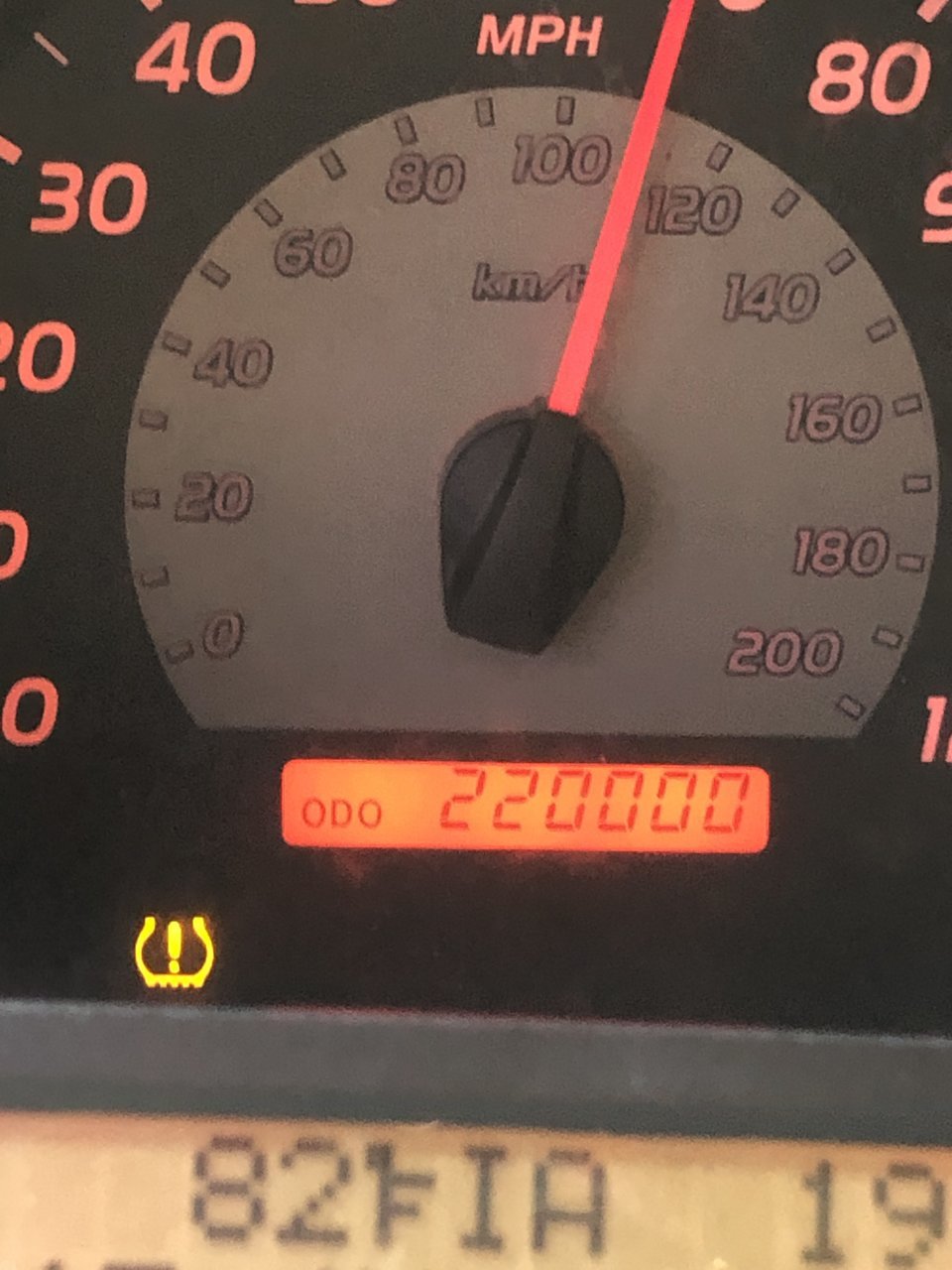

    Forgot to mention, Hit 220k on our way back from Assateague Island!
    Also, Kaila took this photo for me while I was driving, so don't panic.

    :goingcrazy::goingcrazy::goingcrazy: Your tire pressure is low

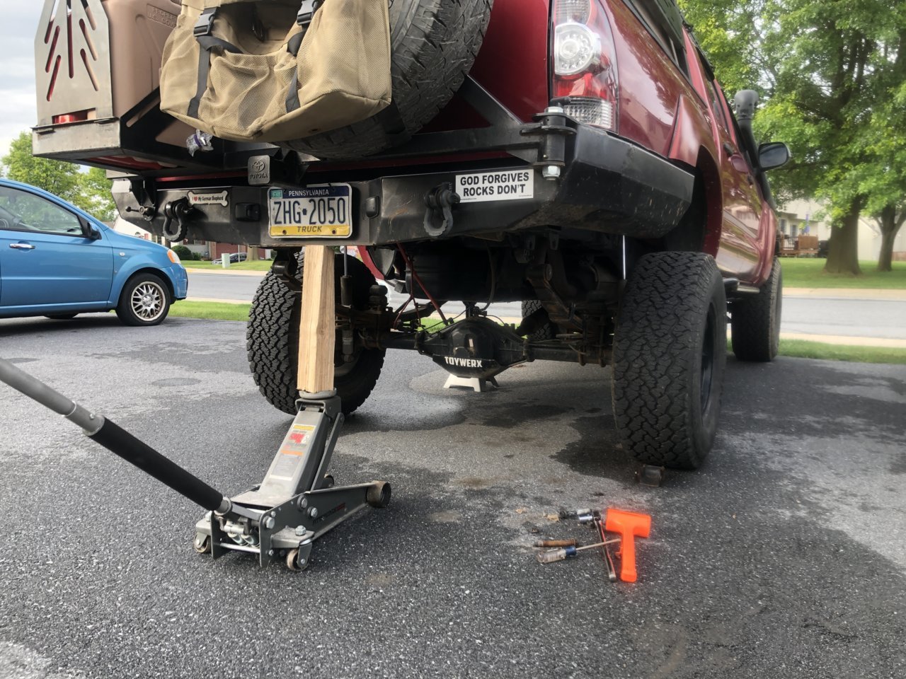

    So, this weeks mini project started innocently enough, and has snowballed in the amount of work to complete quite quickly (@geekhouse23 can confirm).

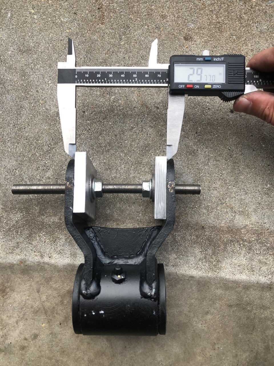

    Beefy Shackles vs Stock:

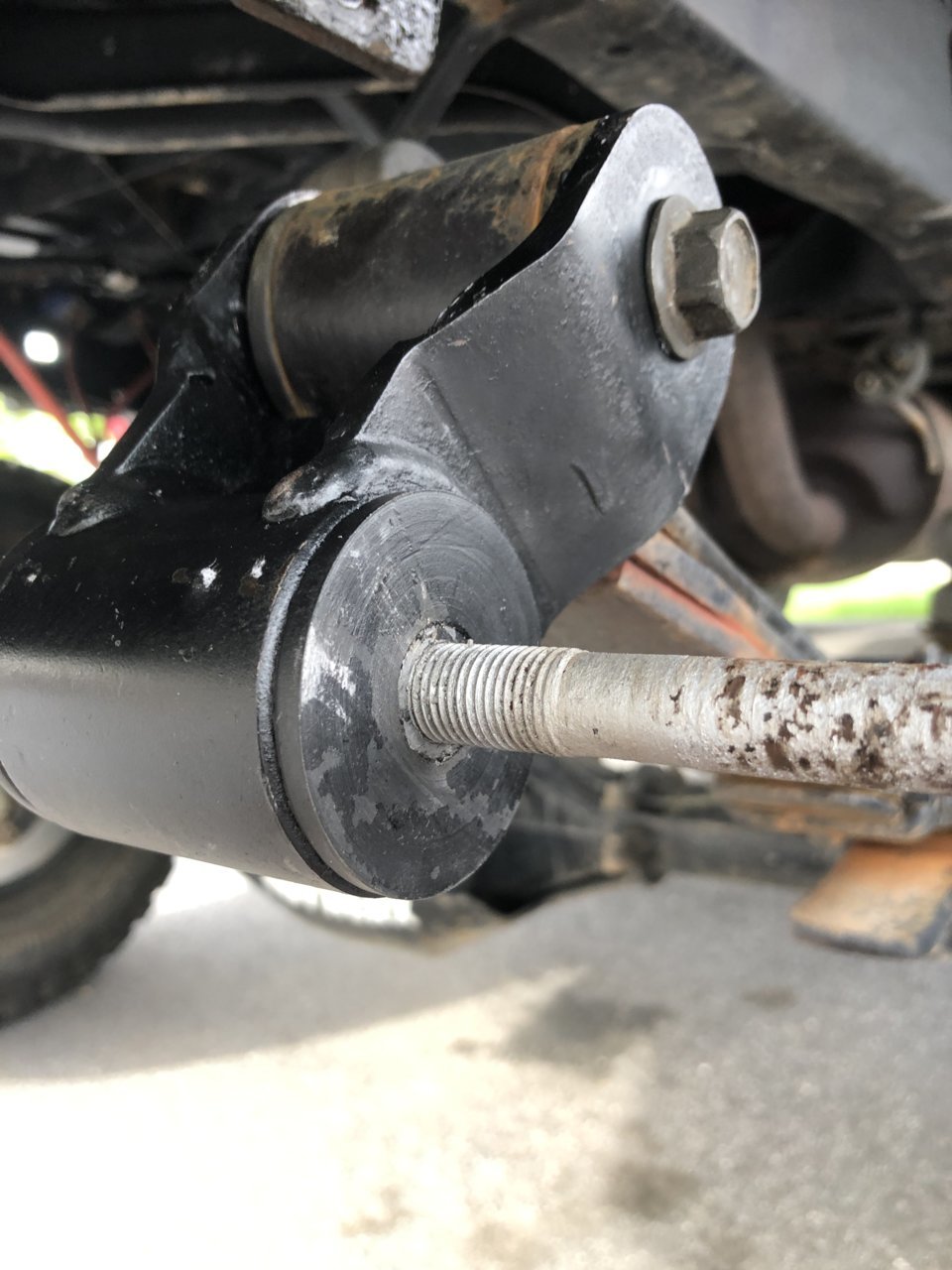

    I wanted to install some used 4X HD shackles this past Monday, so after a quick coat of paint, I threw the truck on jack stands, and unweighted the springs the same way @MY50cal and I did a while ago:
    (This is sketchy and I wouldn't recommend it, but I was trying to beat a storm approaching. Besides, Safety third, right?)

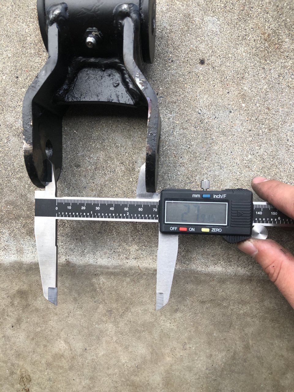

    Then, I was hit with my first obstacle, which was that the shackle does slide over the bushing sleeve.
    The ears were bent, so while walking my dog I thought of a way to straighten them back out, using what I had in my small garage.
    I remembered I'd machined some aluminum and took scrap stainless threaded rod to make a PFBB press, and if I flipped the plates I could use them for the shackles!
    This worked brilliantly!
    Before:

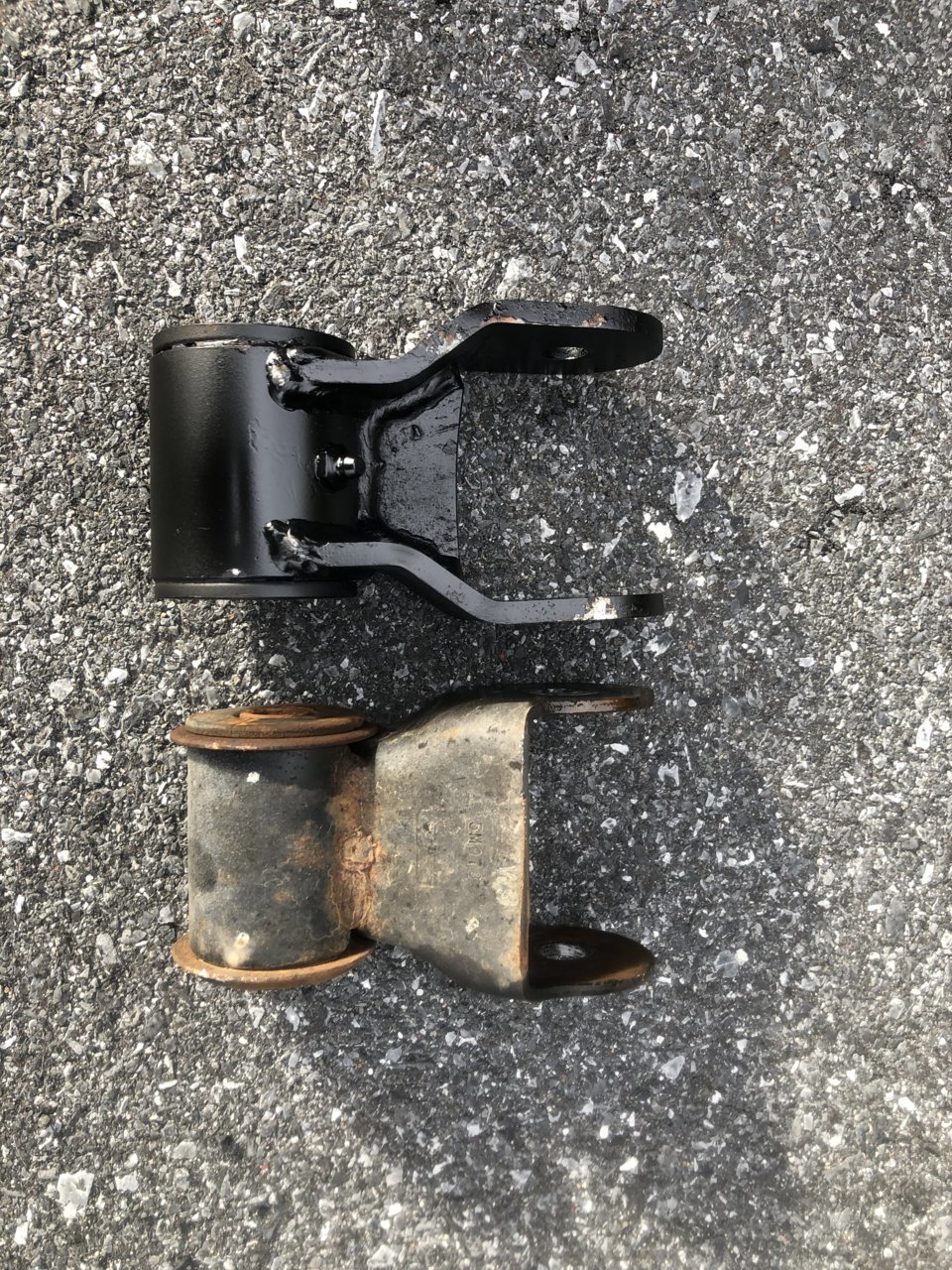

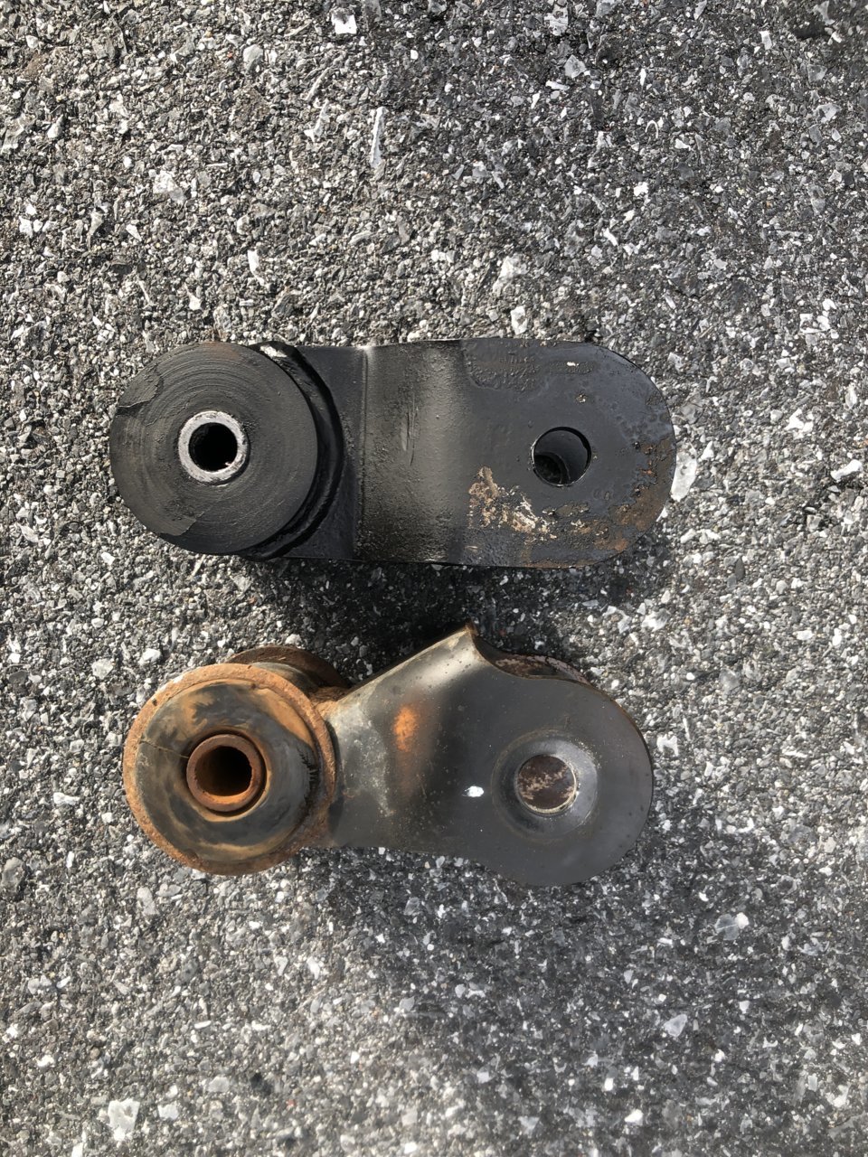

    So yesterday (Tuesday), I throw the truck back up on jackstands, go to slide the shackle over the rear leaf spring bushing sleeve and it fits!
    Next I go to put the bolt through the bushing that came with the shackle annnnnnnnd it doesn't fit.
    Observant readers will notice in the second photo that the bushing sleeves are clearly different IDs, and I measured to verify. The ID of the HD shackle bushing is around .49", where the bolt OD was something like .55"

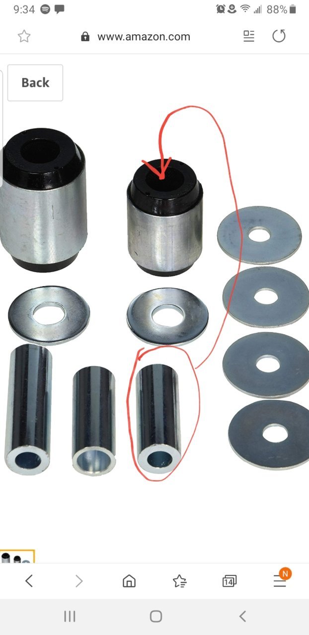

    I could always take the sleeve to my shop and have the ID machined out, but i'd prefer to just get new bushings anyways that has a sleeve that will fit. For now, this 20 minute project which turned into a murphy's law 101 course is on a break, until Adam from 4X gets back to me about bushings. If I don't hear anything back, I'll just measure and verify that these will fit.
