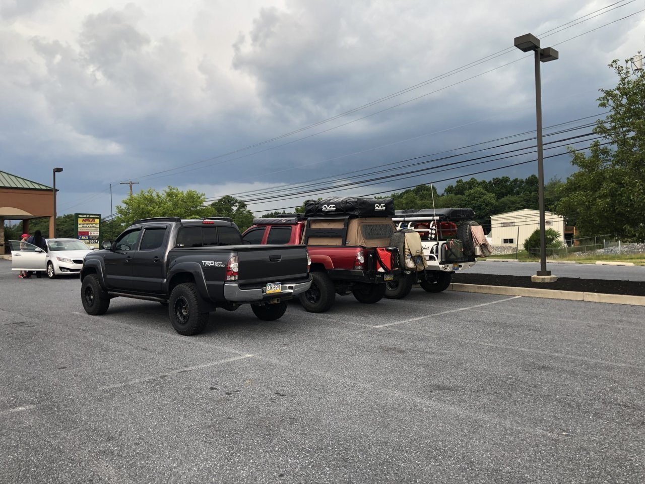

    I’ll have to go through the photos I took! It was rad to meet up!!

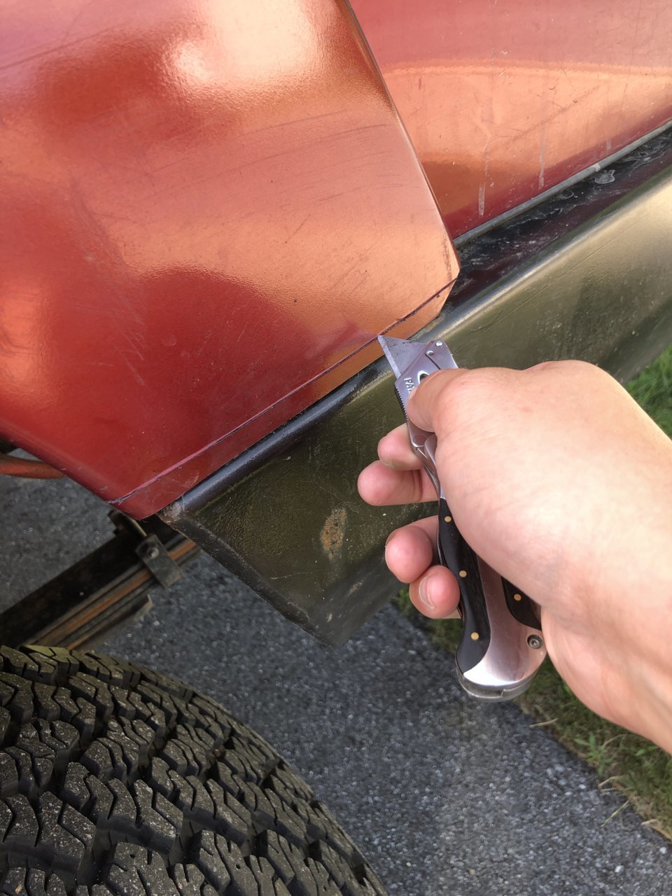

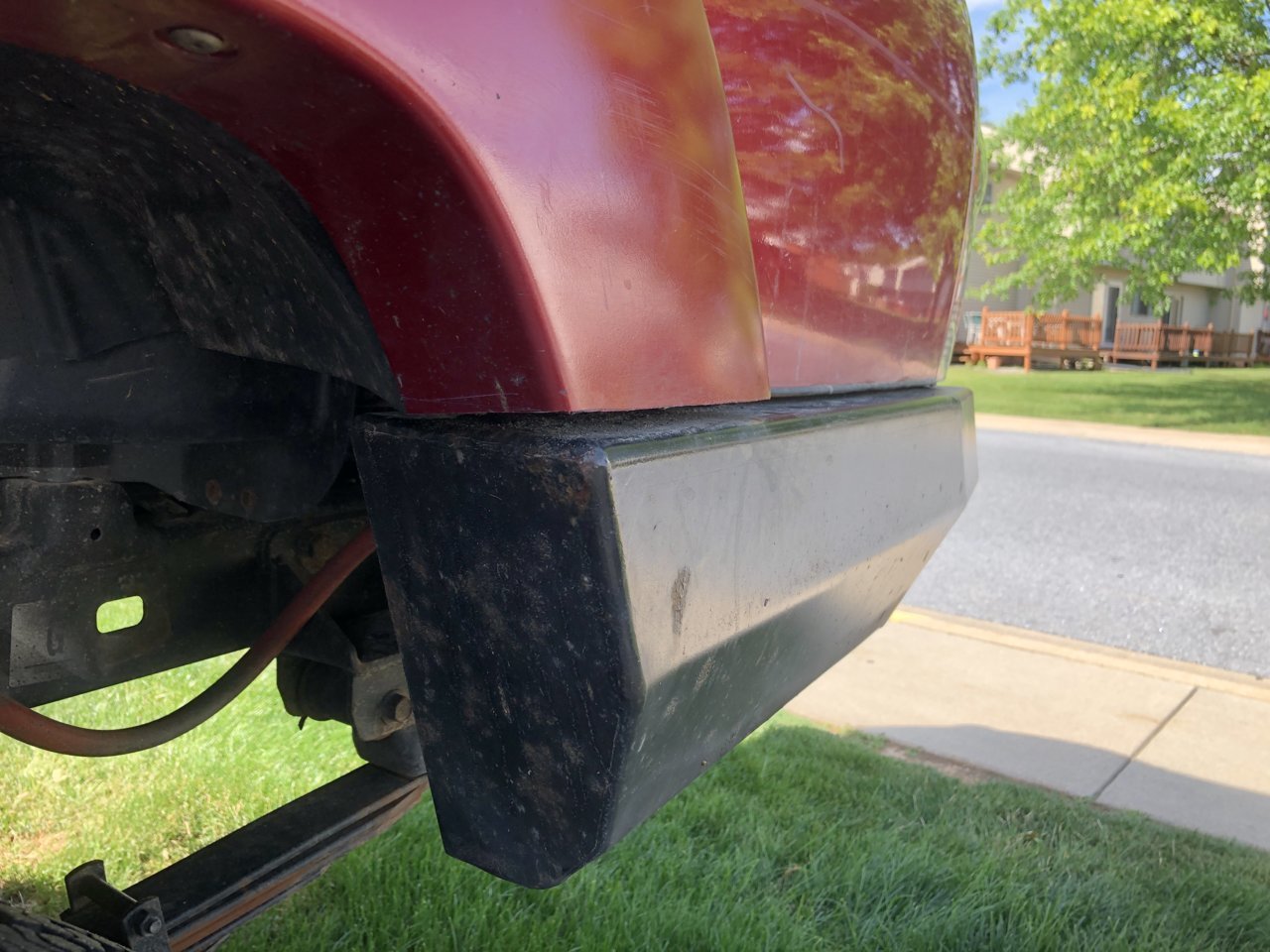

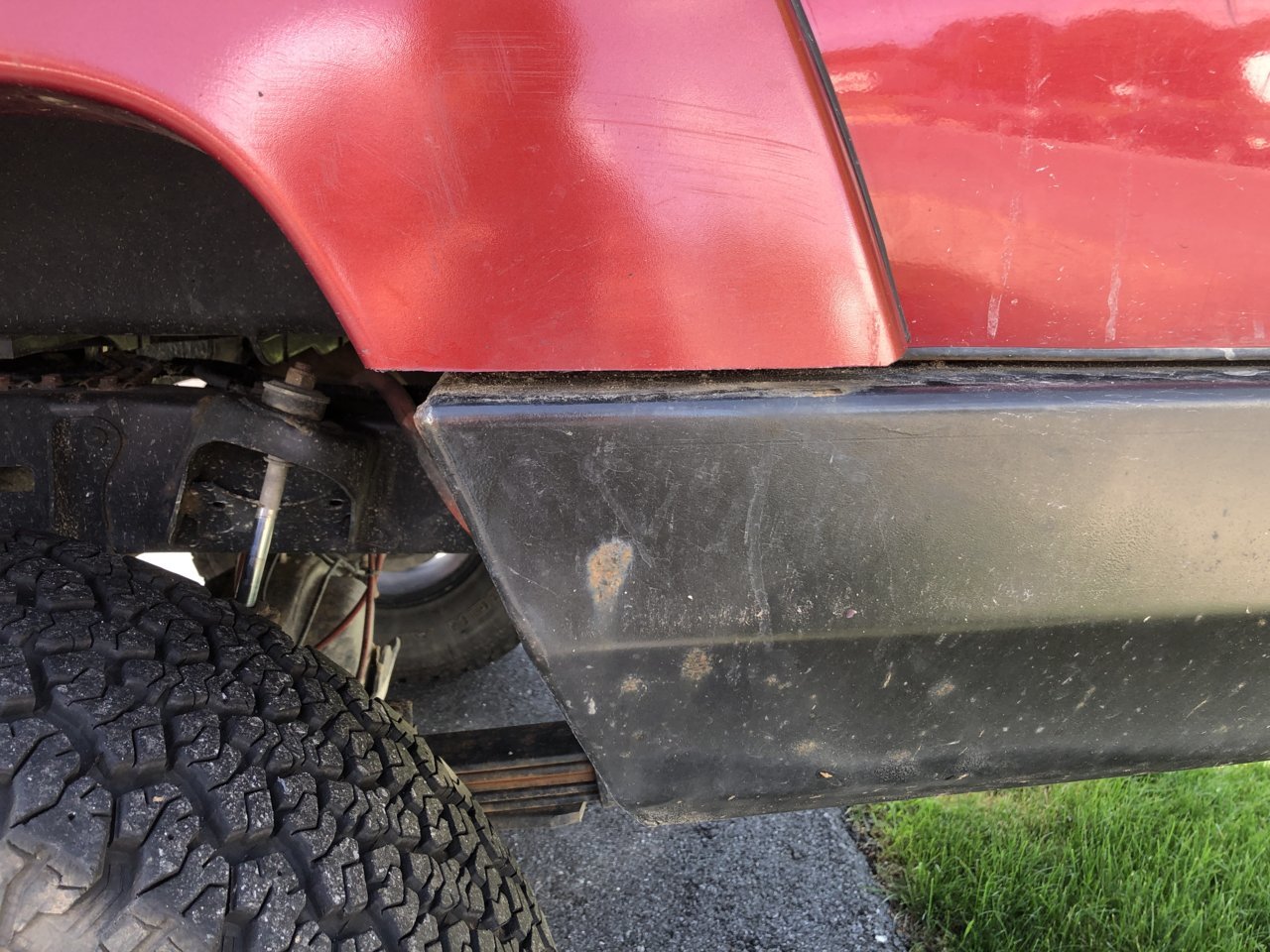

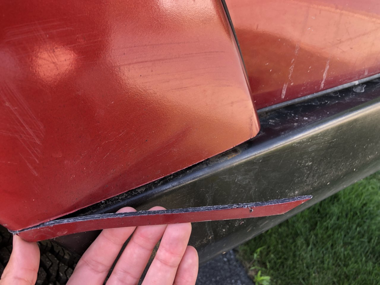

    cut my fender to level after 2 years :anonymous:
    @dziner check the razor blade!

    Here are the supplies:
    eyeballs
    hands (one will work, but two make it easier)
    old ass razorblade
    Step1: Using your eyes, look at where you want to cut your fender
    Step2: Using your hand(s), cut the fender

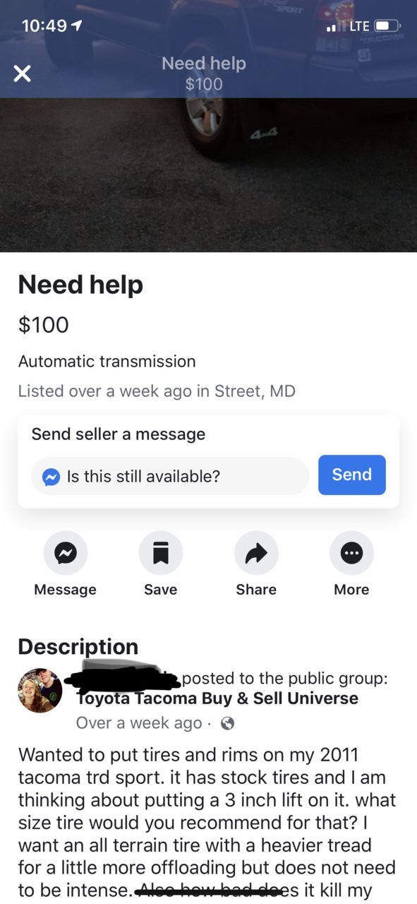

    Could be worse lol, saw this in Facebook marketplace

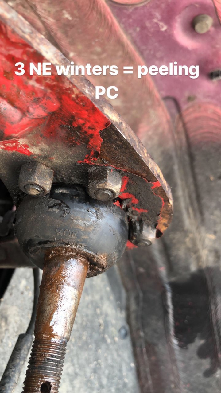

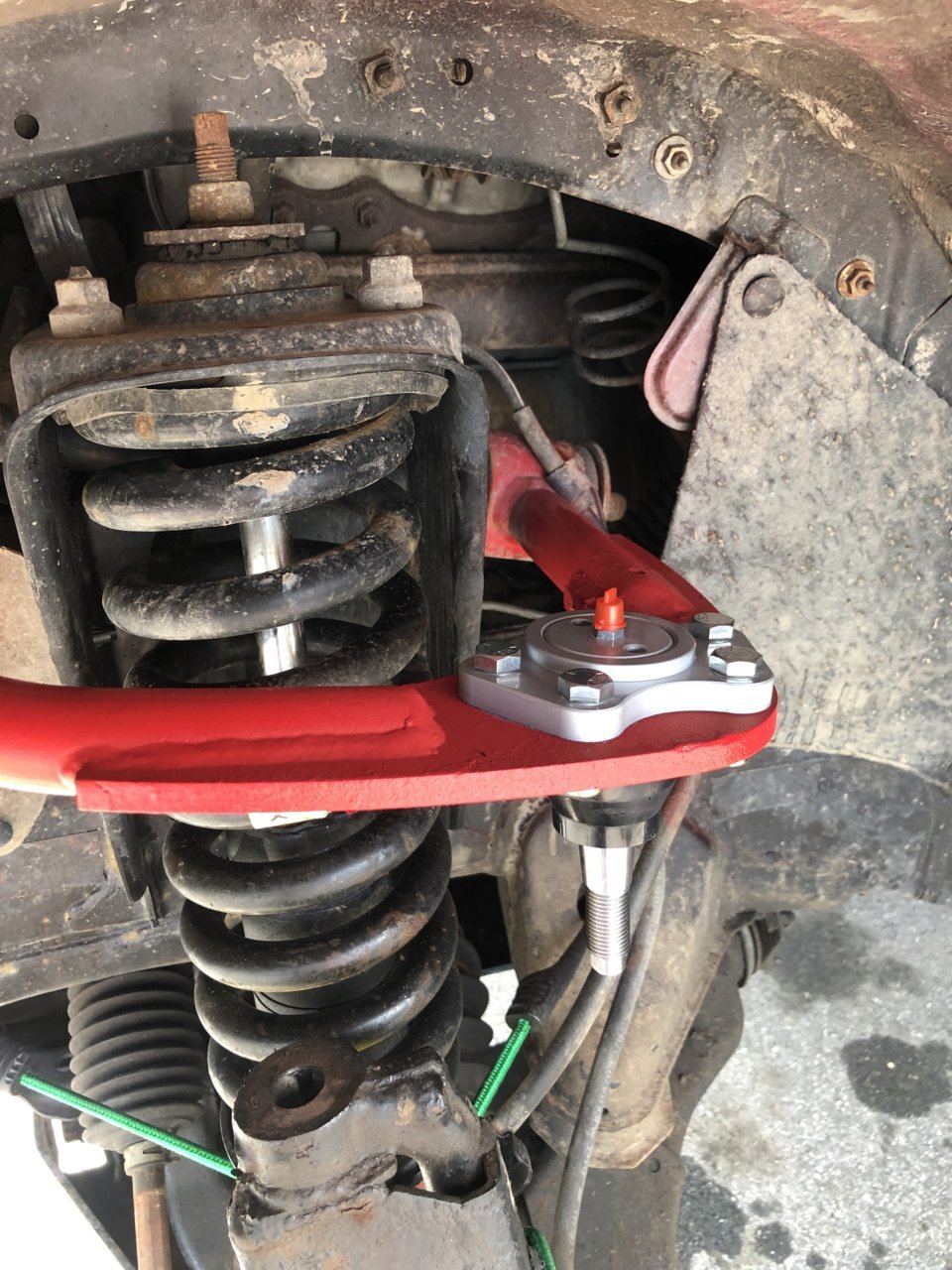

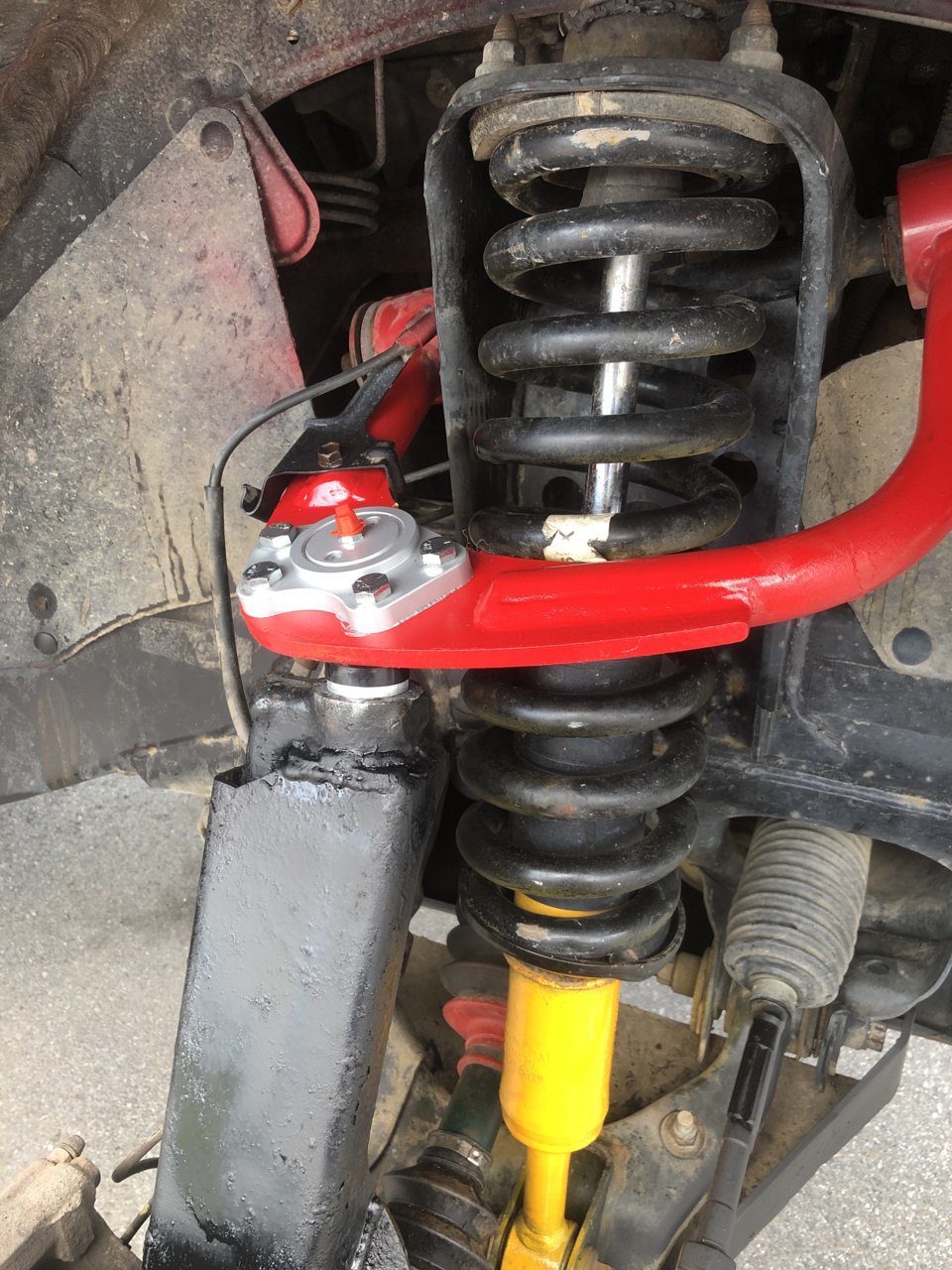

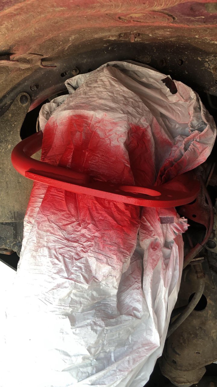

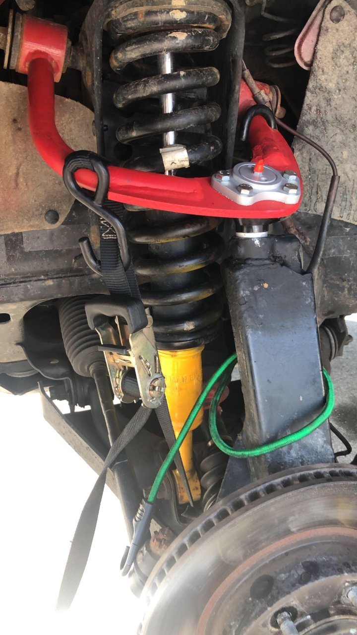

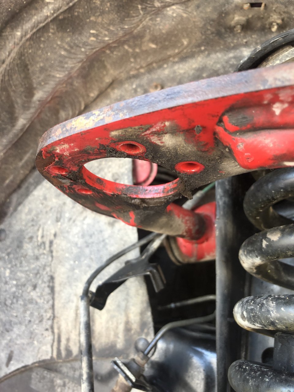

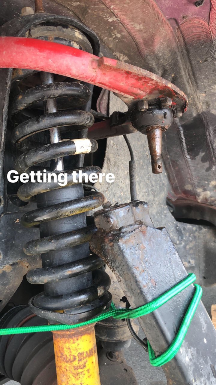

    Replaced my JBA UCA balljoints today
    Shout out to @loosnut for teaching me the ratchet strap trick, and @EatSleepTacos for the prybar tip, which is needed if you have spindle gussets and this balljoint.
    Pics:
    Mini sledge and a socket extension I use as a punch made quick work of the separation
    Crusty
    Little bit of paint, thanks for telling me what brand @Unchained 5150
    Nice and shiny
    Ratchet strap to get it close
    Prybar to finish the job
    Wire brushed and prepped and painted the shock, tie rod, LCA skid, and spindle as well.
    Everything torqued to spec and anti seize was applied where appropriate
    I did 7 pumps of grease as recommended was 5-10
    Much better!

    It feels good getting the fresh joints on there. Did you just replace due to rust or did they need replacing otherwise? One of mine had play in it, so it worked out that Marlin had the recall to send out free new ones.

    Looks good brother Rustoleum Professional Red is a perfect match.

    Yeah it does! The UCA’s were wheeled by @Urineovrurhead before me, and both boots were torn. I figured $63 a side is cheap enough to replace. After a short drive on the new ones my steering does feel better now! Tighter I suppose. And nice you got some free ones.
    After I removed the old ones, they moved pretty easy compared to the new ones, that’s for sure
    That paint legit is the same red! Also, I’m done chasing squeaks, being that I have 3 year old Dakar’s in the rear haha
    before
    After
