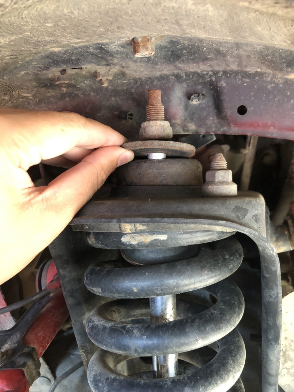

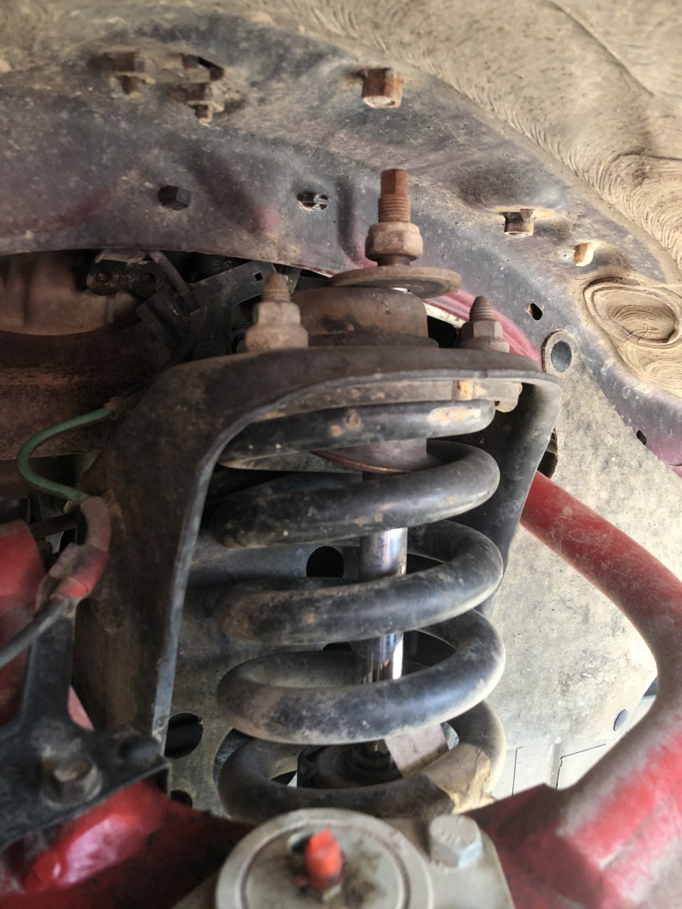

    So my passenger side top hat bushing failed yesterday.

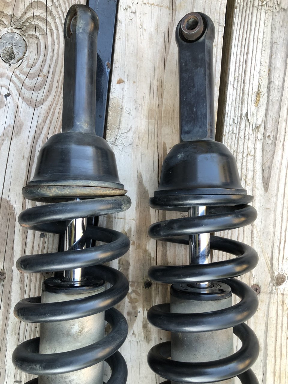

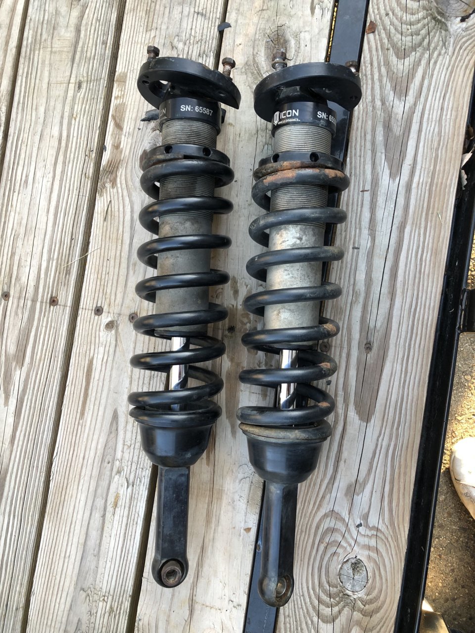

    And I happened to find these and picked them up last night:
    Plan is to rent a compressor, adjust them for what I think I’ll need out of them, and clean them up with some paint on the coil springs after a good cleaning.

    Make sure you get some sort of gusset to sandwich the shock mount. The icon top hats are known to explode.
    Spacers are a cheap option:
    Here's what I went with from dirt designs:
    Also allows for future crossover bracing because #notaracetruck
    Gunshot-6A and Coot83 like this.

    X2. I have seen many sad stories with guys having their top hats fail due to the stupid icon design which many times toasts their coil buckets as well. That spacer ideally makes it similar to kings/foxes an helps eliminate that C style design.

    He did. I think his plan with the spring compressors is to adjust the new icons though. Which btw @Nimble9 if they are still the original 650 pounds springs I’ve always been able to adjust mine on the truck with jus the weight jacked off the suspension. If they are 700’s you will most likely need to compress the springs a touch.

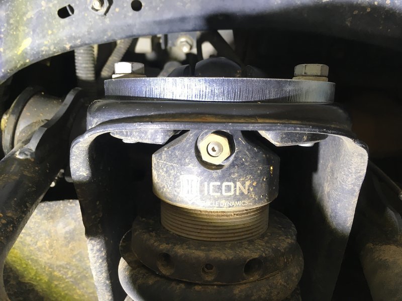

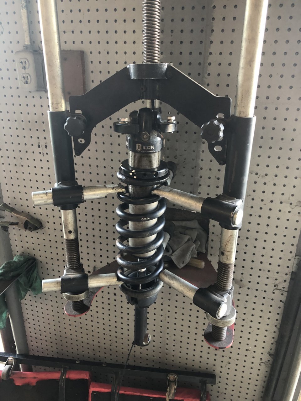

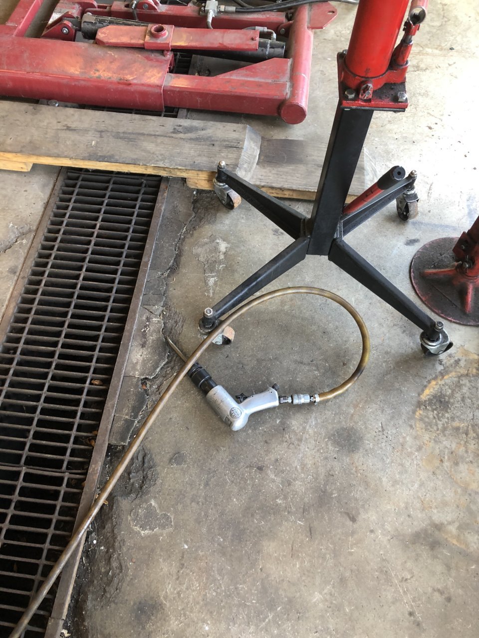

    One is done. These were extremely Seized. No amount of PB blaster was going to unlock this collar.
    I ended up having to use an air hammer to get the collar to spin. White corrosion all underneath. Also, I tried everything before marring the collar, but oh well.

  17. Oct 10, 2019 at 3:22 PM
    #1757
    EatSleepTacos
    Mar 24, 2015
    #151688
    59,834
    Randy
    West Valley, AZ
    2017 4Runner
    That’s quite the rental compressor
  18. Oct 10, 2019 at 4:00 PM
    #1758
    Nimble9
    Nimble9 [OP] visit squareonecreations.com Vendor
    Oct 20, 2015
    #167184
    11,153
    Lebanon, PA
    2006 4x4 DCSB
    enough to have fun
    Talked to a friend who told me where there might be one. They didn’t want me going back there at first but once we talked they were cool
    EatSleepTacos[QUOTED] likes this.

    One shock collar was able to move (After using an air hammer and effing up 2 of the holes), but I moves freely now when the spring is compressed. The other shock didn't budge with an air hammer, so I've been soaking it with Acetone/ ATF (50/50) and I'm going back to the shop later today.
    I already contacted ICON to see if I can just buy new collars, because I'm going to have to eventually run 700 lb 14" springs anyways once I get a winch. So I figured that'd be a good time to change them out haha
